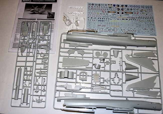

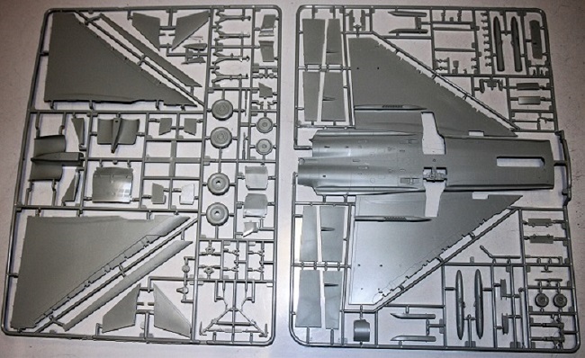

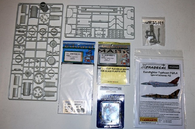

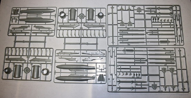

The Revell kit has been around since 2009 and generally considered to be more accurate than the Trumpeter one although they both have good and bad points. There are several aftermarket accessories available and some will be used on the build as well as aftermarket decals which will provide a more fitting scheme for the tribute.

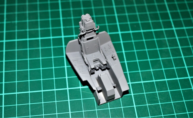

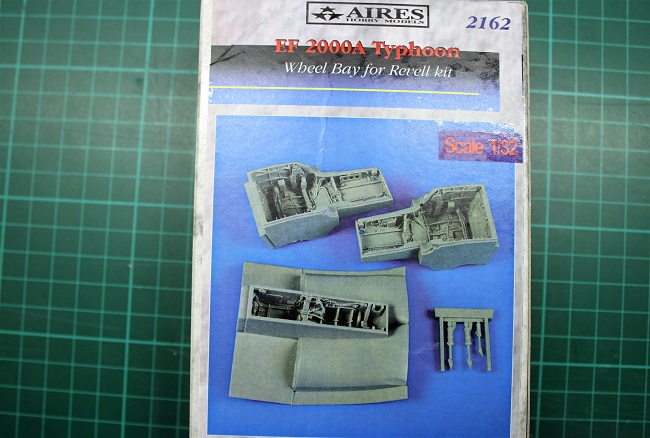

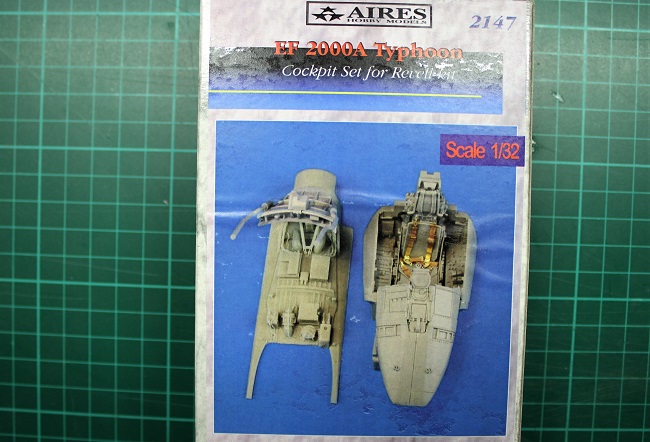

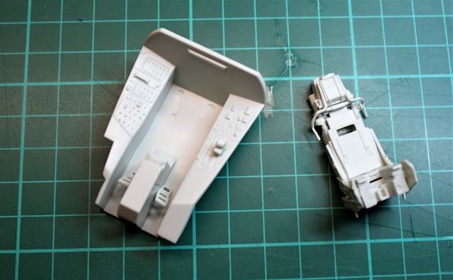

Starting to build the seat and cockpit but found it a little lacking in detail so have decided to remedy that with the Aires upgrade and while I was at it I also got the undercarriage bay and the exhaust set and some Airscale cockpit gauge/screen decals.

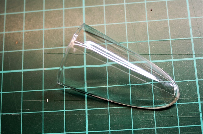

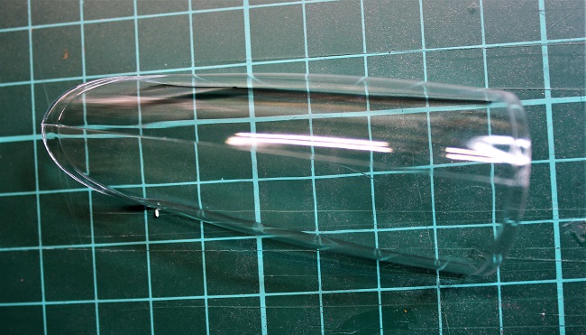

As a lot of builders of this kit have already discovered the canopy and windshield suffer from having a seam line down the middle of them so some work will be needed to hopefully clean it up sufficiently.

BigGrin Nice start Al, a good micro-mesh set will sort out that seam on the canopy did'nt really beleave it worked until I did it myself and it really worksCool

Once you have polished that seam out with some Micro-mesh (working in ever finer grades up to a final 12000 grit), just dip the canopy in some 'Johnson's Klear' liquid floor polish (now sold as Pledge 'Future' I believe), then wick off the excess with a paper towel touched to the edge and that seam will completely disappear. It will also leave your canopy crystal clear to show all of that lovely cockpit detail.
Hope that helps? ThumpUp

Thanks for looking in and the advice gents BigGrin will get the micromesh out and give it a whirl.

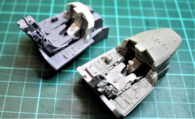

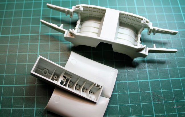

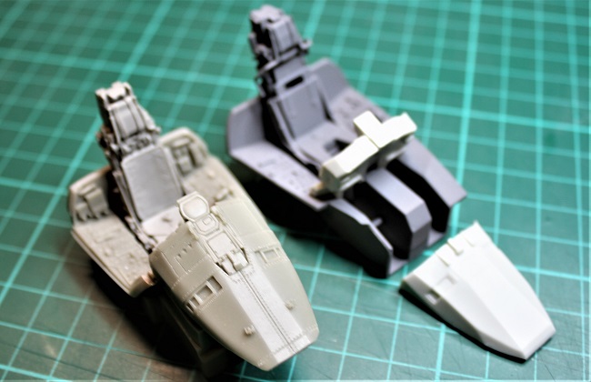

Made some progress on this and have removed some plastic detail from the wheel bays in order to fit the more detailed Aires ones. The second pic shows what undercarriage bays come with the kit and the third shows the new bays attached. The next couple of pics show the Aires cockpit [lighter colour] in comparison with the Revell one. I have had to modify the the kit slightly by removing some plastic in order to accommodate the cockpit coaming. The last pic shows the Pilot figure from Scalemates who will pose next to his TyphoonLOL for the the rest of the build I will refer to him as RupertLOL LOL
More soon

BigGrin Nice start and the upgrades take it to another levelCool
