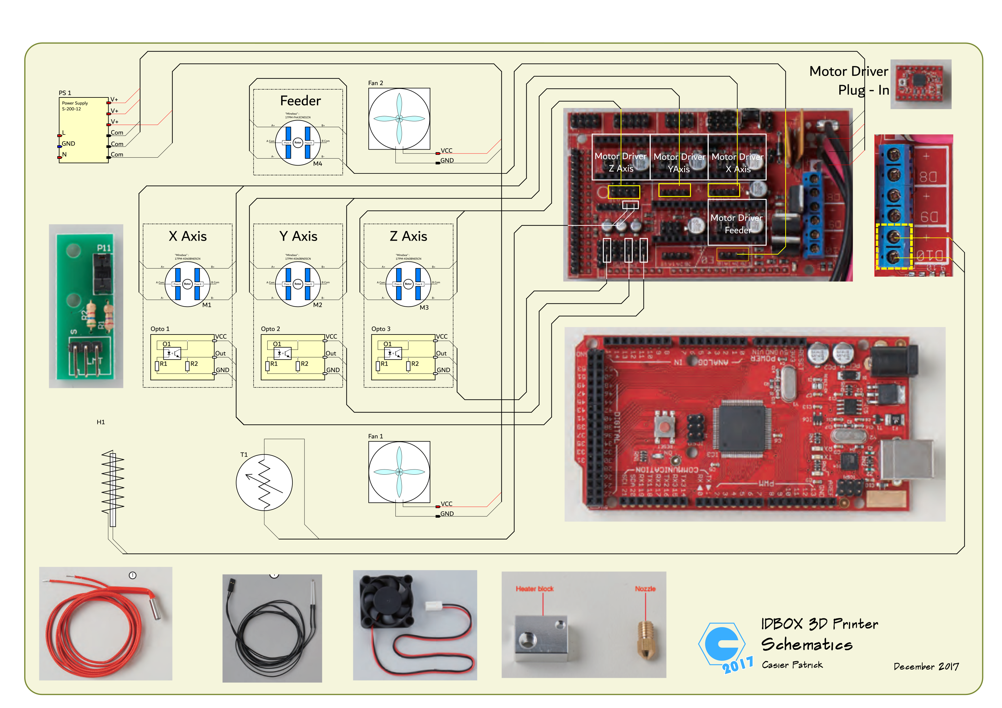

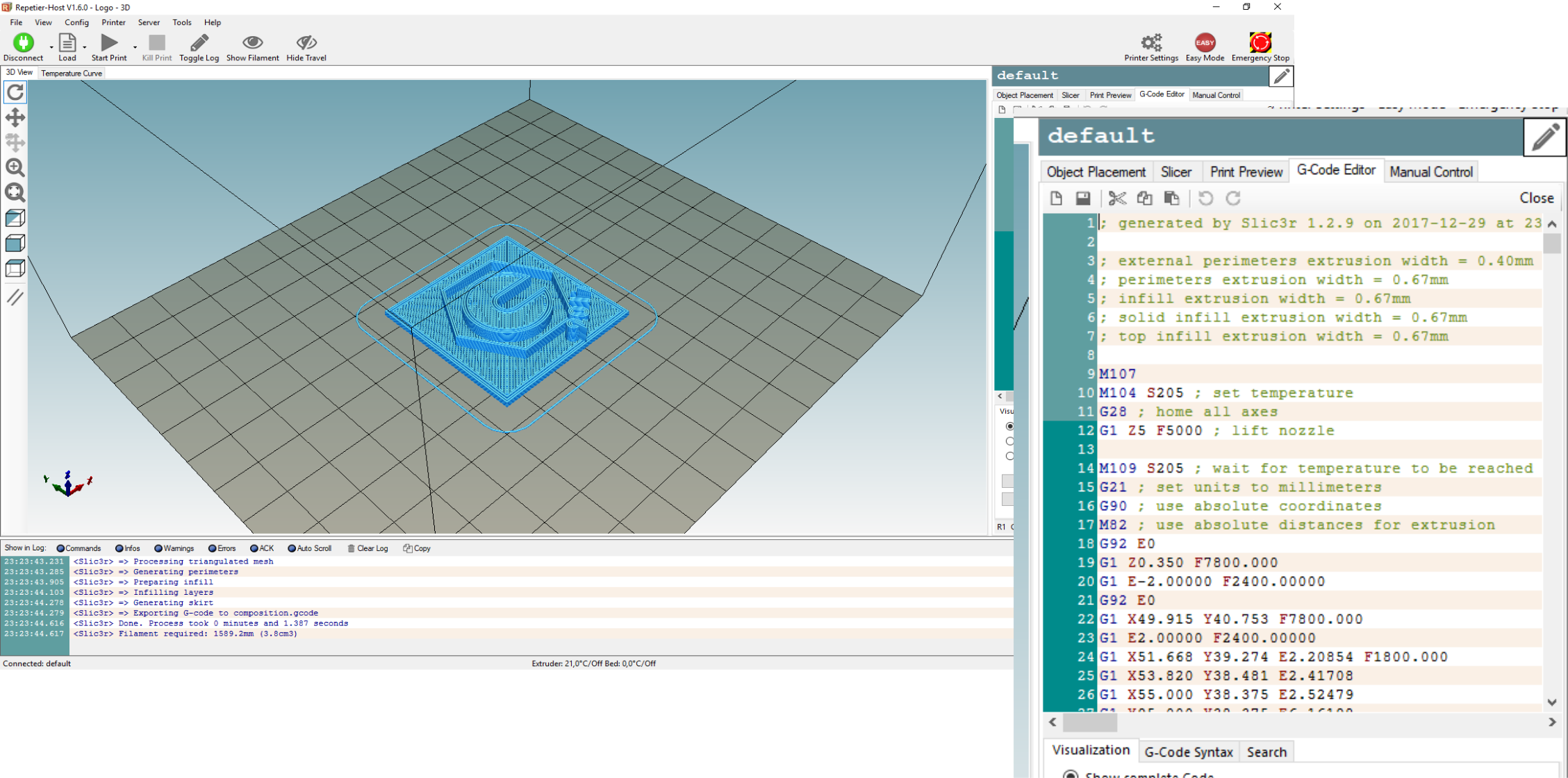

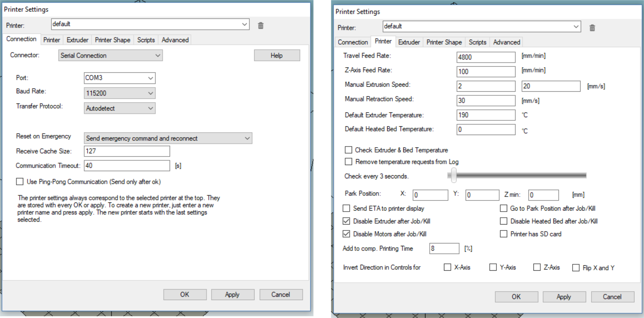

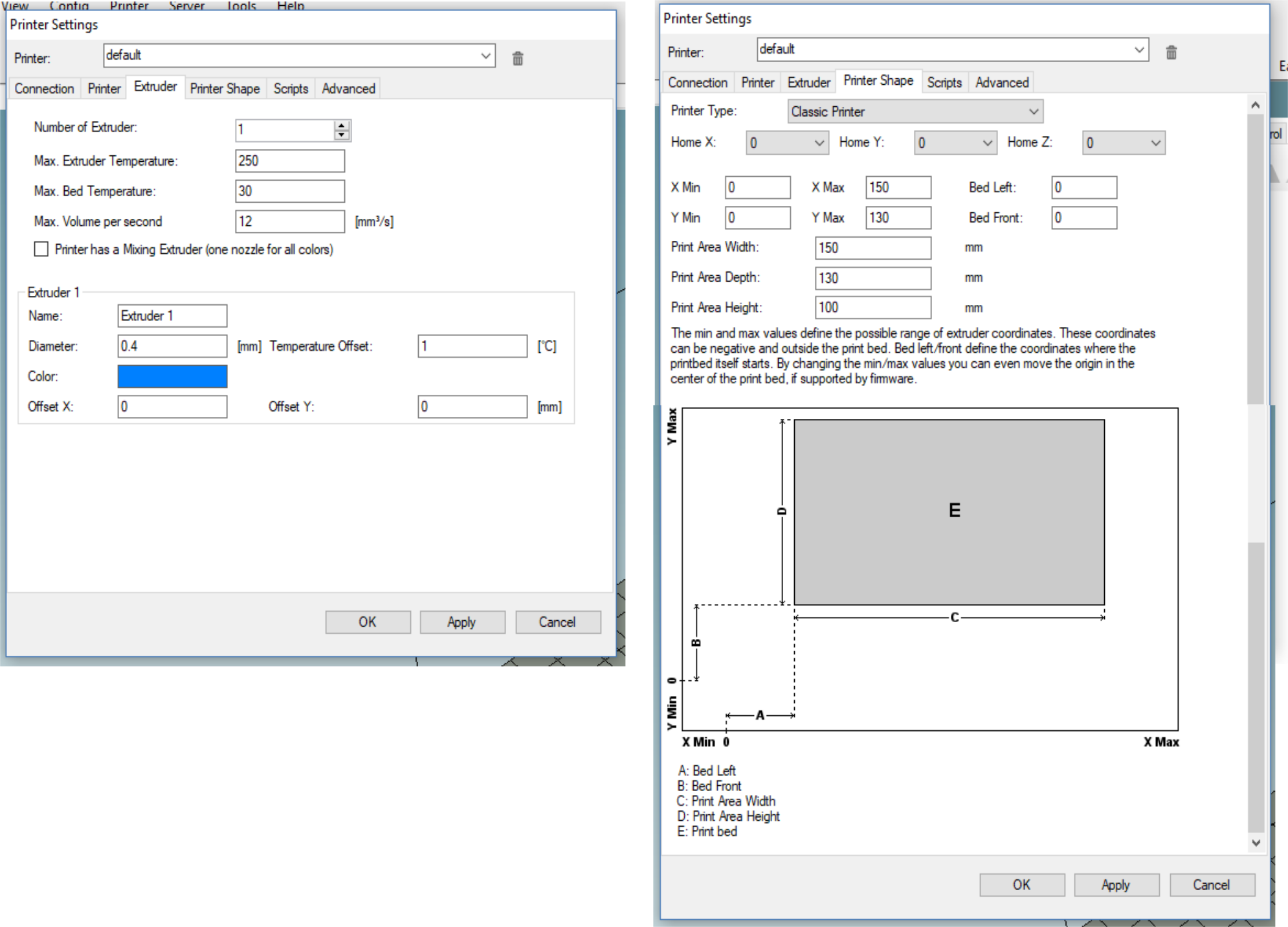

So I give some screenshots of my settings, a sample of my generated Gcodes and a schematic of the way I connect everything in my IDBOX...
It gives you maybe more thing to analyse to search the problem.

#4 Posted : 30 December 2017 00:03:06
Hi Patrick
In your first picture on the left change the max bed temp to 120.
Click on the printer tab to the left of extruder tab and change the default heated bed temp to 0.

Noyhing to do... My extruder does'nt heat up.
It seem to be the Gcode M104 S205 that gives the target T° of the
extruder and the Gcode M109 S205 that looks if the T° is reached.
I know that the bed t° is creating some problems but nothing is
generated as Gcode.

Location: Belgium
I tried it but... My extruder doesn't heat up...!
Could it be that my heater resistance is broken?
How can I test it?

#9 Posted : 30 December 2017 08:42:53
Hi Patrick
Contact Customer Support for a replacement heater unit and quote the stage number for the part.
