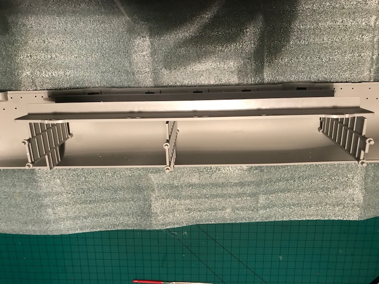

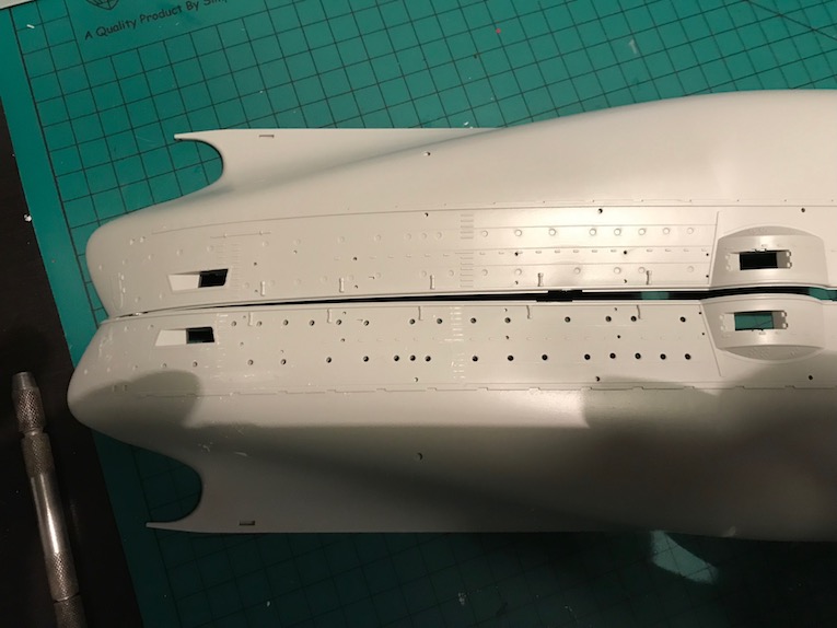

The kit comes with a hull formed from two halves with a lower gun deck that needs to be fitted in step 1. Upon dry fitting the parts go together very well, the internal supports are a tight fit. marrying up the two hull halves and the gun deck at the same time is a bit tricky.
Before I can get the glue out there is some prep to be done to accommodate the additional etch detail and to open up the scuttles.

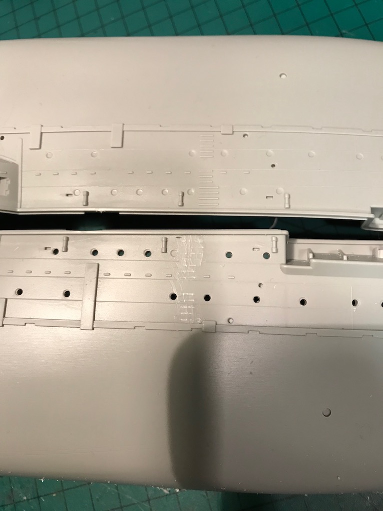

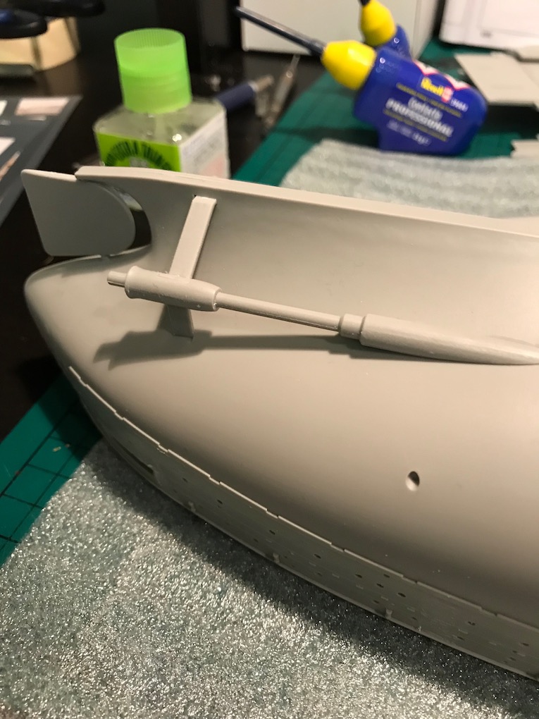

The first task is to carefully remove the moulded on grab handles along the length of the ship. A small chisel blade is ideal for this I find. Once removed a small piece of fine sanding paper is used to rub down the area. Any damage the hull surface can be filled and sanded down before priming.
With this done the next job is to drill out the scuttles. This was done using my proxxon hand held drill, it makes short work of all the drilling although there is more clean up after. The key to doing the scuttles is finding a drill bit of the exact same size of the scuttle and to go in at the correct angle. A couple of the scuttles at the very front of the bow have slightly deformed in the moulding process becoming elliptical rather than round, You may need to fill and re drill these, I however, found that the etch scuttle frames covered the distortion so no filling was required.

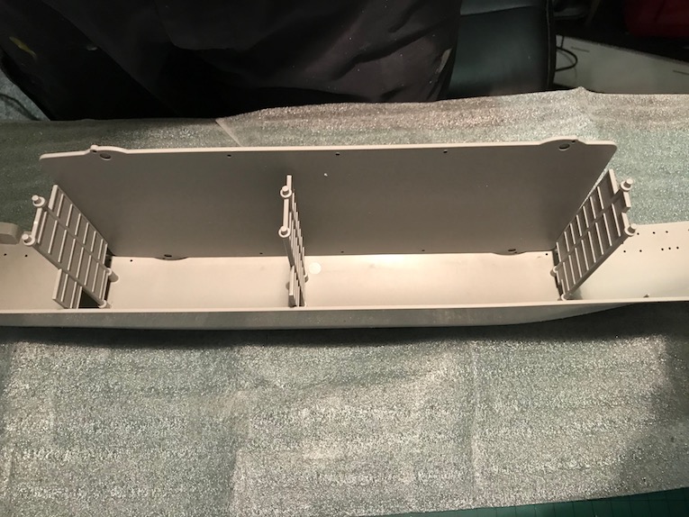

All the parts are dry fitted then the internal supports are fitted in one Side. As stated above these fit quite tightly so dabbing some Tamiya extra thin liquid poly is all that was needed. The deck also went in at this point using the thicker Revell professional liquid polly.

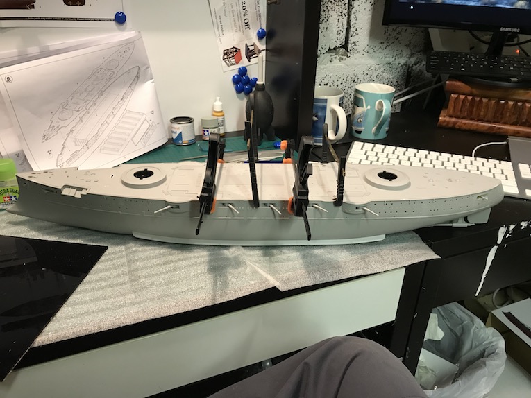

Putting the two hull halves together is a little tricky, there is a lot to line up and you need some time to get everything correct. Its one of the very few occasions that I will use the traditional thicker tube poly cement. Its slower drying time lends itself to this job nicely.
I used some elastic bands and pegs on the bow and rudder mount, just to hold everything together while the glue is curing. At this point I have given the lower gun decks a couple of coats of Humbrol matt black

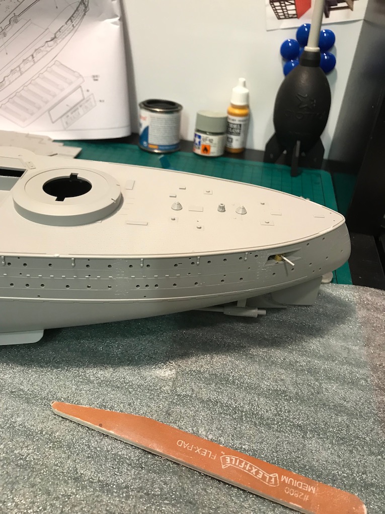

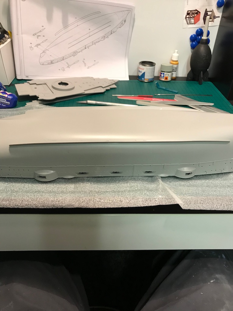

With the hull now dried it was given a sand to remove any visible seems. I used a medium grit on the join line where the heaviest sanding was needed followed by a very fine grit, but all in oil the two hull halves fit very well.
The Anchors on Mikasa are not stowed drawn up to the hawser outlets on the side of the ship, but, like many pre-Dreadnaught ships they are stowed to etch side. This is because the hull is designed to be used for ramming if needs be. On the finished build it will be possible to see through these holes into the ships hull, so I gave the inside of the hull at the bow end a matt black paint.
The rudder was installed when the two hull halves were joined. The Propeller shafts are now added. The fit is not great and quite a bit of filling is required where the shaft part marries the arms. Fortunately this is on the inner side is not visible, non the less it was filled using some Milieput as the gap was to large for Squadron filler.
The two stabilisers are very thin and flexible parts and I found the easiest method of installing was to hold the part in place at one end and dab with extra fine poly cement, then move along and repeat until the whole part was correctly in place. I then flooded the inside join with the same glue and let capillary action get on with the job.

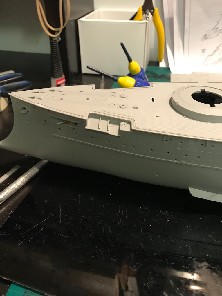

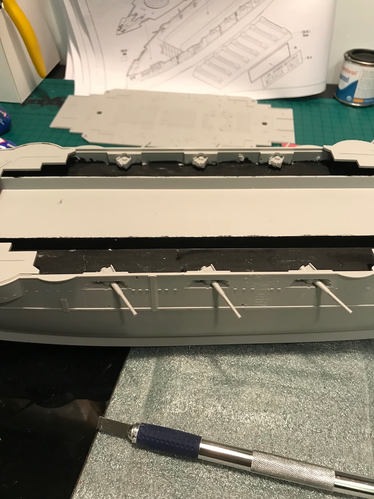

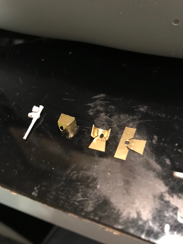

The next task is to install the hull guns before the main deck can be fitted. There are two gun types to be fitted.
The larger calibre hull guns are a single barrel that mounts onto the deck, these can be left movable if you wish, but I fixed mine in place.
The smaller caliber guns that sit at the extreme forward and aft positions are made up of two parts a plastic barrel and an etched gun shield.
I question the need for the etch on these guns. They will be hidden under the deck and only a small part of the front face will be visible regardless of the position you place the gun in. A plastic shield, although no doubt they would not be to scale thickness, is all that is required.
The etch itself is a little fiddly to construct. The sides of the shield need to be formed into a curve first, I used my curve forming tool for this job, the shield roof is formed with two folds.
The kit etch uses fast bend technology, this gives an advantage of being able to form the bend easily without a folding tool. The down side to this is that the process of making fast bends leaves slots in the brass with are visible under paint and in my view detracts from the overall finish as they should not be there.
Its difficult to get the gun shield to sit correctly. Without visible gaps on the top joins. Under dry fitting they are not really seen so I left as it is, but for other guns, on the top deck I may need to consider soldering the parts to fill the gaps? something to ponder.

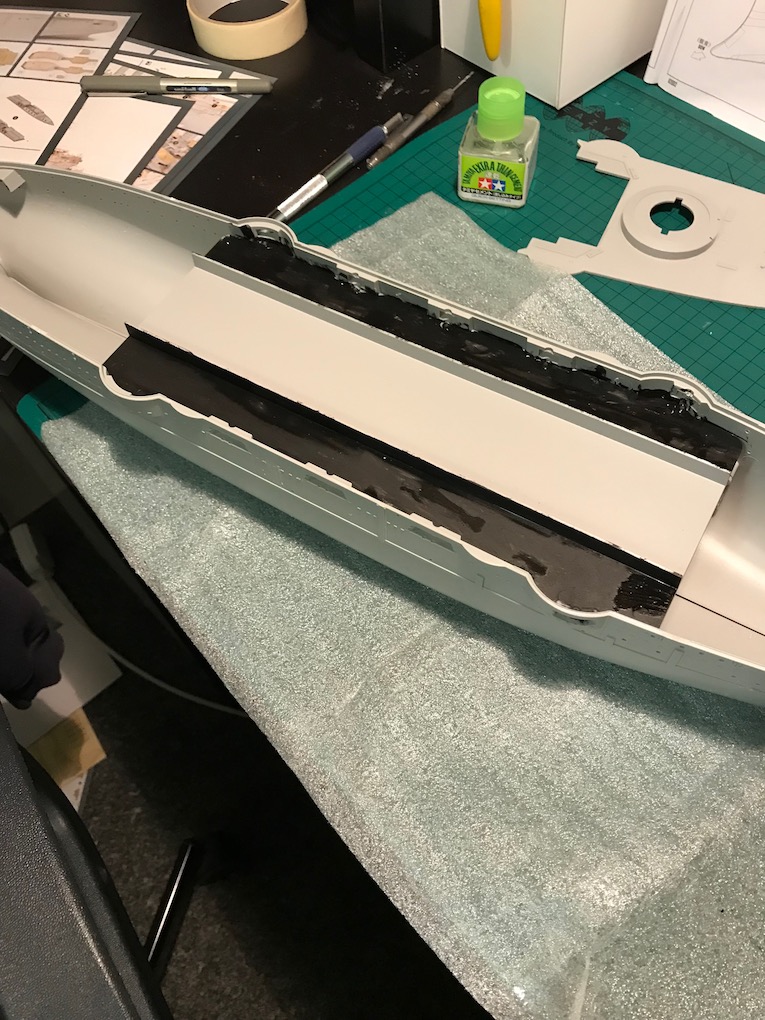

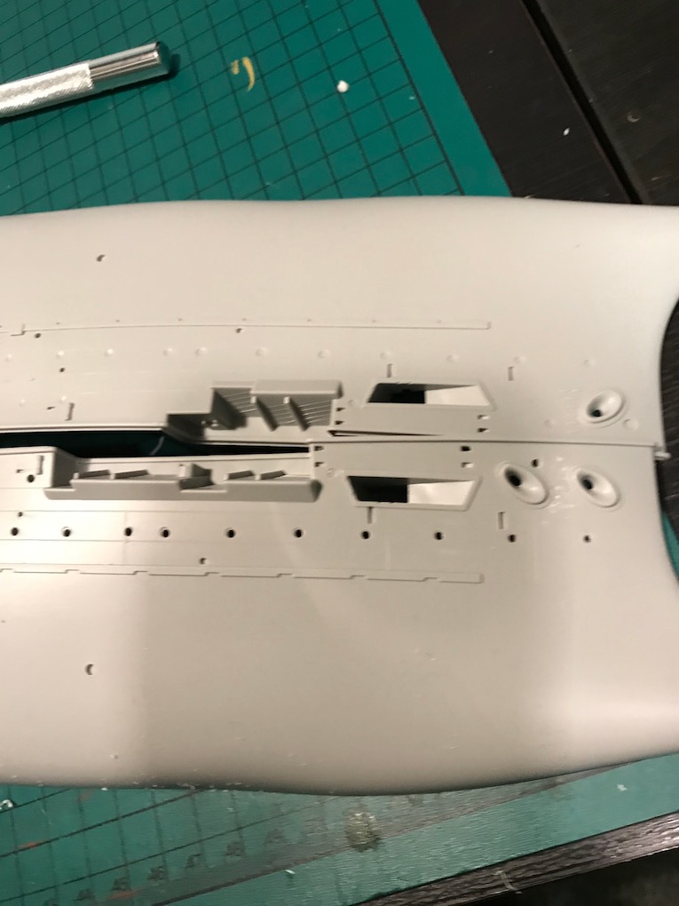

With the guns fixed in place with medium polly cement the upper deck could now be fitted. As I will be using a wood overlay I needed to modify the deck and remove some of the fittings, we will come back to this later.
The three part deck fits very well at the stern and bow, I had a small amount of slack in the centre section so this needed clamping, thick tube polly was used for fixing the decks in place.
