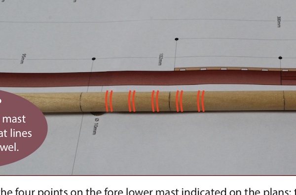

Info Nr. 2 - Mast plan
It's much closer to the ring however still haf way between the ring and the cheek bottom.

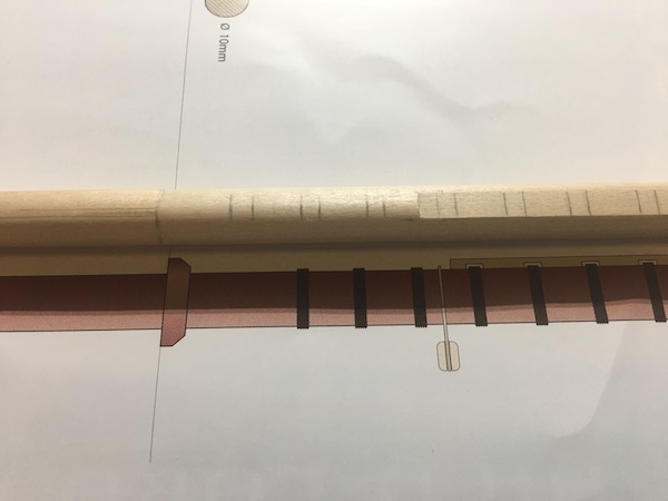

Info Nr. 3 - Follow the 1:1 plan (with the dimensions shown)
If I follow the same spacing of the binding from the cheeks for the lower three bindings then the lowest binding will end up very close to the ring.
The incorrect scaling of the assembled mast plan (see my previous post from my build diary, see link below) also doesn't help to judge where the binding supposed to be.
I thing I'll go for my instinct an use the same spacing (Info Nr. 3), with a tiny bit cheat to get the bottom 3 closer to each other (1mm less distance) to avoid being look ugly and being too close to the ring.
