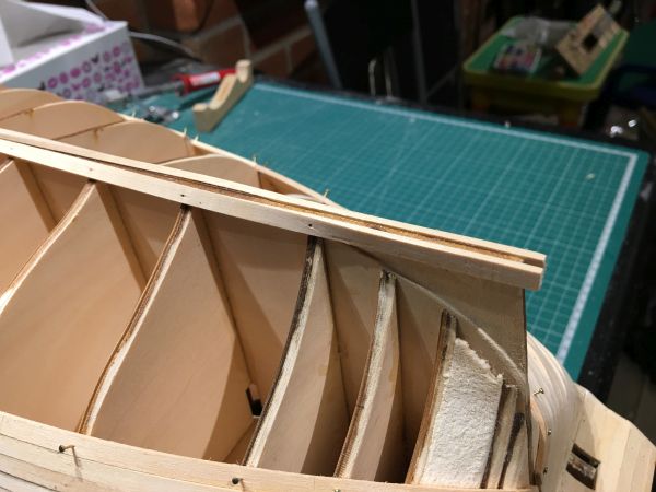

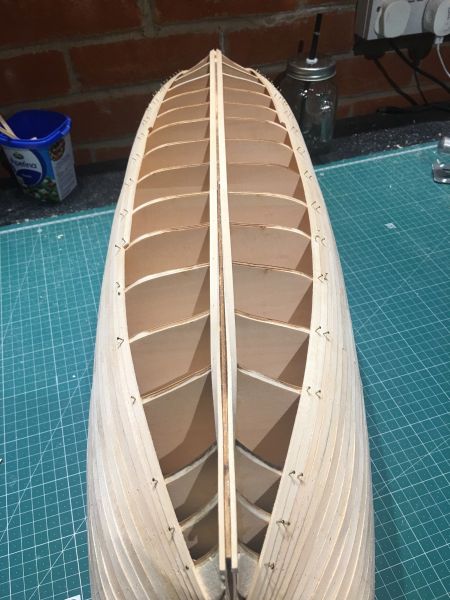

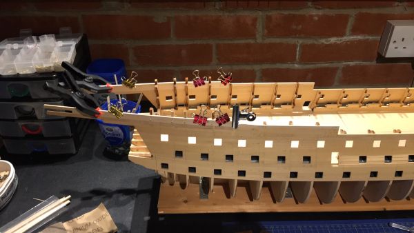

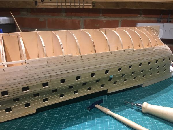

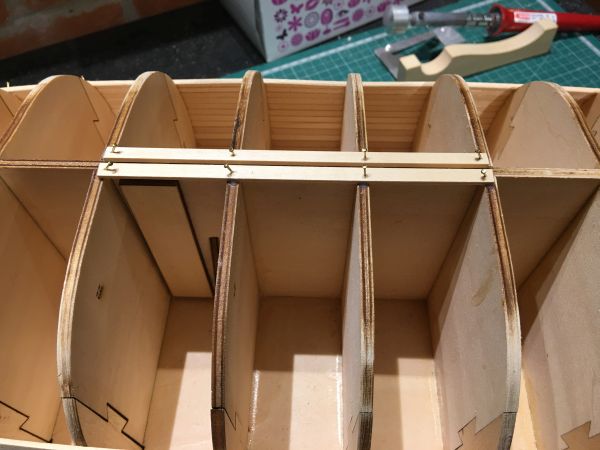

16/05/2017
couple of more layers of plank fitted.
It's not a very quick process.
17/05/2017
Another two layers fitted. With this the upper half of the hull is fully planked.
Now comes the even more difficult and slower part: the lower hull, underneath the waterline. The much bigger curves requiring bending the planks, especially at the bow and stern.
Happy building!

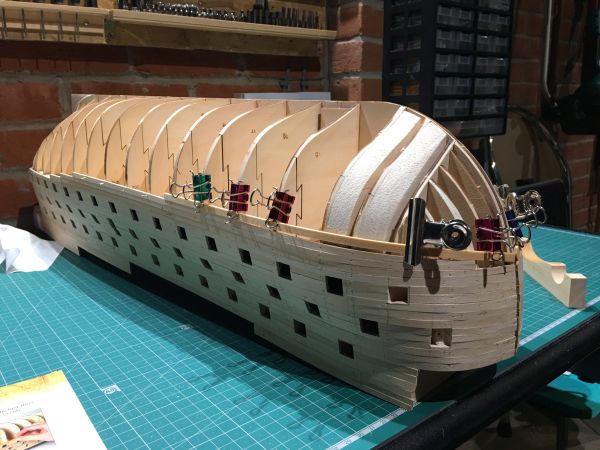

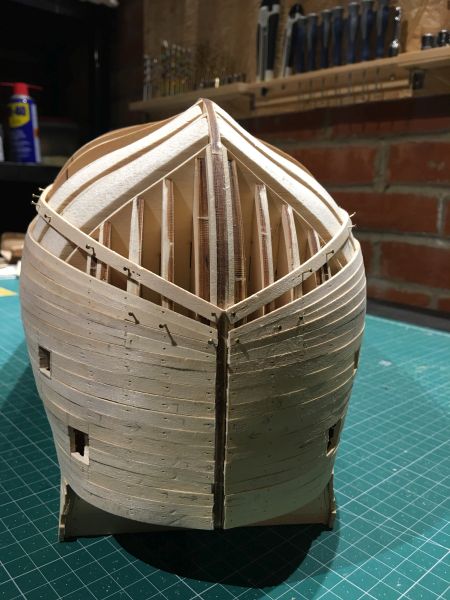

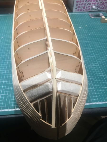

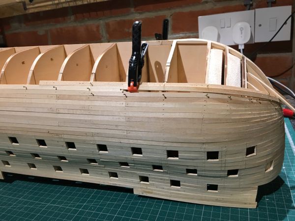

18/05/2017
started planking the lower hull. Veeeeeryyyy slow 😴 Bend one strip each side, then leave it dry its place. Then taper towards the bow and fix it. A pair of plank = 30+ mins... 😴😴
21/05/2017
two more layers of planking fitted on the sides and at the bow. Next one is bent and now drying ready to tapering, then glueing on its place.

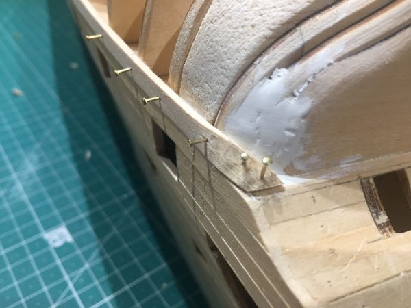

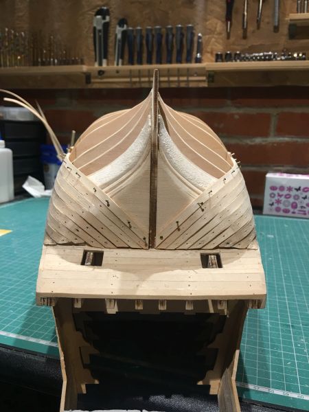

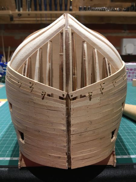

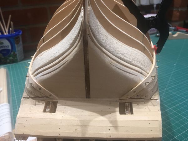

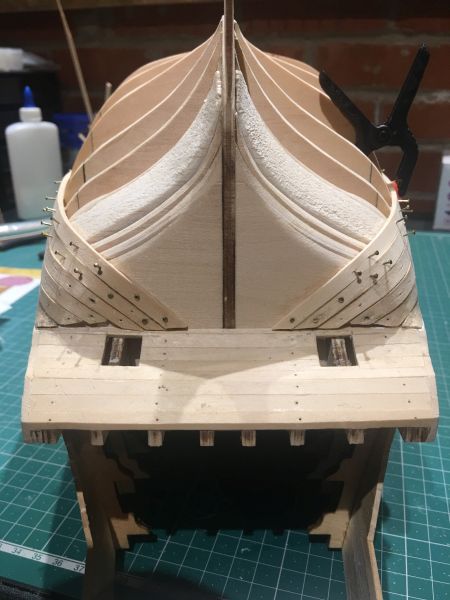

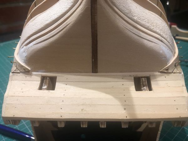

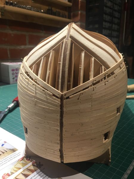

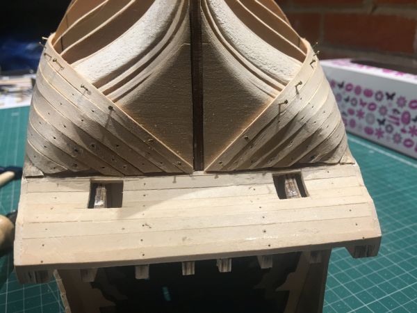

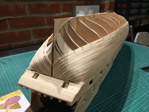

22/05/2017
Another layer and a dropper plank fitted at the bow. Will start working on the stern planking with nearly 90 degrees plank bending without snapping them... 😳😱😵😰
To get ready for this madness gaps filled with milliput.
Happy building!
Laszlo

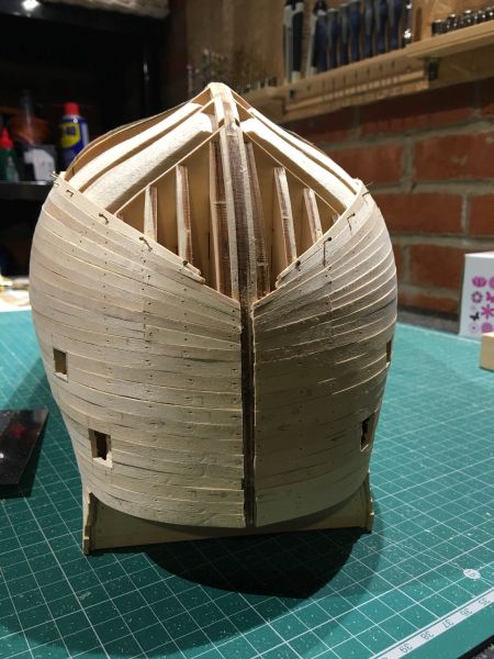

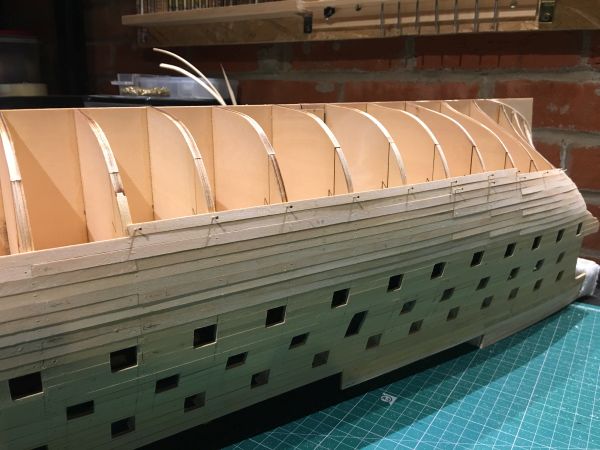

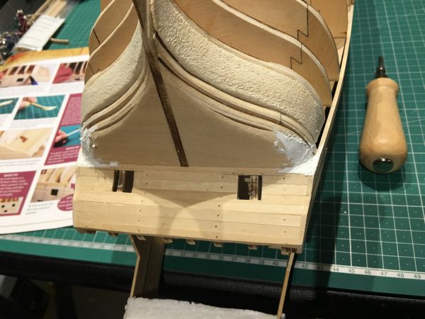

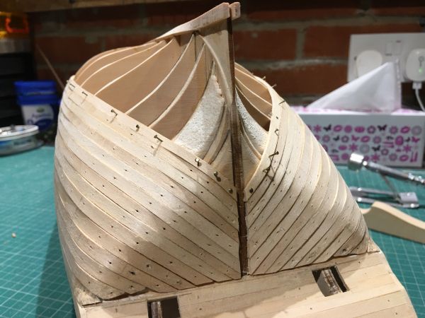

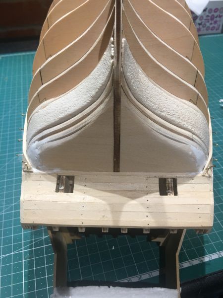

23/05/2017
hardest task (so far) completed. Very first plank at the stern bent and twisted on the same time.... 😥😊😜 One of them is tiny bit split but hopefully won't be visible after pin is removed...
Happy building!
Laszlo

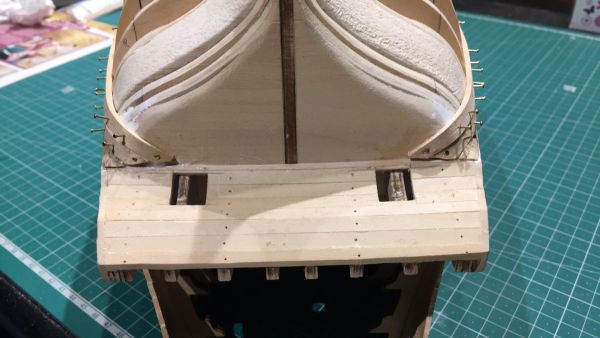

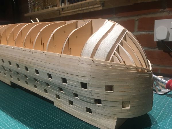

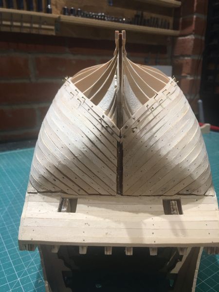

24/05/2017
Further layers added to the stern. Not the smoothest finish but theoretically the plank ends will be covered later on.

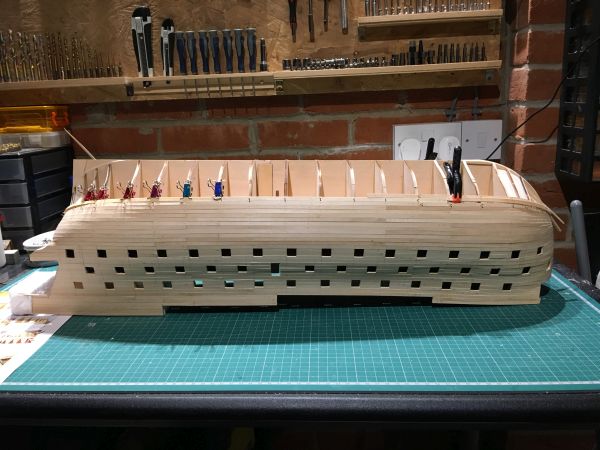

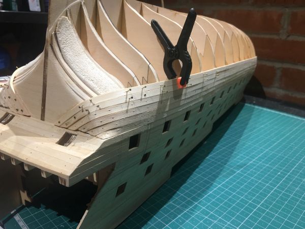

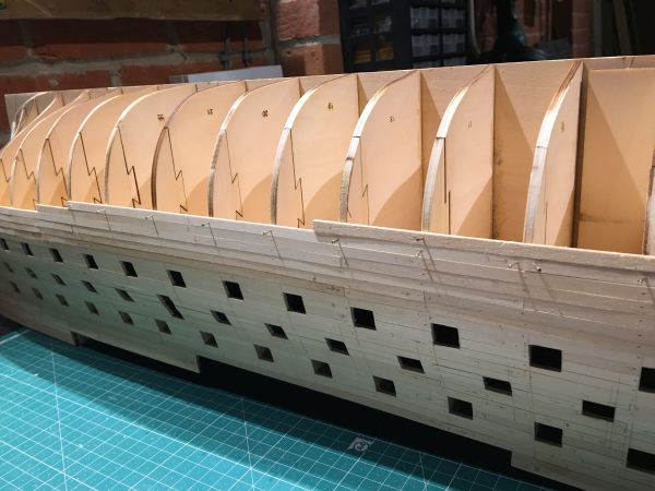

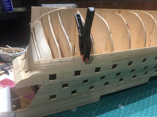

29-31/05/2017
Further layers added to the sides and the bow.

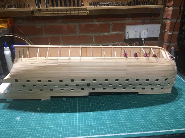

gingerale75
#9 Posted : 30 November 2017 16:45:41
Joined: 30/11/2017
Posts: 493
Points: 1,482
Location: South Norfolk
01/06/2017

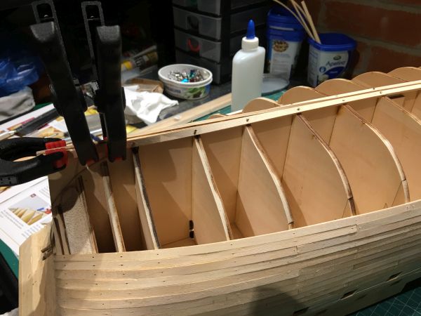

the two layers added yesterday to the bow now extended and completed at the stern...
Happy building!

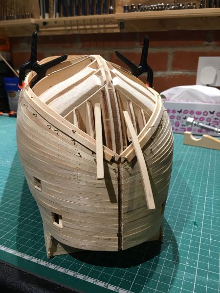

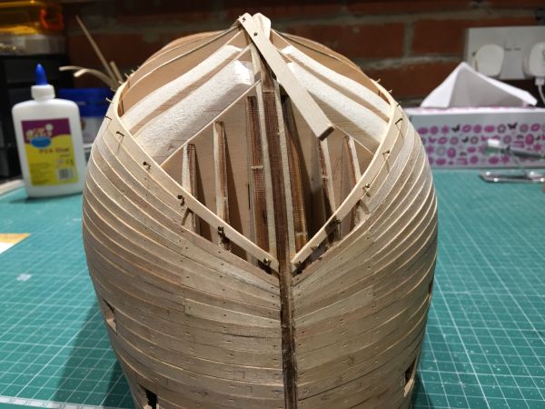

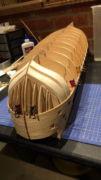

04/06/2017

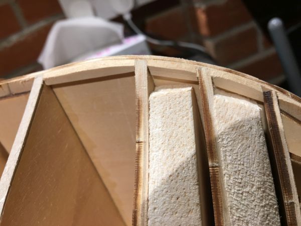

one more layer fixed to the sides and the bow, and bent at the stern & left drying to shape overnight.
Happy building!
Laszlo

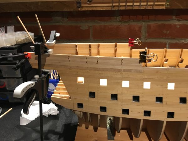

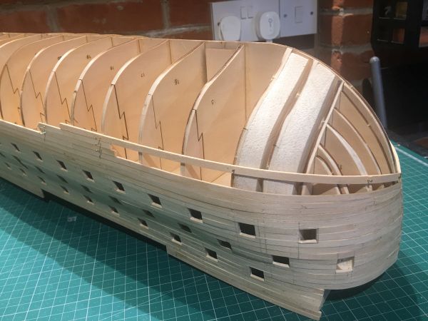

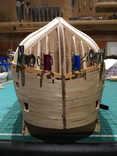

05/06/2017
another layer fitted on the sides, droppers fitted at the bow, temporary planks added for preparation of the next two layers at the bow.
Happy building!

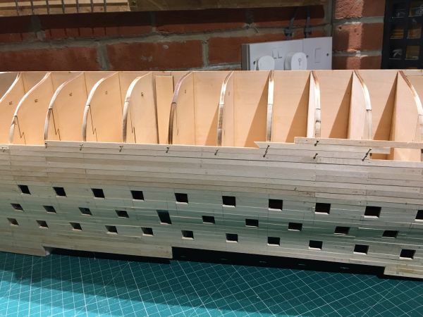

07/06/2017

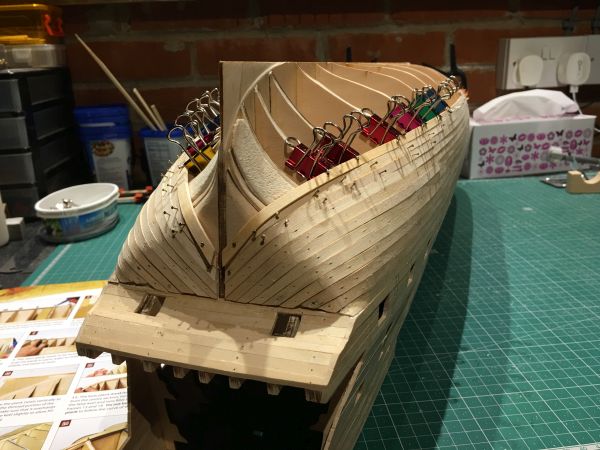

previously fitted layer at the sides now extended at the bow and the stern, new layer started at the sides.
Happy building!
Laszlo

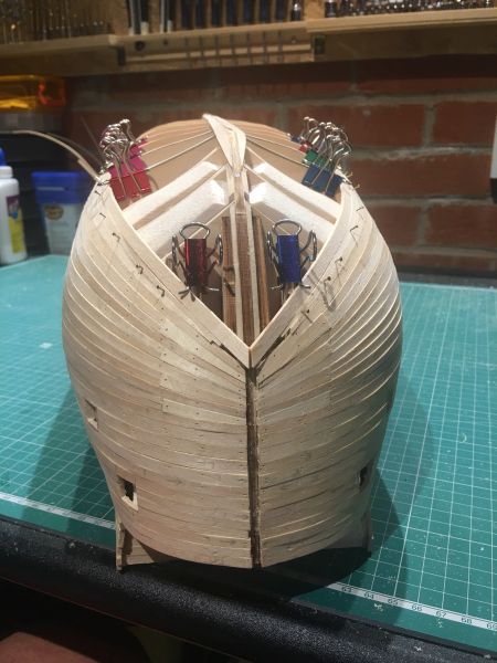

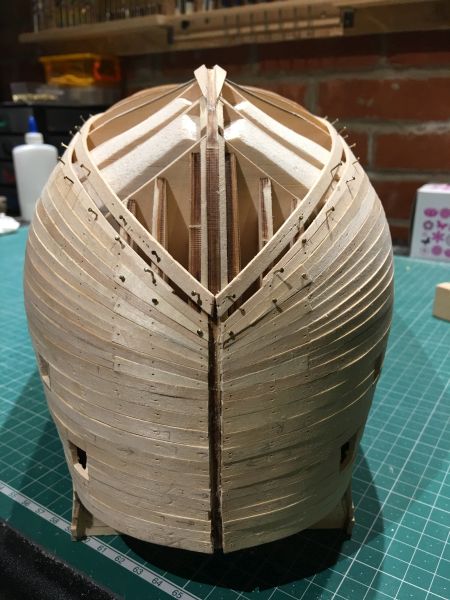

11/06/2017
repetative task again, extending planks to bow and stern, starting new layers on the sides...😳 however bit more productive today... two layers completed, third layer bent and left dry to shape overnight. 😊 the thing is now actually getting look like a ship... 😂

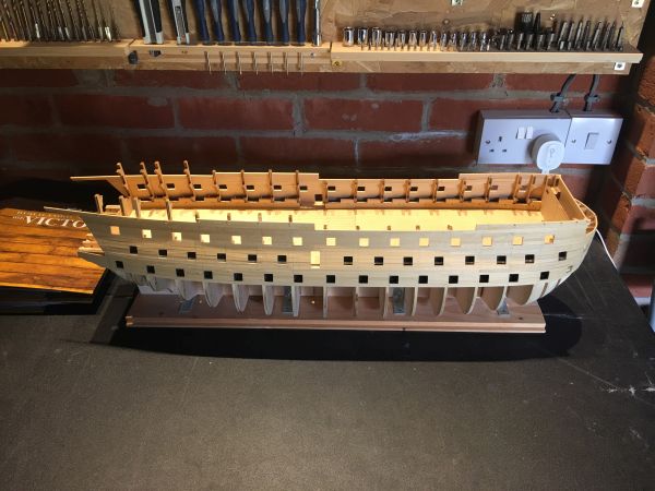

12/06/2017

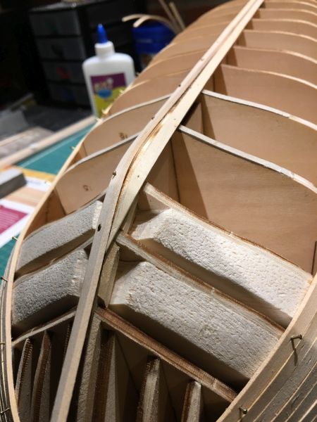

Layer started yesterday now completed at bow & stern. For now planking will stop here and start planking from the keel. To support the garboard plank little fillets fitted, first centre planks fitted next to keel.

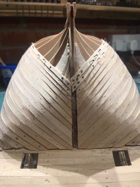

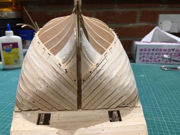

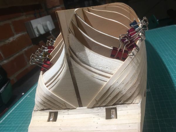

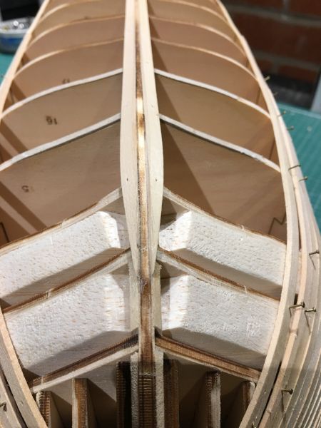

13/06/2017
Very slow progress today. The garboard plank twisted and fitted at the stern, one side twisted and fitted at the bow. These must be thoroughly dry before they trimmed otherwise they will come off.
Happy building!
Laszlo

14/06/2017
Garboard planks nicely dried and remained attached along the keel 😜😜, garboard plank fitted to to other side at the bow, again, left fully dry overnight before trimming and pins will be removed.... Planking now continues again 😳😲, one and a half row fitted.

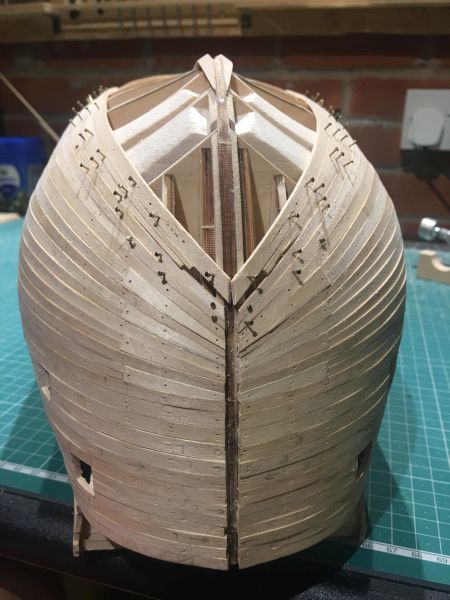

gingerale75
#18 Posted : 30 November 2017 17:00:13
Joined: 30/11/2017
Posts: 493
Points: 1,482
15/06/2017
garboard plank on both sides now complete. And again another row is completed, also dropper fitted at bow...
