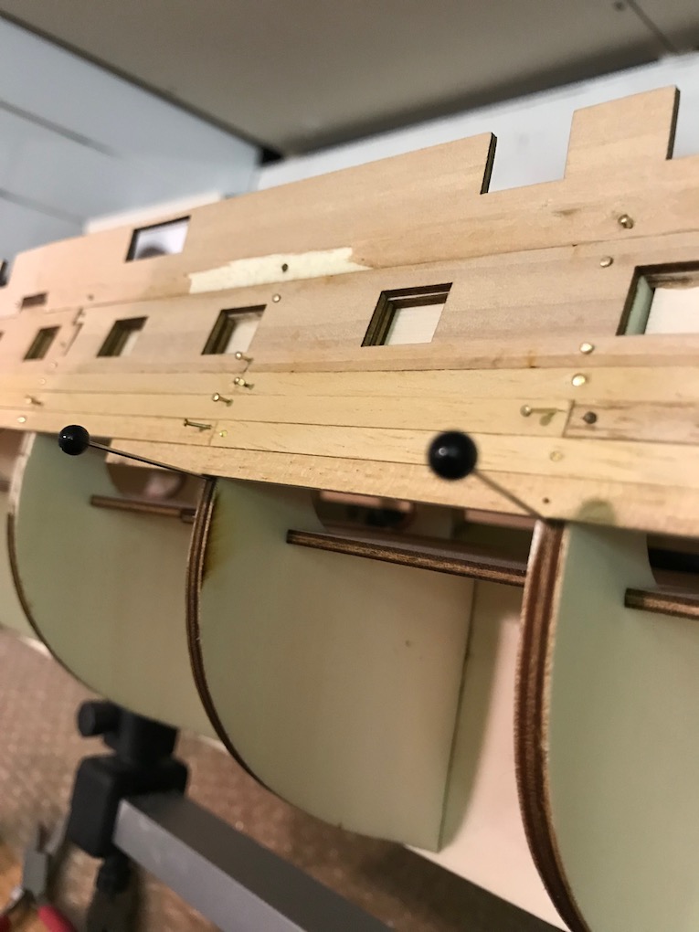

Crows Nest. Fixing planks to a hull frame.
For my first blog I wanted to look at a subject that I get asked about more than any other, I have lost count of how many times somebody wanted my opinion on the 'best' method for holding planks in place when planking a hull so this is my take on the various methods

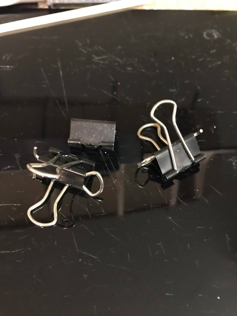

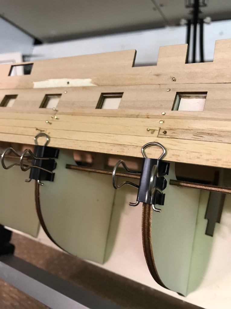

Bulldog Clips (Pictures 1 and 2)
Bulldog clips can be modified by removing one of the clasps and inserting it into the top of another clip to make a tool for holding planks in place.
Advantages of this are that they are quick to apply hold the plank to the rib and at the same time ensure the plank is butting up to the other. In addition the plank is not damaged with holes like other methods.
Disadvantages are, they struggle on tight curves, cannot be used once the gap between planks is to small and difficult to remove excess glue from the area the clip is applied.

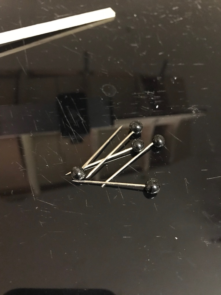

Plan Pins (pictures 3 and 4)
Plan pins are long and thin with good heads to allow easy removal.
Advantages are that they are long enough to pin through a thin plank into the rib and can be used on thin ribs on smaller ship kits with ease. being thin they can be used through out the planking process with no limitation.
Disadvantages are that they are difficult to push through thicker planks. when used in the rib they can help keep a plank butted tightly but no pressure can be applied to the plank onto the rib.

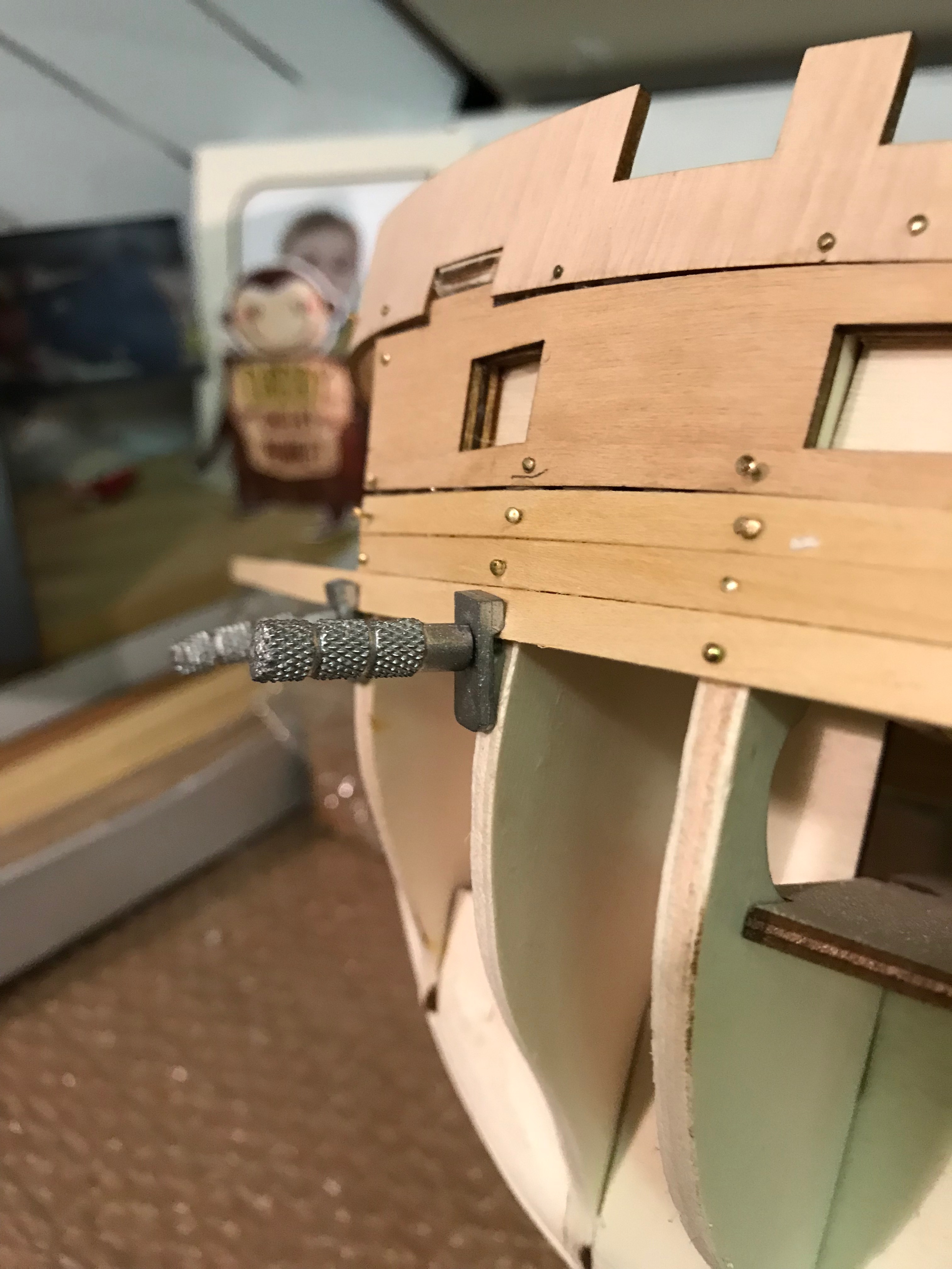

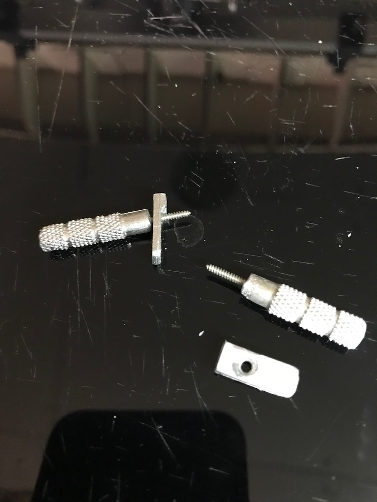

Planking Clamps (pictures 5 and 6)
Planking clamps come in plastic and metal and screw into the rib clamping the plank into place.
Advantages are that the process of screwing the clamp into the rib apply positive pressure keeping the plank in place without making holes in the plank.
Disadvantages are that they cannot be used on the few rows once the gap between planks is reduced. they are an expensive option compared to all others. plastic clamps can bend under pressure. The screw damages the rib which could cause weakness and they cannot be used on smaller kits with thinner ribs.

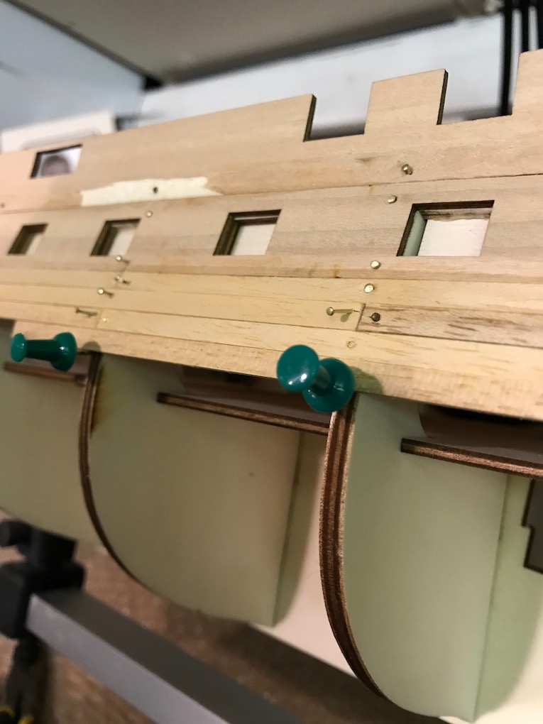

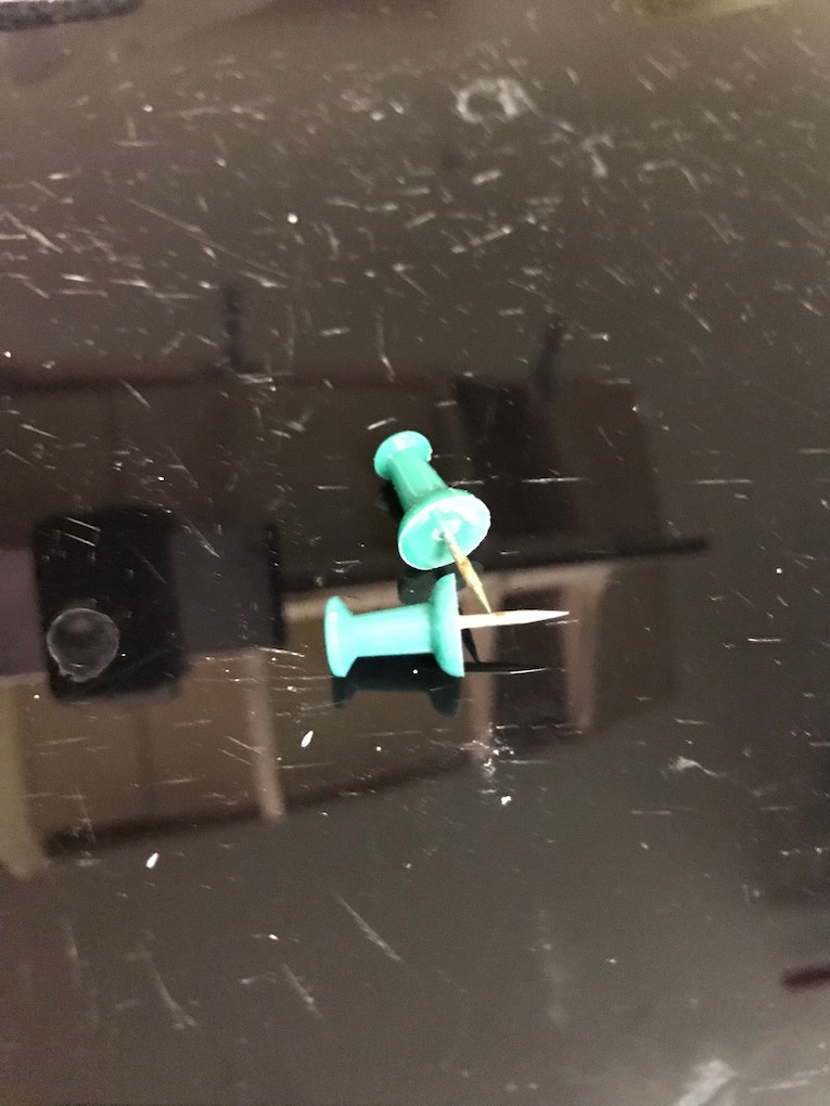

Map Pins (picture 7 and 8)
These have a shorter wider shank than plan pins.
Advantages are that they are easier to push in than plan pins, the lip of the plastic handle can be used to keep the plank against the rib whilst butting up the plank. They are cheap and easily available.
Disadvantages are that the thicker shank can cause ply ribs to split. They can be less affective on curves.

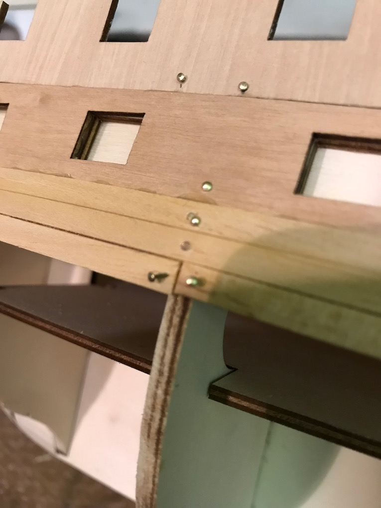

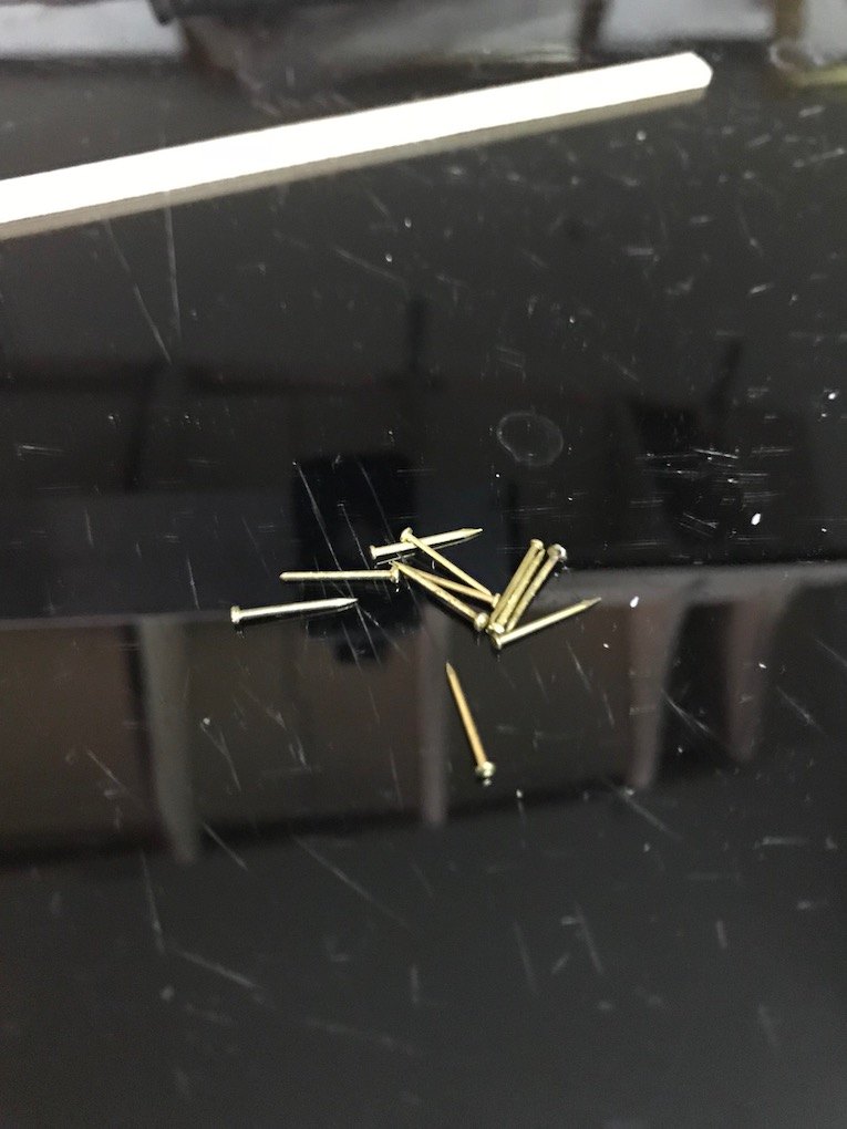

Brass nails(picture 9 and 10)
These are often supplied with the kit and very cheap to buy. Designed to be nails through the plank into the rib.
Advantages are that they have a thin shank so they push through the plank easily. can be used through out the planking process. can either be removed or cut ff and filed down leaving evidence of the building method
Disadvantages are that they can split the ends of the planks if not carful and you may have to drip pilot holes in the planks to avoid this. They can be a bit fiddly and you need to purchase either a pin pusher or modellers hammer to drive them in place. leaves holes that need to be filled if removing them.
So in all honesty I use all of the above depending on the task and material they all have merit and I don't have a preference, but do tend to use nails most of the time using other methods if it works for the build.
let me know your thoughts do you agree or disagree with the above? do you have a different solution?
