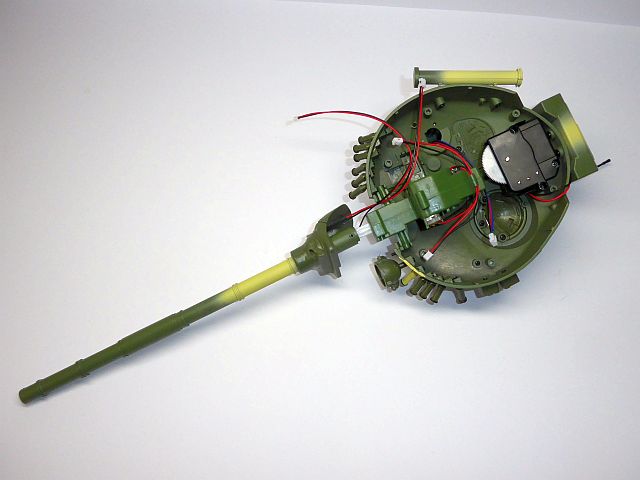

PACK 8

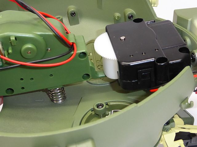

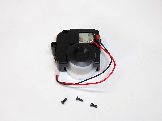

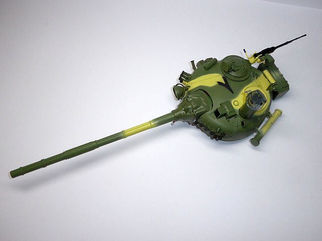

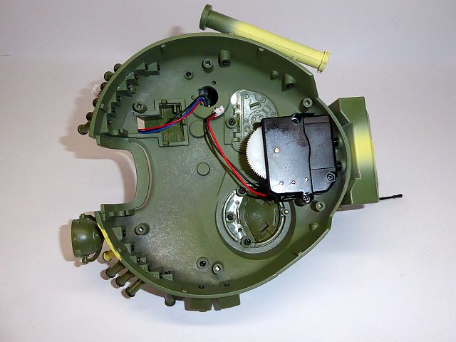

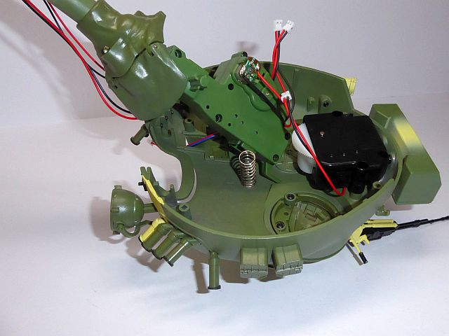

Stage 39

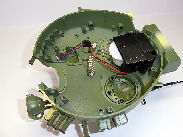

Contains: Gun Barrel Rotor, Screws

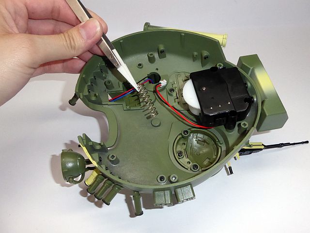

For this stage, you will need the gun barrel rotor, the turret, the gun barrel, the spring, and screws.

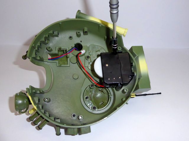

Align the holes in the side of the gun barrel rotor with the posts on the underside of the turret. Lower the rotor into place.
Insert the three screws received with this stage into the three holes in the rotor. Tighten the screw at the rear into place and then tighten the other two screws into place.
Place the spring over the raised circular projection in the centre of the turret.
Take the gun barrel and insert the tab at the rear of the recoil mechanism into the hole in the front of the rotor. The spring will hold the recoil mechanism away from the turret until it is fitted to the base. The two posts on the side of the mechanism will engage with the holes near the front of the turret.
This stage is now complete. Store the assembly and any remaining parts in a Stage labelled bag.

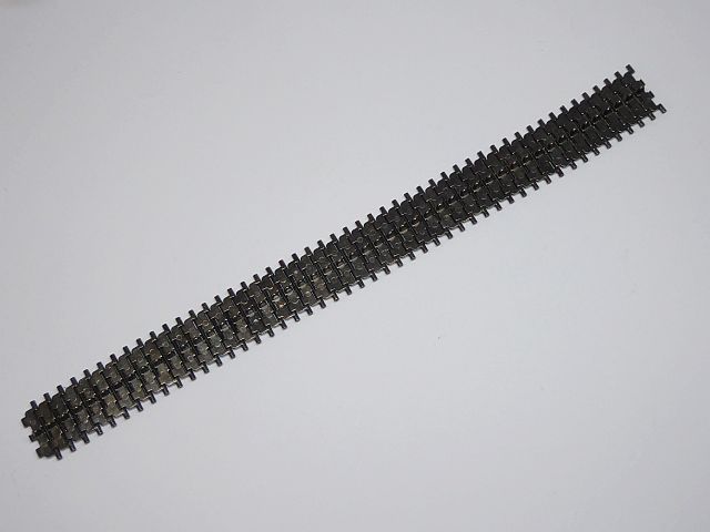

#2 Posted : 14 August 2017 16:21:09

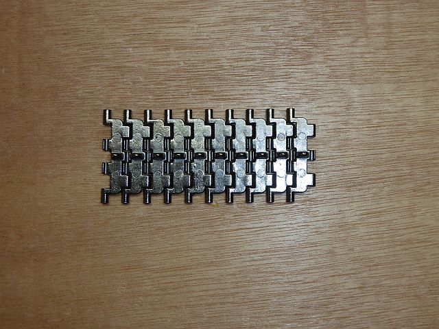

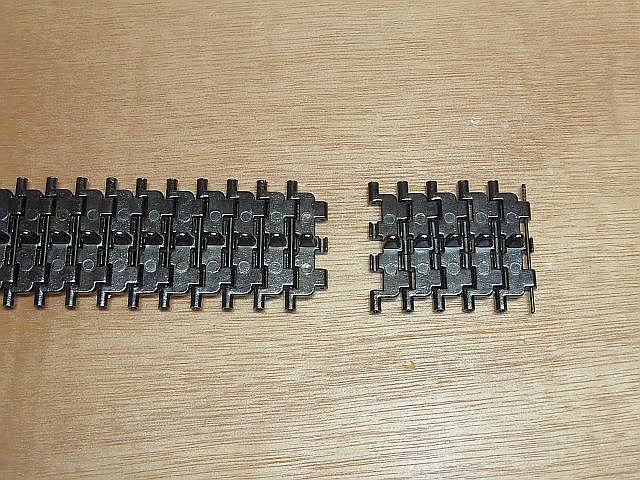

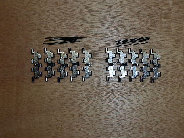

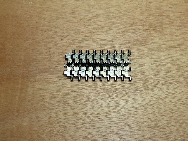

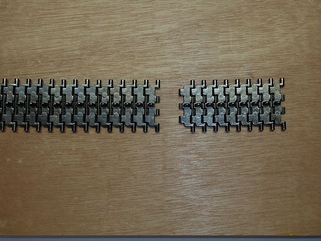

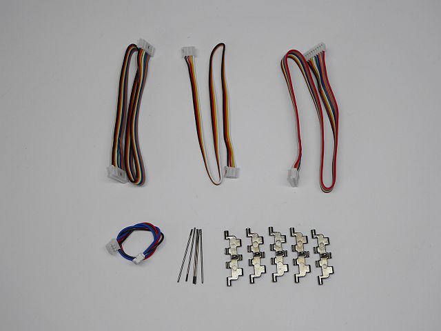

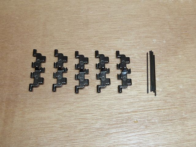

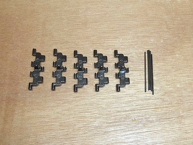

Stage 40

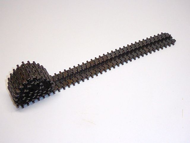

Contains: Cables, K, L, S and F, Treads, Pins

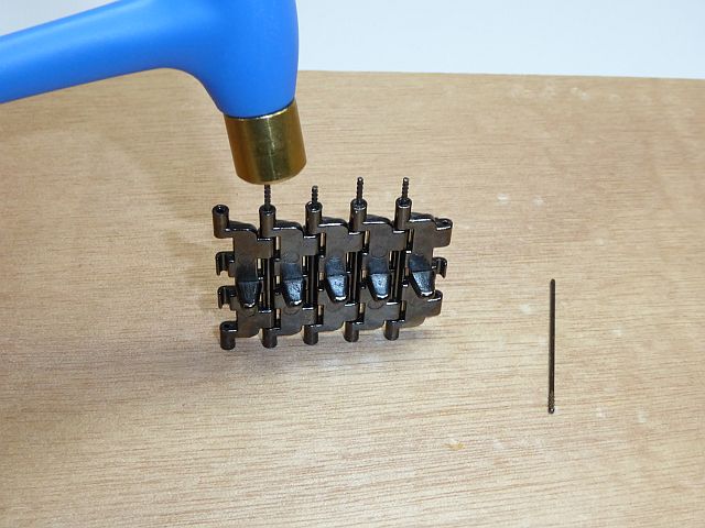

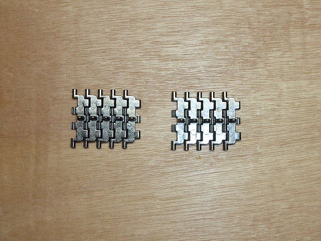

For this stage, you will need the new treads and pins, the track that you’ve already assembled, and a wooden board and hammer.
Combine two treads. Push a pin into the aligned holes of both treads. Placing the track on its side on the wooden board, hammer the pin into place.
Engage the next tread with the assembled pieces, and pass a pin through the holes. Place the track on its side, and hammer the pin into place.
Always remember to test that the pins are unobstructed in the tread holes. Fit the remaining pins and treads together. Hammer the remaining pins into the treads
Place the assembled sections together and join to the track section you’ve already assembled with a pin.

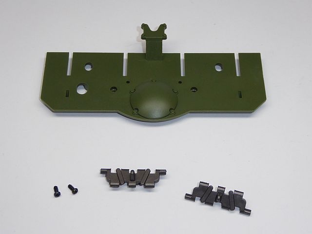

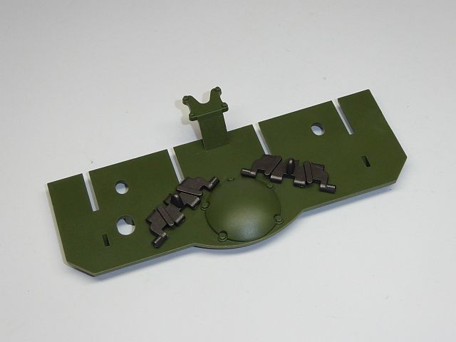

Stage 41
Contains: Rear Panel, Spare Treads, Screws, Pins, Treads, Log
For this stage, you will need the lower hull. the rear panel, the log, spare treads and screws.
The rear panel and the log will fit to the lower hull, which you will receive with Stage 60, so keep these parts to one side for the moment, and refer back to this stage when you fit them.
Place the two spare treads onto the outside of the rear panel. Tighten a screw into the hole to secure it in place. Tighten the second screw into the other hole to secure the second spare tread.
Insert the two posts on the panel into the corresponding holes in the rear of the lower hull. Push the posts into the holes. Tighten a screw into each of the holes to secure the panel to the lower hull.
Insert the two posts on the log into the holes in the rear panel. Tighten a screw into each of the two holes.

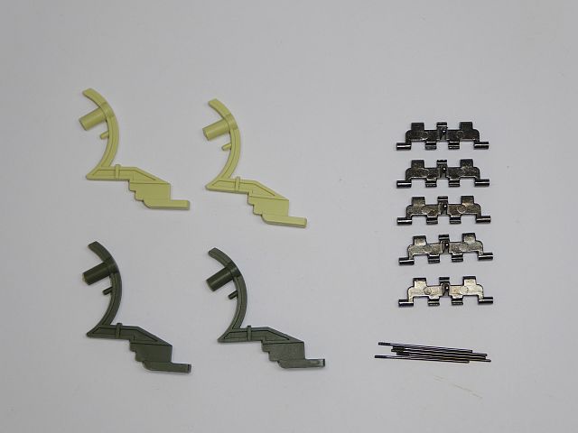

For this stage, you will need the brackets, the idler wheels and parts (from stages 5 and 27), and the lower hull.
The brackets and idler wheels will fit to the lower hull, which you will receive with Stage 60, so keep these parts to one side for the moment, and refer back to this stage when you fit them.
Take the two yellow brackets and fit them to the left of the rear of the lower hull. Fit the two green brackets into the right of the lower hull.
Place the bearing from one of the idler wheels onto the axle at the front of the hull. Insert the bolt into the centre of the idler wheel. Test-fit the washer on the bolt.
Pass the bolt through the bearing, and place the washer onto the end of it. Then place the split washer onto the end of the bolt. Tighten the nut, by hand, onto the end of the bolt. Holding the nut with one hand, tighten the bolt with a screwdriver.
Place the hub cap into the hole in the wheel.
Repeat these steps for the idler wheel on the other side of the lower hull.

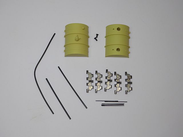

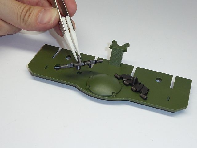

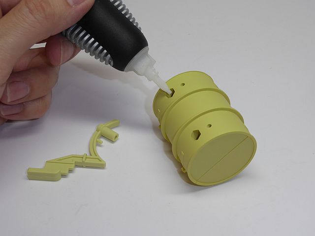

#5 Posted : 14 August 2017 16:26:25

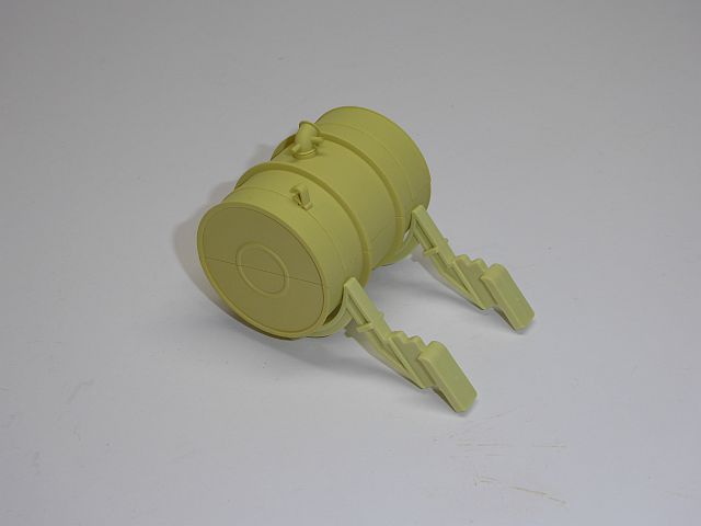

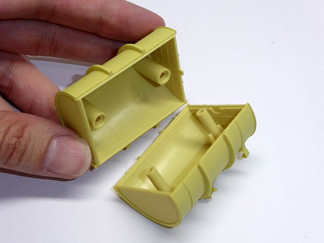

Stage 43
Contains: External Fuel Drum Lower Half, External Fuel Drum Upper Half, Screws, Fuel Lines, Pins, Treads
For this stage, you will need the two halves of the external fuel drum, screws, the lower hull, your assembled track, and the new pins and treads.
The brackets and drums will fit to the lower hull, which you will receive with Stage 60, so keep these parts to one side for the moment, and refer back to this stage when you fit them.

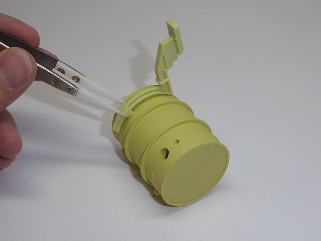

Fit the two halves of the fuel drum together. Holding the halves of the drum in place, insert a screw into each of the large holes. Tighten the two screws into place to secure the two halves of the drum.
Remove the brackets from the hull, and glue them onto the drum, then refit the brackets to the hull.
Engage the new treads, and push a pin into the aligned holes to check that they’re clear.
Place a pin through each of the treads and lightly hammer into place. Then turn the track on its side and hammer the pins fully into the holes. Connect the new section of track to the existing one.

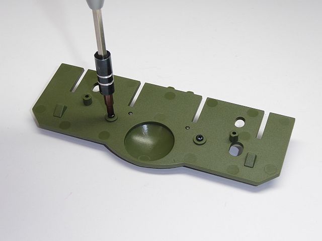

#6 Posted : 14 August 2017 16:28:01
Stage 44

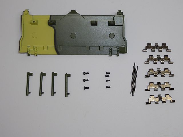

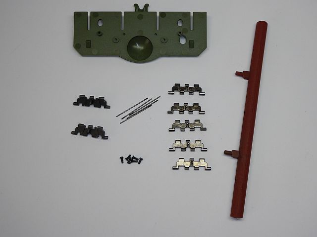

Contains: Lower Front Panel, Mounting Posts, Screws, Treads, Pins
For this stage, you will need all the parts supplied, plus the lower hull, and your track assembly.
The lower front panel and mounting posts will fit to the lower hull, which you will receive with Stage 60, so keep these parts to one side for the moment, and refer back to this stage when you fit them.
Insert the posts on the lower front panel into the corresponding holes in the lower hull. Turn the lower hull over and insert a screw into each of the three holes. Begin tightening the screws, holding the panel in place against the lower hull.
Insert one of the mounting posts into the corresponding holes in the hull and front panel. Fit the other three mounting posts into position on the hull and front panel. Carefully secure the mounting posts to the lower hull with four screws.
Combine the new treads, and insert the pins into the aligned holes. Connect the new tread assembly section to the existing track. Place the track on its side and hammer all the pins into place.
