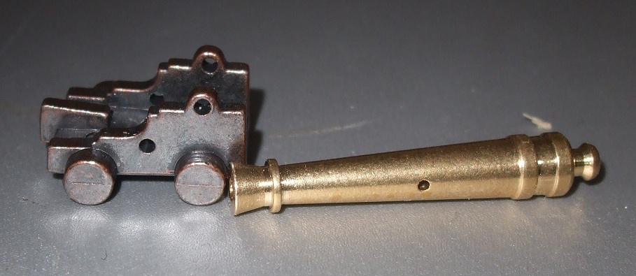

How do you learned ship builders find the quality of my gun carriage ? pic attached.
cheers Catman (Peter)
catman275 attached the following image(s):
completed..... Endeavour Longboat, San Francisco 2, Virginia 1819
building Royal Caroline
#4 Posted : 25 May 2011 23:47:56
Have a look at my build after a little bit of work they look acceptable..
My Cannons
Chris..

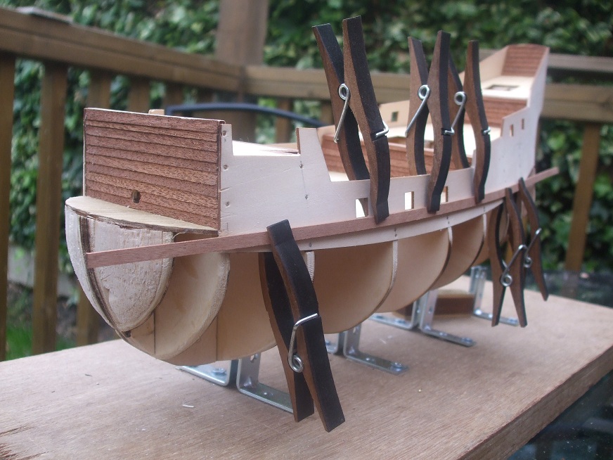

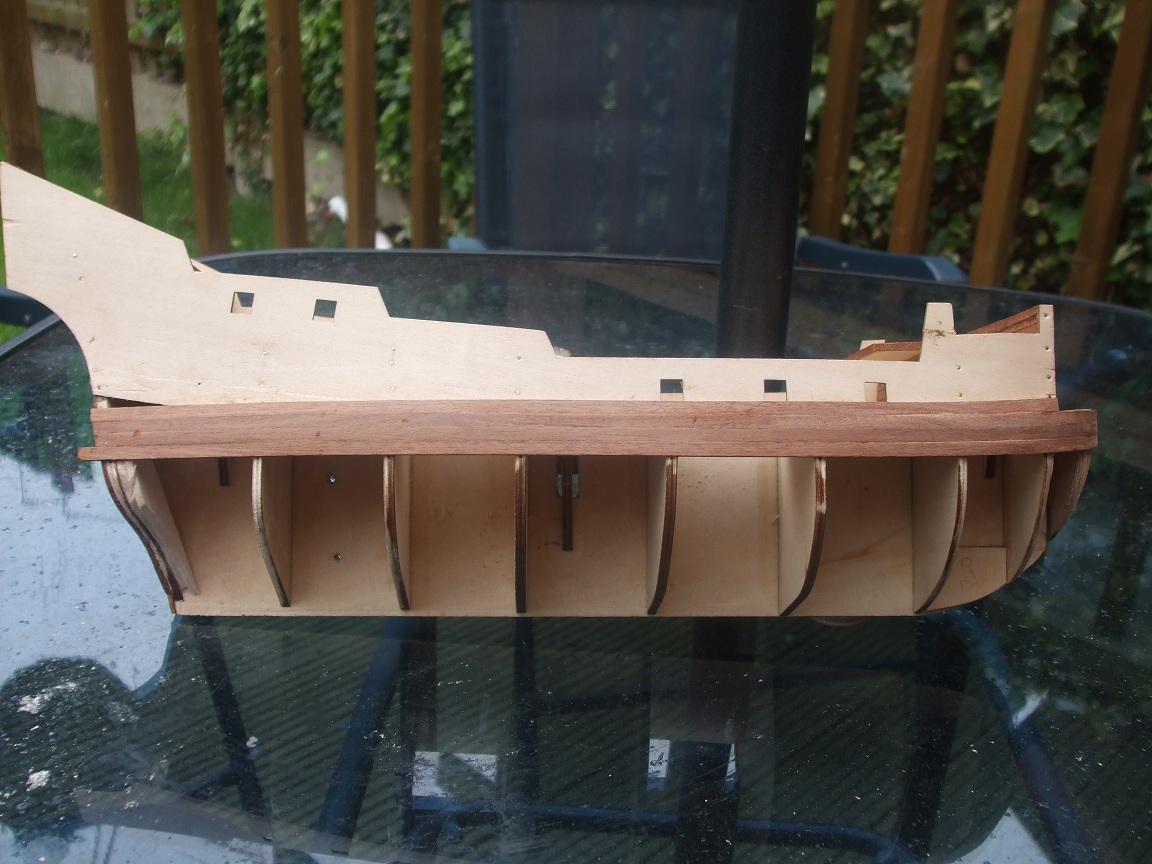

Hi Swabbies,
I have fitted the bulwarks and apart from being about a milimetre out on one side it seems ok.
For Magpie.... In one of your early pics it looks as if you have followed the shape of the bulwarks when fitting your first plank. This means curving it.
Were there any problems you found in doing this?
In my attached pics I have clamped a plank running level under the gunports following the shape of the hull without any bending.
I did want to try and follow this procedure on planking
http://modelshipworld.com/phpBB2/hpteleven.php
Following the shape of the Bulwarks and working upwards with the planking seems to give a better look towards the uppper stern of the ship.
Any thoughts anyone?
Cheers Peter

I have seen other examples of the San Fran 2 hull planking following the line of the bulwarks and I think that direction is the way to follow.
If I have problems then I can always come back here knuckling my forehead asking for help.
cheers Peter

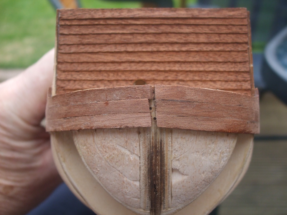

#9 Posted : 02 June 2011 23:52:54
Joined: 22/06/2010
Posts: 179
Points: 428
Location: Poole Dorset
Hi Saintsman,
I started fitting the first planks (3 each side) following the shape of the bulwarks.
I liked the look of it but I could see that I could have problems further down the hull. So I unglued about a third of the length of planks from the stern and leveled them off.
I'll put some pictures up at the weekend when I get some time.
cheers Peter

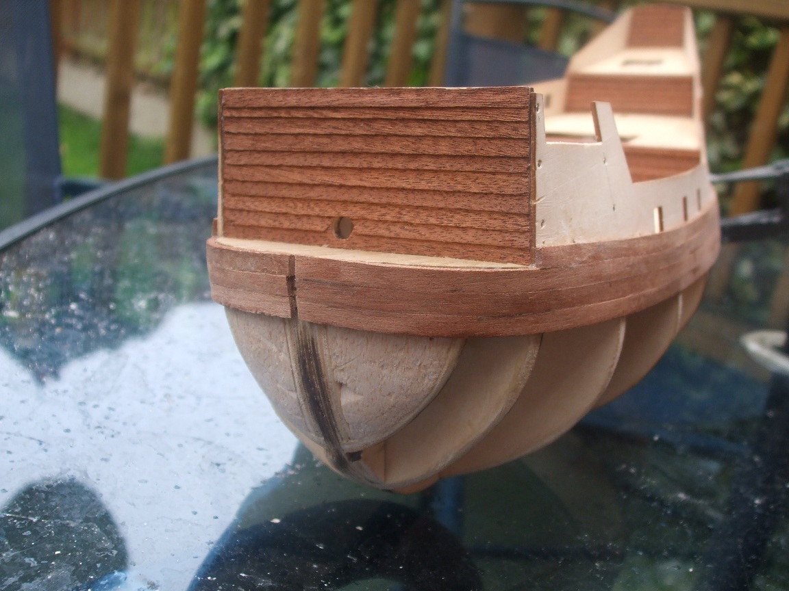

Hi again crew,

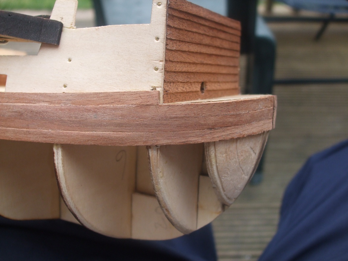

I am putting up my latest pics of the San Fran 2.
I originaly started planking following the shape of the bulwarks but after fitting a couple of planks it was obvious that it was not suitable even though it had a good shape.
I am going to try not to use any pins in the build. It will take longer this way but hopefully will look better.

#13 Posted : 14 June 2011 19:45:38
Hi Catman,
Sorry just missed the question you made earlier, Yes you did the right thing following the curve of the ply as it works out when you go upwards toward the deck area.
Your build is moving along nicely, keep it up Cool
Chris.

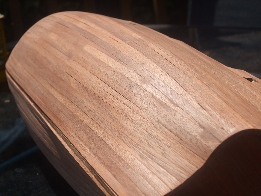

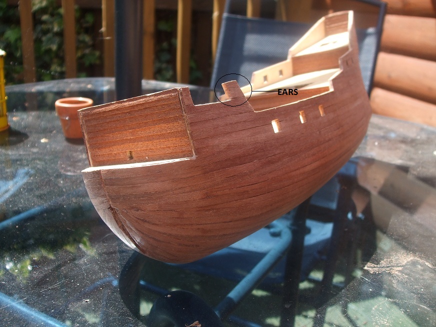

#14 Posted : 27 June 2011 14:23:33
Joined: 22/06/2010
Posts: 179
Points: 428

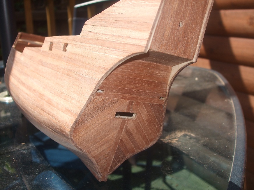

Hi All,
I hope you are all enjoying the weather.
I've got to the stage where I have been sanding down the hull and am also using a 3/4 inch wood chisel as a draw knife. It takes off high points in small shaves rather than fine dust.
As I did this, small gaps have appeared between a few of the planks. When fitting the planks I did bevel the edges so they were a tight fit together.
I wonder if it could be due to doing the planking in wet weather and the hot spell we have had which has taken any moisture out of the planks.
Another thing I noticed ( after planking) was the hardness of the planks, some planks were sanding down easier than others making it difficult to keep level.
I still have to make a cut out and fit the prow and cut out the gunports as well as some more filling ( glue and wood sandings ).
I did manage to break off the "ears" at the forecastle but managed to refit them by gluing a vertical splint on the outside and filing out the backs of the planks, all quite solid now.
I have a few pictures of the build also my working area including my sons gearbox for his Landrover which he has taken forever to do!
Cheers to all
Peter

#15 Posted : 27 June 2011 14:32:26
Good stuff Catman!!BigGrin ThumpUp
underhill
#16 Posted : 27 June 2011 15:44:11
Rank: Amateur Level 1
Joined: 06/03/2011
Posts: 34
Points: 98
Snap
I broke the same bits off, and found the wood very hard as well. I'm using new blades for almost every stage.
#17 Posted : 27 June 2011 15:57:19
Try useing a razor saw as well as a knife I find it works for me with this build.BigGrin LOL

#19 Posted : 27 June 2011 17:07:57
Joined: 30/01/2011
Posts: 865
Points: 2,410
Location: Cambs
I've been using saws, knives, axes, angle grinders, the odd chisel, but the Chinese meat cleaver worked best.BigGrin
The wood is hard, but that makes it more of an effort, and hopefully, as with most things, the greater the effort the greater the result.
Your looking good catman, I'm at roughly the same stage, just lined the inner bulwarks, but instead of the Ramin wood, I had some walnut 0.6mm lying around, so chose to go with that. I've got some pics so will update my diary soon.
Oh, tbe "ears" came off of mine as well, the inner lining has helped support them a bit, but I think the outer supports will help a great deal once I get to that stage.
Come on you Jimmies
#20 Posted : 27 June 2011 17:13:36
Looking good the Catman. Nice planking.
The ears snapped on mone too. Lol. Common problem.
