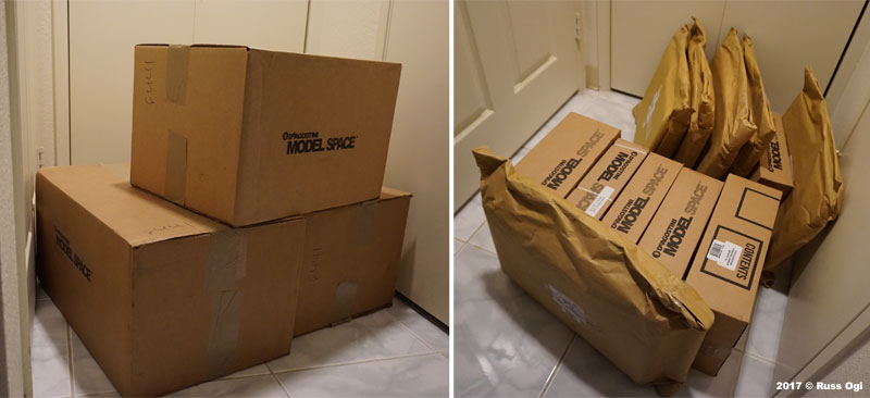

I ordered the entire kit rather than a part-work subscription. So if you're wondering what it looks like when the entire kit arrives in one shot, here it is.

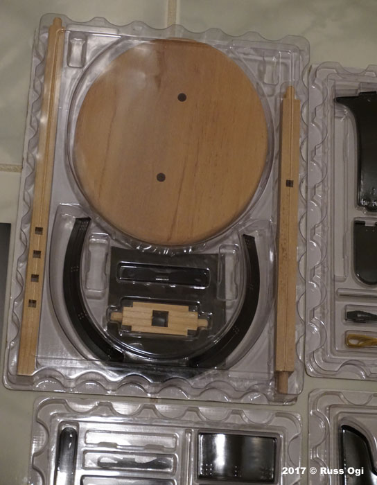

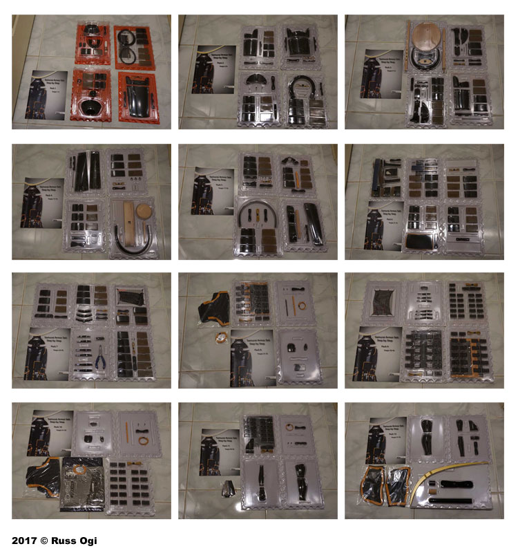

Inside each of the big boxes are smaller packages each containing one pack. 12 packs in all. Each pack encompasses several steps. 55 steps for the entire project. Each pack comes with a full color instruction booklet and each of the steps are packaged in their own blister pack sealed with a cardboard backing.
Here is a detailed look at each of the 12 packs. For reference, each floor tile is almost 39.5cm or about 15.5" square.
I've included a higher res gallery on my blog here
ZetaForge attached the following image(s):

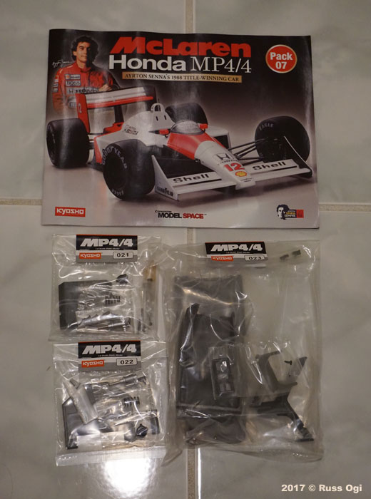

Date Masamune used some of the best technology available in the design of his armor. This includes parts from a McLaren Honda MP4/4!
Somehow this Pack 7 for the MP4/4 was mistakenly included in my kit in place of the Samurai armor Pack 7.
In addition to the incorrect Pack 7, the Yoroi bitsu (armor storage box) is missing. The yoroi bitsu serves as both storage container for the armor and as the base for the wooden display stand to sit.
I quickly contacted DeAgostini customer service and informed them of the errors.
The correct Pack 7 was dispatched at no charge to me. It did take about 2-3 weeks to make it to me but, being in Hawaii, you accept longer shipping times as part of the price of living in paradise.
Trying to get the storage box however is an on going issue. More on that later.

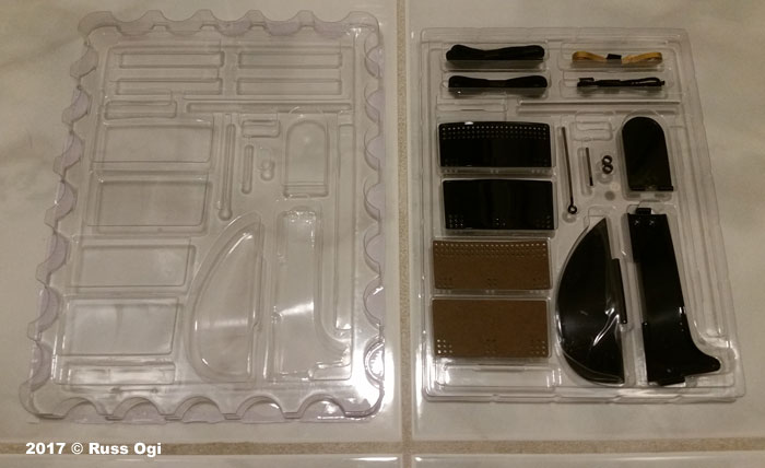

This is my first model from DeAgostini, and my first impression was set by the packaging. I was impressed. Each step comes in a blister pack with a snap-fit backing keeping the parts secure. Both arrive sealed with a cardboard backing. I was surprised at the weight of some of the parts.
The model itself is made of multiple materials including metal, wood, faux leather and multiple types of material. The kote (armored sleeves) are made of chain-mail. Half scale chain-mail, how cool is that!

I've been reviewing the instructions online and reading the build diaries of others here in the ModelSpace Forum to get an idea of what's ahead.
Since I have the entire kit, I am planning on building the armor in sections rather than following the steps in order. For example, lacing all the kusazuri (tassets) sections at the same time. I find when I work, it's much easier, and more enjoyable, to tackle similar tasks together.
But building out of order presented the problem of keeping parts from getting lost and keeping them organized. There are a lot of parts and many of them are much smaller than they look in the instructions.
Fortunately, I found that the packaging is durable enough to be opened and closed several times.
Both top and bottom are contoured to keep the parts in place and snapped together at several points keeping top and bottom securely closed.
This allows me to use them as storage containers making the parts accessible while keeping them organized.
I'll be following up shortly with another post as I start the build.

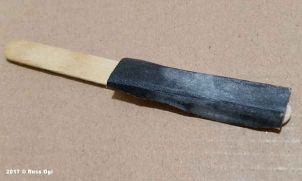

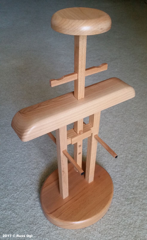

I decided to start with the wooden stand. Looking at the instructions, it seemed fairly straight forward. Also, I would be able to keep some of the partially built armor sections on it as I progressed with the build.
The instructions indicate the pegs (clothespins) may need sanding. As I got started, I found all the holes, round and square, needed adjusting. Instead of sanding the clothespins, I used a 5/16” drill bit to widen the holes. Once drilled, the clothespins fit easily while remaining tight enough to keep the stand together without adhesives.
I used a Popsicle stick wrapped with sandpaper as a sanding block to clean out and adjust the square holes. For smaller areas I used a jeweler's file.

#12 Posted : 13 August 2017 08:47:26
Joined: 10/05/2017
Posts: 78
Points: 240
Location: Honolulu

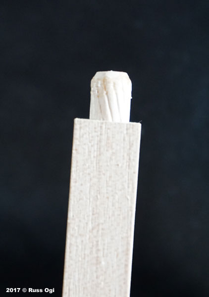

The top peg to the kabuto (helmet) platform had the opposite problem. It was very loose. I applied some super glue gel to the clothespin to add some mass to it. I left the platform off and let the glue dry overnight. The kabuto platform now fits snugly.
ZetaForge
#13 Posted : 13 August 2017 08:49:16
Joined: 10/05/2017
Posts: 78
Points: 240
Location: Honolulu
The hole for the menpo (facemask) cross arm was too tight. I worked on that for a good half hour or more going back and forth sanding the piece and clearing out the hole.
In the end, I managed to get the entire stand assembled without having to glue it together.
ZetaForge
#14 Posted : 13 August 2017 08:50:30
Joined: 10/05/2017
Posts: 78
Points: 240
Location: Honolulu

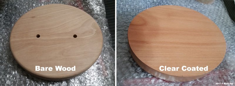

When I display the armor, I plan to use a drape over the stand, so finishing really wasn't necessary. However, I decided to clear coat the wood stand primarily to protect it from moisture. Honolulu has relatively high humidity.
I added small felt pieces to the ends of the crossbars to prevent the wood from scraping against the inside of the do (torso) armor.

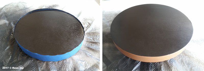

#20 Posted : 16 August 2017 05:34:59
Joined: 10/05/2017
Posts: 78
Points: 240
Location: Honolulu
Gandale, Metal Mech, thank you for following my build.
I've added a blog entry with some thoughts on stand designs here.
I decided on another little addition to the stand.
The foot of the stand was pretty smooth after the final layer of clear coat but I decided to add a rubber coating to it.
I used black Plasti Dip Spray. I've used it for years to create a protective layer between parts to prevent paint rub. In this case, I thought it would provide a good non slip foot for the wood stand.
If you haven't used this product before it goes on a little thicker than spray paint and dries into a rubber coating.
I masked off the sides of the base. The trick is to remove the tape just as the Plasti Dip begins to dry - it starts to go from a gloss black to a matte black.
Letting it completely cure before removing the tape, especially with a heavier layer, can pull the rubber off the part leaving ratty edges.
