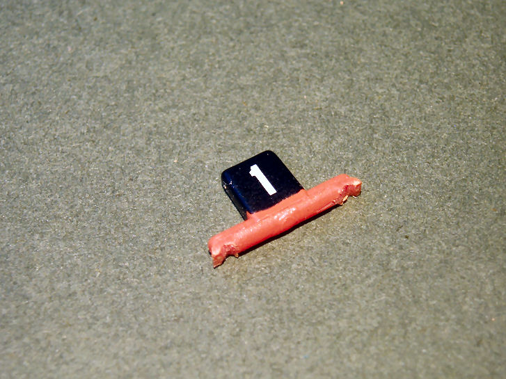

ELEVATOR CAR 1

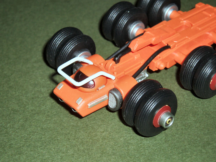

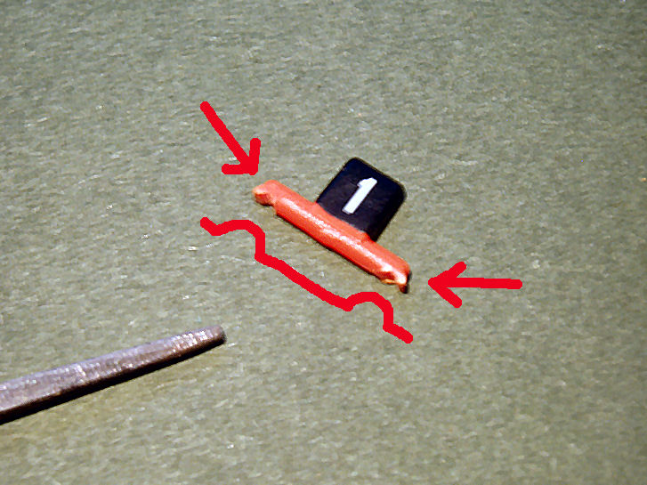

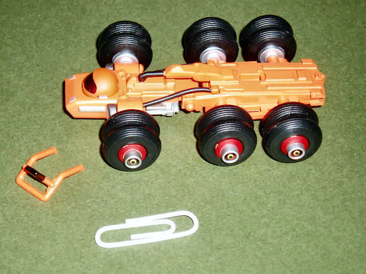

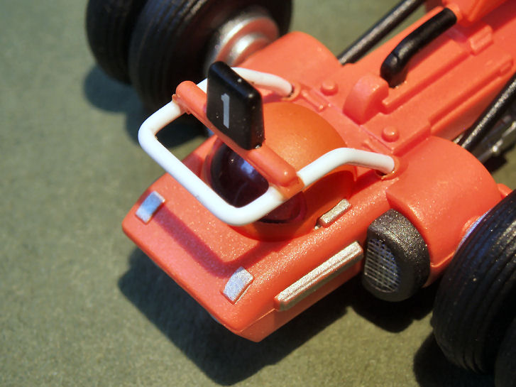

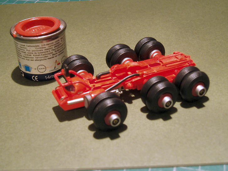

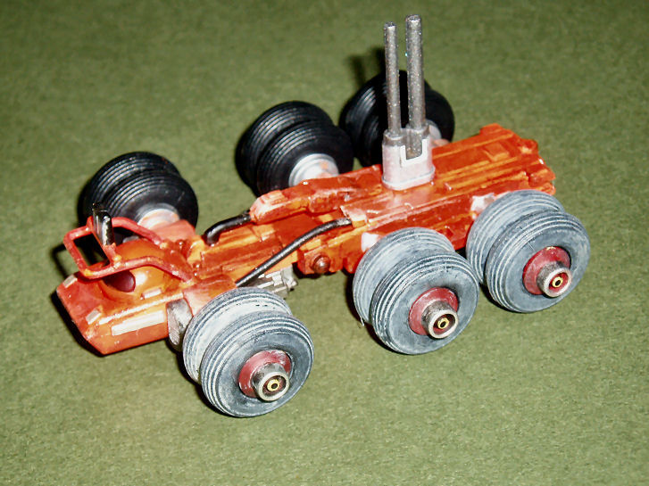

The elevator car is assembled piece at a time as per the instructions but the roll bar over the cab is a bit too thick. This can be remade using a plastic covered paper clip.
Using the kit part as a template cut and bend a piece of paperclip to the same shape. Pictures 1, 2 and 3.

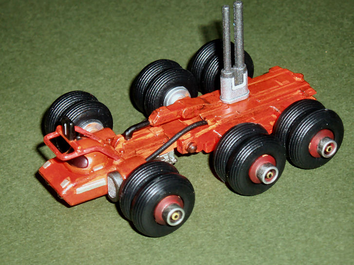

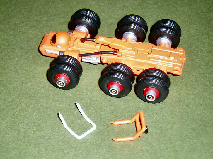

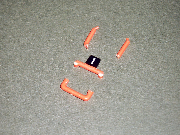

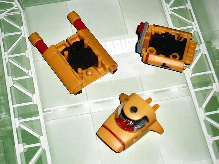

The cross-piece from the kit part should be carefully cut off and two small curves filed into the underside as shown in pictures 4, 5 and 6.
Using cyano adhesive, glue the new roll cage into the holes in the body. A paper clip fits perfectly.
Glue the cross piece into place as shown in picture 7.

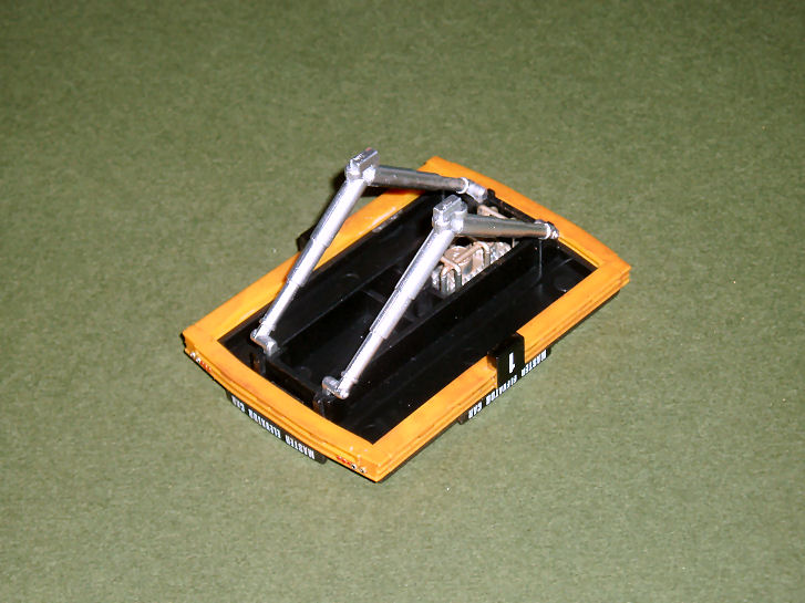

The platform legs have mould seams on them and these should be carefully sanded off – picture 8.

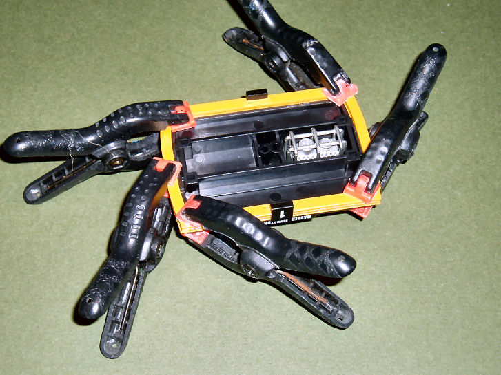

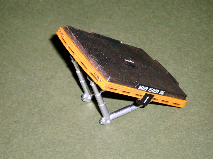

Assemble the platform using clamps to keep everything flat. The kit upper platform part may have a slight warp so the clamps are necessary here. Picture 9.

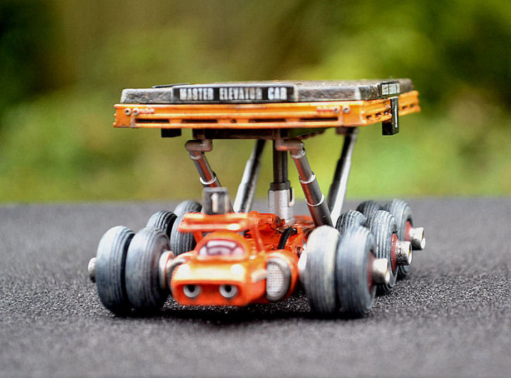

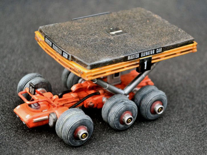

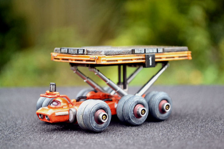

The entire model body can be repainted a satin/matt orange as the kit plastic isn’t quite the correct colour. The pictures make the finish look somewhat glossy but in reality, it is quite dull. Picture 10.

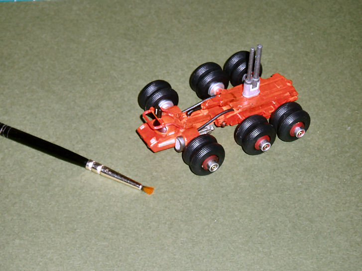

The platform can now be assembled after repainting the hydraulic legs silver.

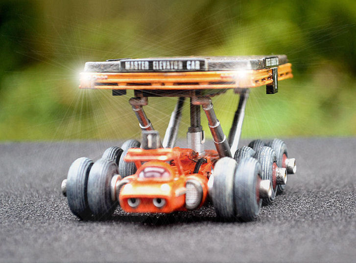

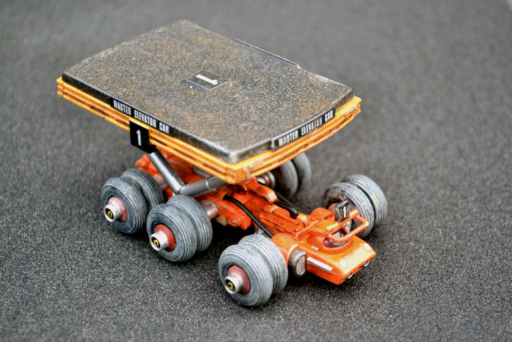

Weathering should now be added using a thin wash of matt earth and white spirit. Dab the platform with a paper towel to remove brush marks and leave a mottled effect on the surface.
Add further washes of matt sand and matt earth along the edges of the platform and frame. Pictures 11 and 12.
Use a cut down brush and lightly dry-brush a diluted matt black on the body. Think about where the vehicle would get the dirtiest, and also use the effect to highlight raised parts. Always brush from front to back on the model to represent how dirt would actually hit a fast moving vehicle. Do not brush anywhere from side to side.
If you overdo any black, remove it with a cotton bud dipped in white spirit.
Further weathering using light tan or sand colour can be added. Do not forget the platform frame, particularly at the front. Pictures 13 and 14.
The tyres should be painted using a light tan/sand colour, diluted with white spirit.
Brush well into the treads and sidewalls and remove the excess by ‘rolling’ the wheels in a paper towel. Picture 15.
Note that the rear axle parts next to the body should be painted silver – Picture 17.
The platform can now be fitted and any further detail painting or weathering added.
Pictures 16, 17, 18 and 19.
The weathering may look quite overdone in the pictures – an unfortunate effect of close up photography of a small model. In fact, the weathering – particularly the tyres, is quite light.
However, if you look at any genuine pictures of the vehicles in Thunderbirds you will see that they are all extremely heavily weathered to make them look less like models.

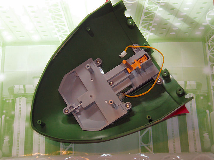

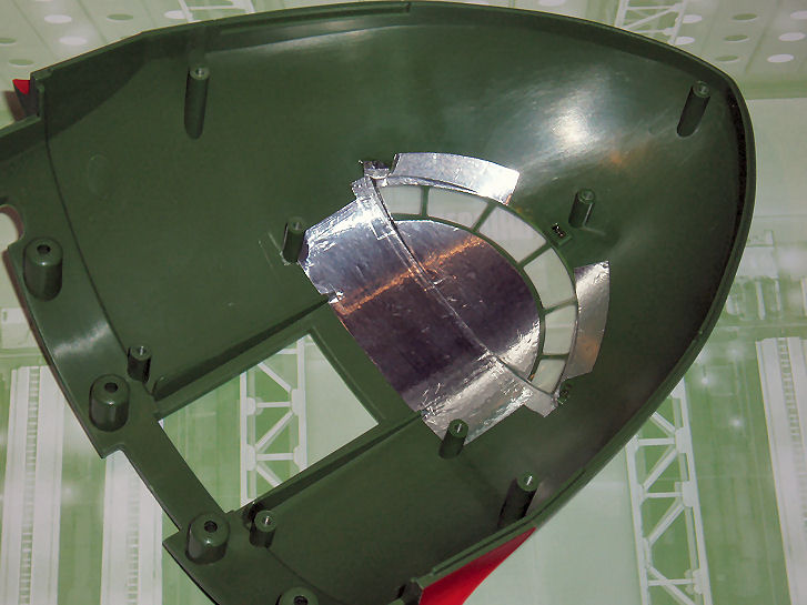

These parts can be assembled as per the instructions. There is no additional detail needed although to prevent any light seepage from the cockpit lighting through the canopy edges, adhesive aluminium tape can be cut and fitted around the joins as shown in picture 1.
If the canopy is to be left removable this is not necessary.
Fit the other internal parts as per the instructions. Picture 2.

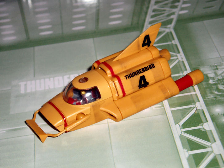

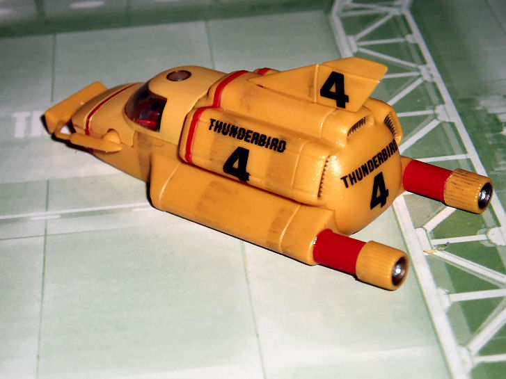

THUNDERBIRD 4
Assembly of Thunderbird 4 is very straightforward although it has been noted in some builds that the finished vehicle is quite light. This can be helped by filling the rear voids with plasticine before assembly as in picture 3.
Take care not to fill any locating holes.

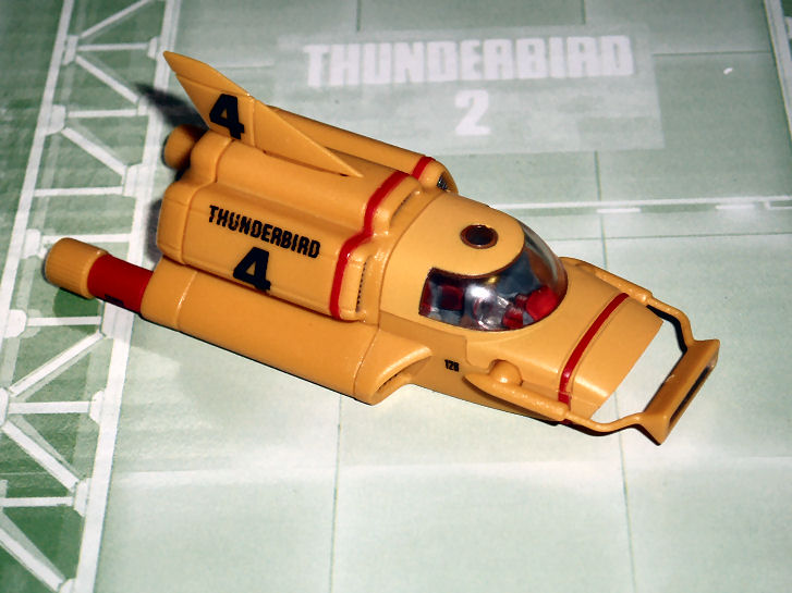

Thunderbird 4 can then be lightly weathered.
There are numerous pictures of TB4 on the web but many are models that are not part of the original TV series. Many of these models are heavily weathered which is actually silly as TB4 spent its working life under water! It would hardly become filthy.
If you look at genuine pictures from the TV series you will see that it is actually quite clean with only light shading on a few panels.
This can be achieved by using thin strips of masking tape fixed to the body IN FRONT of the planned shading.
Use a soft pencil and lightly ‘scribble’ a patch next to the tape. Try not to leave any hard lines.
With a cotton bud, gently smudge the pencil, dragging towards the rear of the craft.
Remove the tape and work on a different panel. Try not to go too far.
The pencil can be sealed with a matt spray – not brush.
In fact, if the model is handled carefully there is no need to seal the pencil.
The majority of weathering on the original studio props was done in this way.
