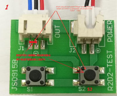

#4 Posted : 20 July 2017 11:50:57
Update
Neither the projector, nor the test board are faulty.
The projector will work properly and will project both video clips at the end when your R2-D2 is completed.
Our engineering department discovered that using the test board to control the projector to project both clips, can produce and inconsistent result when the battery level of the battery box starts to drop.
As a result, they have modified the programming on the IC of the projector just to project the “Luke” clip instead of both clips when tested at issue #29.

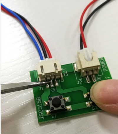

If you wish to 'test' the Leia projection, there is another way to do this by providing a direct connection between two points on the test board (shorting them) as shown in the photos copied below. Please accept our apologies for the confusion.

I had no Leia on my test, but then when I shorted the two pins (not an easy task), I DID get the Leia graphic. So it does work BigGrin

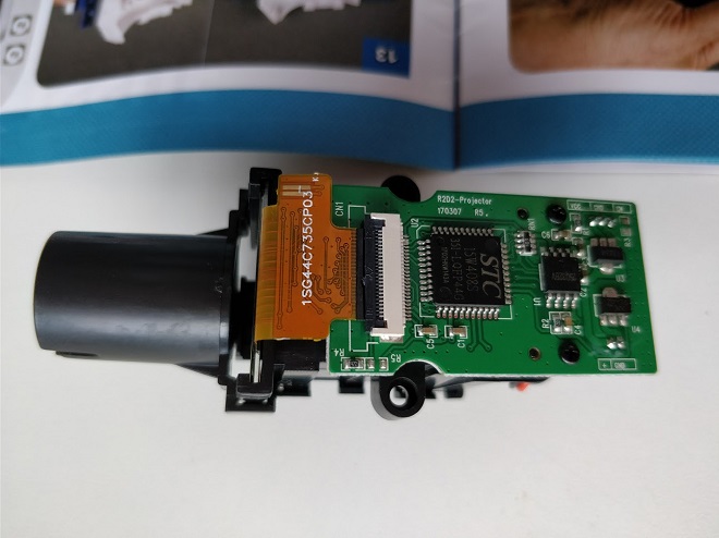

I don't see any image either, just a pixellated circle of light. I've tried new batteries in the battery box but that hasn't made any difference. Maybe a faulty projector board?

Anyone that is experiencing a pixelated circle and no images, this problem is most likely caused by a loose connection of the LCD cable to the projector PCB and you need to reconnect the cable as follows:
Unplug the connector for the LED cable as indicated in the photo below and reconnect the cable and black part of the connector should be closed down to clamp the cable in position.
If the problem is caused by a loose connection or the connector is not properly seated, this should fix the problem. If this does not fix the problem, most likely that the LCD is damaged and needs to be replaced, therefore contact c/s to request replacement of the issue it is supplied in.
Sometimes the ribbon maybe misaligned and needs pushing in further, lifting the block clamp to insert the ribbon more and clamping it down will align the contact and should then work ok. These are relatively fragile components and can be damaged if not been handled carefully.

There is a work around, which will allow you to project the “Leia” clip by providing a direct connection between two points on the test board (ie shorting them).
