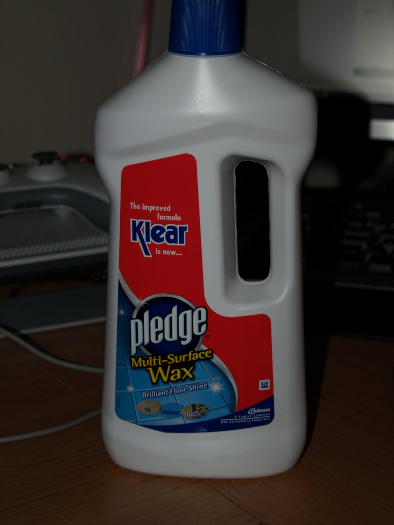

For those of you that have been building kits for a long time and have used "Johnsons Klear" and upset that they discontinued it well ITS BACK BigGrin You can now get it from Asda's and other well known Super Markets Labeled under "Pledge Multi Surface Wax"

Says its an 'improved formula', question is, is it just as good as old or even better?

To be honest Mr T I see no difference to the old stuff which is a good sign..
Loony... its used as a clear coat for protecting paint but is also used on aircraft canopies by some modelers to give it an extra shine and remove any slight scratches etc.
Its also used as a first coat before Decals are applied so to allow the decal to adhere better then another coat to give the decal protection. Imagine its like a gloss finish but because its water based it will not attack the silver paint on the MP4-23 if you wanted to give it a coat or two. I have used Alclad2 Silver Chrome and it needs a clear coat to protect the paint otherwise the silver will come away after constant handling. Its also best apllied with an airbrush but can be wiped on with a lint free cloth. Its milky in colour when in liquid form but dries quickly and clear once dry.

BTW...... I have used the 'new' klear, and it's no different.
