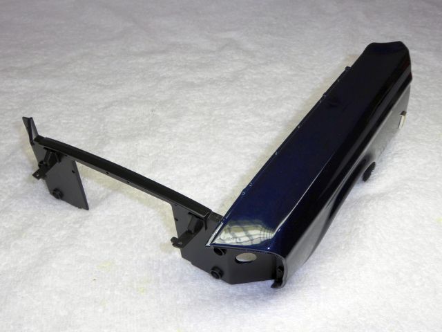

#1 Posted : 06 July 2017 16:04:06
Issue 81

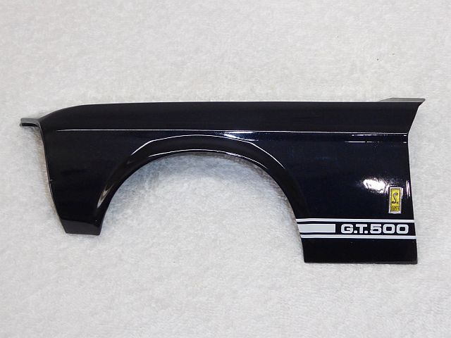

Left Front Wing
Parts content:
Left Front Fender
Although the left front wing should not be fitted yet, you should take the opportunity to test-fit it. The two posts on the wing engage with the two posts on the chassis
Issue complete, carefully store any remaining parts in an issue labelled bag.

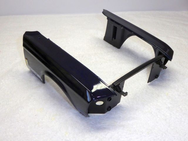

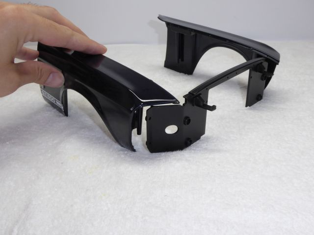

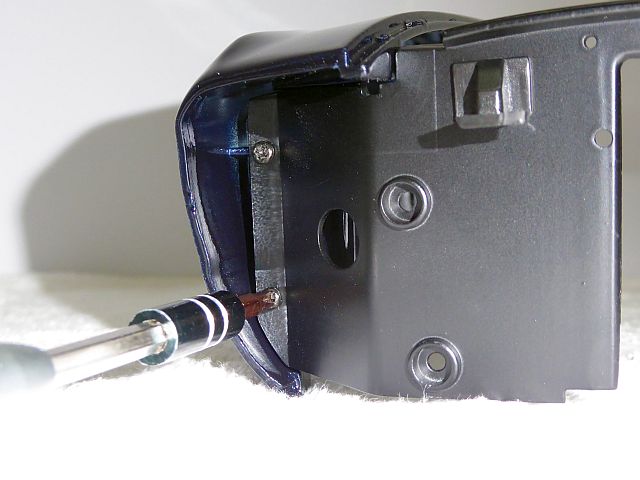

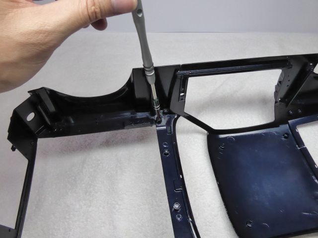

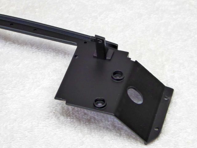

#2 Posted : 06 July 2017 16:07:50

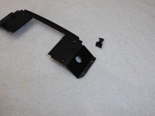

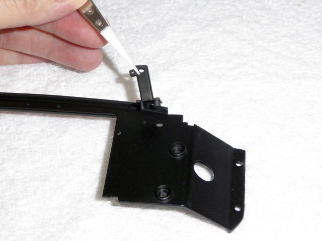

Issue 82

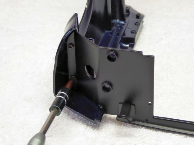

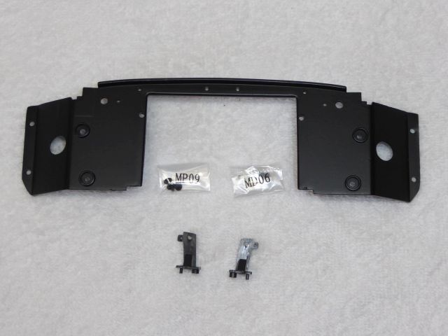

Chassis Front Panel
Parts content:
Chassis Front Panel
Left Hood Bracket
1.8x3mm screws
Right Hood Bracket
2.3x4mm screws
Align the post on the left hood bracket with the hole in the chassis front panel. Insert the post into the hole. Turn the panel over and secure with a 1.8 x 3mm screw into the hole.
Insert the right hood bracket into the hole at the other end of the chassis front panel. As before, hold the bracket in position and secure it with a second 1.8 x 3mm screw.
Now retrieve the left front wing from Issue 81. Place the two holes in the chassis front panel onto the two posts in the wing. Fix the two parts together with two 2.3 x 4mm screws.

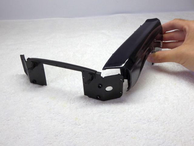

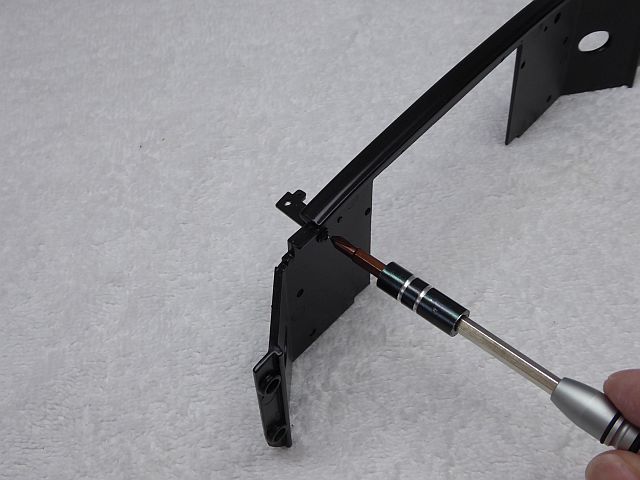

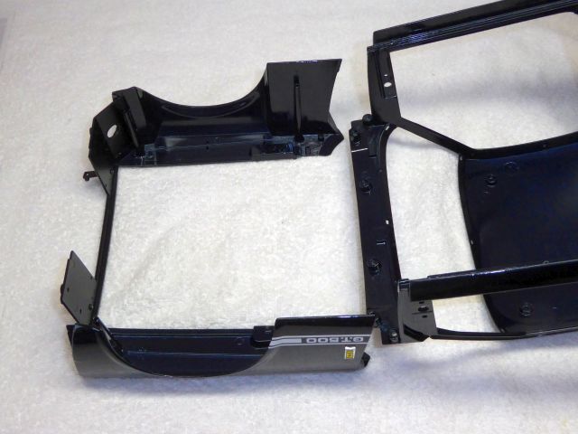

#3 Posted : 06 July 2017 16:09:40
Issue 83
Right Front Wing
Parts content:
Chassis Front Panel
2.3x4mm screws

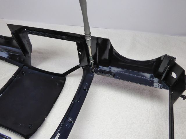

Align the posts at the front of the wing with the holes in the right side of the front chassis panel from the previous Issue.
Secure the parts with two 2.3 x 4mm screws.
Handle the assembly with care so as not to damage it.

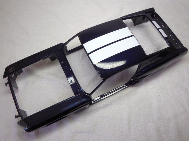

#4 Posted : 06 July 2017 16:12:05
Issue 84

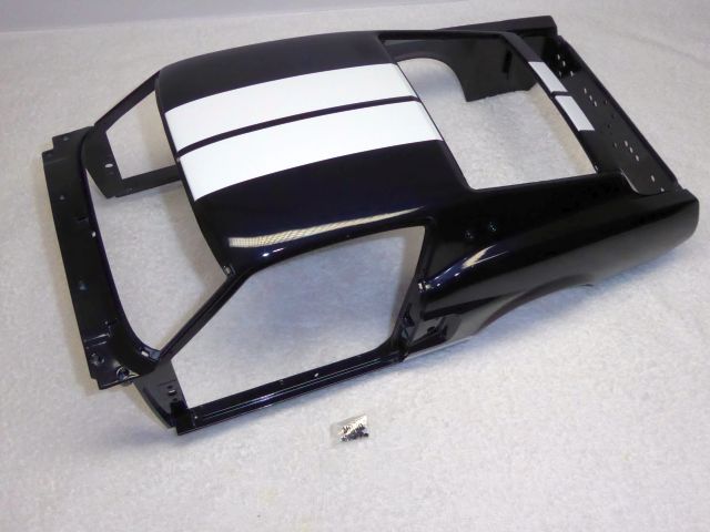

Body
Parts content:
Body
2.3x4mm screws
To avoid damaging the paintwork on any of the body parts, you should work on a soft surface, like a cloth. The posts on the inside of the front wings will engage with the corresponding holes in the front of the body.
Align the rear of the front end assembly (the wings) with the front of the body.
Lower the posts on the underside of the wings into the corresponding holes in the body.
Hold the parts together and turn them over so you can access the underside. Tighten one 2.3 x 4mm screw into one of the holes. Tighten the second 2.3 x 4mm screw into the same hole on the other side.
Tighten another two 2.3 x 4mm screws into the two remaining holes, next to the first two.
Once the parts are secure, there should be a small gap between the the bottom of the wing and the doorpost.
