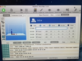

I have built the idBox and set up repetier Host.
The one thing that does not seem to be correct is when i press the z Home button the z reading is zero but in the instructions it says it should read 100.
Can anyone help me with this?
Thanks
Paul

The pack is number 11 and under the title "apply greace to the lead screw and set the z axis home position"
Eventually it says press the home button - the z axis coordinate will show z = 100 and change from red to black numbers.
Ours changes to zero in black not the 100 it apparently should read.
There is a z axis closeup that says "the z axis coordinate is at z=0 when the table is at the highest point (when the nozzle and table are closest together.)
I hope this is enough info for you.
Thanks
Paul
gugenheim attached the following image(s):
#4 Posted : 28 June 2017 19:39:10
Hi
First check the table is fully lowered and that the limit switch is secured correctly so the dog is in its correct position. Then reset the table to its start position and rerun the test this should cure the problem as I suspect the limit switch is not finding the table position properly.
