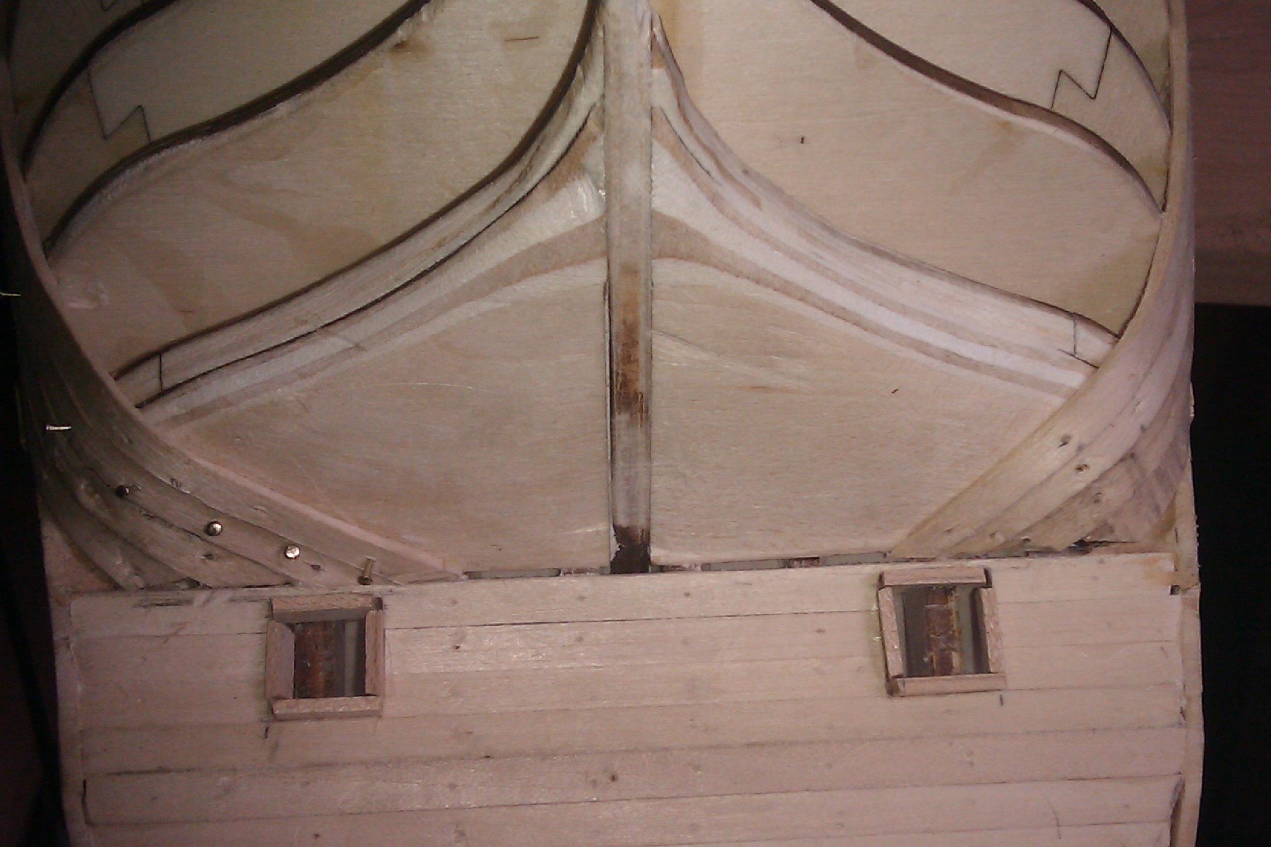

hi everyone
could someone please advise me on this issue ive come across ive got the 1st 4 rows of planks done but already theres quite a big gap between each sides & the center of the ship both sets of planks are the same thinkness

Location: Loughborough
Dont worry about this to much, the best way i found was to tapper the planks on one side in a gradual fashion so that the planking ends up to be the same amount of planking for each side.
If you have any problems have a look at past posts and im sure there is information regarding this common problem.
Keep up the good work.

Hi cal!Cool
This link might help you, it explains the stern planking from my build dairy.
http://forum.model-space...posts&t=1060&p=6

cheers petpole & darron looking at the diagram looks like ive not taperd the planks enough so looking like ill have to lock myself away my next day off remove them & start again
thx again calBigGrin

Hi Cal,
It looks pretty good to me. You are only about 1 plank different and you can correct this as you go by tapering a little more on the wide side and it will not be noticeable when all the others are fitted.BigGrin
