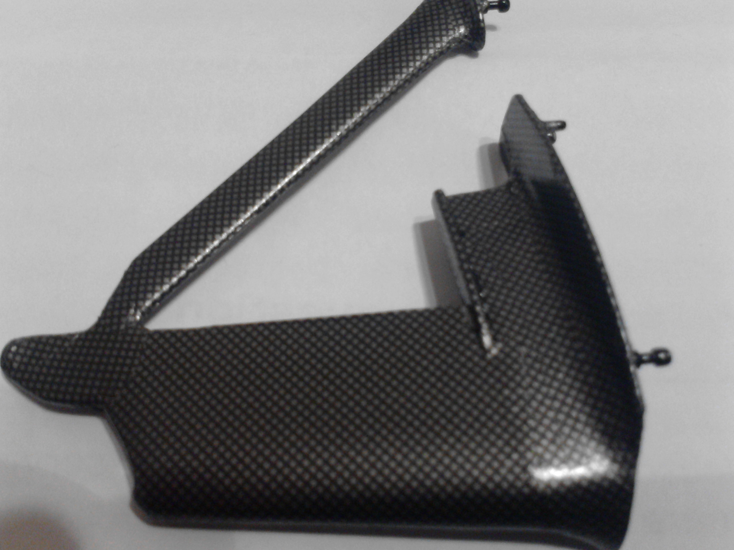

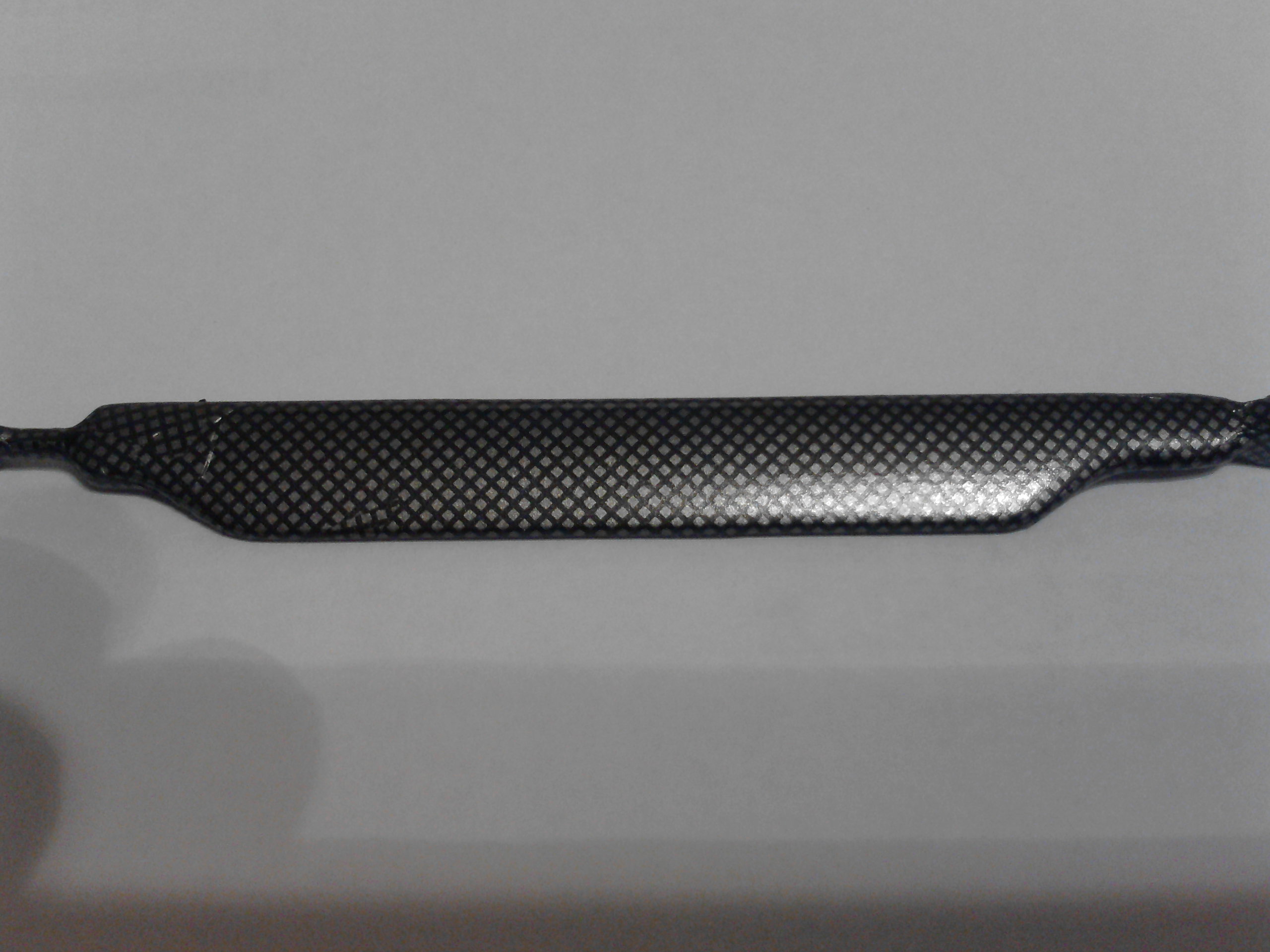

Hi all, received issues 3 & 4 this week so had a god at putting carbon on to the top suspension arm & push-rod. What do you think ? I did the top susp, in two sections..OhMyGod what a jod 3 hrs and 1 full sheet later done better order some more i'm going to need it BigGrin
The carbon i have use is Scale Motorsport 1/12 scale plain weave and i will be using a different one studio 27 for the wings

Done a great job there glen but a whole sheet!!!! ok i'm guessing some mistakes on the way?? lol one good tip is to give them a coat of halfords clear Lacquer or if you want to try it Tamiya clear smoke.
Yes these are waterslide Decals Timson72
glen2011
#4 Posted : 08 May 2011 01:03:30
Rank: Beginner Level 3
Joined: 25/03/2011
Posts: 22
Points: 56
Location: Sheffield uk
Hi, Thanks Spencer, first time trying this, well not quite a full sheet and yep i made some mistakes BigGrin. Tried to do it all in one go but a to complicated shape, then did it a again and still weren't happy so ended up doing it in two sections, i'm going to clear lacquer all my carbon parts. clear smoke sounds interesting

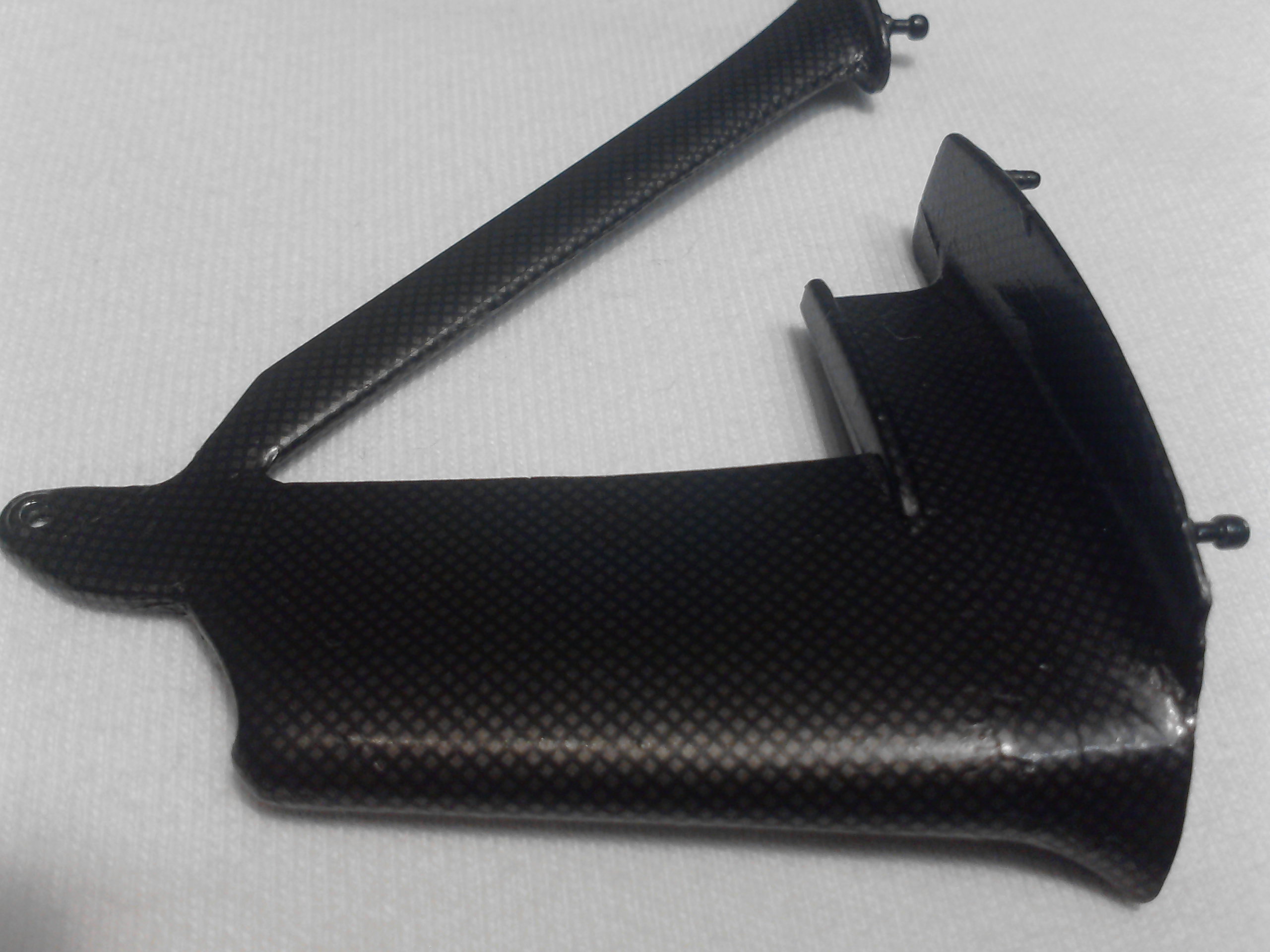

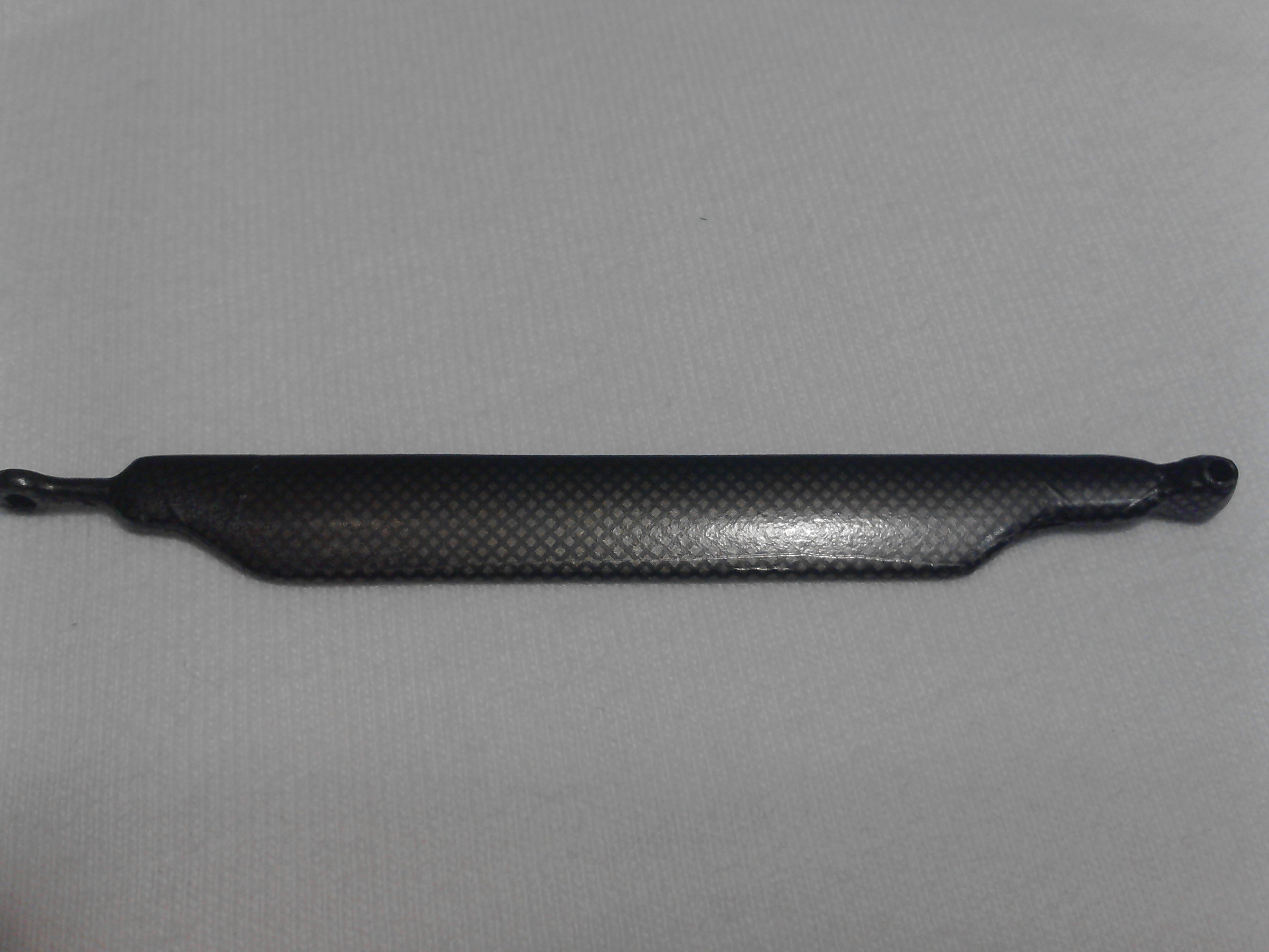

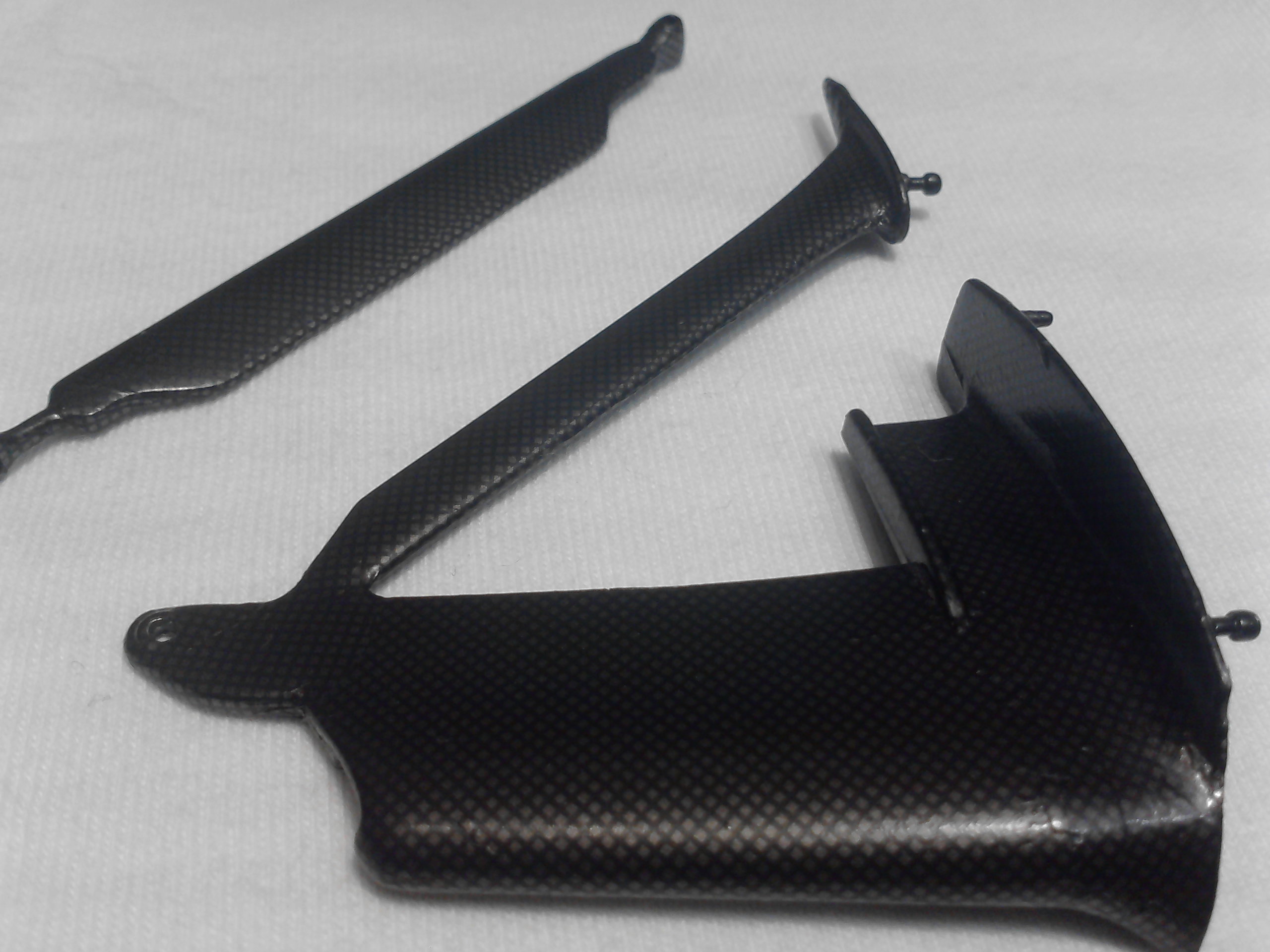

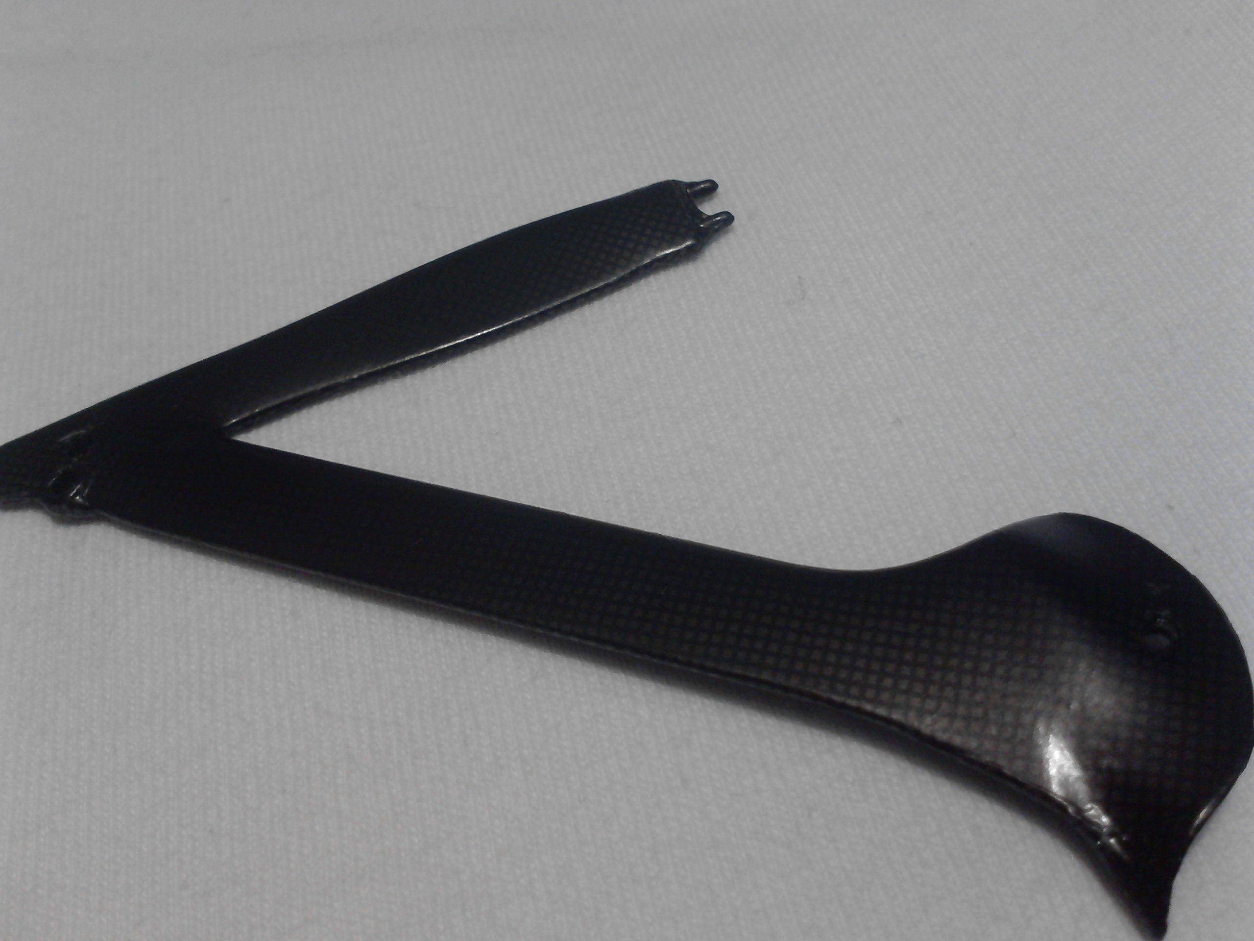

Hi all, just sprayed over the carbon with Clear Smoke Tamiya PS-31 then applyed a top coat of Semi Gloss Clear Tamiya TS-79. here a few pics. Also put carbon on the front wing plates and going to put a coat of gloss clear
#13 Posted : 24 June 2011 22:00:16
Good stuff GlenBigGrin
