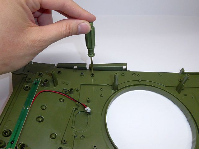

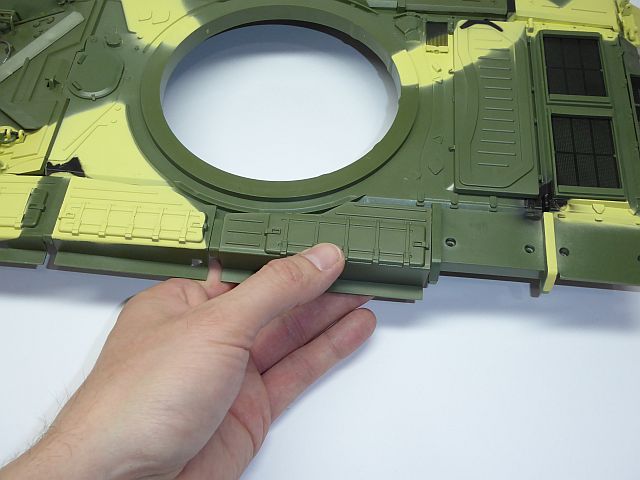

#1 Posted : 27 April 2017 20:00:00
PACK 6

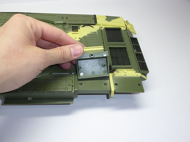

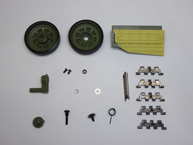

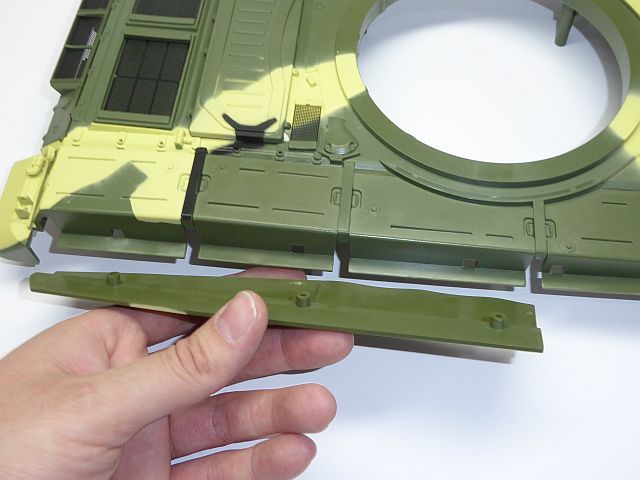

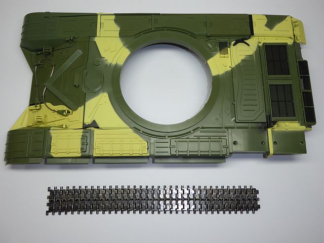

Stage 28

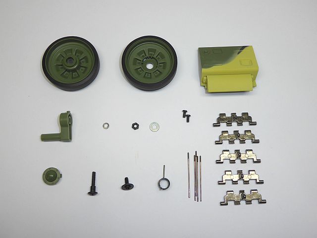

Contains: Road Wheel Inner, Road Wheel Outer, Suspension Arm, Washer, Split Washer, Nut, Wheel Cap, Axle Bolt, Washer Screw, Spring, Treads, Pins, Second Stowage Pannier, Screws.
In this stage, you require the second stowage pannier, screws, treads and pins. You will also require the track section from Stage 27 and the hull.

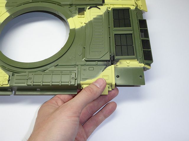

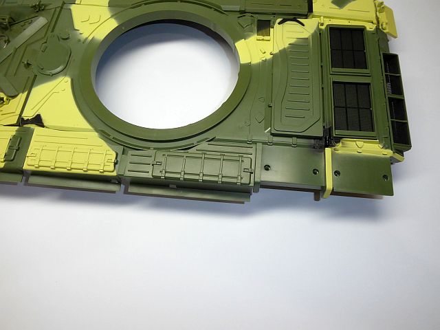

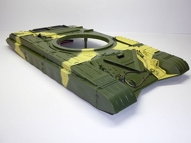

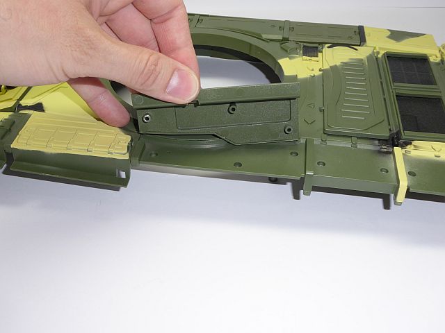

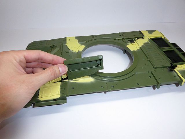

Align the posts on the underside of the pannier with the two corresponding holes in the hull, push the pannier into place. Turn the hull over, hold the pannier in place and insert a screw into the hole. Tighten the screw into place. Insert a second screw into its corresponding hole and tighten into place.

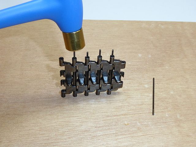

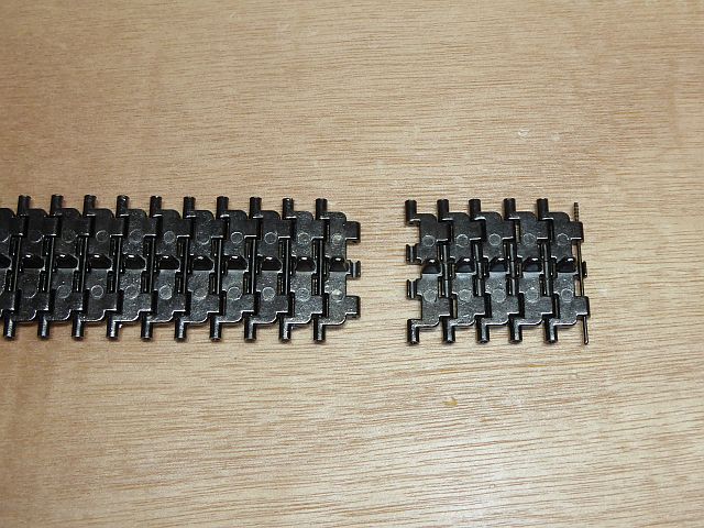

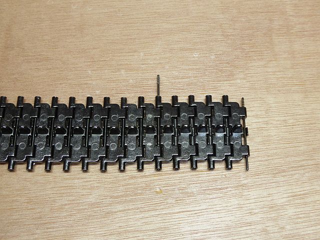

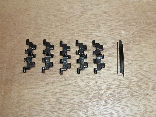

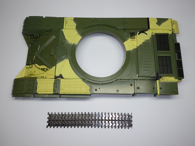

Assemble the five new treads to create a track section. Align this new section with the end of your track assembly. Push the pin through the aligned holes to join the two sections together. Place the track on its side and hammer the pins into place.
This stage is now complete. Store the assembly and any unused parts in a Stage labelled bag.

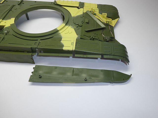

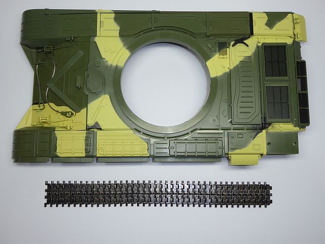

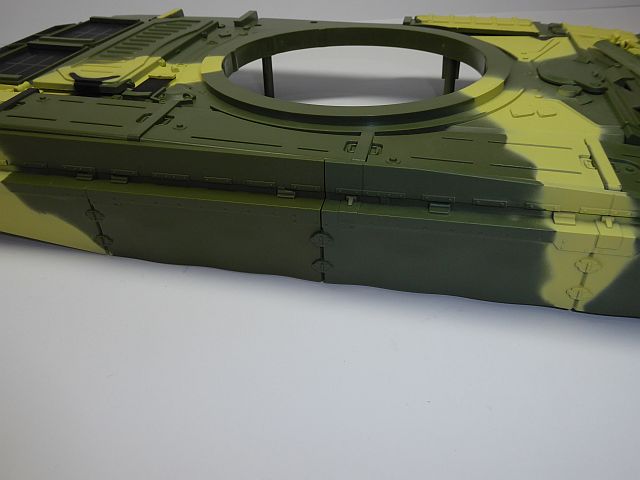

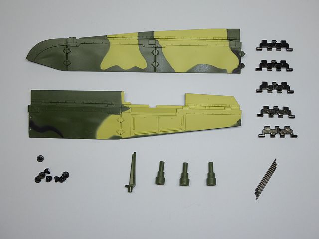

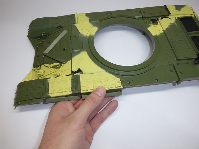

Stage 29
Contains: Left Front Skirt, Left Rear Skirt, Washer Screws, Bracket, Rollers, Treads, Pins.
You require the hull, the two right skirts from Stage 10 and screws.

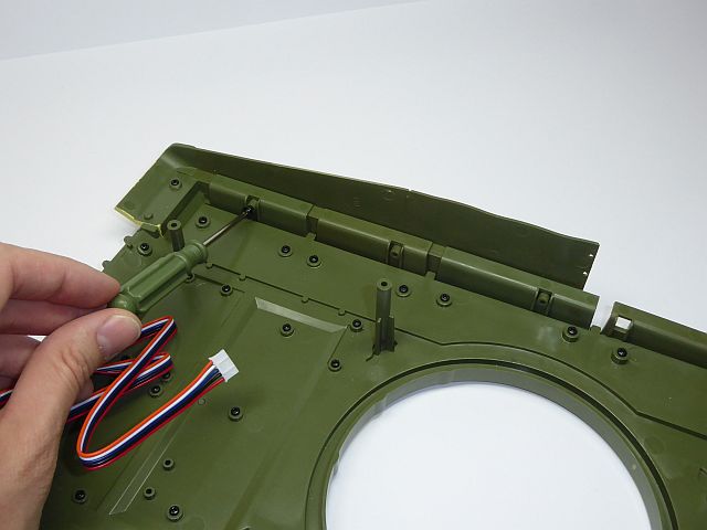

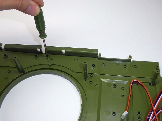

Before starting tap the holes in the posts on the inside of the two right skirt pieces.

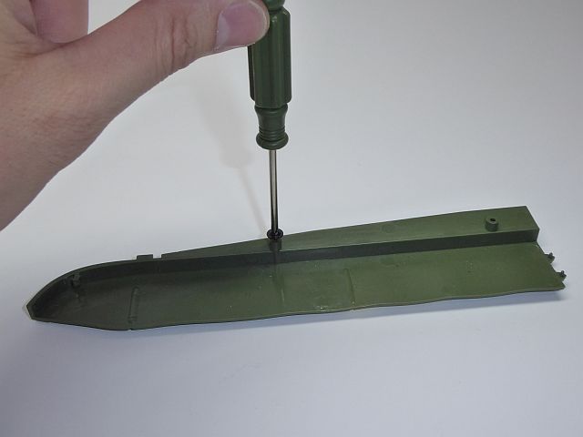

Take the rear right skirt and align the three posts on the inside with the three corresponding holes in the external fuel tank. Push the posts of the skirt into the holes then insert a washer screw into each hole from the inside of the hull. Tighten the three screws into place.
Align the two posts in the right front skirt with the two corresponding holes in the external fuel tanks and the two tabs with the matching recesses in the front of the right skirt. Push the front skirt into place making sure that the two tabs at the rear engage with the matching recesses. Insert a washer screw into both holes from the inside of the hull and tighten the screws into place.

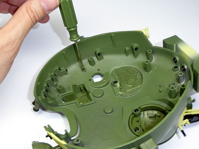

#3 Posted : 27 April 2017 20:09:59

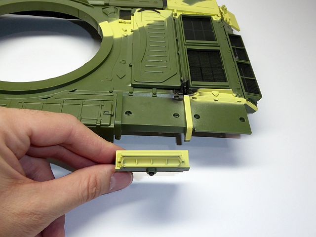

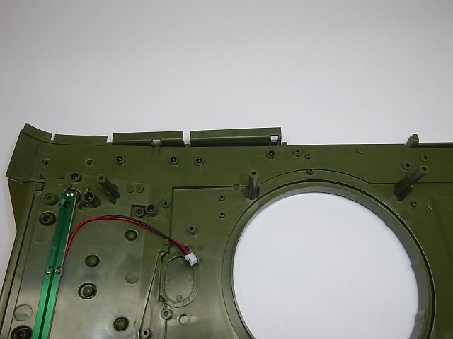

Stage 30
Contains: Road Wheel Inner, Road Wheel Outer, Suspension Arm, Washer, Split Washer, Nut, Wheel Cap, Axle Bolt, Washer, Screw, Spring, Treads, Pins, Screws, Third Stowage Pannier.
In this stage, you require the third stowage pannier, screws, treads and pins. You will also require the track section from Stage 28 and the hull.
Take the third stowage pannier and align the three posts with the three holes in the hull. Test fit the posts on the pannier into the holes in the hull. Press the pannier into place. Only two of the posts go all the way through the hull. Tighten a screw into each of them to secure the pannier.
Engage two treads and insert one of the pins through the aligned holes and lightly hammer the pin into place. Repeat this process with the remaining pins and treads. Attach the new section of track to your previously assembled section.
This stage is now complete. Store the assembly and any remaining parts in a Stage labelled bag.

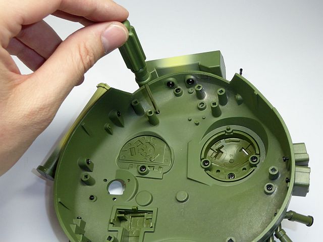

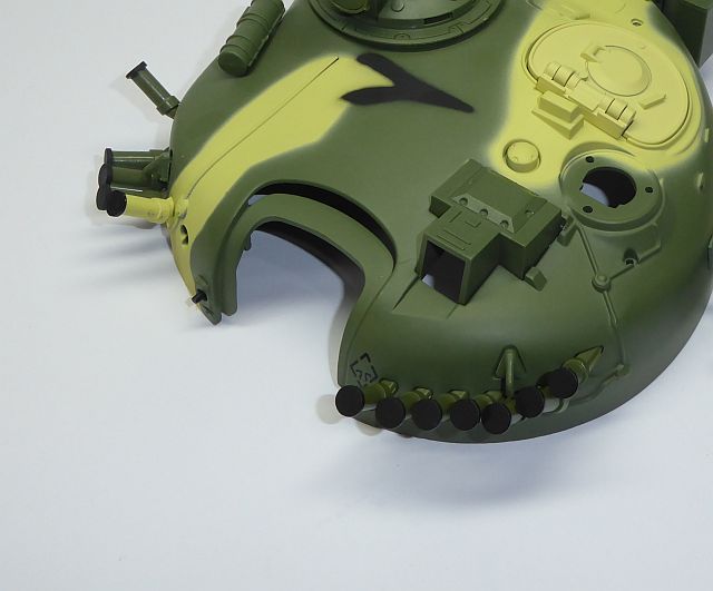

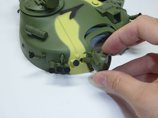

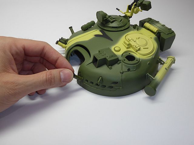

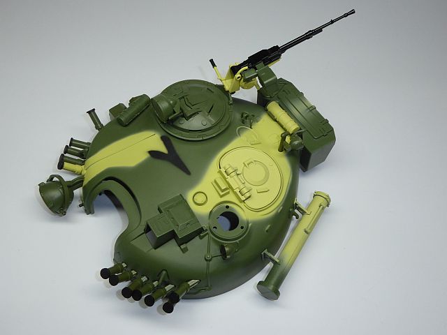

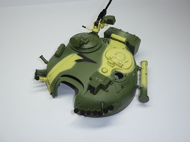

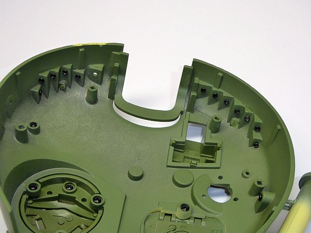

Stage 31
Contains: Spotlight, Tail Light, Headlight, Ammunition Boxes, Floodlight Bracket, Screws.

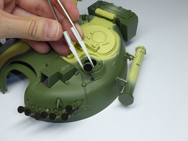

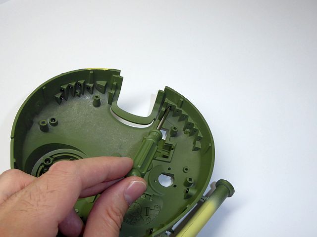

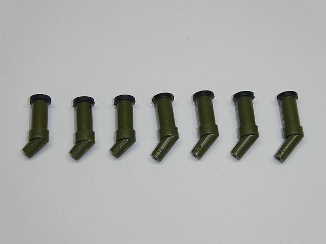

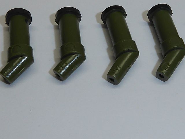

For this stage, you will need the smoke mortars and screws from Stage 9 and the turret. Make a note of the identifying part numbers for the mortars as shown in Step 1 of the instructions, the part numbers are also printed on the ends of the mortars.

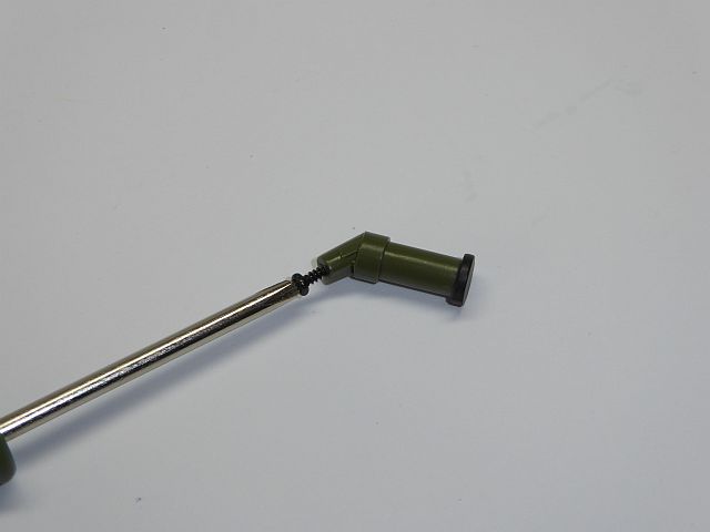

Carefully separate the smoke mortars from the sprues. Remove any flash or burrs from the mortars then very carefully open the screw holes of the mortars a little if required.
Half tighten a screw into the hole at the end of each mortar and then remove it.
Insert smoke mortar number 6 into the first hole on the left side of the turret. Tighten a screw into the smoke mortar from the inside of the turret. Fit smoke mortars 7 to 9 in the same way and in sequence around the turret. Now fit smoke mortars 10 to 12 into the remaining holes on the turret.

Stage 32

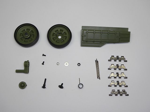

Contains: Road Wheel Inner, Road Wheel Outer, Suspension Arm, Washer, Split Washer, Nut, Wheel Cap, Axle Bolt, Washer Screw, Spring, Treads, Pins, Screws, Exhaust Port.
In this stage, you will require the exhaust port, screws, treads and pins. You will also require the previously assembled track section and the hull.
The exhaust port looks like the other stowage panniers but has a detail at the side.
Align the posts on the underside of the exhaust port with the corresponding holes in the hull and push the exhaust port into place. Turn the hull over and insert a screw into each hole. Tighten the first screw into place followed by the second screw to secure the exhaust port to the hull.
Engage two treads and insert one of the pins through the aligned holes. Lightly hammer the pin into place. Repeat this process with the remaining pins and treads. Attach the new section of track to your previously assembled section.

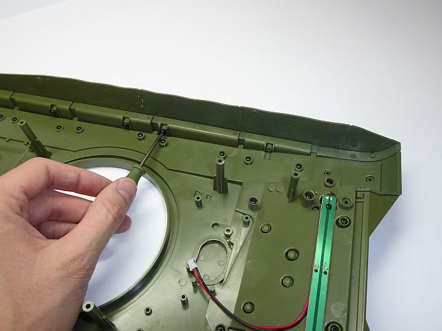

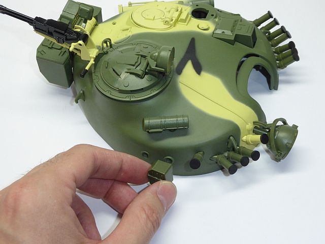

#6 Posted : 27 April 2017 20:22:36

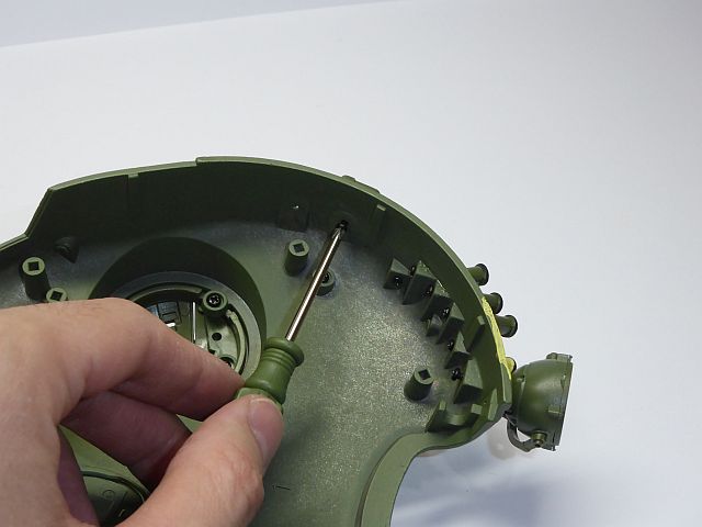

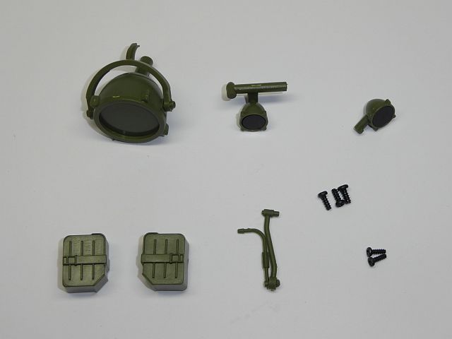

Stage 33

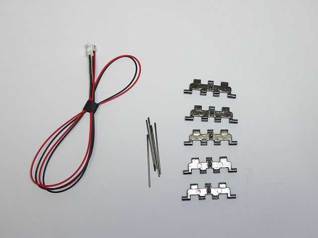

Contains: LED, Pins, Treads.

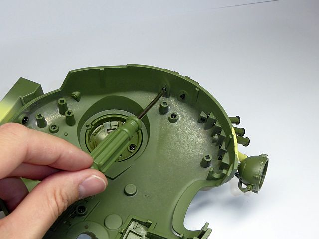

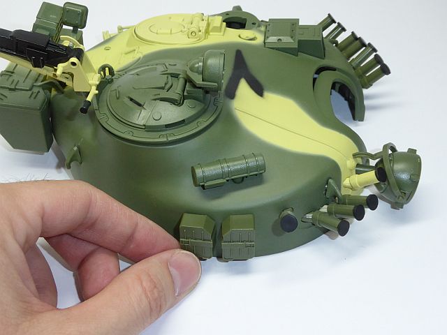

For this stage you require the turret as well as the spotlight, tail light, headlight, screws and the ammunition boxes from Stage 31.
Insert the post on the back of the spotlight into the hole next to the right smoke mortars. While holding the spotlight in place, tighten the large screw into the hole from the inside of the turret.
Take one of the ammunition boxes and place it over its corresponding hole. Carefully tighten one of the medium sized screws into place on the inside of the turret. Fit the second ammunition box in the same way over the adjacent hole. Secure the second ammunition box in the same way as the first.
Insert the headlight into its corresponding hole. Hold the headlight in place and tighten one of the small screws into it from inside the turret. Insert the tail light into its corresponding hole towards the rear of the turret. Hold the tail light in position and secure it with a small screw from inside the turret.
