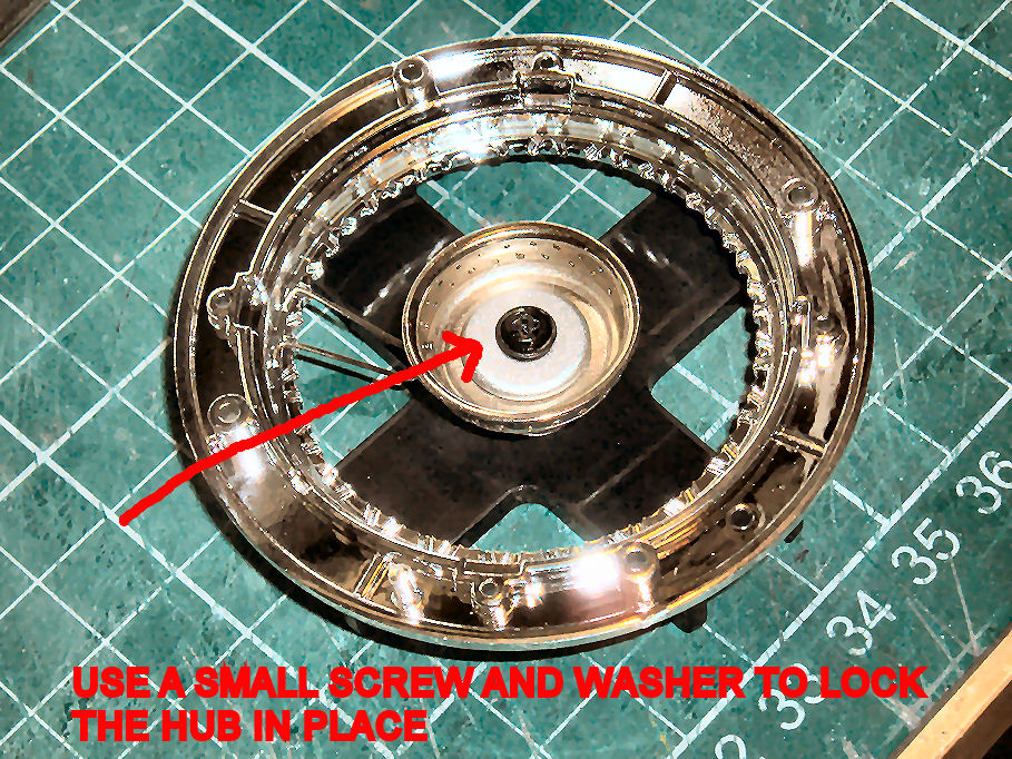

PLEASE NOTE: This thread is intended to clarify that the wheels CAN be assembled as per the instructions.
I certainly don't want to 'muddy the waters' in any way.
I've had a couple of PM's asking me to have a go at assembling a wheel as it appears to be causing some difficulty.
The main problem seems to be getting the second layer of spokes to have the desired '3 crossover' pattern.
Why I've been asked, who knows but I'm pleased that a few think I could help.
I'm not starting my actual build for a long time yet, but I'll have a bash at the first set of wheel parts.

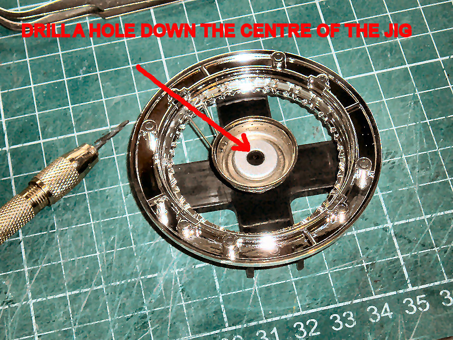

To begin with, The central hub has a plastic core that's meant to lock in place on the jig.
I'm not sure why there's a locating stub and groove, as the two metal hub components rotate on the plastic centre anyway.
However, centre hub duly placed.

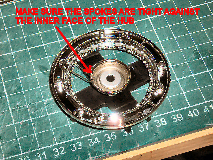

You will find it a pain trying to hold the hub down along with the rim, and fit the spokes...
Drill a small hole down the centre column of the jig and fix the hub in place with a small screw and washer.
Later on, use pieces of masking tape to fix the outer rim as well.

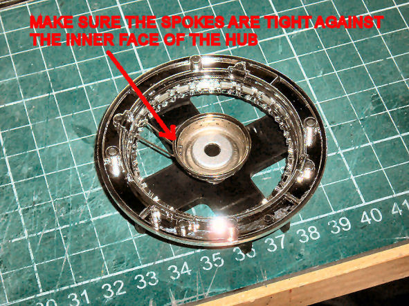

For now, just fit a couple of spokes and glue firmly in the rim and hub.
Make sure the central hub is rotated sufficiently to keep the spokes tight.
Let the glue dry completely before moving on.
*Using glue is purely optional and not necessary. I just like to be extra-secure.*

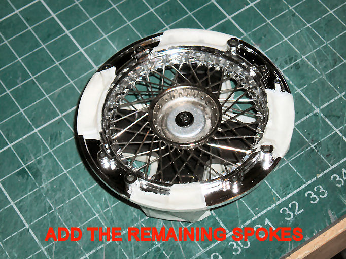

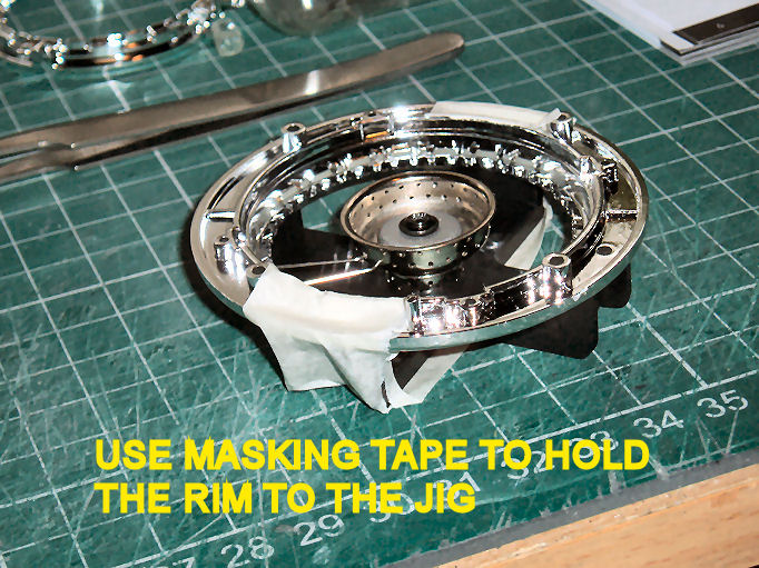

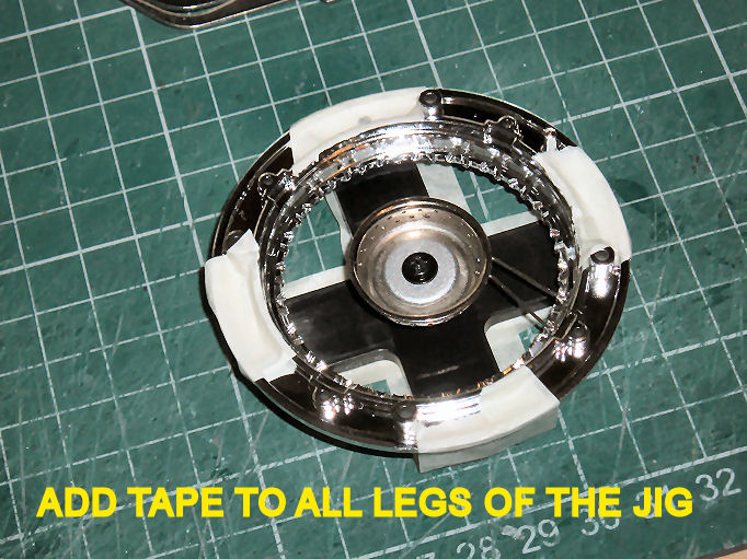

Add masking tape all round the jig and onto the rim.
Now the spokes can be added without all the hassle of trying to keep the jig, rim and hub all in one place without everything moving.
#5 Posted : 23 April 2017 16:53:02
Posts: 5,192
Points: 15,725

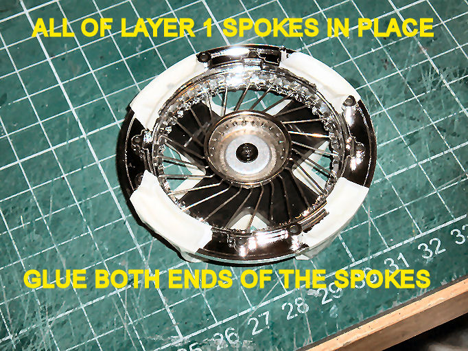

With all parts of the rim and hub firmly held in place on the jig it is now quite easy to fit the spokes by just feeding them through the relevant hub hole, turning the whole assembly on it's side and 'wiggling' it - the spoke will drop through the hole, pointing in the right direction with no need to use tweezers.
The tweezers can then be used just to lift the spoke into the correct rim slot.
Apply CA to both ends of the spoke and move on to the next one.
I fitted all the spokes in layer 1 in about 15 minutes.

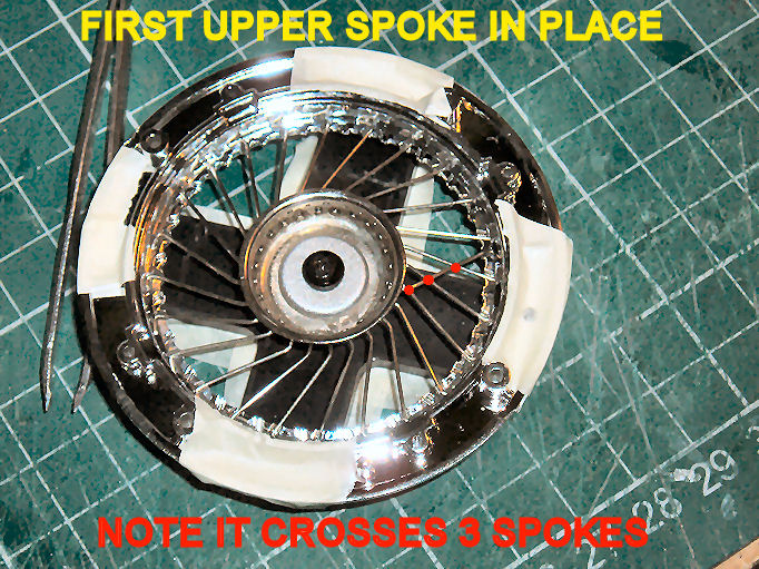

Now the next layer of spokes can be added.
Feed a spoke through any upper hole in the same was as the lower spokes.
Turn the rim on its edge and 'wiggle' it until the spoke drops through fully.
Check the spoke crosses 3 spokes underneath and using tweezers, the spoke will 'click' into place in the correct slot. Apply a dot of CA for security if you wish.

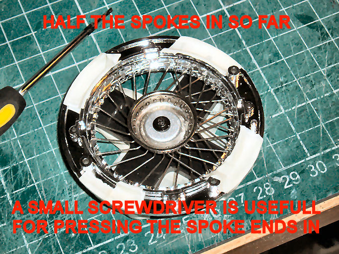

A small blade screwdriver is useful for pressing the ends of the spokes into the grooves.
Take care not to slip, and skewer your hand!

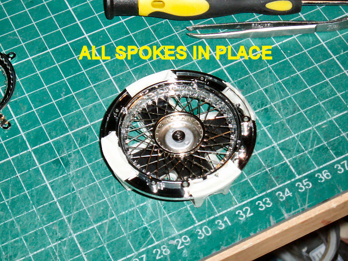

#8 Posted : 23 April 2017 17:45:07
Posts: 5,192
Points: 15,725

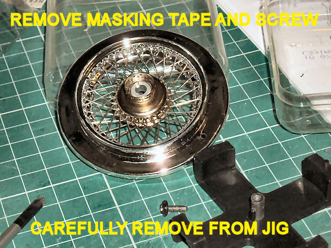

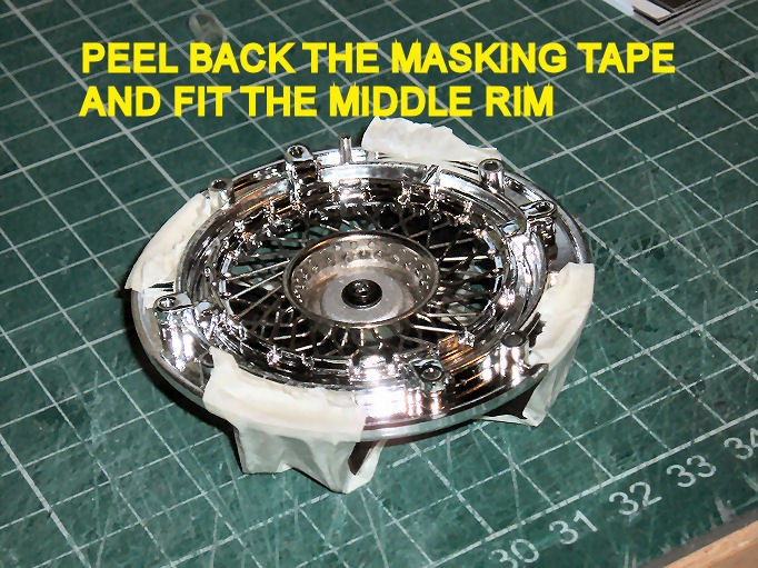

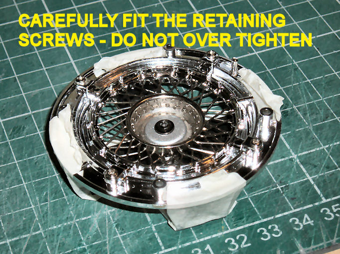

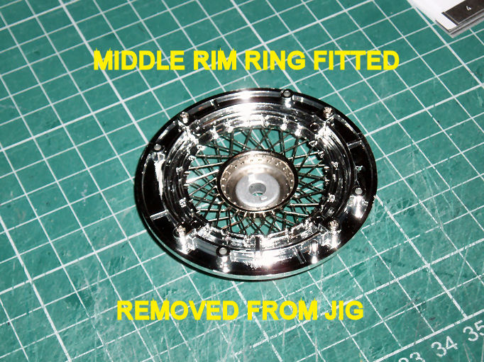

When all the spokes have been fitted, peel back the masking tape but do not fully remove yet.
Fit the central rim ring and fix with the screws. Take care not to over tighten them as this will strip the plastic threads.
Remove all masking tape and the retaining screw in the hub centre.
Carefully take the wheel from the jig...

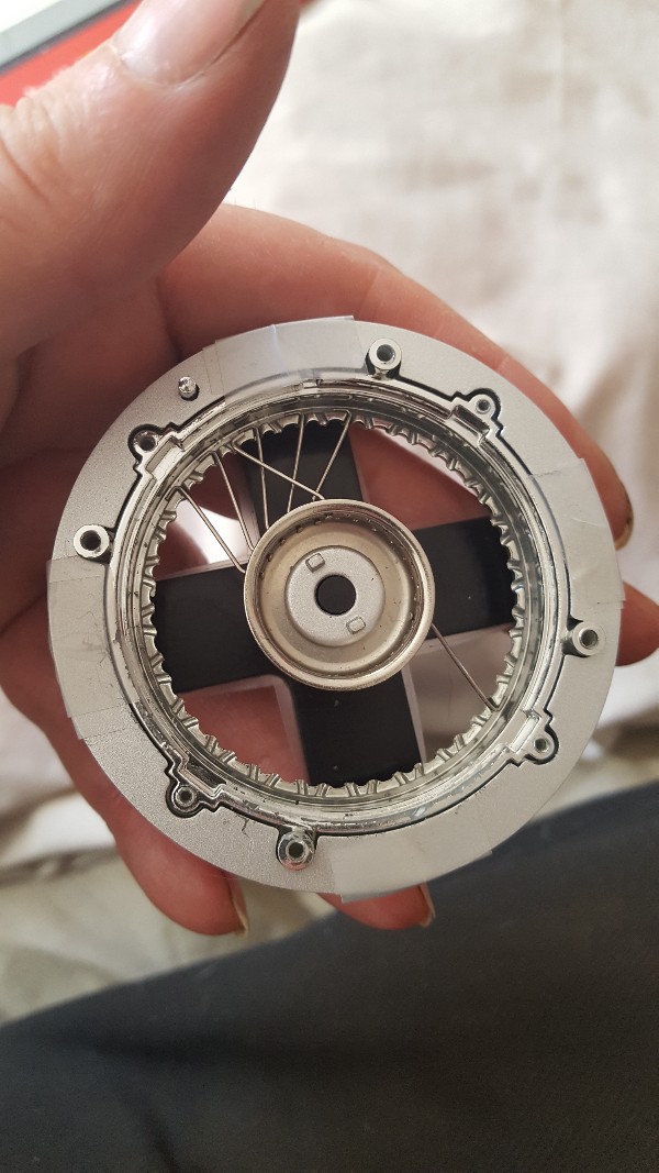

Hi Roy
Are you using test pieces for this?
I cannot emphasise enough that the pin on the second row will not fit with the centre hub and outer rim flush to the jig. It's too short. The photo below shows several inner spokes in place, including one that is twelve spokes away from the other five. The wheel is tensioned correctly by the inner hub being rotated anti-clockwise to give the best chance for everything fitting. The outer ring is taped flush to the jig.
With all six inner spokes in place the outer spoke will not reach its hook over point. It's about 1mm too short. The only way I can make it fit is by tilting the centre hub slightly towards that hook over point but that forced the inner spoke that is twelve spokes away from the others out of place. I've tried pressing down on the outer spoke when I have put it in place and tried to get the opposite inner spoke in by pressing down and out on that too but there's no way it will fit.
Another poster suggested raising the outside of the jig a couple of mm. This would put it near the same height as the upper spoke to give slightly shorter travel to the hook over point.
That is what I'm going to try next.

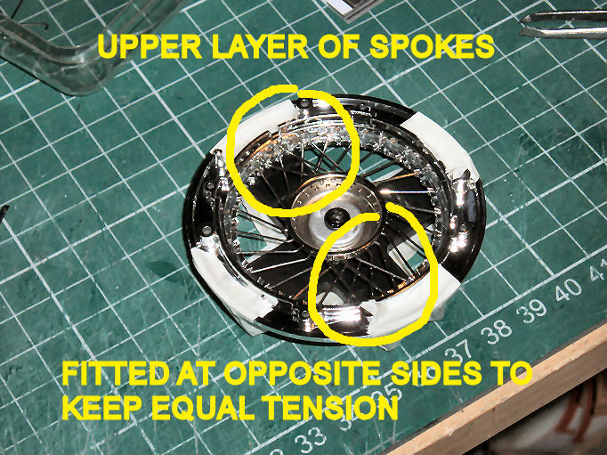

#11 Posted : 23 April 2017 19:12:24
Posts: 5,192
Points: 15,725

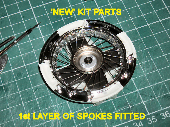

A new rim is being assembled but this time using only the 'new' kit parts, and not the test issue parts.
As before, I have screwed the central hub in place and taped the outer rim to the jig.
The first layer of spokes was added as before, quite quickly - around 20 minutes.
The 2nd 'upper'layer is being added but fitting spokes at opposite sided as the construction proceeds. This will help to keep everything central and under equal stress.
The outer ends of the spokes are pushed into place using the end of a small screwdriver.
Keep your other hand out of the way!

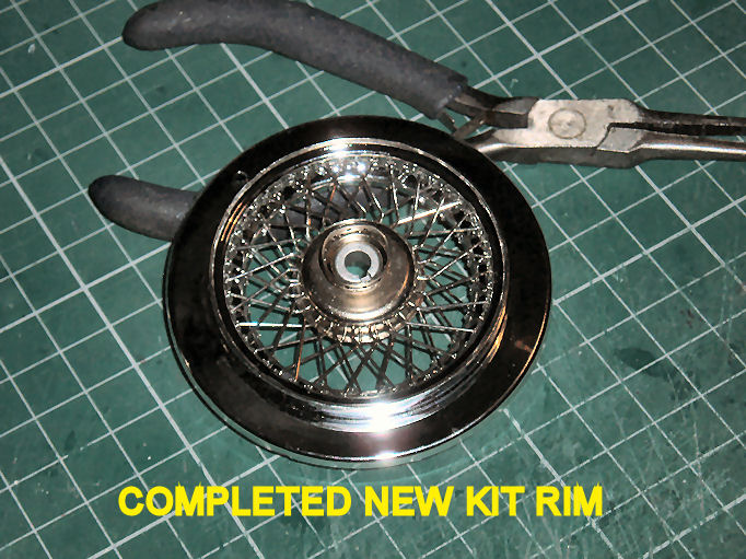

The remaining spokes fitted.
A few were tight in their locating points but could be pushed into place with the end of a small screwdriver - other hand well clear.
There doesn't appear to be any difference between the test kit parts and the new kit parts, other than the two locating tabs on the inner hub.
Total time to assemble, about 45 minutes including photo's, editing and upload.
I imagine that after the 2nd - 3rd wheel, it could be done in about half an hour.
I will concede that assembly is not easy, and 'part-time' hobbyists might find it easier to assemble the wheels 'wrong' with only 2 crossing points in the spoke pattern.
However, I am not in any way recommending this.
