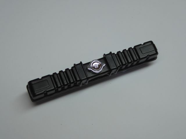

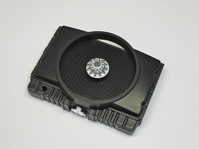

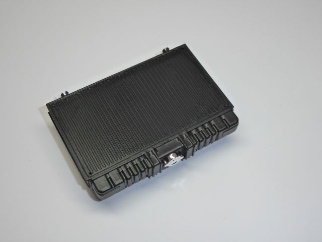

Issue 69

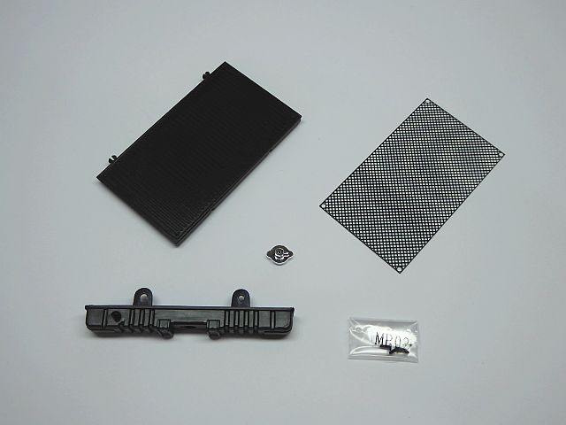

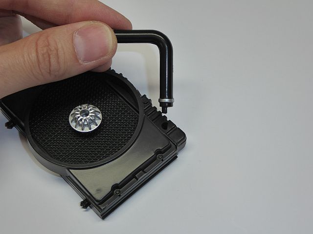

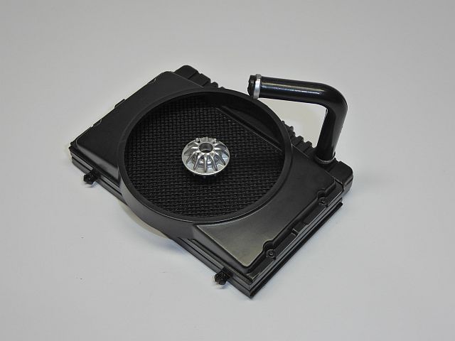

Radiator Front and Top
Parts content:
Radiator Cap
Radiator Top
1.2x3mm Screws
Radiator Front
Radiator Front Grille

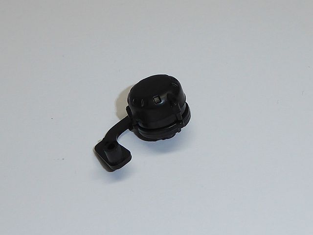

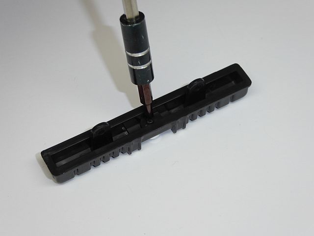

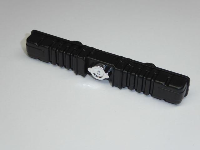

The bottom of the radiator cap matches the hole in the top of the radiator top, place the cap into the hole. Turn the assembly over and, while holding the cap in place, secure it with an 1.2x3mm screw.

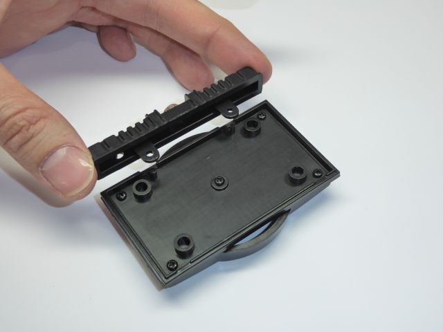

Retrieve the radiator assembly from the previous stage, and align the holes underneath the radiator top with the posts on the inside of the radiator rear. Push the holes down onto the posts, then take the radiator front from the previous issue and place the posts of the radiator front into the corresponding holes in the radiator rear. Press the parts together making sure they fit perfectly.

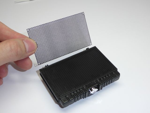

Now place the radiator front grille onto the front of the radiator and secure it in place with two 1.2x3mm screws.
Issue complete, carefully store any remaining parts in an issue labelled bag.

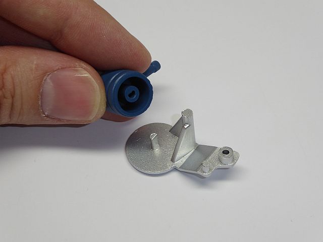

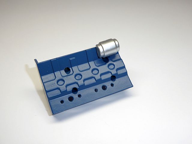

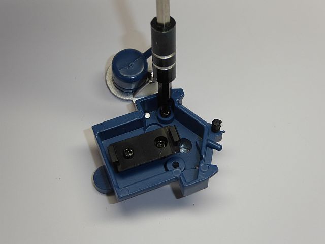

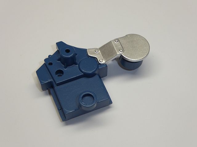

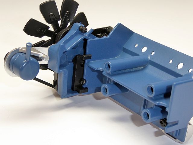

Issue 70

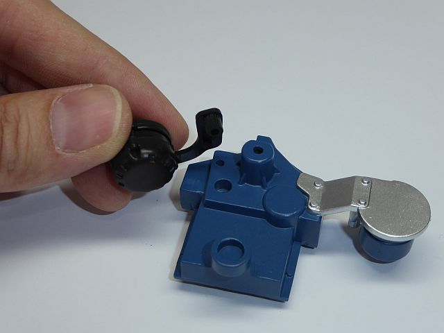

Engine Front and Pressure Pump
Parts content:

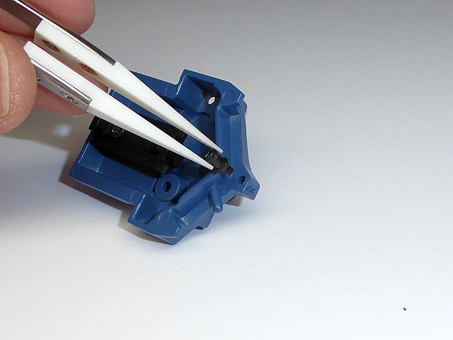

Engine Front
Engine Front Bracket
2.3x4mm (MD06) Screws
Tube
Pressure Pump Support

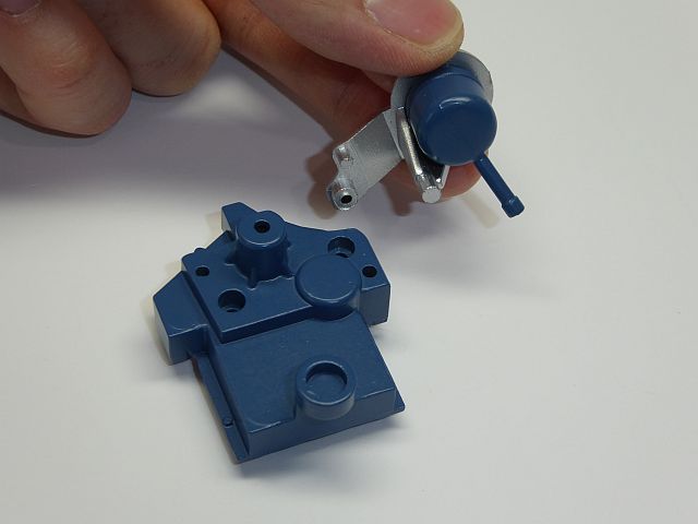

Pressure Pump
2.3x4mm (MP01) Screws

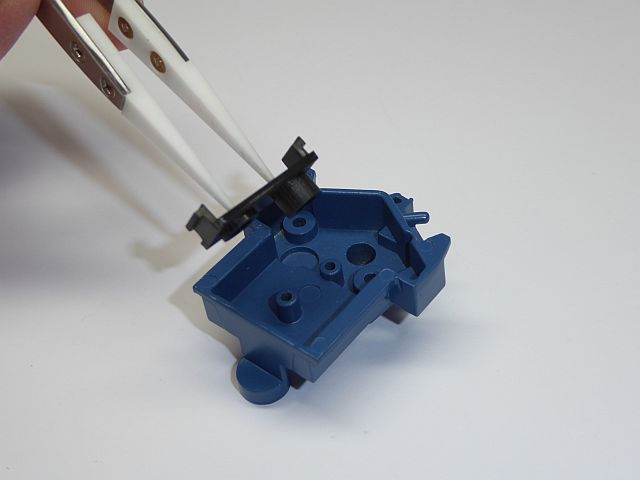

Align the posts of the engine front with the holes in the bracket, then insert bracket into the engine front. Use two MD06 screws to secure the bracket to the engine front. Now insert the tube into the hole at the top of the engine front.
Align the hole in the bottom of the pressure pump with the post in the support. The hole and post are D-shaped, so only engage in one position. Push the pump onto the support.
Align the two posts of the pressure pump support with the two holes in the engine front. Push the posts into the holes until the parts are flush.
Turn the assembly over and, while holding the pressure pump support in place, secure it with an MP01 screw.

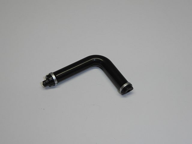

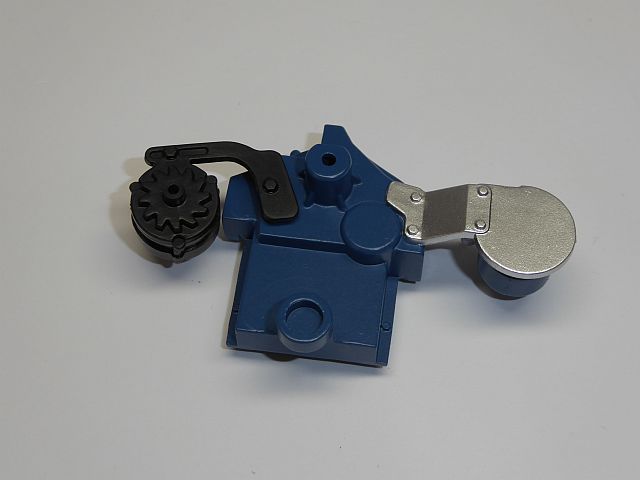

Issue 71

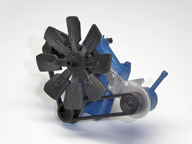

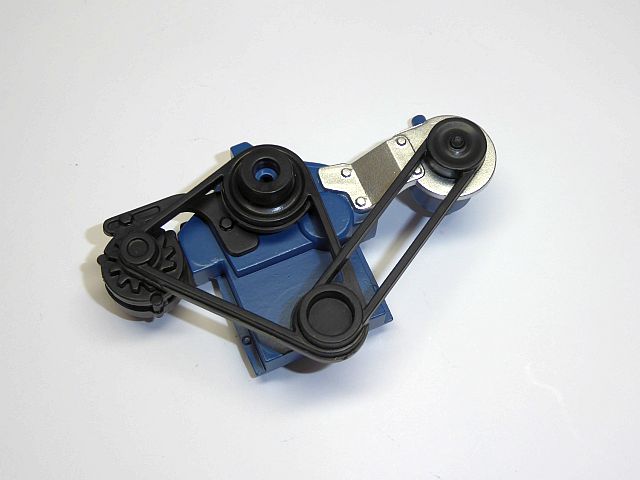

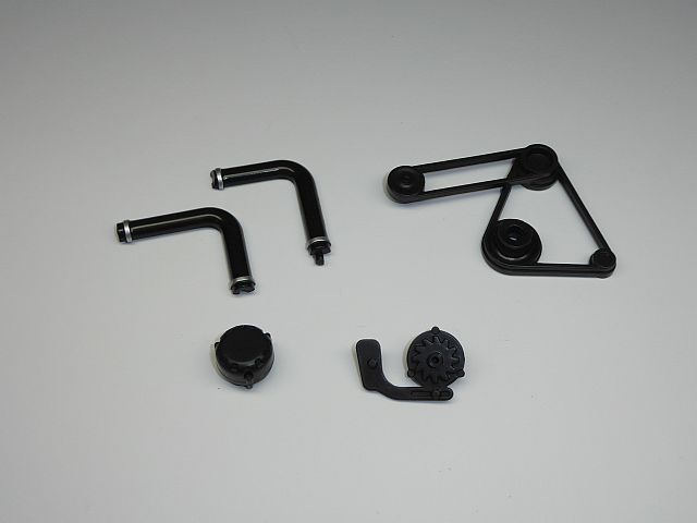

Alternator, Pulleys and Radiator Hose
Parts content:

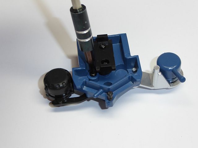

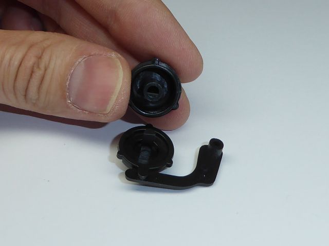

Radiator Hose Half (1)
Radiator Hose Half (2)
Alternator
Alternator Support
2.3x4mm Screws
Pulleys

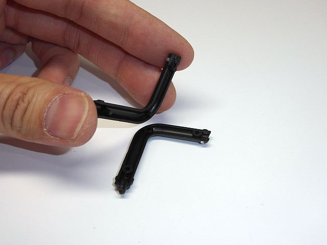

Take the radiator hose halves and align the pins with the holes, Press the two halves of the hose together.
Retrieve the radiator assembled in a previous issue, and locate the hole in the top of it. Align the pin at the end of the radiator hose with the hole in the radiator. Insert the hose into the radiator. The pin and hole match, so they will only engage in one position.

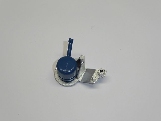

Next, take the alternator, and the bracket, align the pin and hole and press both pieces together.

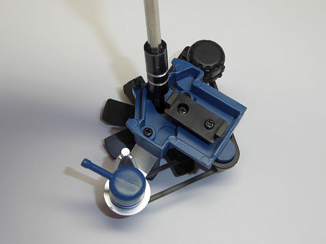

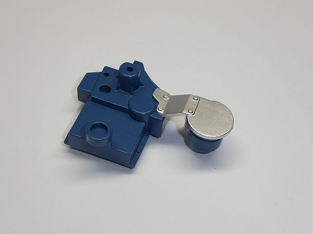

Now retrieve the engine front, and insert the alternator bracket into the hole on the upper left. Turn the assembly over, while holding the alternator bracket in place, and secure it with an 2.3x4mm screw.

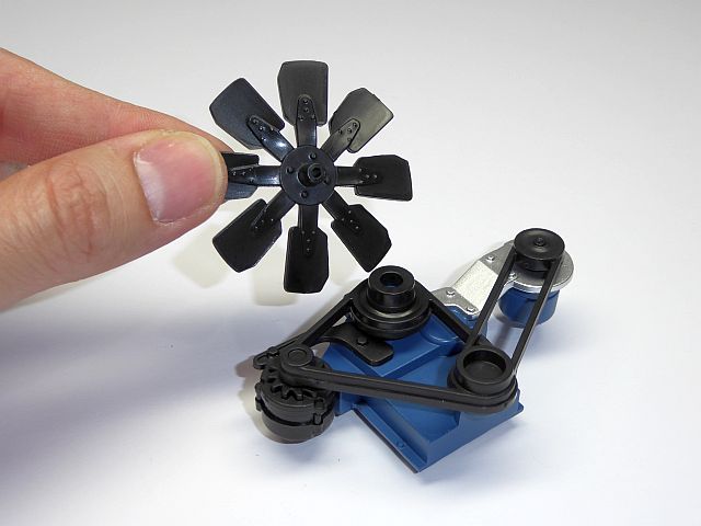

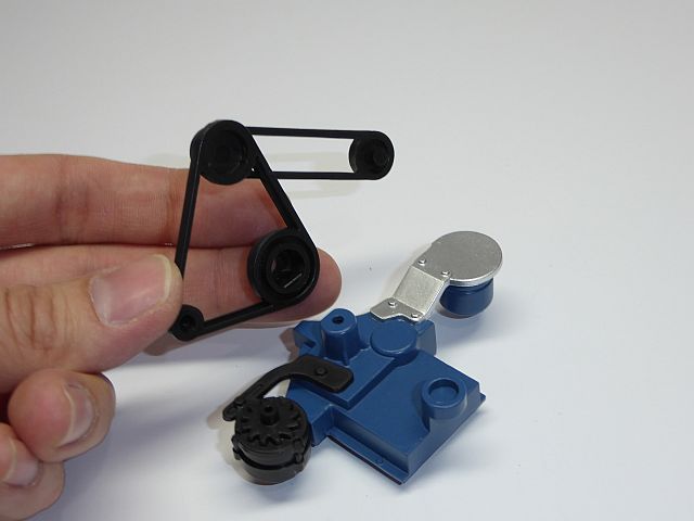

Align the holes of the engine front and alternator with those in the pulleys, and press into place. Retrieve the fan, and insert its post into the hole in the pulley. Make sure the fan blades are facing outward. Turn the assembly over while holding the fan in position, and secure it with an 2.3x4mm screw.

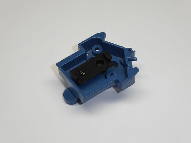

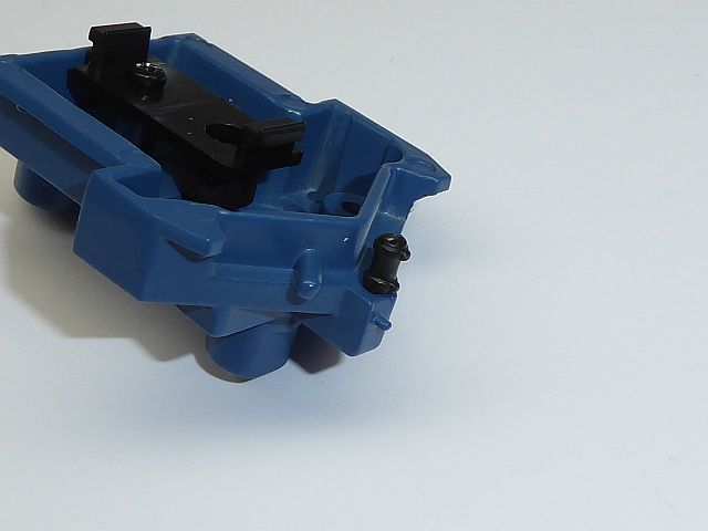

Right Engine Block and Light Switch
Parts content:

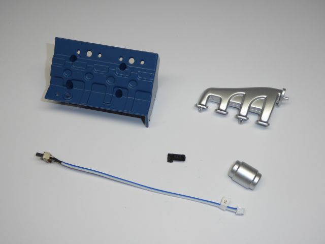

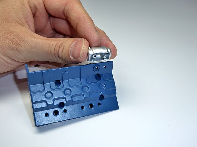

Right Engine Block
Gas Recycling Filer
2.3x3mm Screws
Light Switch
Switch Support

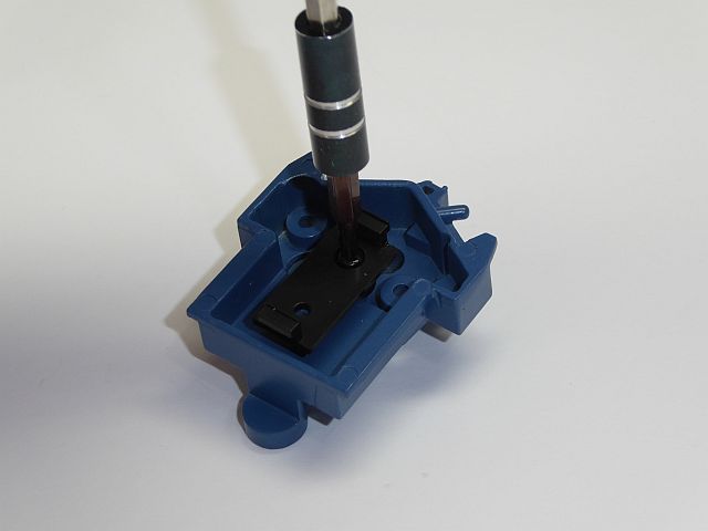

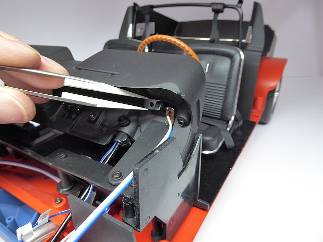

Right Exhaust Manifold

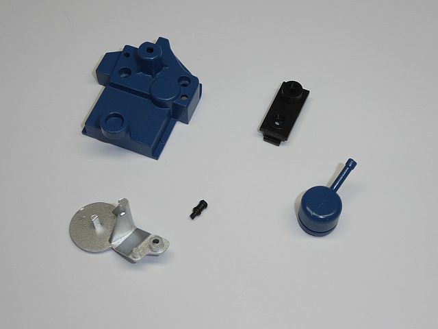

Align the pin and post on the gas recycling filter with the two corresponding holes in the right engine block. Push the filter into place. The filter can only be fitted in one position. Turn the assembly over and, while holding the filter in place, secure it with an 2.3x3mm screw.
Retrieve the engine front from the previous issue, and position it at the front of the engine block. Make sure that the two tabs on the engine front bracket slide into the grooves in the front of the engine block.

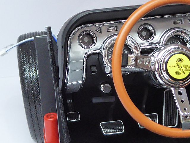

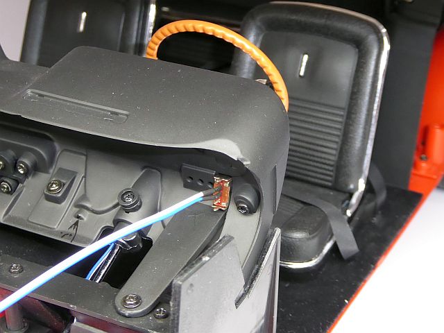

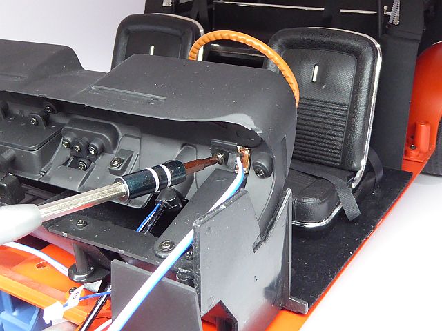

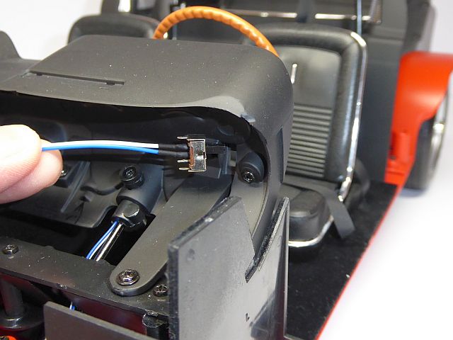

Insert the light switch into the small hole in the rear of the dashboard. Gently push the switch in until it is firmly located.
Place the angled part of the switch holder over the rear of the switch. Secure the bracket with an 2.3x3mm screw. Check that the switch can move up and down.
