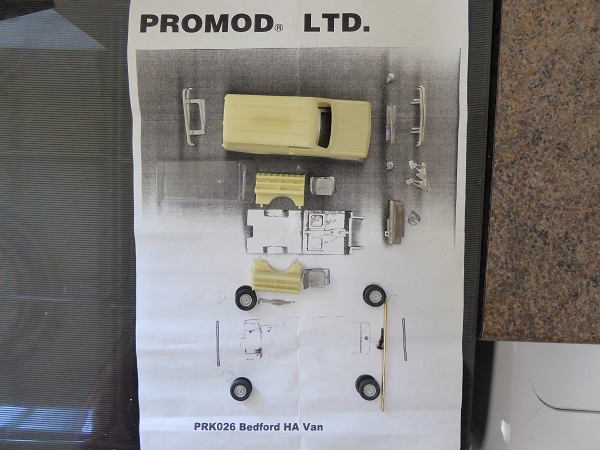

The model doesn't come with instructions, just a b/w photocopy of parts supplied. To be honest there isn't a lot to this kit so figuring out what goes where isn't too difficult.
The attached photo shows the parts photocopy with the components laid out on top.

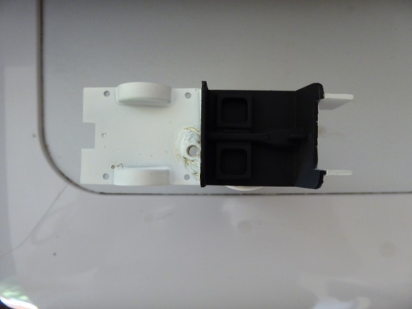

The attached photo shows the interior base. I have already spent some time cleaning up the flash and checking it for fit with the chassis. As can be seen I have already sprayed this part; matt white for the rear of the van interior and matt black for the cabin representing the carpet. Two coats for each with a coat of matt varnish to seal all areas.

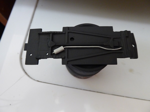

This photo shows the chassis. Again, I spent some time cleaning up this component before spraying matt black and varnishing. I masked off the exhaust pipe as it looked rather good in white metal.

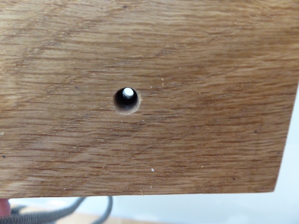

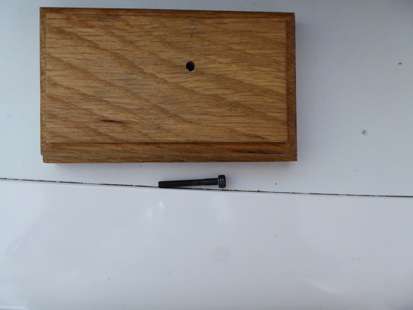

Attached is a photo of the oak plinth. I have already drilled a counter-bored hole to accept an M3 cheese head bolt. I have soldered a brass nut into the white metal van interior with a hole through the chassis so that the bolt locks the van to the base.
#5 Posted : 10 April 2017 18:26:33
Another picture of the oak plinth showing the M3 cheese head bolt

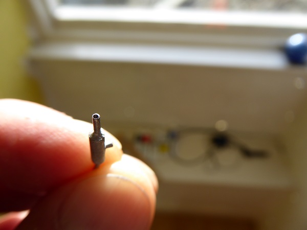

With smaller models, the exhaust pipe always gives the game away as they usually have a solid end. To remedy this I partially drilled the end out with a 0.5mm diameter drill and painted the hole with a fine, permanent marker. See attached photo for the end result.

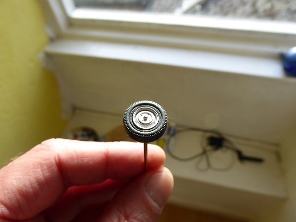

Here is a close up of one of the wheels fitted to it's rubber tyre. I will polish the centre cap and leave the outer rim 'as is' before varnishing.

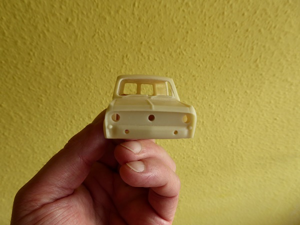

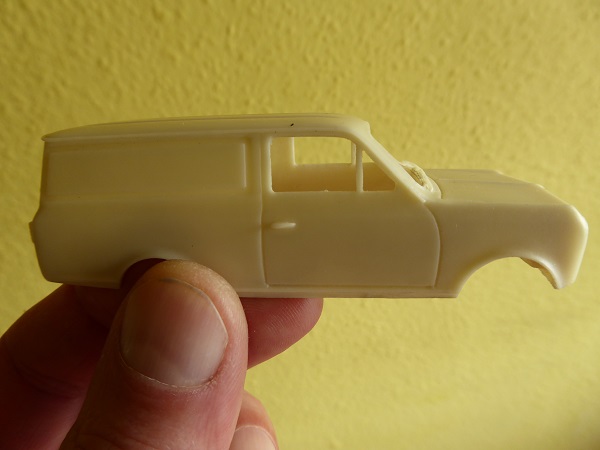

Here are a couple of images of the plastic bodywork. This will be painted gloss white then varnished before adding my own DIY water slide decals, painting the windscreen seal and indicators.
