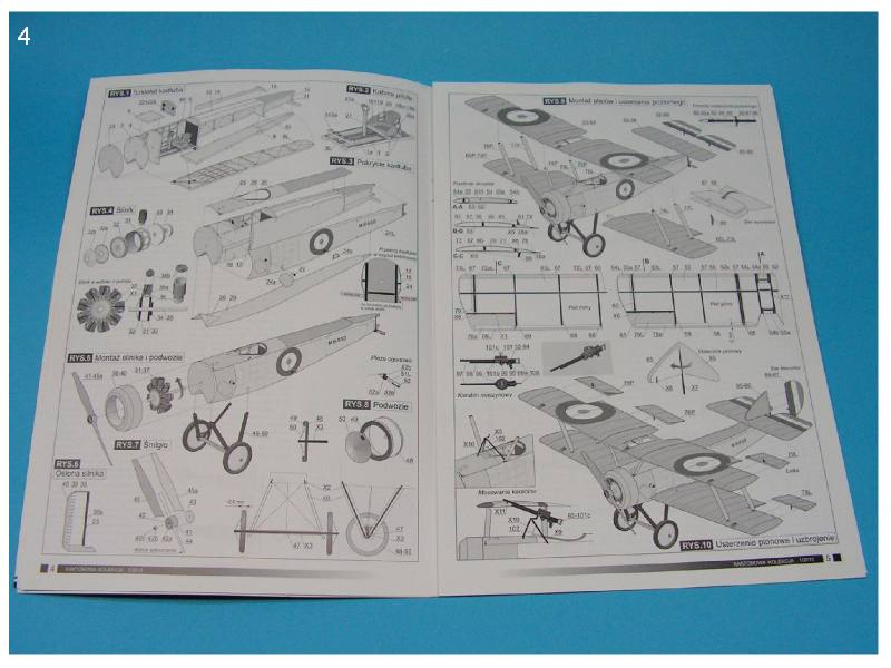

The difficulty in understanding the instructions is made easier by the excellent drawings provided in the book as shown in Photo 4, these explain most of the ‘stick what where?’ problems caused by the on line translators running back to Polish when they encounter a term specific to airplanes or modelling!Blink There is also a page of photographs showing the main sub assemblies being built and coming together which helps a lot too.

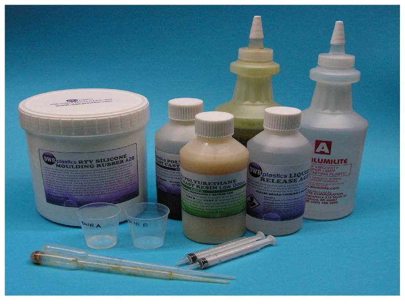

The big ‘Family Portrait’ photo shows the supplies I’ve bought to try out resin casting. My first purchase was the American “Alumilite” kit as seen in the Hobbies catalogue and on the far right of the photo. I bought this set because, frankly I didn’t know what else to try! It’s quite a sizable kit – about a kilo of resin consisting of half a kilo each of A and B which is mixed together at 1:1 to produce the solid resin. This is a good all purpose resin which has a very short setting time – the chemical reaction begins 90 seconds after you began mixing it together!Blink The casting can be removed from the rubber mould after about ten to fifteen minutes. The downside is it’s really expensive! Alumilite also do a silicon rubber to make the moulds and I almost sent off for some of that too (costs over £30, the same price as the resin in fact) Luckily I discovered a British company on Ebay called DWR Plastics who produce a home grown silicone rubber substitute which is shown in the big white tub on the left. Not only is their rubber exactly the same, property wise, but it costs way less than half the price (£12.50). What I forgot to include here was the little bottle of purple catalyst which is added to the white rubber to begin the RTV (Room Temperature Vulcanisation) which sets the liquid rubber into the solid mould. After looking through the DWR on-line shop I also discovered that they manufacture the resins as well. Their resins are less than half the price of the American product but it allows more mixing time (3 minutes as opposed to 90 seconds) and it is also more ‘watery’ when mixed which means it is easier to pour into the mould and also produces finer detail. On top of that, the British resin is non-toxic too which helps with any sanding down afterwards! I bought a half kilo set for £9.00, which is shown in the centre of the photo along with a bottle of liquid wax release agent which is applied to the first half of the rubber mould before pouring in the second half. This was just £4.50.
Finally at the bottom are some of the plastic mixing cups (40 for £2.99) and disposable pipettes (50 for £2.34) both obtained on ebay again. The cups are for mixing the resin, the pipettes are for adding catalyst to the rubber. My first experiments with resin casting have been quite successful I'm relieved to say, and I’ll have a full description of this fascinating aid to modelling in the diary later.Cool

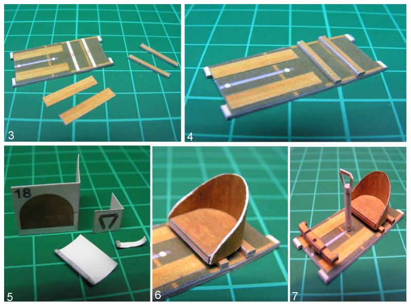

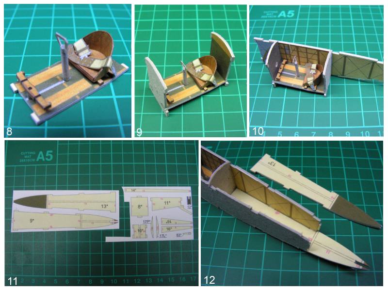

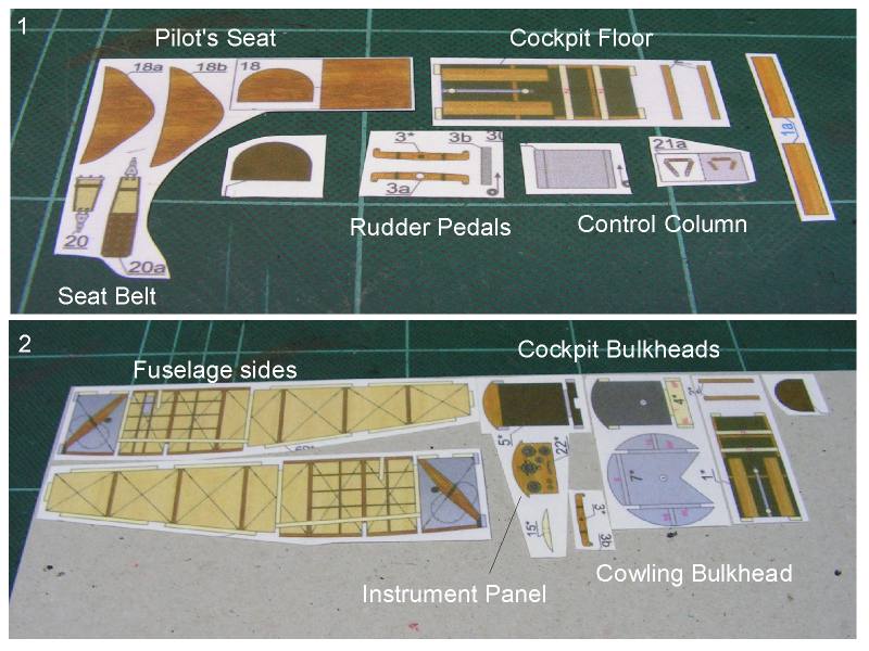

Photos 1 and 2 show the actual parts required to construct the cockpit section of the Pup. The first thing to be aware of with these kits is that there are three different types of components parts. The first and largest group are the actual bits you will need to build the plane (obviously!Blink ) but these are split into two sections: the pieces with a simple part number such as the parts of the pilot’s chair in Photo 1 (18, 18a and 18b) are used ‘as is’, that is, you cut them out and glue them together. However, parts marked with a number and a * after it, are first glued to the 1mm backing card as illustrated in Photo 2 before then cutting them out to be glued together. The third type can be seen on the far right of Photo 1 – parts printed with a part number in Blue. These are additional ‘up-grade’ parts, you don’t need them to build the aircraft but adding them in will improve the end model. The parts shown here (1a) are additional foot rest boards which can be glued over the top of the printed ones on the cockpit floor to add a little depth.
So to begin construction, first the cockpit floor and the two seat supports are glued to the backing card and then cut out together with the additional foot rests as shown in Photo 3. Next, the foot rests and seat supports are glued in place on the cockpit floor as in Photo 4. The floor is now ready to put in the pilot’s seat, control column (joystick) and the rudder control pedal. Photo 5 shows some of the main components of the seat and joystick – part number 18 shown here is the ‘cushion’ of the seat and is printed in a rectangle of card which has to be folded double and glued front to back before the part is cut to shape. The same procedure goes for the joystick handle shown to the right. The two ‘curly’ bits of card are the control column itself and the smaller column for the rudder pedal. These have to be rolled up as tightly as possible to form the cylinders required then unwound, brushed with the Roket glue and rolled up again. The seat itself is composed of five pieces (not including the seat belts coming later). The cushion mentioned above, the base, which is glued to the 1mm card and two wooden backs. The backs are glued ‘back to back’ (pardon the pun)Blushing and note: they are not exactly the same size – the outer panel is slightly larger than the inner one and when glued together there is a little gap at the bottom, this is stuck to the 1mm card base. Immediately after gluing the back panels together they should be rolled around a suitable cylinder to give them the required curved shape before the glue dries. The finished seat is illustrated in Photo 6, here you can see one of the inherent problems with paper and card construction: gluing two thin pieces of card together as in the seat backs gives a white edge made up of the actual thickness of the card sections. This is remedied as illustrated in Photo 7 with the edges of the seat along with the 1mm card front, the supporting beams and the assembled rudder pedal all having their bare edges painted with Revell Wood Brown acrylic. The pedal is also glued to the 1mm card and here you can see the control column and pedal support glued in position. The last part of the basic cockpit assembly to be added, are the two seat belt straps, and they will be the first things to go on in the next installment.
Robin.

Continuing on..
The seat belt is one of the printed parts that is used straight from the sheet and only requires a very careful cutting out before gluing in place. The belt modeled in this kit is the very early version which simply secures around the pilot’s waist. Before the end of the year, this type would be superseded by a more complicated system where a bracing wire behind the seat carried a pair of shoulder straps which fitted onto a smaller waist belt, in other words, much more like, and the forerunner to the harnesses found in the Spitfires and Hurricanes of the Second World War. The actual belt buckle on this type is a little more complicated than the printed one and I’ll be scratch building a new one in Number 2.
The ends of the straps are glued to the seat supports according to the instruction drawings, although some blue-prints show the straps secured to the wooden frame on the ‘floor’ behind the back of the seat instead. As this is the ‘By the Book’ version, they are attached as per the instructions as shown in Photo 8. Now that the cockpit floor assembly is complete, the next step is to add on the two bulkheads, front and rear. In the real aircraft, neither of these actually exist! The rear one would be only the wooden top piece whilst the front one wouldn’t be there at all, the pilot’s legs almost rest under the crankshaft of the engine – but for the model these are in fact essential parts of the fuselage ‘box’ construction. The front one cannot be seen once in place but I’ll be ‘modifying’ the rear one in Pup No.2 as you’ll see later. The bulkheads are glued to the floor in Photo 9 and the whole assembly is attached to the starboard fuselage in Photo 10.
The last step required for Pup 1 for now is to glue down, then cut out and fit the top and bottom of the rear fuselage section. For now however, the bottom or floor of the fuselage is only going to be glued to the starboard side panel, the top section is merely held in place by its tabs. This will however keep the entire fuselage locked together to prevent any warping of the pieces whilst I begin the cockpit area of Pup No.2. (The reason being, I want to be able to take comparison pics of the two internal areas so I can’t glue No.1 fully together just yet!)BigGrin The component parts are shown before gluing them to the 1mm card in Photo 11, and the fuselage floor is illustrated ‘clipped’ in position before gluing in Photo 12.
