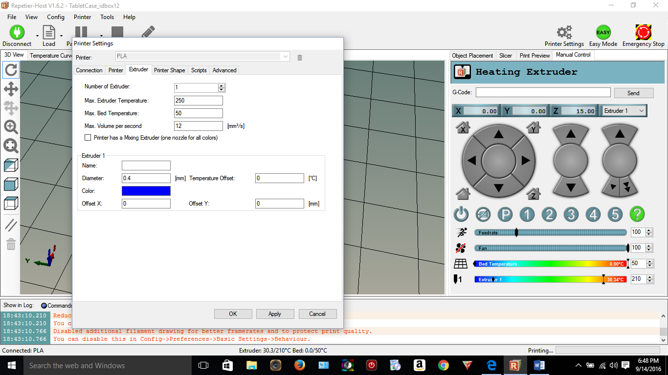

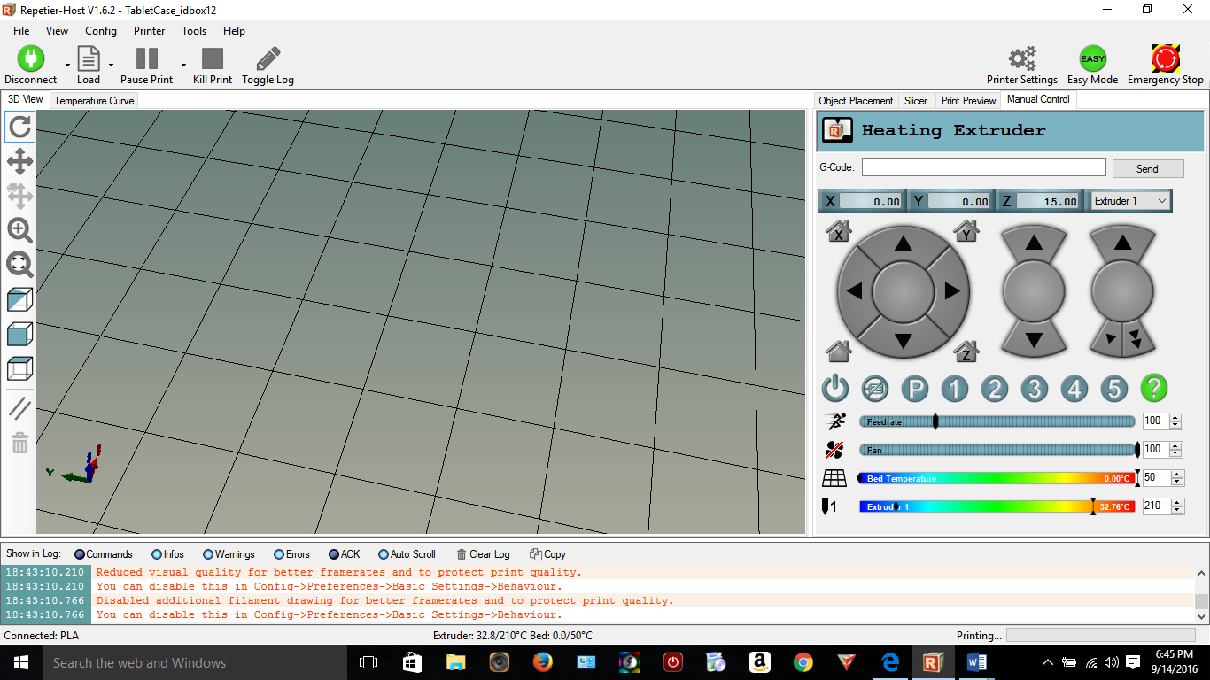

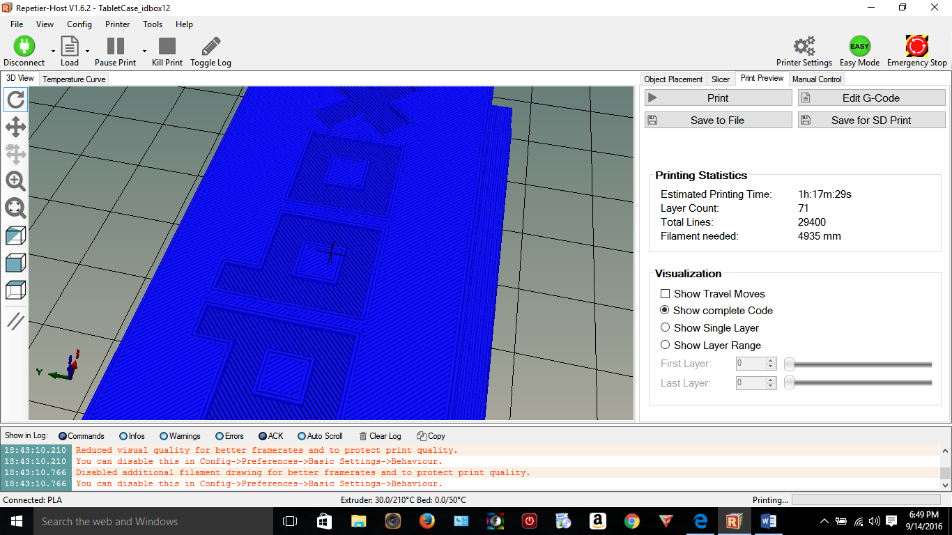

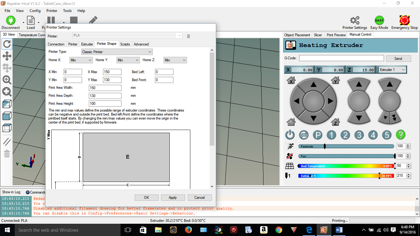

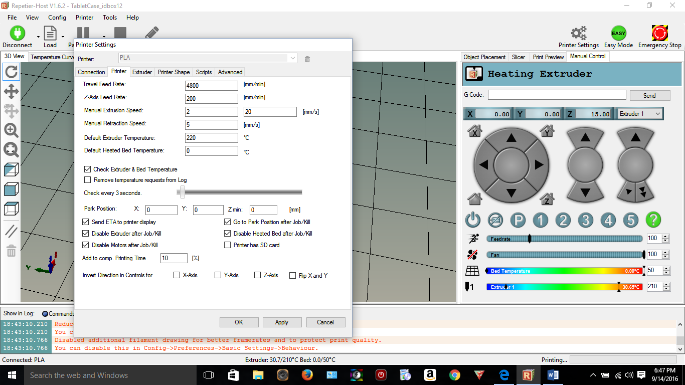

Svelterdread
#17 Posted : 24 June 2017 08:49:14
Joined: 14/09/2016
Posts: 13
Points: 42
Location: elkton md
Sorry about the delay, illness in the family.
I reinstalled the software and followed what you did in your post. But before that and still the extrusion heater fan does not work. If I unplug it and plug the Idbox cooling fan in its place it works fine. Voltage on the power supply is fine. I plugged in another fan and it did not work.
It did try and print , went through the motions however no filament was extruded so nothing printed. Temperature. was correct , should have printed. even with a new nozzle wouldn.t print. Finally during the last print attempt the program locked up and had to use task manager to close it.
So it won't print and the fan doesn't work.
Vince
Svelterdread attached the following image(s):
pcasier6@gmail.com
