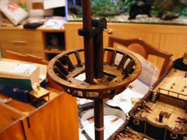

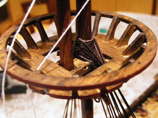

#3 Posted : 26 February 2017 11:17:55
Hi John
Martyn is correct here. The hole in the base of the fighting top should run port to starboard and the holes for the masts in the crosstrees should run bow to stern. Here is a couple of pics of my fighting top. Follow the instructions as per the amendment. Hope this helps...Cool Cool

Thanks Martyn and Alan
Oh bother...I've gone and drilled all the holes now, so they are in the wrong orientation...Blink No worries I'll re-drill and plug the redundant ones...Cool

Hi Alan
I have not yet glued the crosstree on, (luckily), but I have drilled all the holes in the top rim as per the drilling plan from issue 112 - which has not been amended. So now, by turning the fighting top 90deg., all the holes are misaligned. I have now plugged all the holes with wood putty...a nice Jarrah colour!...Cool
When dry, I will sand smooth and then re-drill all the holes as required by the revision...BigGrin
Thanks for the pics Alan, a picture tells a thousand words...Cool
