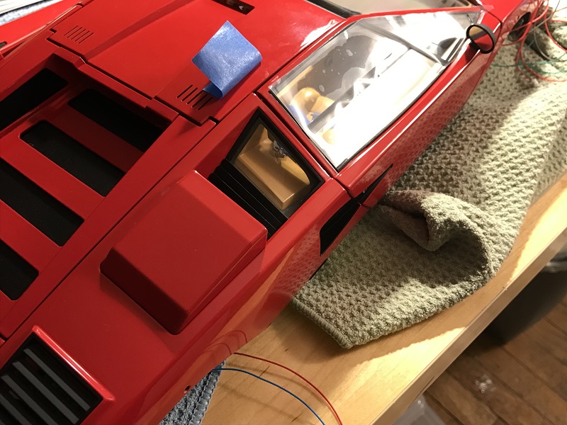

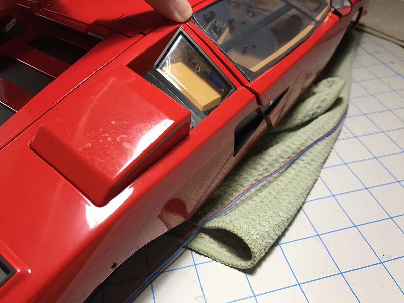

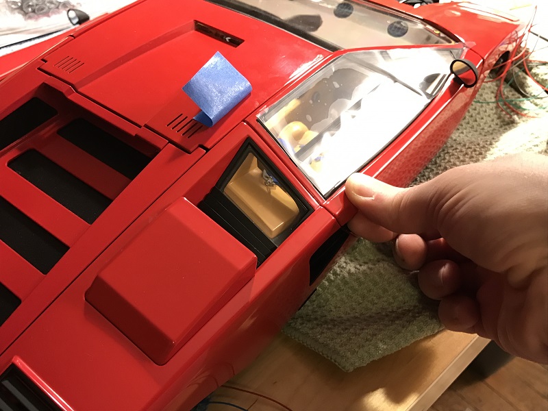

Sure. This is my first post with pics so hopefully it came through.
The pics are slightly out of order. Starting with the second you can see both doors. The left (driver) door fits perfectly - nice and flush on all the edges. The right is angled off the body slightly. When I use my finger to pin it to the body you cans see the results in the first pic. The bottom of the door doesn't follow the contour of the body. The way the hinge is constructed it's hard for me to imagine that the hinge is improperly angled thus creating this skew but who knows. I welcome anyone's thoughts/views

Hi Rich
I have been looking at my completed build and with the doors unlatched there is a fair bit of lateral play, and when the doors are allowed to drop on their own they do seem to sometimes rest in the same position as yours. The difference is that mine will lock into place as soon as they are pushed inward.
Seeing as the hinge only fits in one way then I doubt this could have been fitted wrong. Does the door stay in the open position on its own? This should mean that the hinge and hinge lock are fitted correctly.
Im wondering if this could be a problem with the lock not engaging rather than the hinge being mis-aligned? With the door open does the lock move in and out when the lock button is pressed?

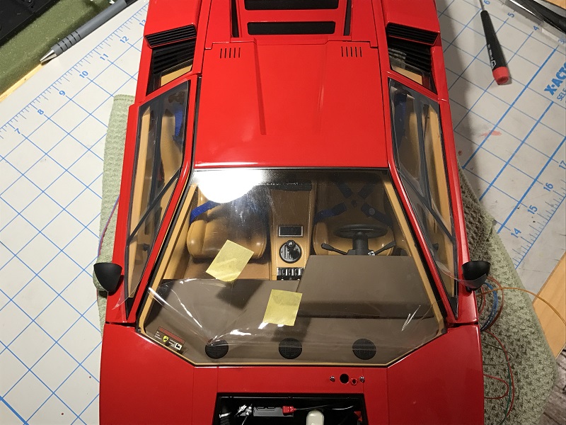

OK I'm almost there... I reattached everything and the right door fits but is super tight. The left door almost fits flush but the door lock mechanism pushes it out slightly.
The first pic shows the door when I press the lock in - everything is flush. The second shows what happens when the lock engages. I think I need to shave/reshape the door lock slightly to get it to fit.
My assembly/disassembly process has shown me there is an alternative way to assemble the front end. The instructions suggest that the builder attach the doors to the front fender and then attach the enter assembly to the body. I found this to be very cumbersome and difficult to get the struts to fit through the slots. You need an extra set of hands and even then its a tricky. It is possible to instead leave the doors off, attach the front fender to the body and then attach the doors. By flipping the model over you can still get to the screws that hold the door in place. I found this to be a much easier way to assemble everything.
