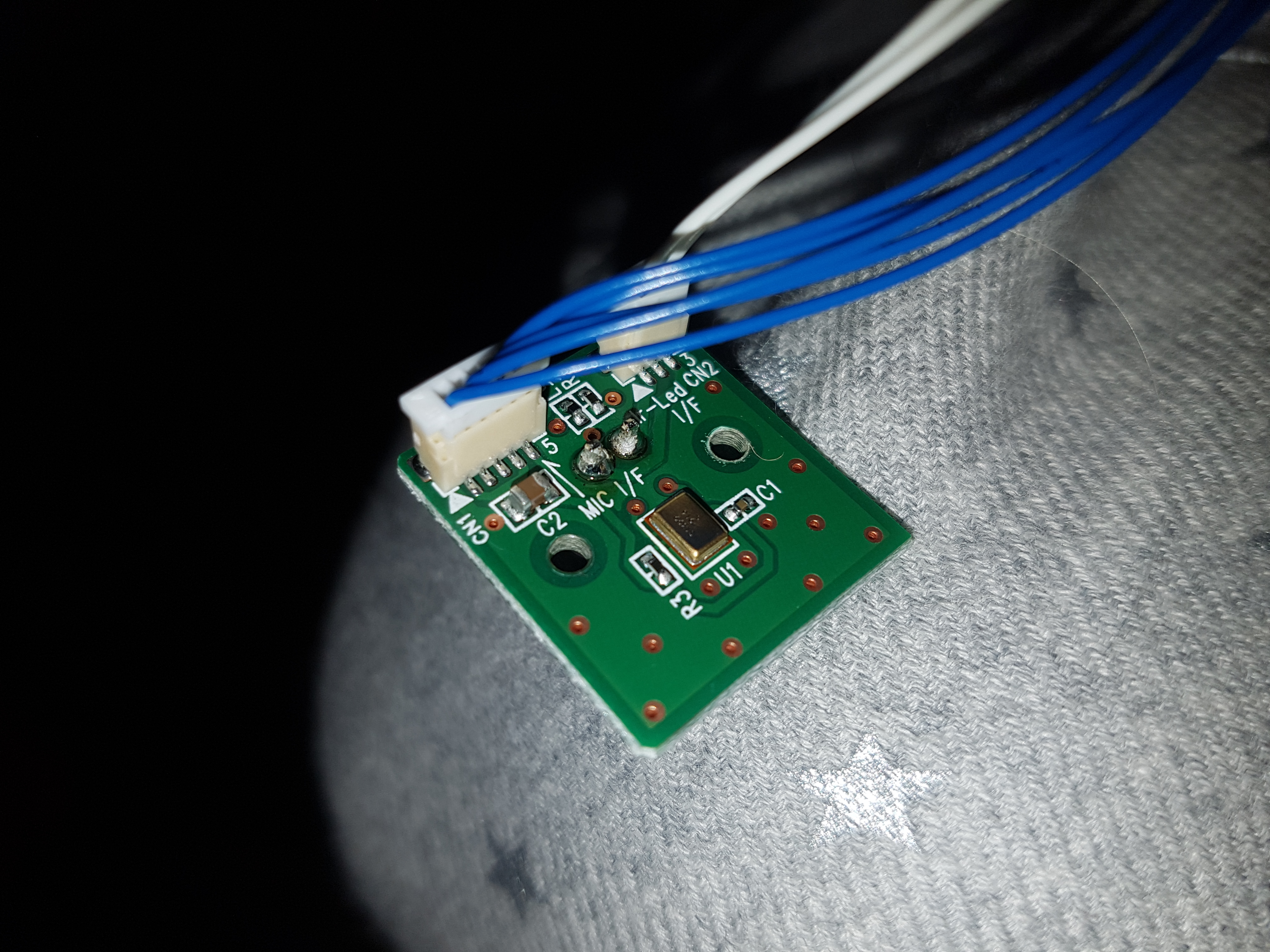

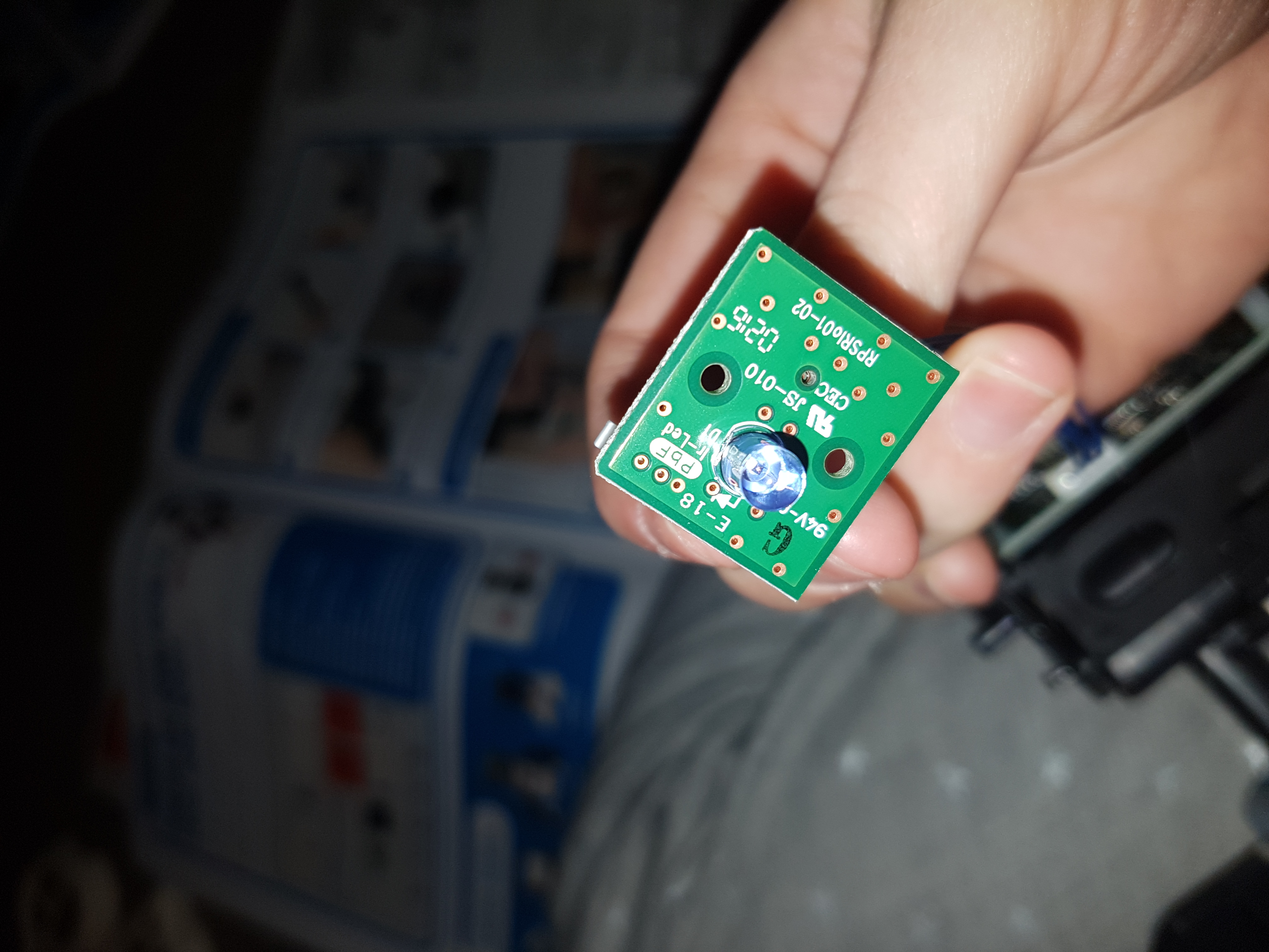

Joined: 11/01/2017
Posts: 12
Points: 39
Yes i ubderstand this. I can still for half an hour and he still has not responded. Iv found the board that says mic but i cannot see a mic on that board

Hi Steph
It sounds like you may have a faulty microphone board, this is fitted on page 526 stage 69 in magazine 18 can you first double check the connections and try the test again.
If still no reaction then a replacement stage 69 will need to be reordered.
By the way in pack 18 did you receive the ' Living with Robi' magazine on the back page is a usage tips that contains advice on talking to Robi.

Points: 39
Hi yes iv tried all connections. My partner has also checked everything for me. How do i go about getting another board?
#10 Posted : 11 January 2017 18:41:23
Hi Steph
To get a replacement ring C/S on 033303001516.
Have your subscription number ready and ask for a replacement stage 69 from pack 18
