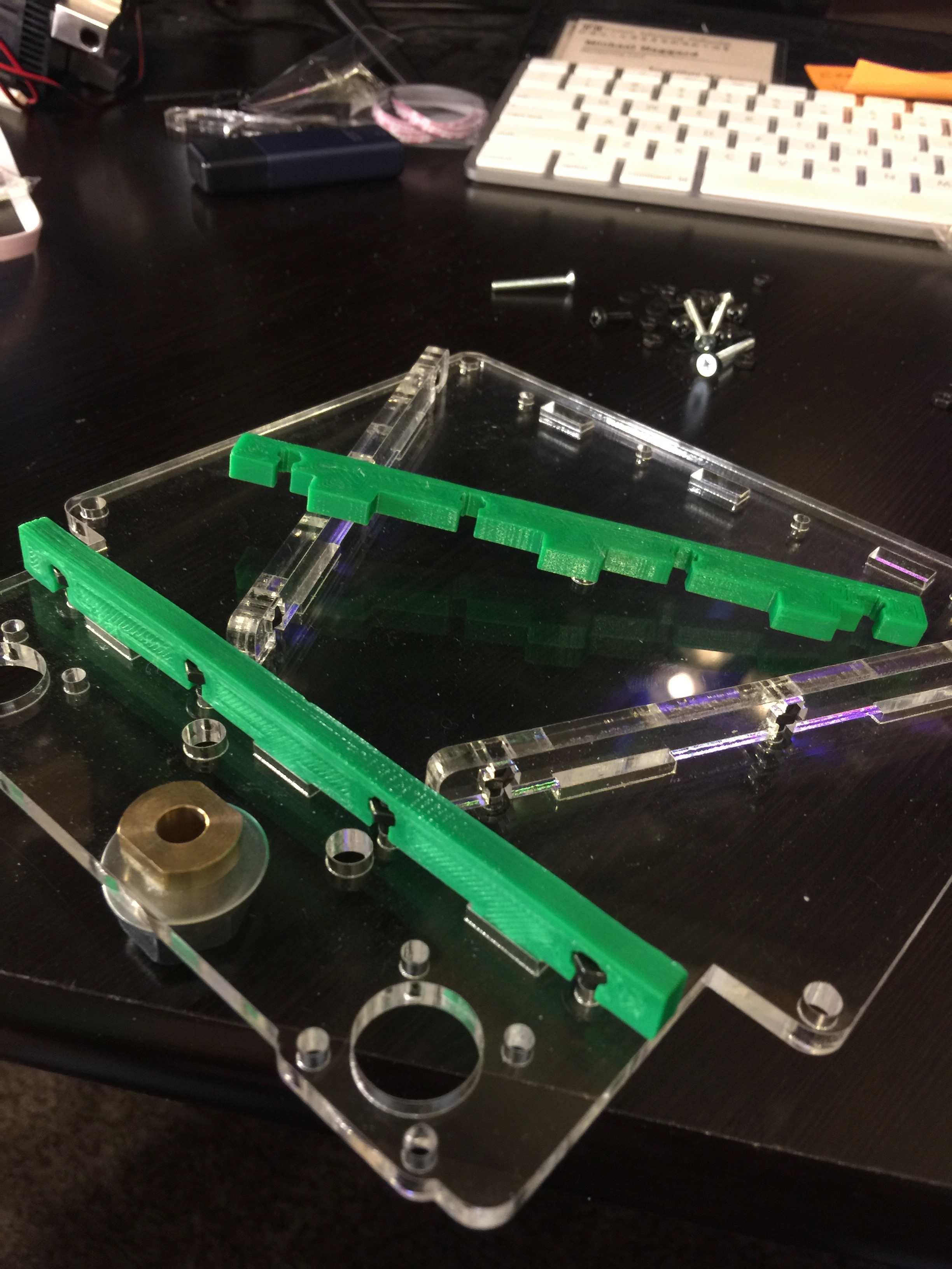

Hello. For the past 12 years I have been living in Taiwan. The 7-11 chain in Taiwan for 2016 sold the idbox printer one issue at a time each week for a year. I have all the boxes now, but have moved back to the USA. I have finished building the printer. I have plugged it in, connected USB, and gotten the software to connect to the printer. The fans come on so power is not an issue. The green icon lights on the computer screen, the software says connected... but no other communication. The lower part of the screen says waiting for temperature and all commands pile up in the queue and never get sent.
Since my books are all in Chinese, I have been trying to glean the forum for info... my chinese is limited... especially reading. Any troubleshooting assistance would be appreciated.
I am familiar with 3D delta printers. I even had some parts missing and broken from the shipment from Taiwan to USA and just designed new parts in CAD and printed them on my Delta printer.
