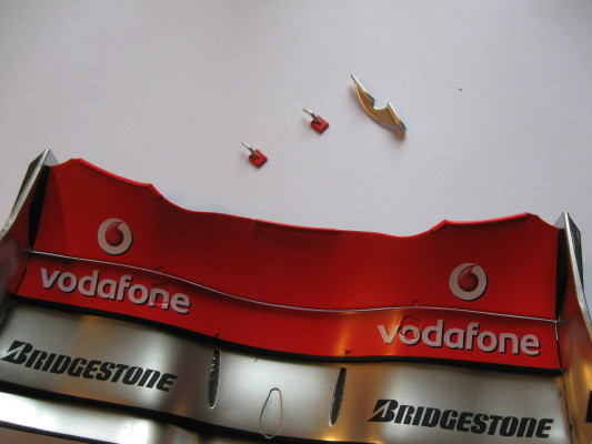

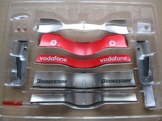

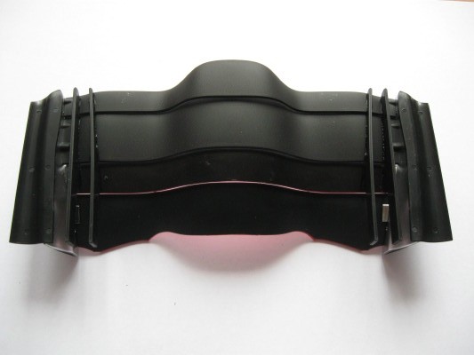

Issue 1 - Contains front wing parts, a mini '00' Phillips screwdriver and 600 grit abrasive paper; and has build step's for the start of the front wing section.
Miniature screws, ABS glue and Superglue are all used for the assembly of the wing. The build steps contain clear information on the glue/screw points.
Before assembling the wing parts you will need to remove paint from the indicated area's noted within the magazine steps, which is to ensure a good bond; removal of paint can be done by gentle scraping with the edge of a model knife blade and abrasive paper, taking care not to damage the surrounding painted area.
Once the paint has been removed from the indicated area's, the assembly starts with front flap being fixed to one wing end, which is followed by the front wing and then the opposite wing end.
The middle flap and rear flaps are then installed, followed by the front wing centre stay, and finally the two flap stays (avoid applying too much glue to the centre stay).
Later in the series, a decal will be supplied to add on top of the two flap stays to complete the 'n' and 'o' in each of the two Vodafone sponsor decals (left and right).
The wing section and upper front wing should be carefully stored for further assembly at a later point.
This completes the build for issue 1.

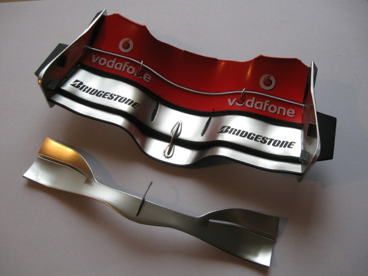

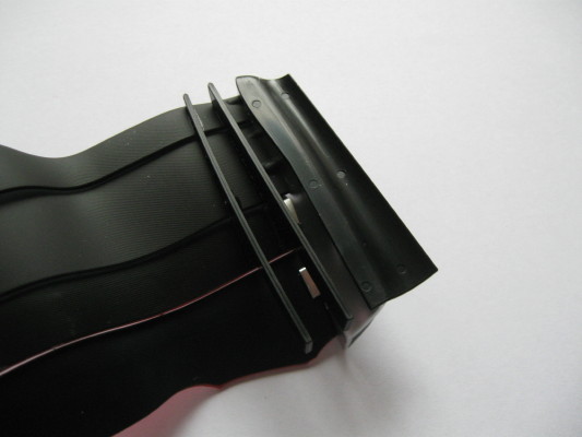

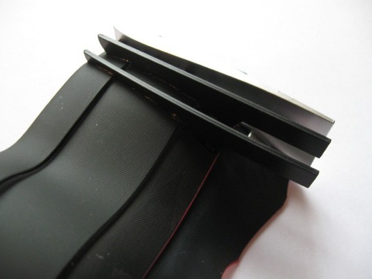

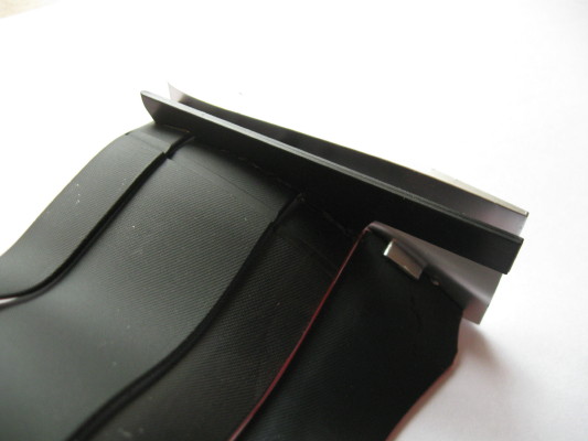

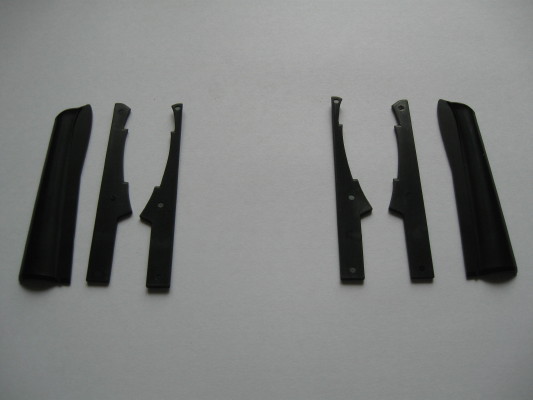

#4 Posted : 30 March 2011 15:05:16

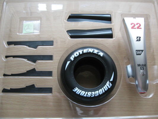

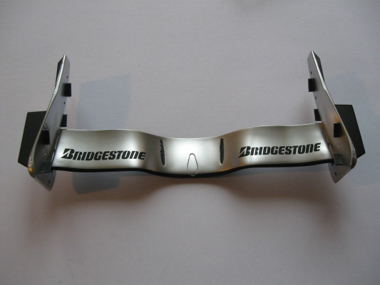

Issue 2 - Contains a front tyre, nose upper section, Mercedes decal and front wing underside fins; and has continues the assembly of the front wing.

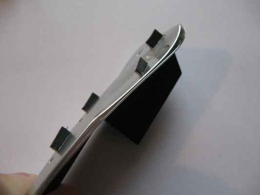

The fins need to be fixed in place with ABS adhesive, take care not to apply too much adhesive and ensure that it does not come into contact with any painted parts.
Identify where each fin is to be located onto the underside of the wing and that each fin is located into its corresponding groove, and that the fins sit upright and at right angles to the wing.
For a good bond of the left/right-hand end plates (parts 6/7), you will need to remove the silver pant from the flat surface of the left/right front wing end plates, this can be done with such as a nail-file emery board.
This completes the build for the underside of the wing, which should be carefully stored pending further assembly.
Carefully store the Mercedes decal and Tyre.

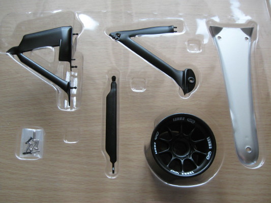

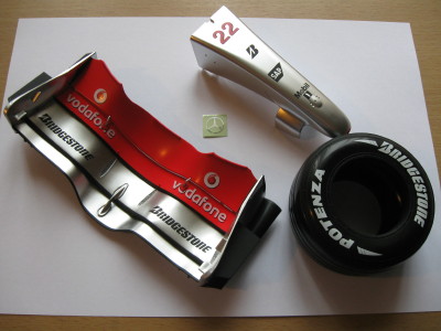

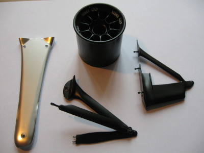

#5 Posted : 07 April 2011 10:20:01
Issue 3 - Contains the left front upper & lower suspension arms and pushrod, front wheel rim, underside nose section & fixing screws; and has the assembly of the front left suspension.
The suspension parts have been cast in metal to mimic the strength and precision of the original carbon fibre components.
Front upper and lower suspension arms - You'll need to remove paint from the ball-joint stubs of the upper and lower suspension arms as per the indications noted in the magazine, this can be done with careful gentle scraping using the blunt edge of a knife blade.
The front Pushrod is then screwed to the lower suspension arm with a type 'B' screw, ensure you locate the pushrod onto the correct side of the suspension arm. - Note that the screw is intended to go in at an angle, so that the pushrod will naturally rise away from the suspension arm as you tighten the screw.
Take care not to over tighten the screw, and ensure no pressure is put onto the free end of the pushrod until the assembly is fixed to the car at a later point.
That's it for this issue, carefully store the remaining parts.

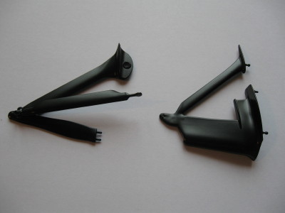

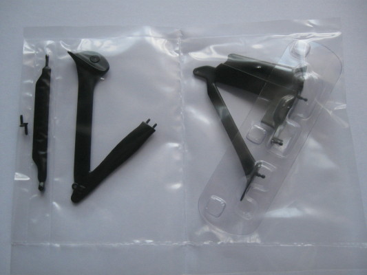

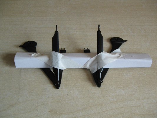

#6 Posted : 13 April 2011 10:11:22

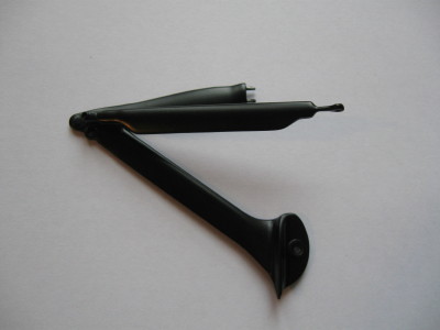

Issue 4 - Contains the front lower/upper suspension arms and pushrod plus fixing screws; and has instruction for the assembly of the front right suspension.
This assembly of parts in this issue is a mirror image of the left front suspension previously assembled.
Front right upper and lower suspension arms - You'll need to remove paint from the ball-joint stubs of the upper and lower suspension arms as per the indications noted in the magazine, this can be done with careful gentle scraping using the blunt edge of a knife blade.
The pushrod is then screwed to the lower suspension arm with a type 'B' screw, ensure you locate the pushrod onto the correct side of the suspension arm. - Note that the screw is intended to go in at an angle, so that the pushrod will naturally rise away from the suspension arm as you tighten the screw.
You have now finished the sub-assemblies for the lower and upper front suspension arms, it will be some time before you are ready to fit them in place, so store them carefully to ensure they are not damaged.
It is important that the open ends of the lower suspension arms are not squashed together, as this will put strain on the joints; therefore to prevent this from happening, fold some card into a 'V' form, locating it under each pushrod, and secure by masking tape.

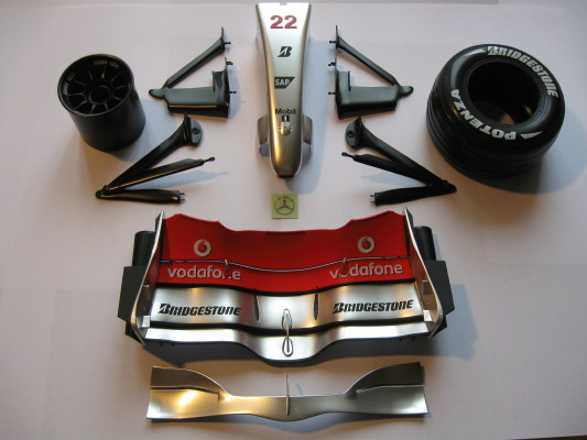

The final photo shows what we have so far in the first four issues.
That's it for this issue!

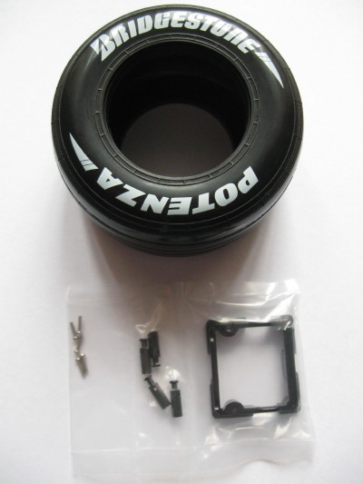

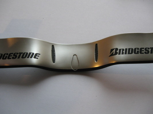

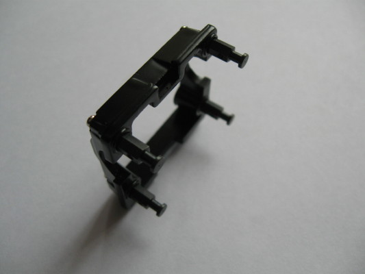

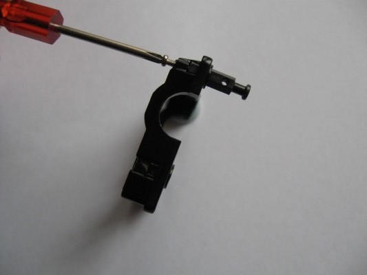

#7 Posted : 20 April 2011 09:22:32

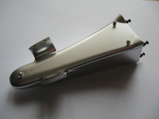

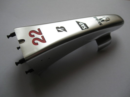

Issue 5 - Contains a front tyre, nose plate, nose pins & fixing screws; and has instruction for the fixing of the nose plate and nose underside panel.

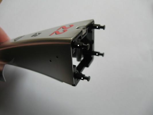

Fixing the nose pins to the nose plate - The nose pins are fixed so that the hole within each pin is aligned top to bottom, i.e. parallel to the longer side of the nose plate - and should be secured with 'D' type screws.
Attaching the nose to the nose plate - Insert then nose plate into the upper part of the nose so that the protrusion in the nose fits into the socket on the nose plate, push it home until it clicks into place.
Attaching the nose underside - Align the screw sockets of the upper and lower nose sections and fix together with three 'C' type screws (from issue 3) and tighten the screws about half way, then check the panel alignment and then fully tighten each screw to close the panel gap, be careful not to over tighten the screws.
That's it for this issue, carefully store the nose and remaining parts!
