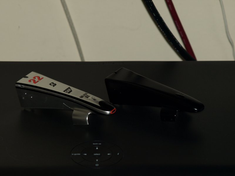

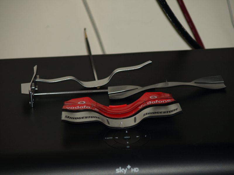

As of this morning I have not received anything from Degostini with regard to my order but that does not stop me from moving along either so I decided to pop into Smiths and buy 2 copies of the first issue for the above project. Below are a few shots of the first issue and one with the Minichamps 1:18th to show a size comparison as to how big this kit is going to be... Further updates will be added as i go along week by week and i hape you all enjoy reading about my builds as much as I'm going to enjoy doing them BigGrin
Spencer

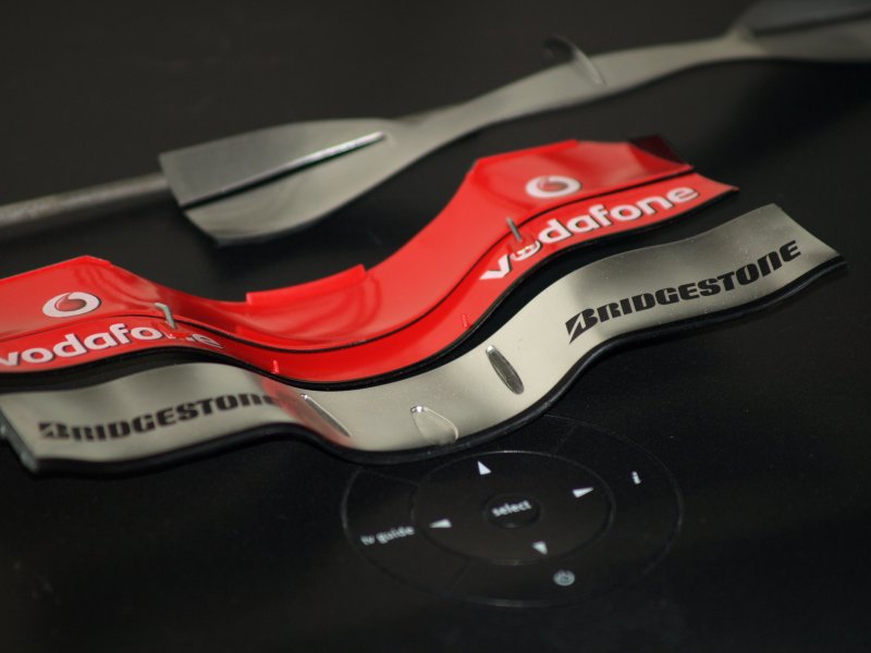

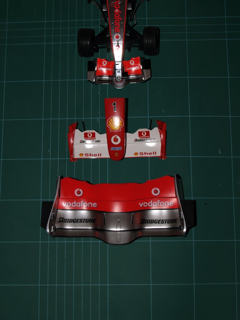

#5 Posted : 27 March 2011 22:28:03

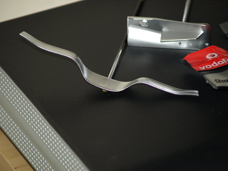

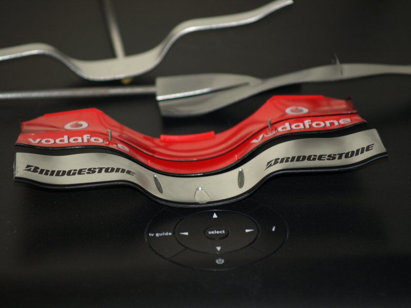

A few shots of the lower wing section. Here I have also taken a comparison shot of a 1/18th wing, 1/12th and the 1/8th...

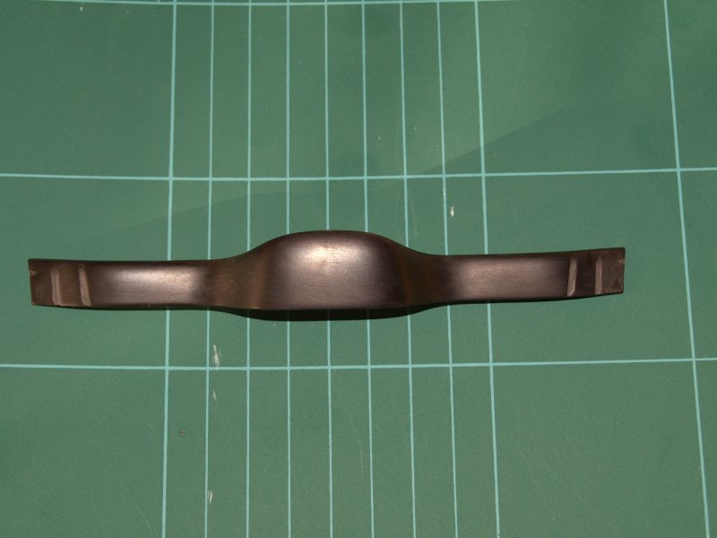

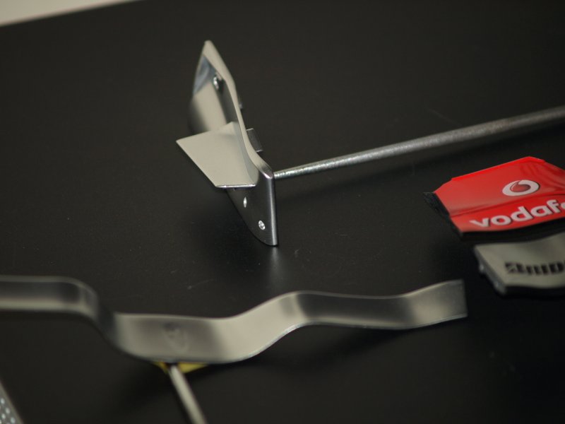

#12 Posted : 03 April 2011 20:07:16

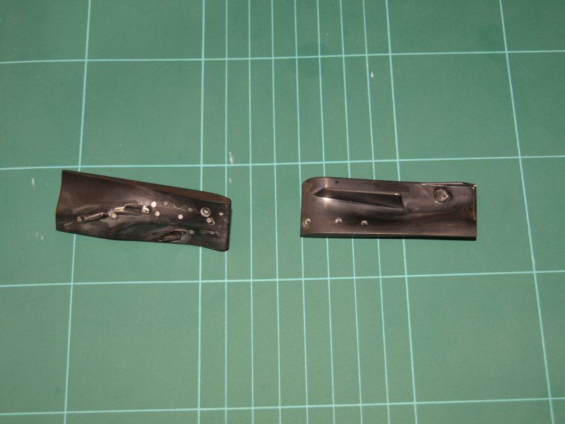

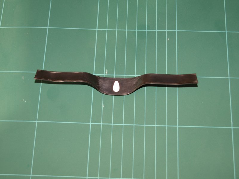

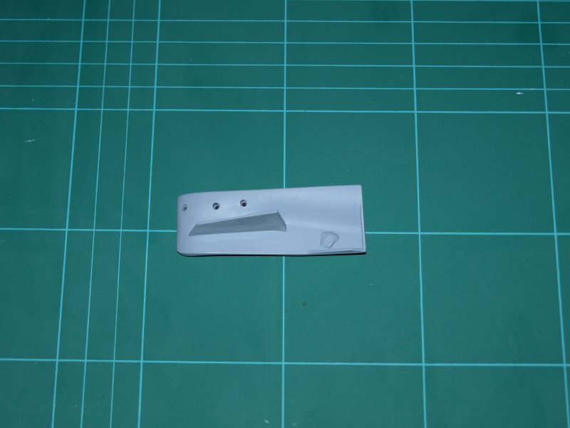

Just a few updates of the front wing section with paint removed and sanded down carbon effect ready for primer.
SennaMentalMe
#13 Posted : 03 April 2011 21:38:43
BigGrin BigGrin Hi Spencer, looking good so far. A lot of work ahead methinks, though stick at it as I think it will be interesting to compare this build with your other standard build (I seem to remeber that you are doing two if I am correct, one standard, one heavily modded??)
I take it that you are remaking or modifying the front wing centre stay as you have filled the oval recess? Strange that the standard wing endplates come with the extra holes on the inner face, which you have also filled I see, as they don't seem to have any function, so why would Kyosho put them there in the first place, very strange even if they are slightly hidden by the upper wing/nose element when it gets fitted later. Maybe Mr T knows about some parts further in the build intended for these holes though I can't imagine what they might be??
What scale carbon fibre decal will you be using as I always used 'Scale Motorsports' 1/12 and 1/20 sheets plus their kevlar, etc, though I haven't seen any carbon decal in 1/8 scale? I don't think 1/12 would look too small if that is what you intend to use??
Anyway well done on your efforts so far and keep the pics coming!! Come on Wednesday .... Hurry up!! Drool Love BigGrin

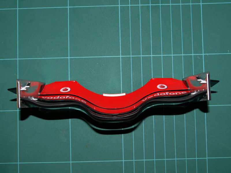

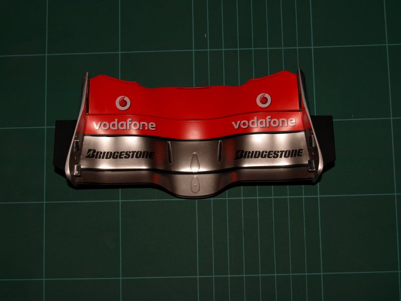

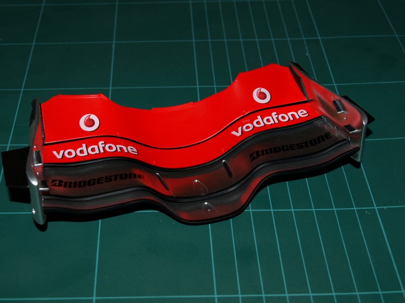

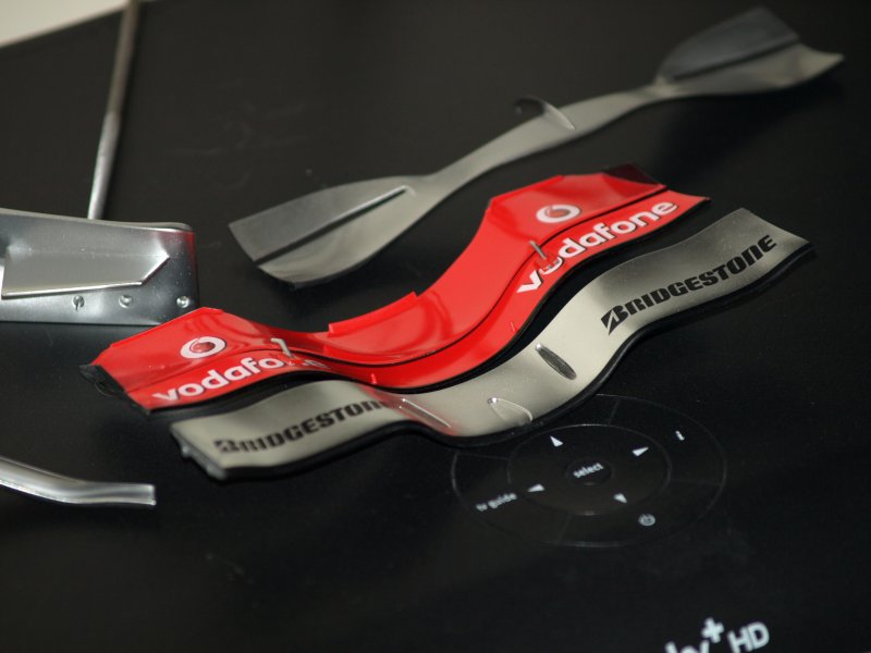

#14 Posted : 04 April 2011 22:36:24
Primmed and played around with some chrome paint this evening and to be honest its not come out too bad. I'm going to try another process tomorrow and see if I get better results.
Kev.. I'm going to be using the Studio27 1/12 carbon decals as the seem to be a pretty good match and likeness. I will be doing 2 builds but how long i can keep up with both is another question lol... anyway here are some pics taked this evening..
Oh and clear coat on the red wings to give a better finish.
SennaMentalMe
#15 Posted : 04 April 2011 23:13:30
BigGrin BigGrin Hi Spencer, great build so far and nice pics thanks for posting them!! ThumpUp The chrome finish you have achieved looks excellent, was it Alclad II paints that you used or something else - hope you don't mind me asking?? Looks very close to the chrome finish on the standard parts so could be useful to know what paints match for touching up, overspraying join lines, etc. as I don't like the look of the joint that is going to be happening soon between the upper and lower nose parts in the next two weeks (though it may be hidden by the decals)?
Never tried the Studio 27 carbon decals, as I said in previous post, I always used the 'Scale Motorsports' stuff which was pretty good and sits down on compound curves nicely with a touch of 'Micro Sol' and 'Micro Set', though was prone to cracking if the sheet wasn't stored flat!!
Your red wing parts look good with the clear coat oversprayed. I still have quite a lot of 'Johnson's Klear' left (discontinued now unfortunately) so will be using that as it dries quite quickly and polishes up really nice and quite scale like in the amount of shine, but does usually need two coats and a gentle buffing.
If you drop one of your builds (not literally I hope!! Blushing), which is most likely to go, the standard or the upgrade??
Well done, keep the pics coming, I will post some more of mine by the end of the week if my issue 2 arrives at the newsagents on Wednesday!!
_____________________________________________________________________________________________________________
Regards ... Kev BigGrin BigGrin

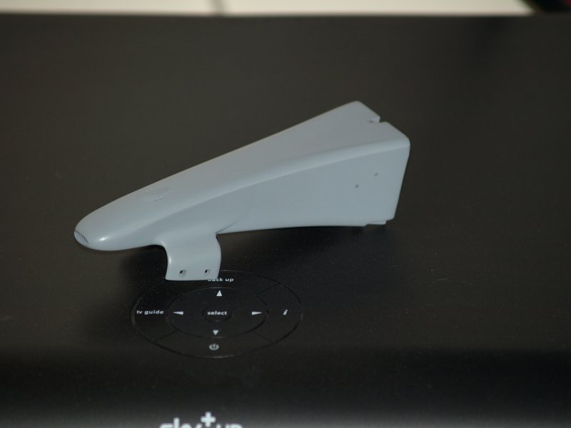

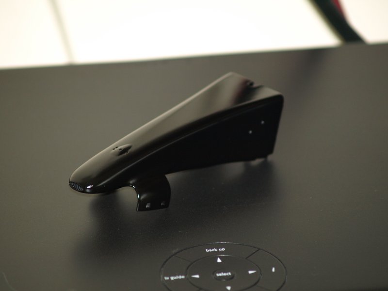

#18 Posted : 07 April 2011 22:25:59

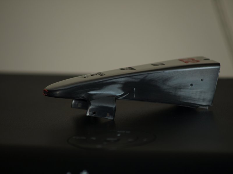

Ok here are some more shots of what I have been doing this evening.. No turning back now!!!
#19 Posted : 07 April 2011 22:29:30

SennaMentalMe
#20 Posted : 07 April 2011 22:40:14
BigGrin Excellent work Spencer, that's what I'm talkin'about!! ThumpUp Love Are you getting one of the (Japanese aftermarket) nose decal replacement sets for this build or are you going to hand spray all the logos with an airbrush ??
This is going to be an interesting diary and I have already decided to change my mind from a standard build and do a lot of extra work similar to what you are doing, the model is well worth it!!

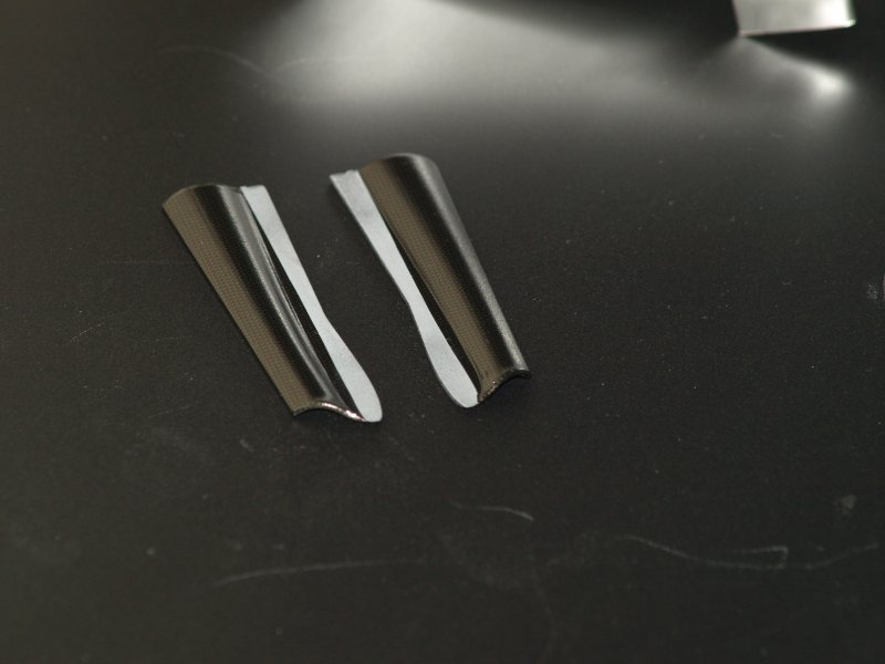

The underwing aerodynamic vanes supplied with issue 2 are too thick I think, so I will be making new ones from thin brass sheet plus using some 1/12 Carbon decal. It looks like you have 'carboned' the shaped vanes on the bottom of your wing endplates - is that using the Studio 27 brand that you were talking about previously, as I have to say, it looks better than the Scale Motorsports brand I used to use, as mentioned in my previous posts?
Great build Spencer Love Drool and I look forward to some more pics, will post some of my own once I have got everything ready to go!!
