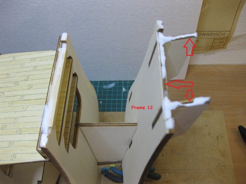

#3 Posted : 25 September 2016 08:11:16
In the first photo below (German build), as marked by the red arrows, you can clearly see that top of Frame 12 and the aft deck supports have not been sanded and the top of Frame 12 not angled, and no where in the German build does it show the top of Frame 12 having been angled nor does it even mention such!

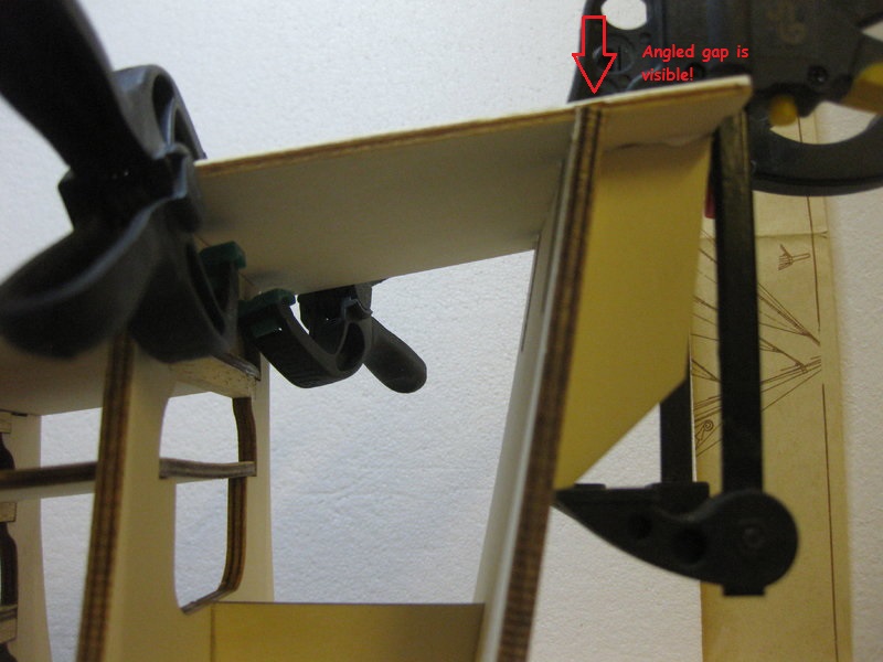

In the seccond photo (German build) which shows the deck glued in place, if you enlarge the image you can clearly see an angled gap between the top of Frame 12 and the underside of the deck as indicated by the red arrow, which indicated that the top of Frame 12 has been left as supplied (square cut).
I can see that in Stage 20 the german builder has filed the end of the deck so that it meets flush with the transom, but this has nothing to do with how the deck sits upon Frame 12 as indicated by your drawing at post #93
