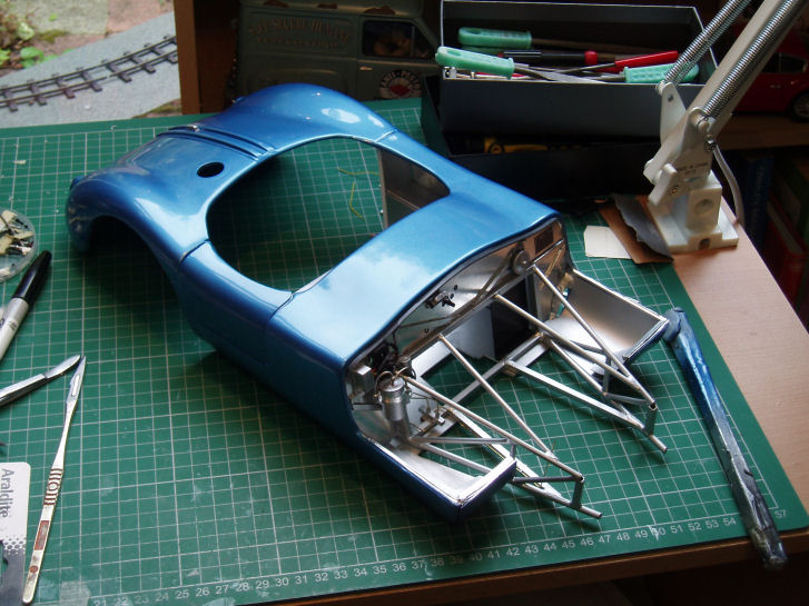

I've been quietly working away at this one for over 6 months as a 'fill-in' build while I was building the Ferrari 250 GTO (on the forum here somewhere...)
It was an old scrap shell from a previous C Type build, and was gathering dust in the garage.
I was about to bin it but decided to build it as a 'workshop' car - on axle stands, no bonnet, door, one seat out, no wheels etc - so the innards etc could be seen.
It was also going to be old English white.
However, it's now going to be the blue Ecosse car, number 19 and I might build it as a complete car - still undecided.
The body is fibre glass with brass engine/chassis frames.
Firewall, floor, inner panels are sheet plastic. Engine etc cast in resin by me.
LOTS more to do...
Hope you like it.
Roy.

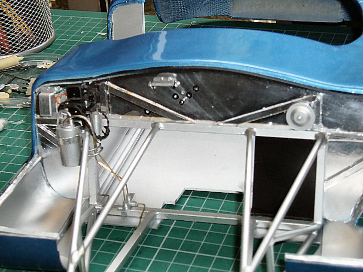

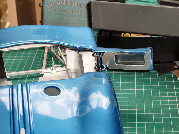

Just a little more...
Some bulkhead details added.
The regulator box face was done by printing a photo of a real box (Google images) on clear transfer film.
When added over the painted box, it looked pretty good - I hope.
The engine lamp was cast in resin and the bracket made from flattened Coke-tin metal.
Roy.
#8 Posted : 10 August 2016 11:30:03
Unbelievable stuff ! Please keep posting pictures.
How are the chassis frame members joined? by epoxy?
Keep up the great work.
#9 Posted : 10 August 2016 17:36:07
Pretty impressive stuff Roy!
I'm always fascinated watching people scratch build, I'm sure this will be yet another stunning turn out from you
#10 Posted : 11 August 2016 13:30:15
Posts: 5,058
Points: 15,320
Thanks guys.
Yes, the chassis tubes are all epoxied - I haven't learned the dark art of soldering stuff and epoxy allows me to move bits about as it's setting, if it isn't quite right.
Roy.

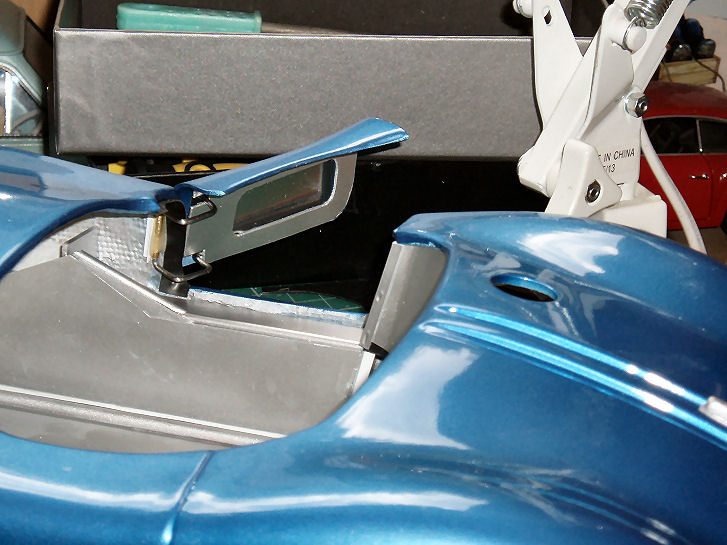

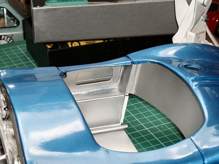

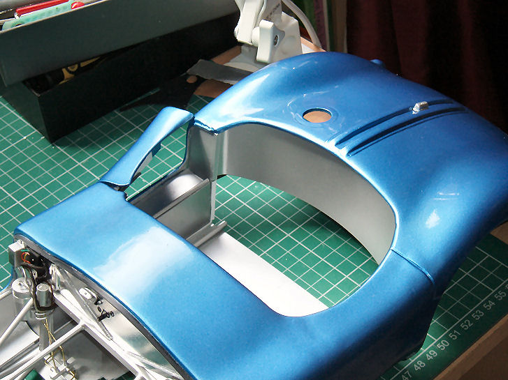

I've now added the drivers door - hinges made from brass rod bent into a 'dog-leg' and inserted into brass tube epoxied inside the body.
The door was taped in place for a good fit, then the hinges attached inside the door skin.
It will all have inner panels covering the gubbins eventually.
I also added a rubber seal around the body door opening so there's no light gap when the door is closed.
A small amount now also added on the firewall.
More on the interior next, then fit the engine...
Roy.

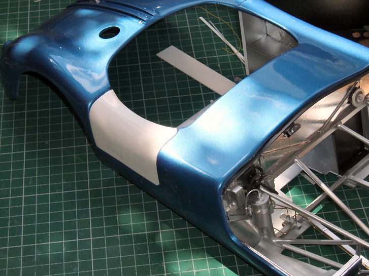

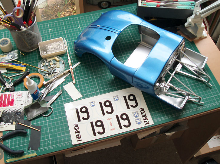

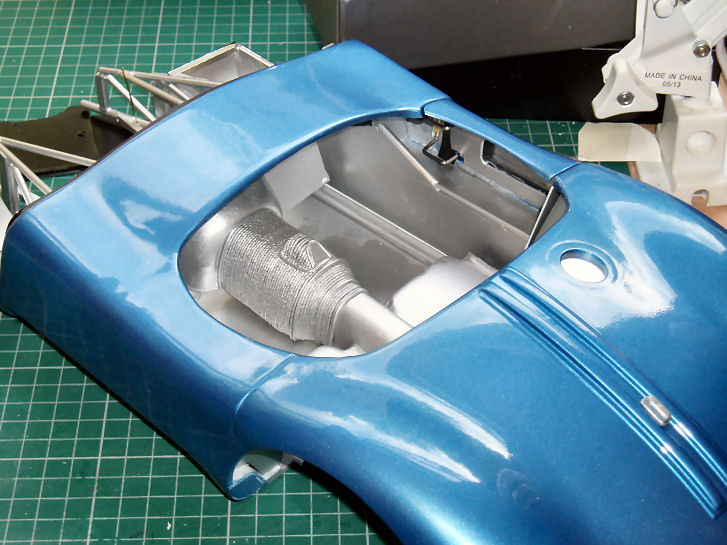

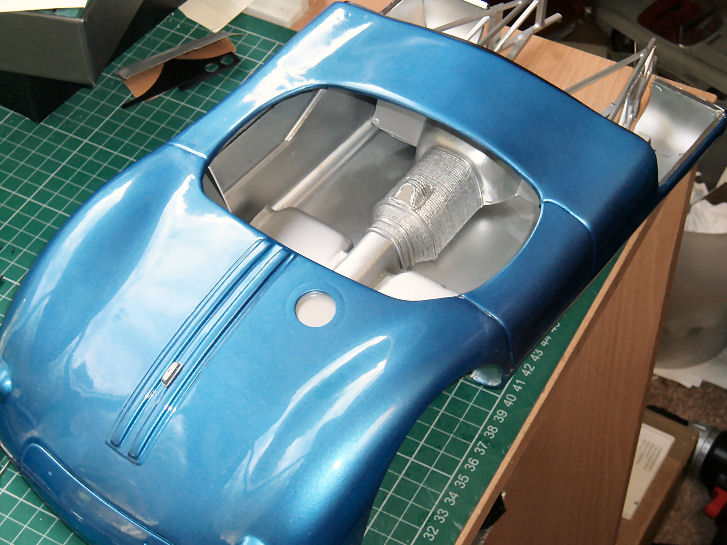

Just a bit more today...
I've added the inner door panel and started building up the rear of the cockpit but I'm not happy with it.
Not quite the right shape so it just might all get heaved out again...
Roy.
#16 Posted : 15 August 2016 11:02:11
Posts: 5,058
Points: 15,320
Forgot to add the pics...

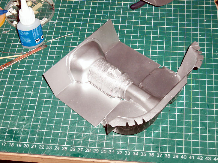

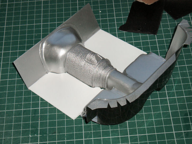

Hello chaps.

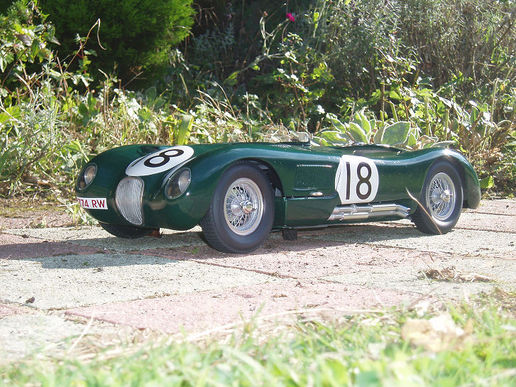

The interior parts are moving along slowly.

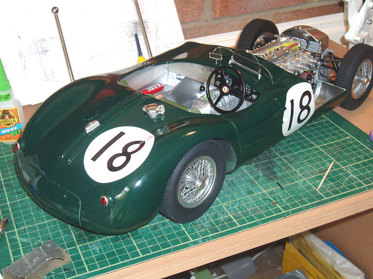

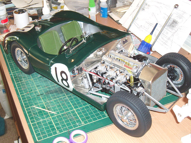

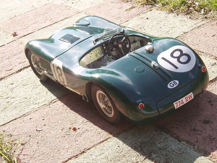

The rear wall and tunnel are made from a very poor moulding taken when I built my first C Type model a few years back - a few pics of that one attached.
The covering on the tunnel was made by the tedious job of binding the whole thing with thin nylon cord and using wire to make the edge binding.
It's reasonably close to the actual car.
Lots of tubing and other stuff to add before fitting the innards into the body permanently.
Roy.
First - My original C Type - my first ever scratch build:
