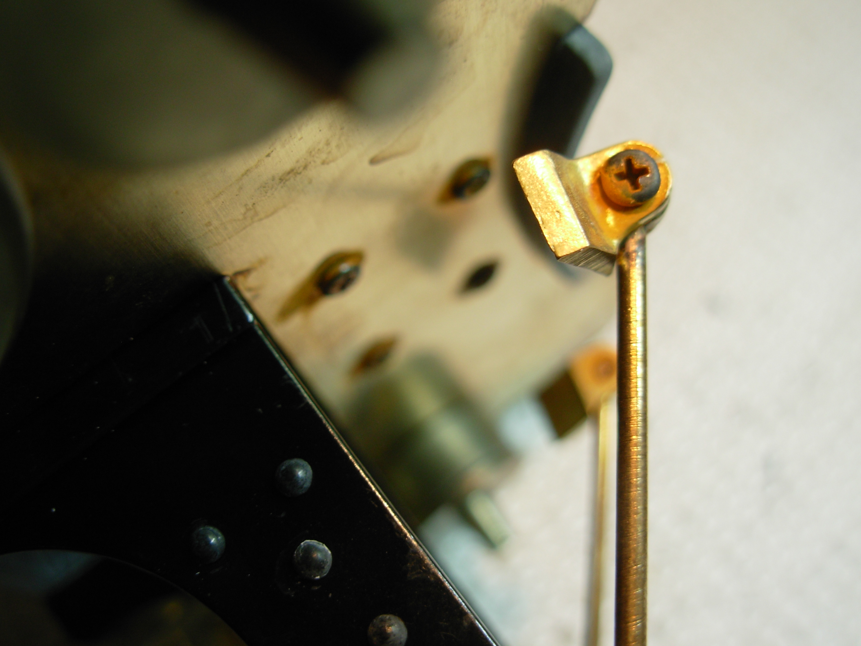

After looking through other build diaries, I decided to paint the cylinder/underframe assembly before the suspension and other details were added.
I followed the following process, which seemed to work fine on the front steps:
A soak in Simple Green for de-grease, followed by a vinegar bath to help paint adhesion and then air dry.
What I found looks like the screws rusted, causing stains around each screw hole. By removing each screw I am able to remove the stains,but I wonder what I did wrong.
#2 Posted : 05 August 2016 17:56:36
If your vinegar solution was with water then air drying it will have caused oxidation, hence the rust. I always use a blower with my compressor to dry or even a hair dryer.
#3 Posted : 05 August 2016 18:02:19
The de-grease removed the grease and the lacquer from the screws this allowed the vinegar which is a mild acid to attack the screws causing the rust to form.
You may now need to seal the screws to prevent the rust returning under the paint job by using a rust eater solution like they use on automotives
