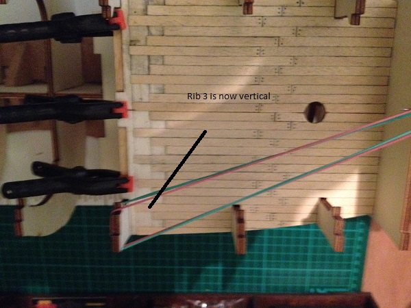

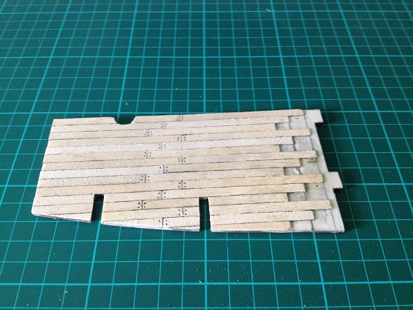

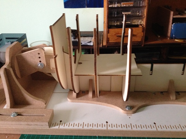

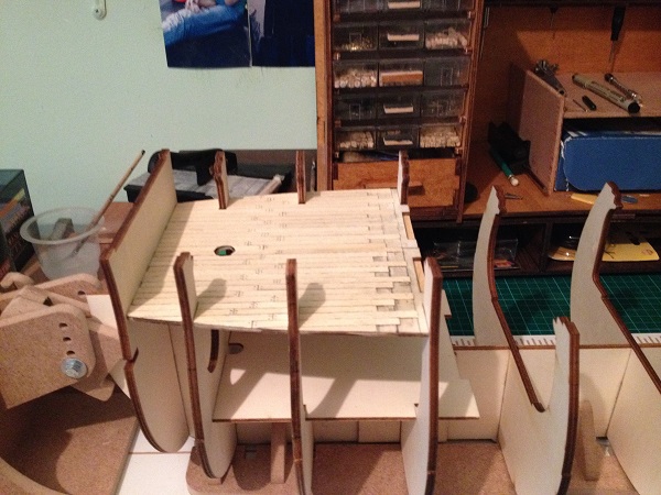

I didn't manage to do a build diary properly for my Victory. Hopefully I will do better with this one.
At first glance the wood is top class not to sure about the planks I found them a bit flimsy, and looking at the instructions I couldn't fathom out the spacing for stage 1 it all seemed a bit Iggledy piggledy. So i took a bold step (for me anyway) to change the spacing to a more uniformal one , will it pan out who knows just have to wait and see. So here we go. Stage 1 and 2 are complete.
That's it for now

#2 Posted : 28 July 2016 10:49:54
Very nice start looking good
#3 Posted : 28 July 2016 10:51:33
Welldone. Nice start on her. Look forward to more.

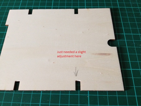

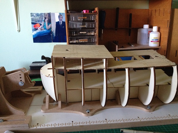

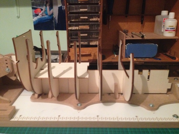

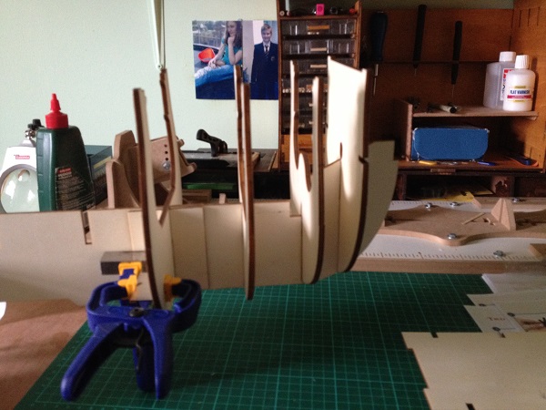

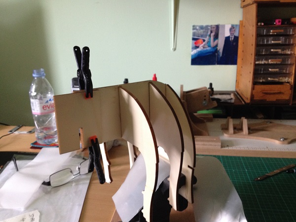

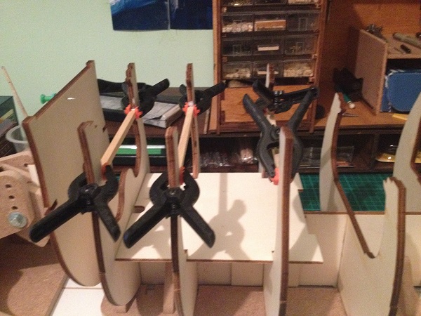

Stage 3 & 4 completed. I had to do a slight adjustment on one of the decks to make it fit properly other than that no problems. happy days

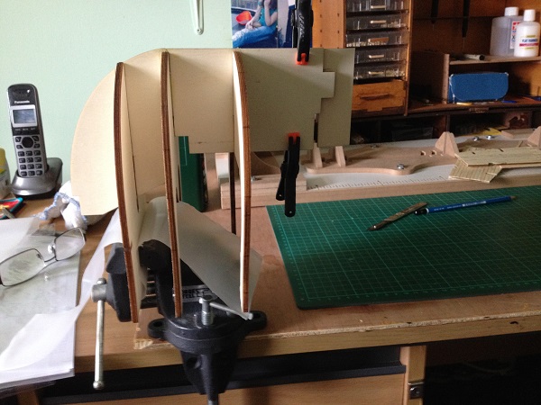

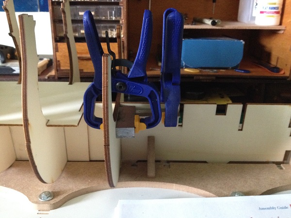

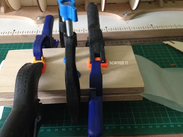

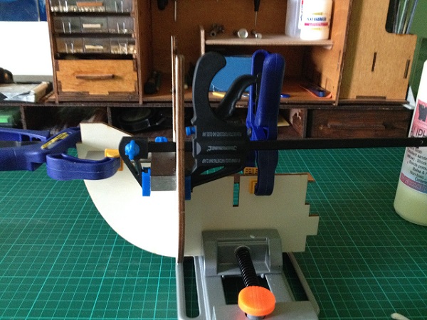

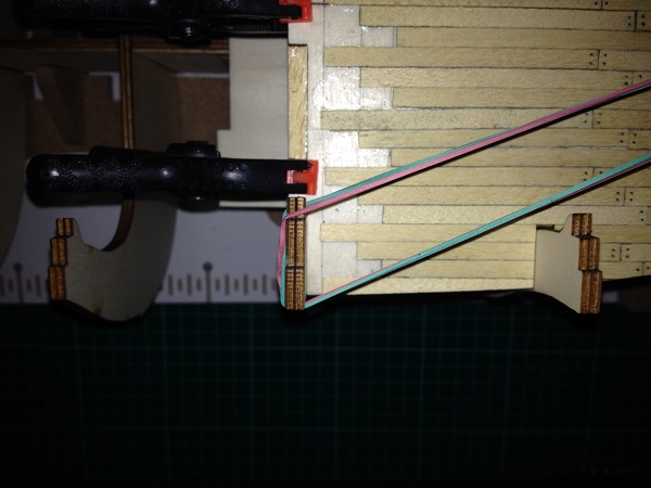

Stage 5 completed only a slight problem sorted it with an elastic band

#6 Posted : 29 July 2016 17:18:49
Nice work mate. Doing a really good job on her. Look forward to seeing the next update.
#7 Posted : 29 July 2016 21:48:03
Nice fix and a very nice start
#8 Posted : 29 July 2016 23:36:31
Looks like you off to a great start and I like the care and attention you're applying.... Keep doing that and you'll end up with a great build..... Look forward to your next update....

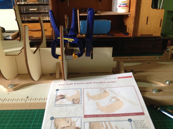

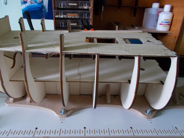

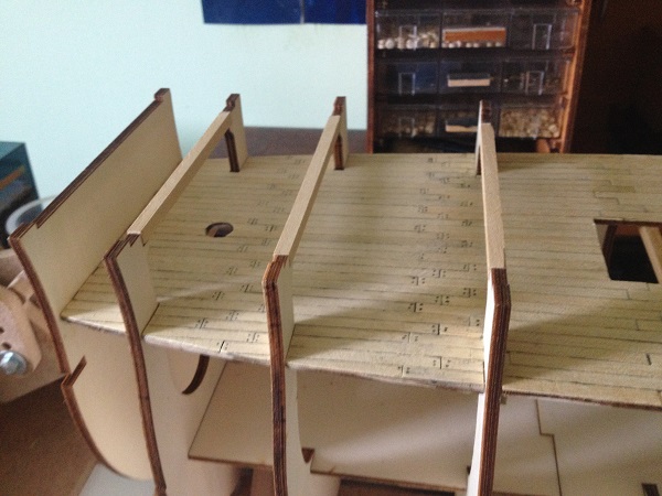

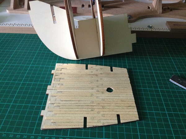

Stages 6 & 7 completed.
I really do not like the wood used for the decking it is so flimsy It was difficult trying to cut the planks where the grating is going without the wood splintering in fact it did a couple of times, hopefully the gratings when fitted will cover those up.
eebygum attached the following image(s):
#10 Posted : 30 July 2016 13:32:08
Looking good
With the cutting of the planks around the holes I placed a metal ruler on the planks and then ran a sharp scalpel across them several times which seemed to do the trick

#11 Posted : 30 July 2016 13:35:40
Joined: 18/08/2015
Posts: 294
Points: 897
Location: Amesbury, Wiltshire
Thanks Dave I will try that next time

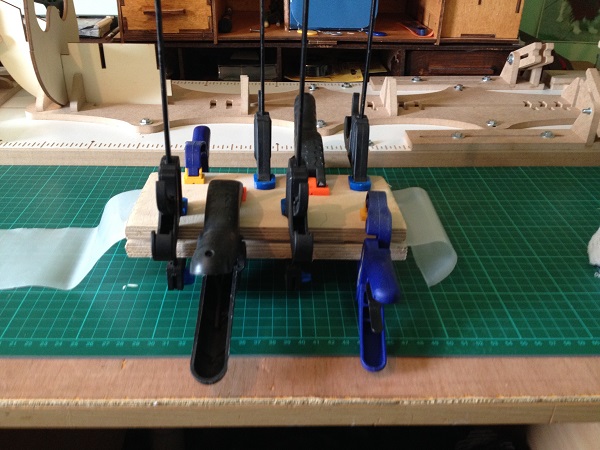

Stages 8 and 9

#14 Posted : 31 July 2016 08:51:57
Looking good Terry . I had the same thing with the wood on the San Felipe I found by soaking the wood for a few minutes and letting them dry it stopped it happening. Hope this helps rgd Martyn
eebygum
#15 Posted : 31 July 2016 09:10:20
Joined: 18/08/2015
Posts: 294
Points: 897
Thanks Martyn I will try that on my next deck. do you know what type of wood is used for the decking by any chance?
cheers
Terry
#16 Posted : 31 July 2016 09:19:28
The wood used for the decking is Lime wood Strips.
Your doing a great job on her Terry.
#17 Posted : 31 July 2016 09:20:35
Hi Terry I am not building this model but looking at the wood I think it's basswood
#18 Posted : 31 July 2016 09:24:29

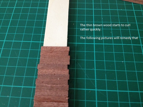

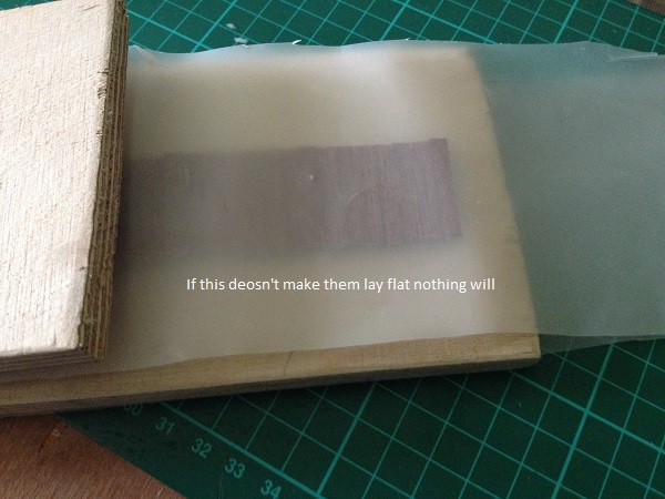

The brown wood is Sapele too.
What I use to stop the Sapele curling is evostik impact glue. Put a thin coat on the strip and a thin coat on the ply. Wait to dry for about 5 minutes then place them together. BUT you only get one attempt as once together they dont come apart easily.
