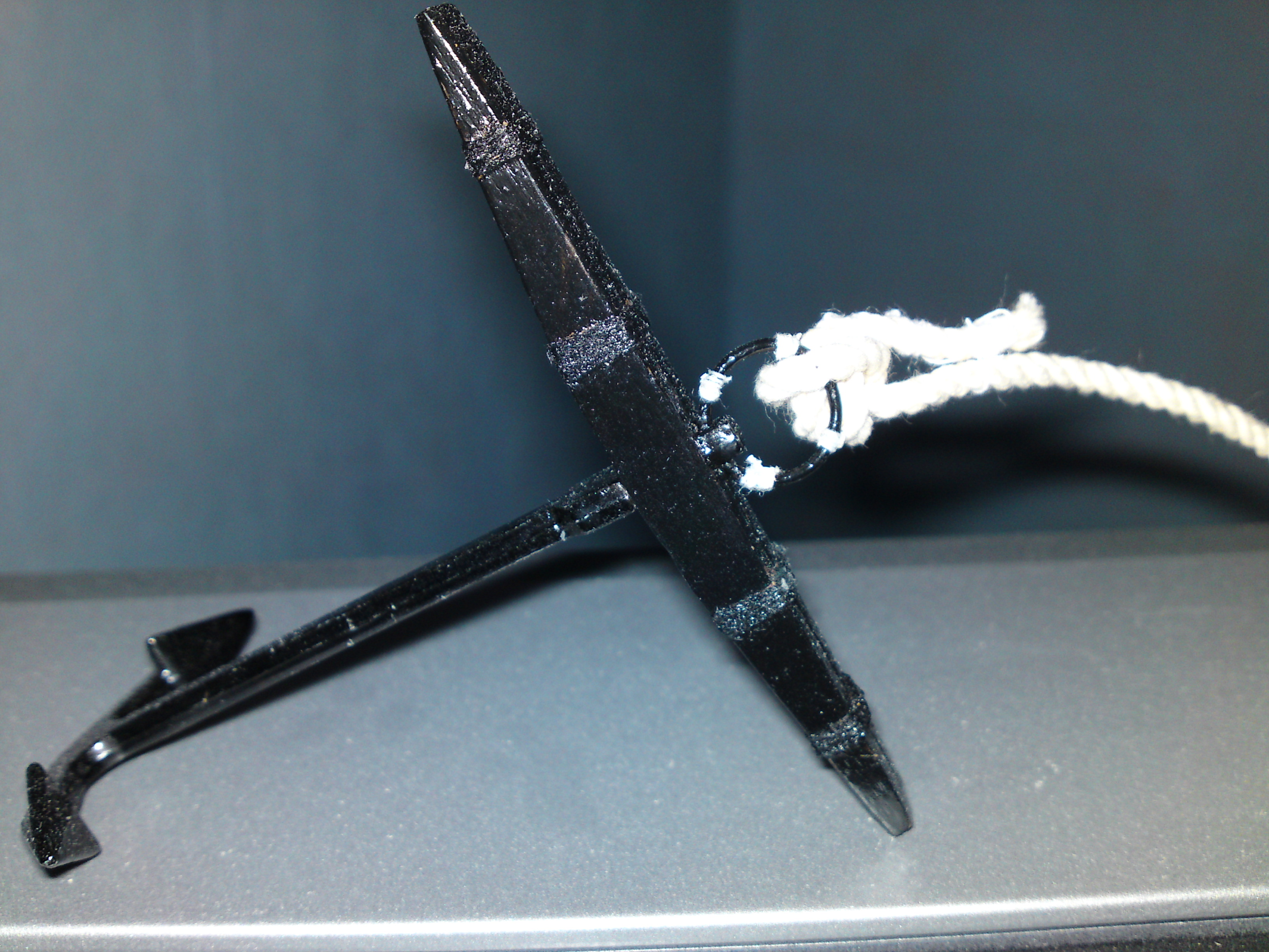

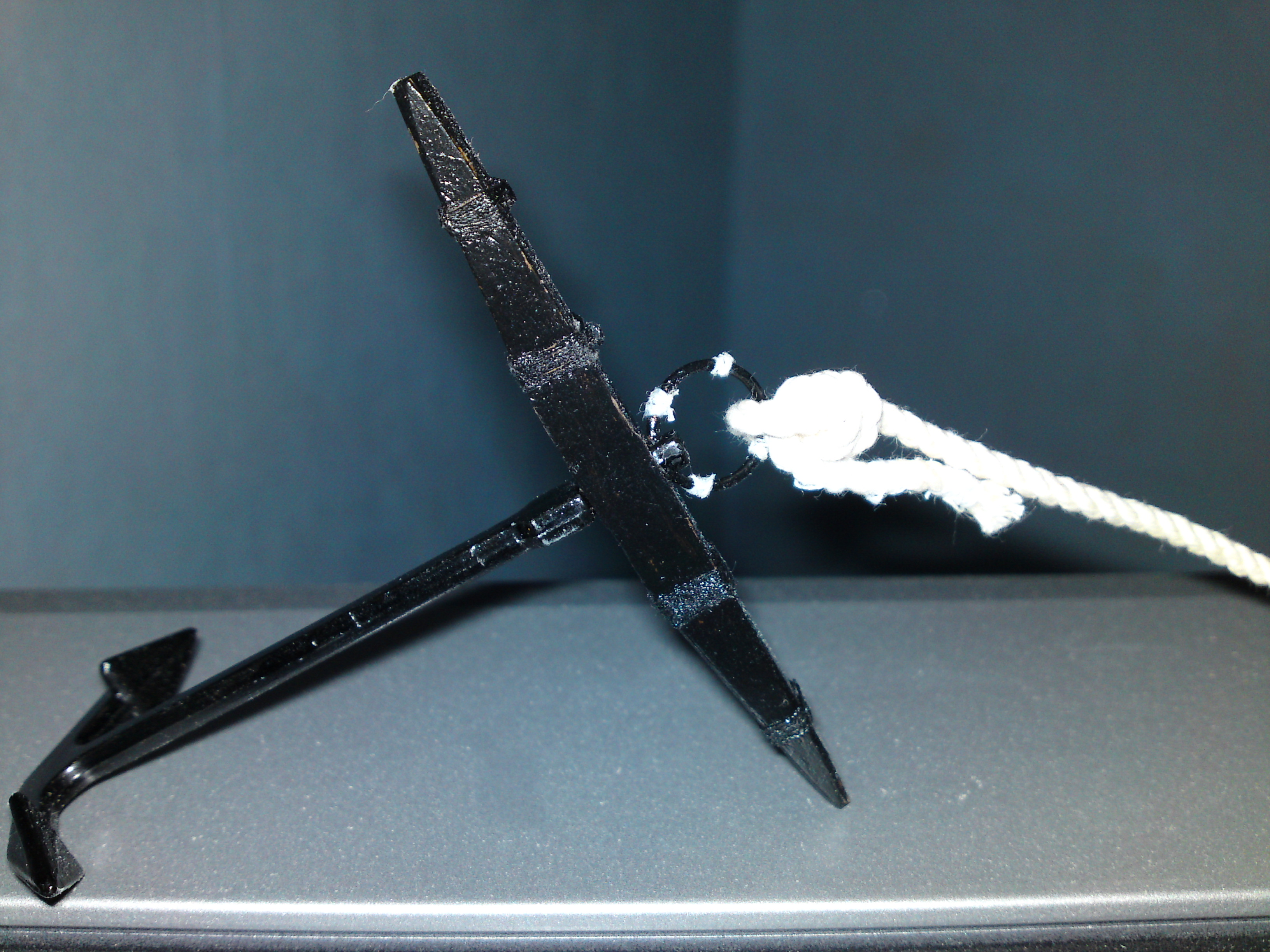

Anchor redone with puddening

Got to have puddening and siezings, right? It's fiddly but well worth it. well done.
I still reckon that the supplied anchor rope looks way too dark. Might I suggest that you try bleaching it? (overnight, neat bleach).
Schnellboots on back burner
Tools.
#5 Posted : 07 April 2010 22:11:17
i agree the anchor rope is way to dark. i was thinking about bleaching then soaking in a waterd down paint to ad a tint

Cheers, the puddening and seizing was very fiddly but looks better with it.

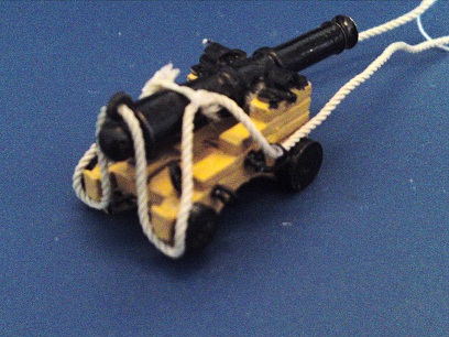

Redone the cannon, idea from Jase. Looks ok but again very fiddly. Purchased 0.8mm thread from Miskin models, eyes from garden wire.

Salutations for attempting the securing rope over the barrel Blink *claps*
Most fiddly indeed! I salute your skill with the string!
My only critique (and its only a small one) would be that the rope is all of the same thickness and looks slightly out of scale with the cannon - it also looks a little 'floaty'. Have you considered painting the rope down with either some thinned varish before probing it into shape, giving the illusion of weight? (This will also reduce the wooliness of the twine by dampening down most of the stray fibers

Thanks for that, will be considering your suggestions and will more than likely give it a go.
#9 Posted : 08 April 2010 23:33:33
love the cannon humbuled that i have offerd insperation. for my part i yesterday purchased some green stuff after seeing what a differance it can make. its great we can all share and learn!!BigGrin

Hi, love the new and improved cannon!! The extra work that you have put into it has really payed off.BigGrin

Anchor redone, 15mm ring and 2.5mm rope, rope maybe out of scale but will be able to tell better when attached to ship.

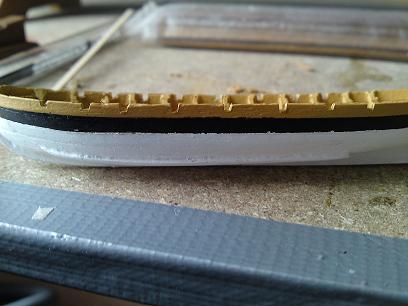

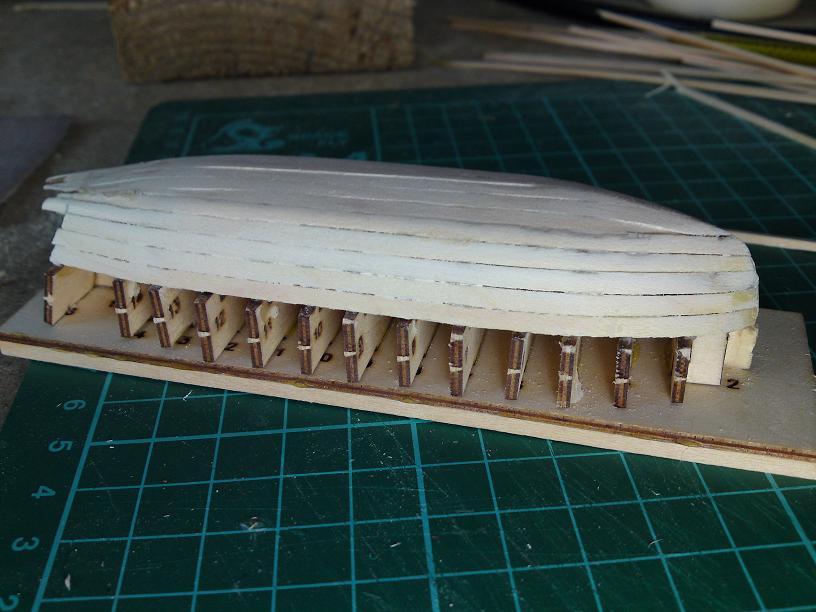

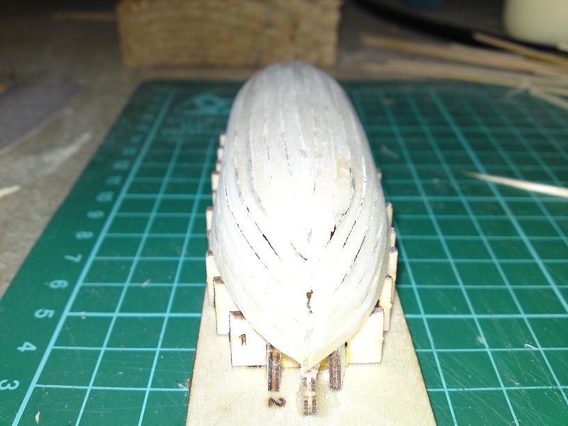

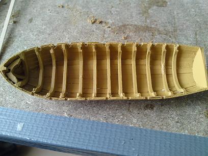

Launch planked, i did not use the planks supplied but some i had left over from another build that went badly wrong, hate cameras cause they make everything look really bad. The gaps should not really show when painted.

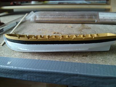

Launch now painted and despite how the launch looked in previous post no filler was added, the sanding sealer covered the small gaps. The paint job is not brilliant but i struggle with the painting, i have watered down the paint and applied 4 coats of white and its not too bad.
