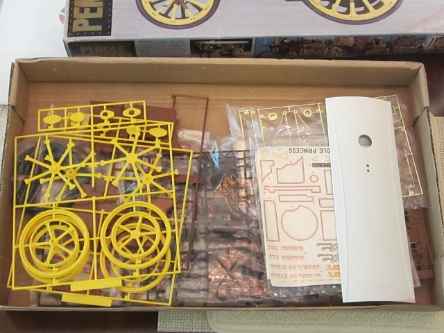

Thanks to Mr T I managed to get hold of one of Bandais 1/16 traction engine kits.Awesome detail in this kit.I am going to build it and also use it as a template to scratchbuild a 1/8 scale version.

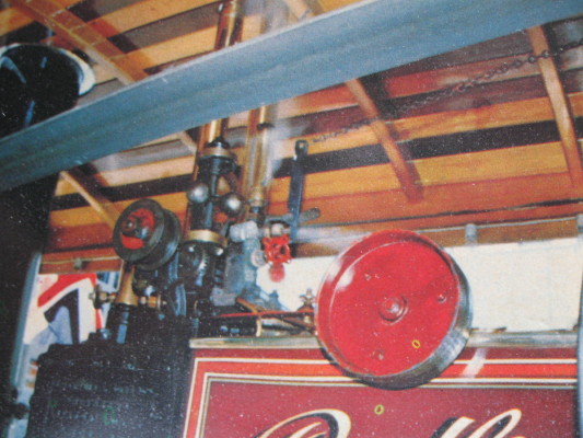

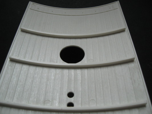

One criticism of the roof canopy authenticity, the underside of the canopy in the kit is depicted as having simulated wood slats side by side. In reality these slats should be spaced apart as depicted in the photo below, the space being roughly the width of a slat. To add realism, you could opt to lay lengths of thin wood veneer strip alternately laid and paint black between. The veneer strips will also add depth to the look of the slats.

I found this last picture very interesting. My research had confirmed that the roof was constructed with slats and spaces, not solid. But this is the first photo I have seen with detail. What beautiful woodwork. What do you think the material over the slats was, or is? I had fealt that given the 1919 time period it was probably tenting canvas material painted gray but I really have no idea. Your thoughts?

The normal canopy method was a wooden framework with linen canvas on the top which was PVA coated to stretch/seal it, then painted in a colour of choice. There would be a textured finish to it which is why the plastic canopy has a slight texture feel to it.
The canopy underside photo is on the side of the orginal box (white background), there was two version of box art for this kit, the second is shown in darbyvet's photo above, which only has colour photos of the completed model and without the real canopy photo, no idea why, but I am guessing that Bandai realised they had dropped a clanger showing a photo of the real canopy which exposed their error, hence the removal of this photo from the box art of the second production run.

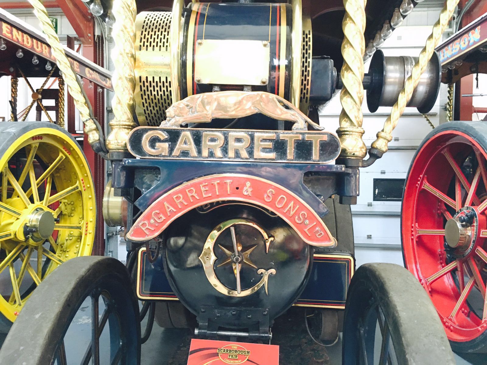

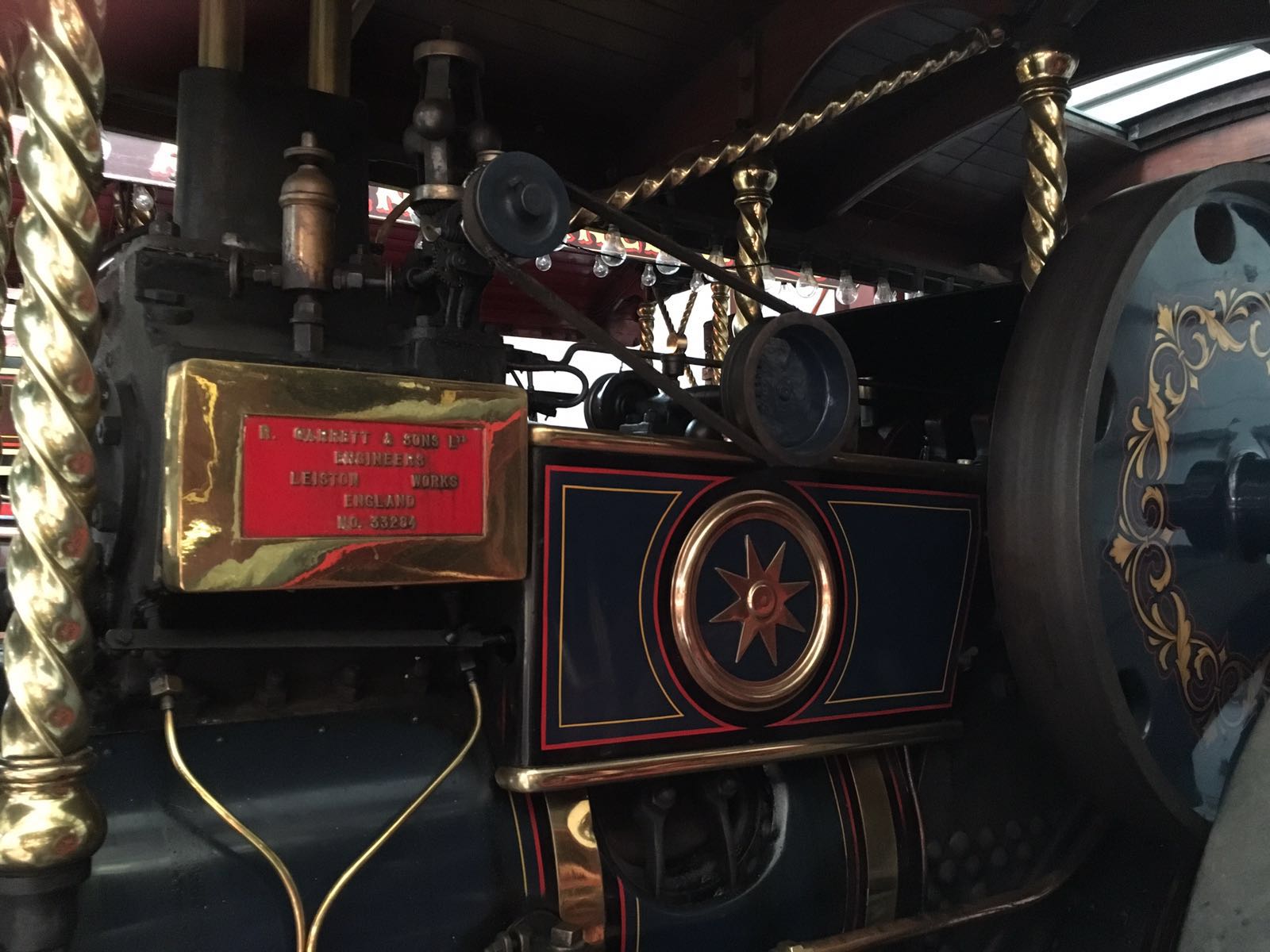

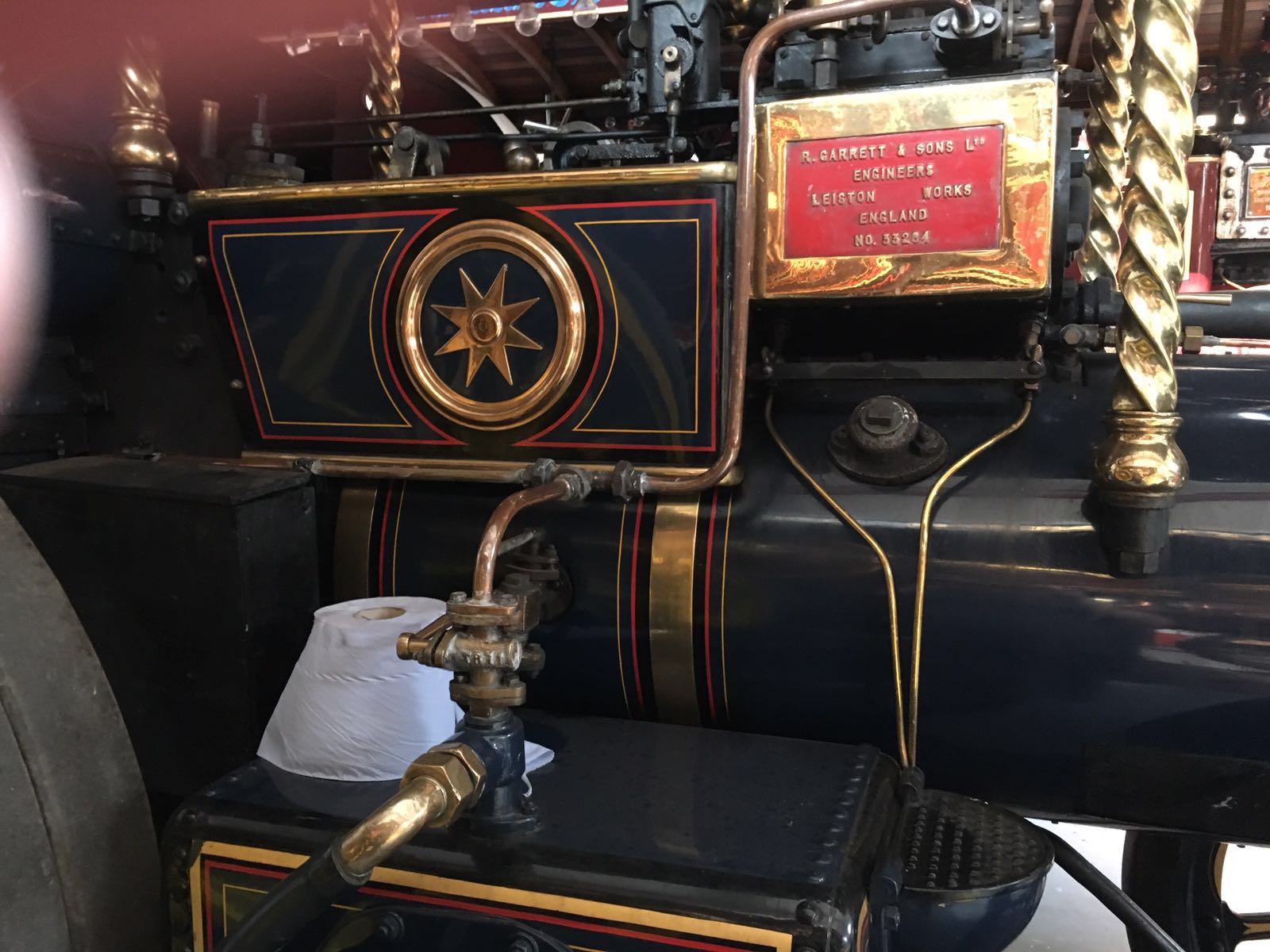

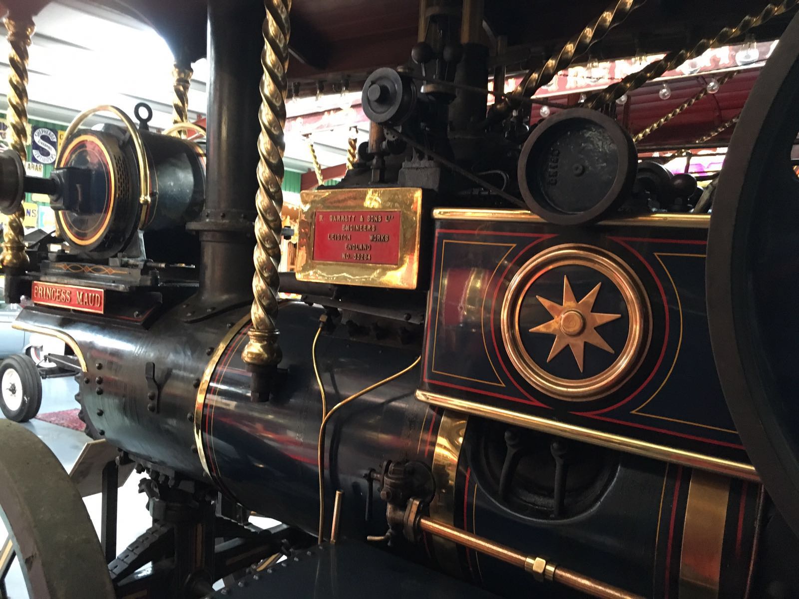

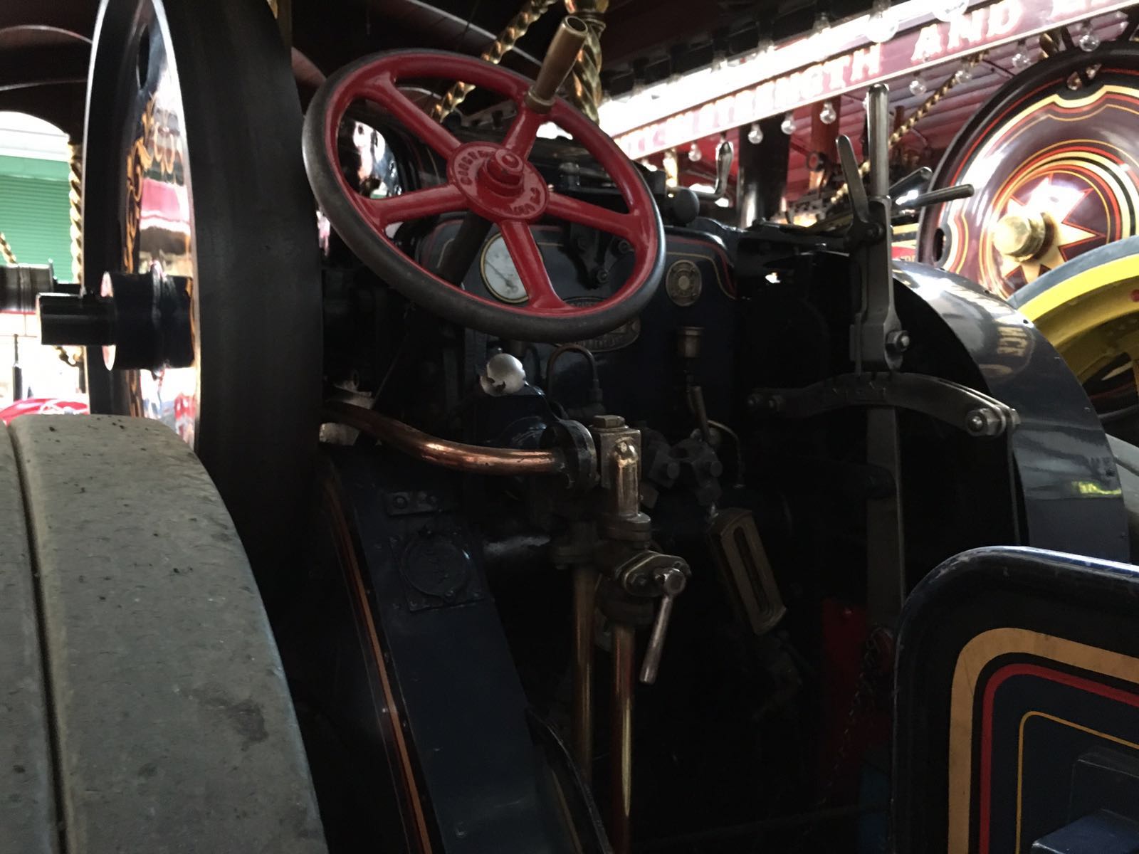

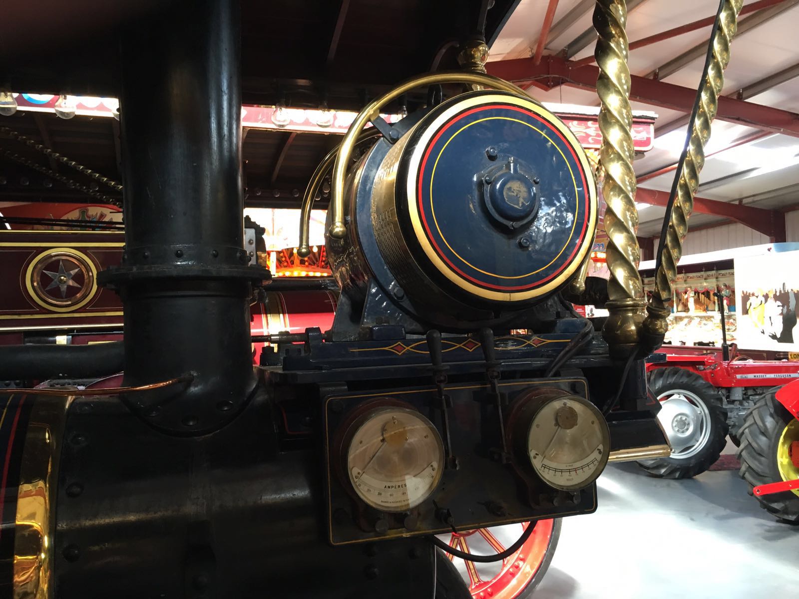

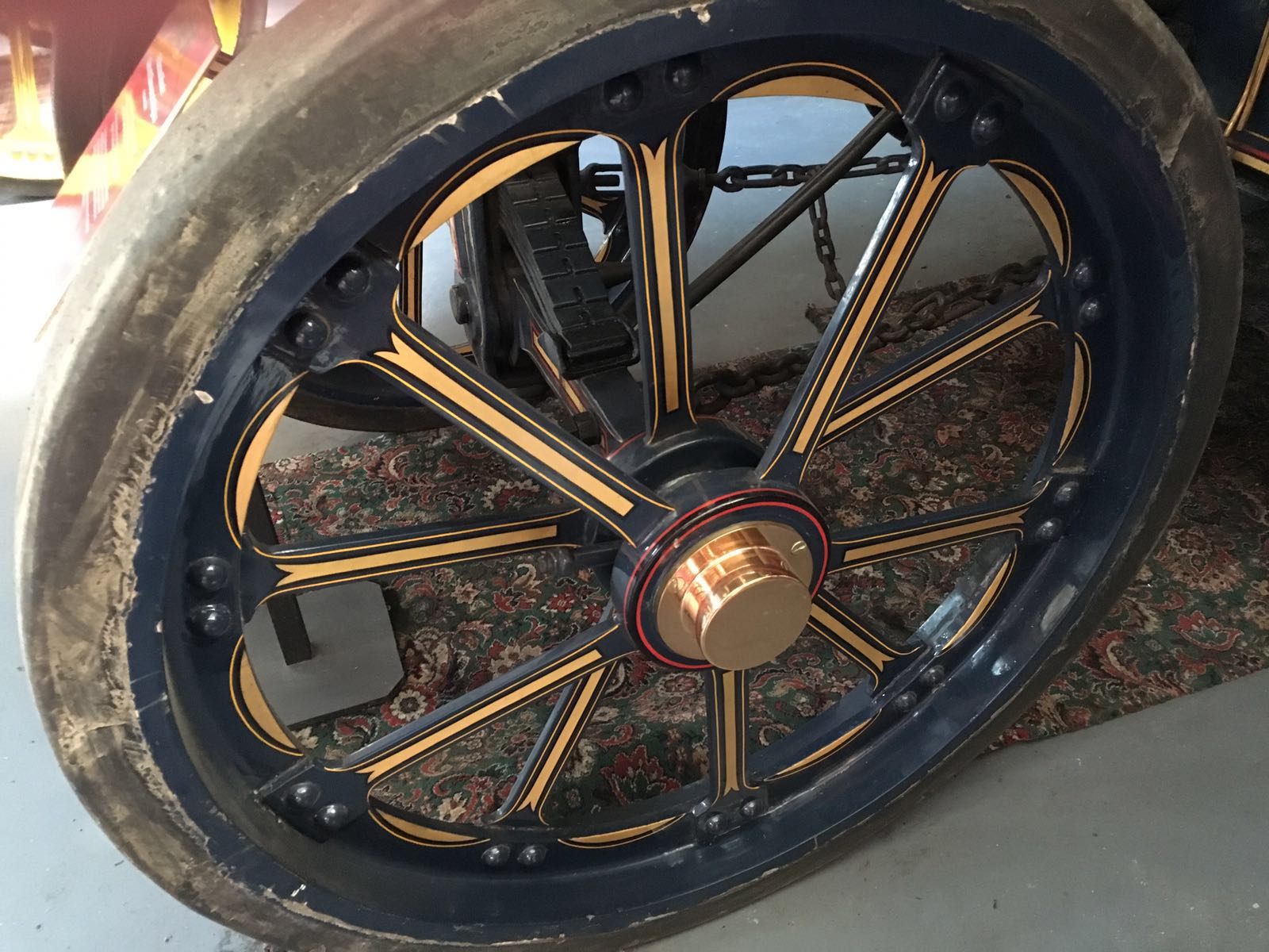

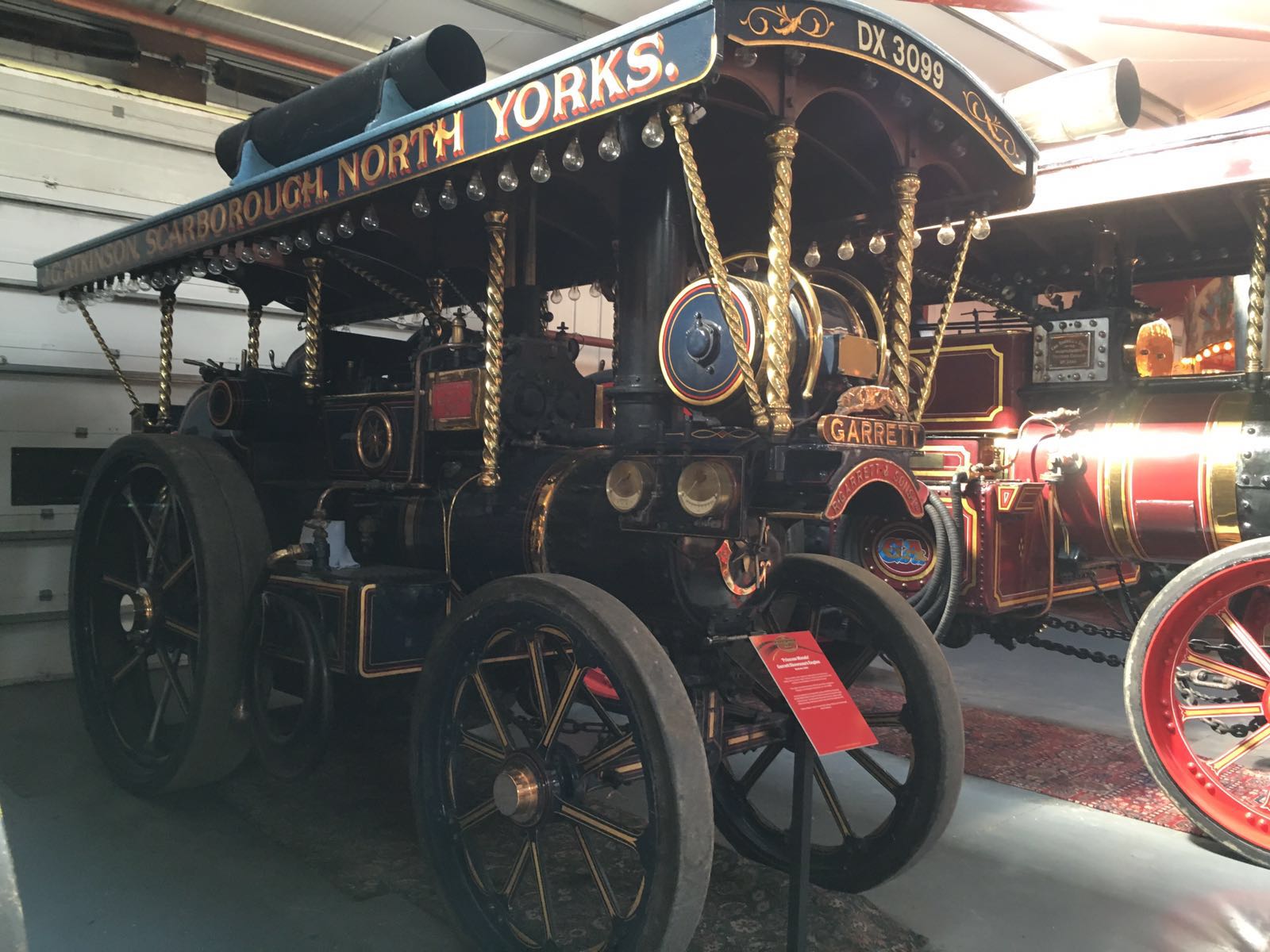

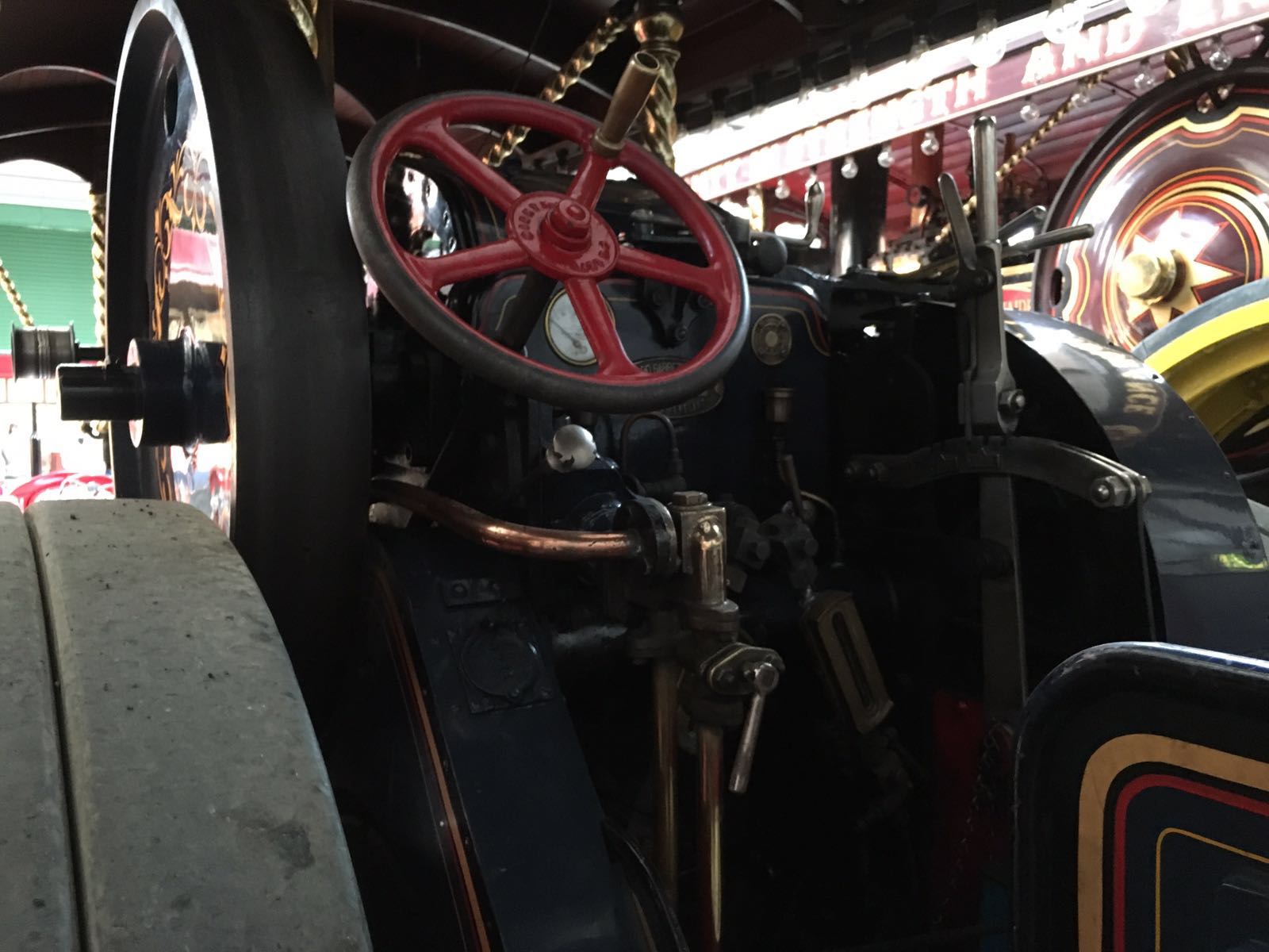

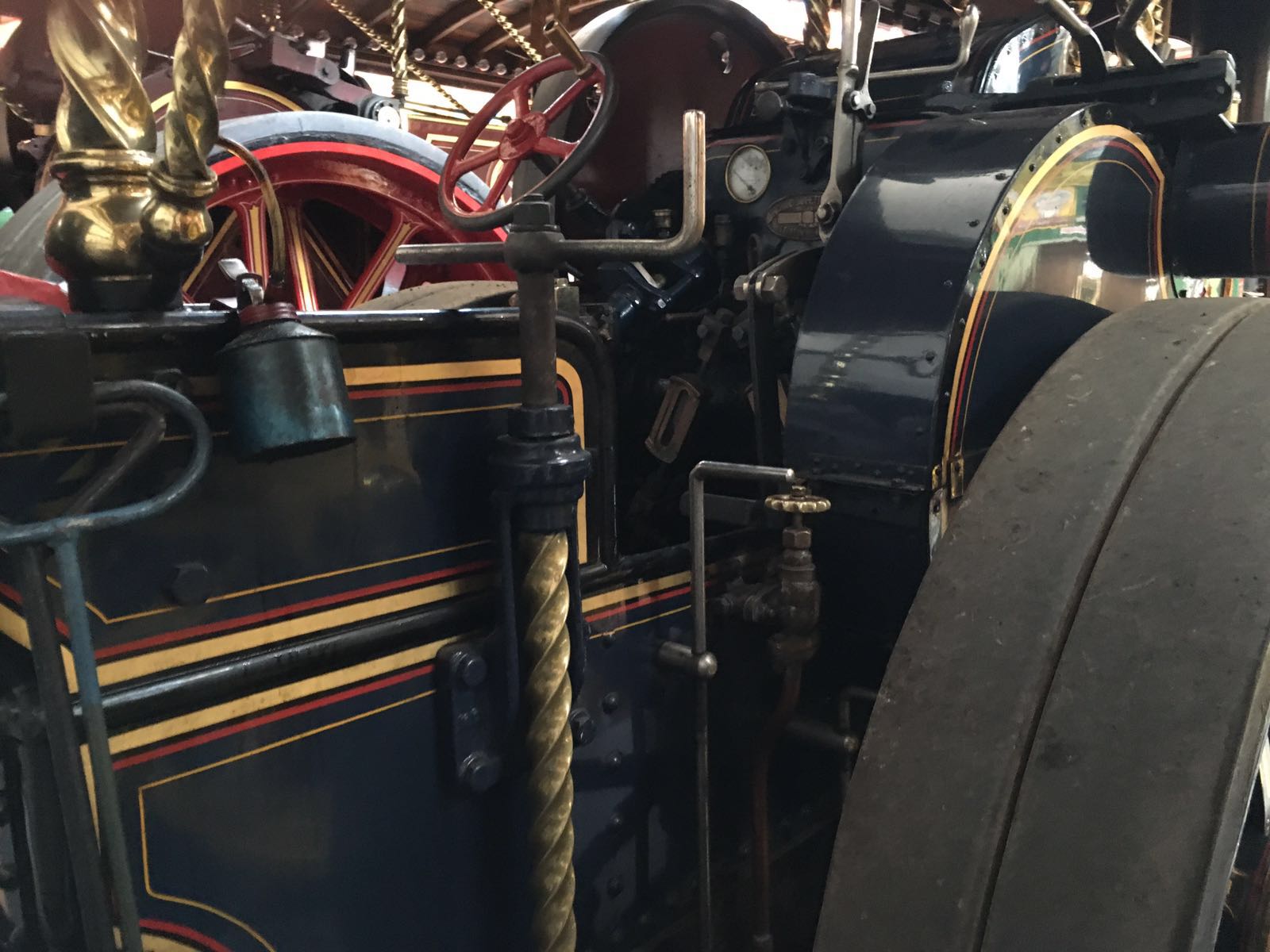

Some useful ref photos of a similar Garret showman's engine..
#10 Posted : 05 September 2016 11:00:44
Some cool photos there Tom, very nice and I especially like the one of the oil can - an essential part of any traction engine driver's tool kit!!
Kev

Carl and Mr T,
Great pictures Mr T.
The oil can detail was neat but don't forget the roll of toilet paper either!
These also answered a question I posed last July about the dynamo being accurate and it is. Thanks for that also.
