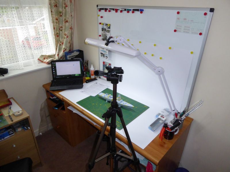

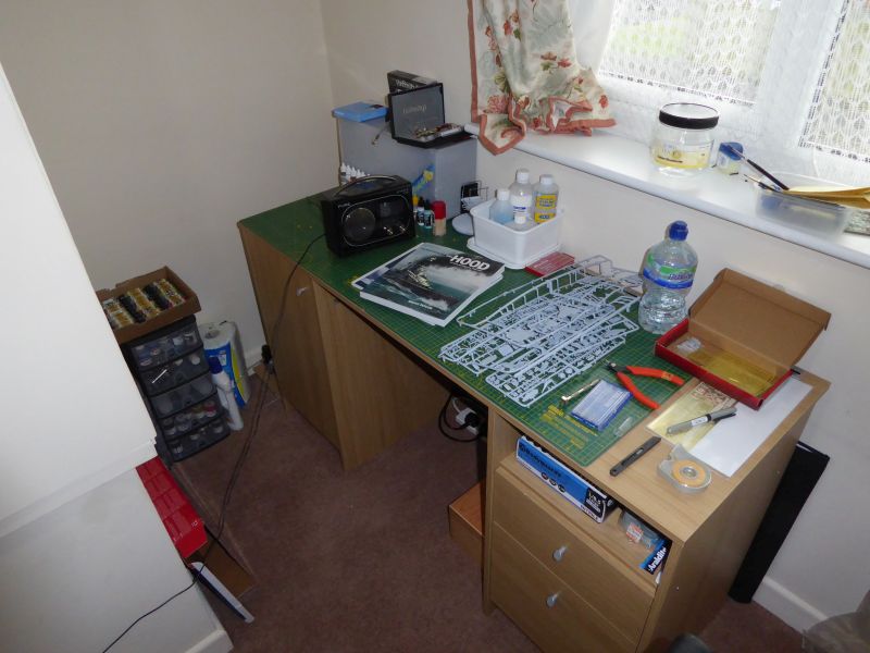

After setting up another desk in my hobby room yesterday and moving all the painting things, spray booth, paints etc in doors from the garage I decided to have a play around with this kit. Pictures attached of new setup. The task light is a daylight lamp and I also have an LED day light bulb in the ceiling light

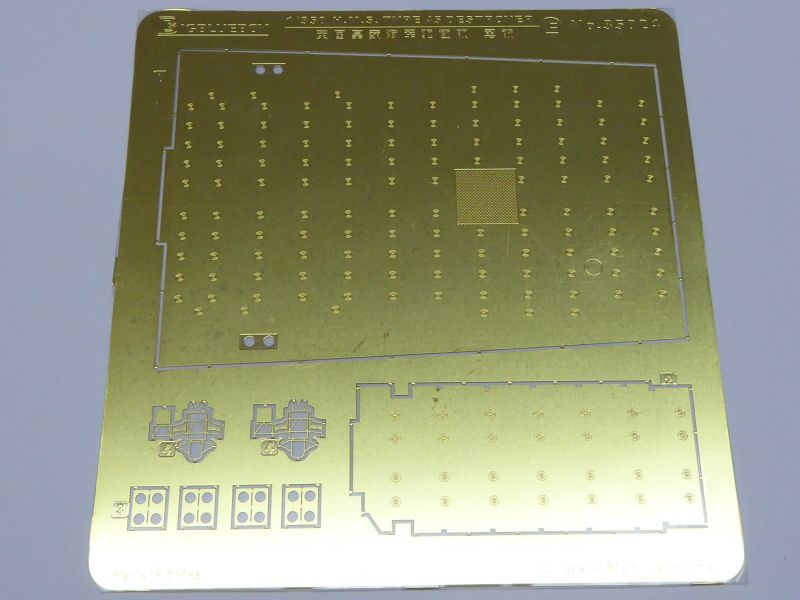

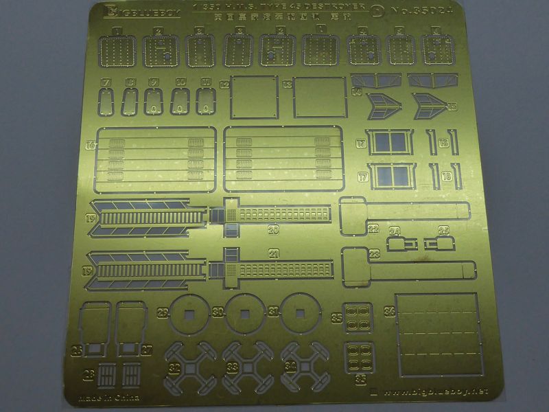

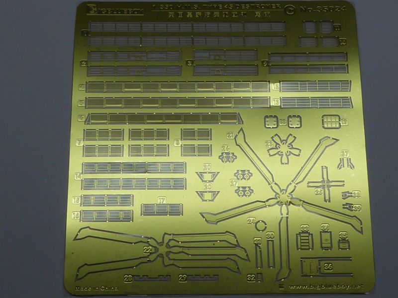

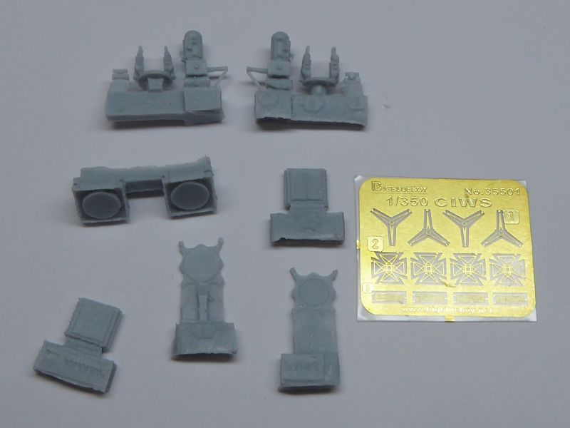

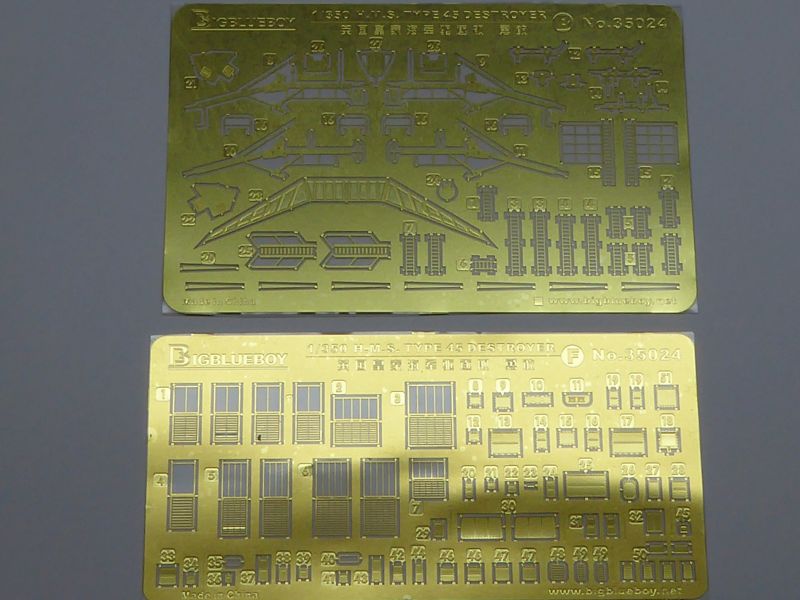

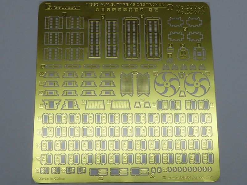

I will also be using the Big Blue Boy photo etch kit for this build.

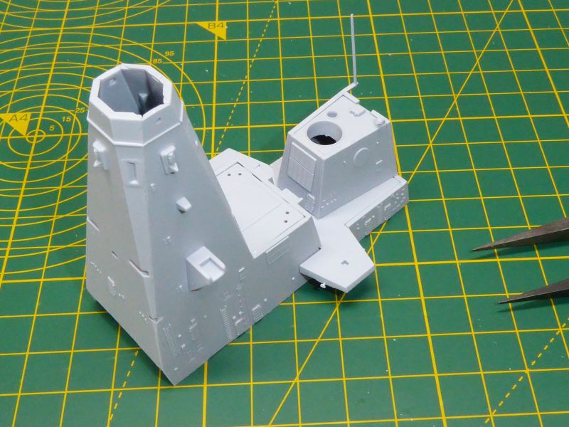

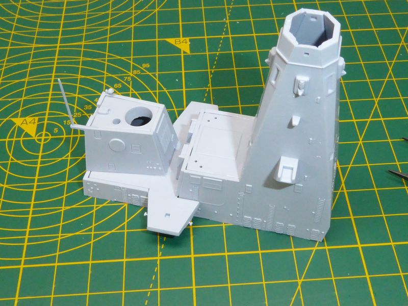

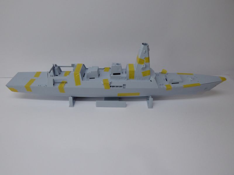

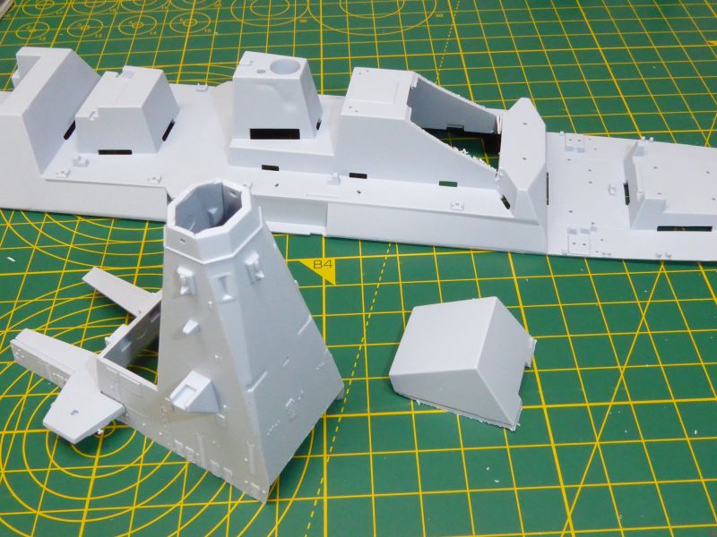

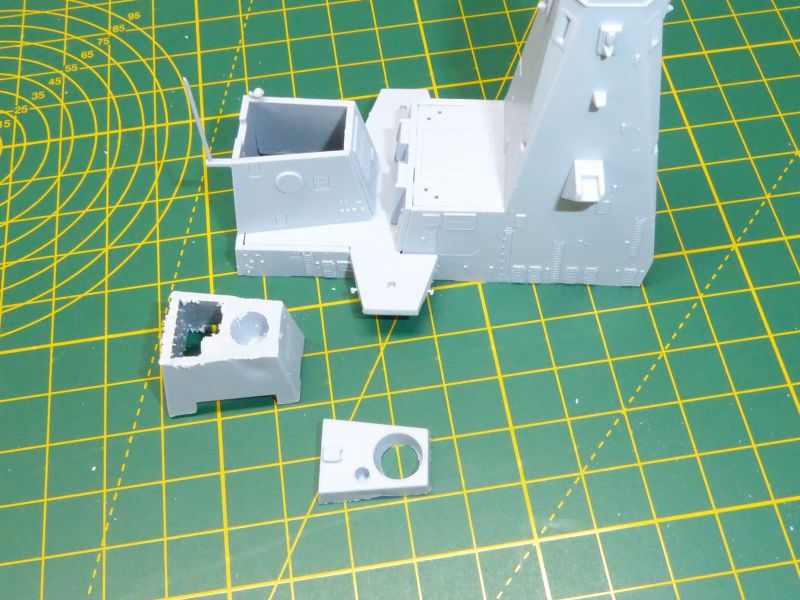

I started off by test fitting the main parts to help get an idea of how I am going to handle it. I have to admit the fit is terrible.

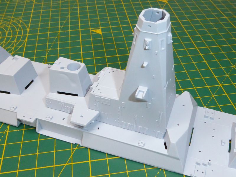

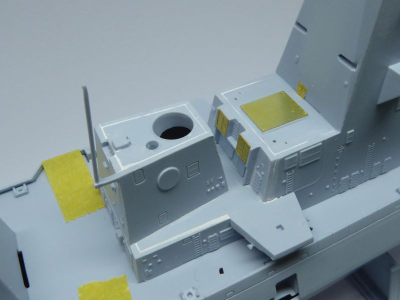

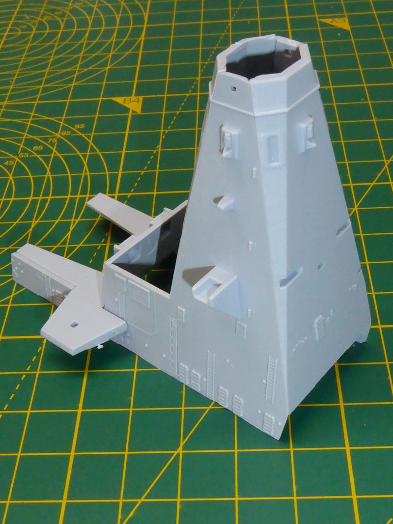

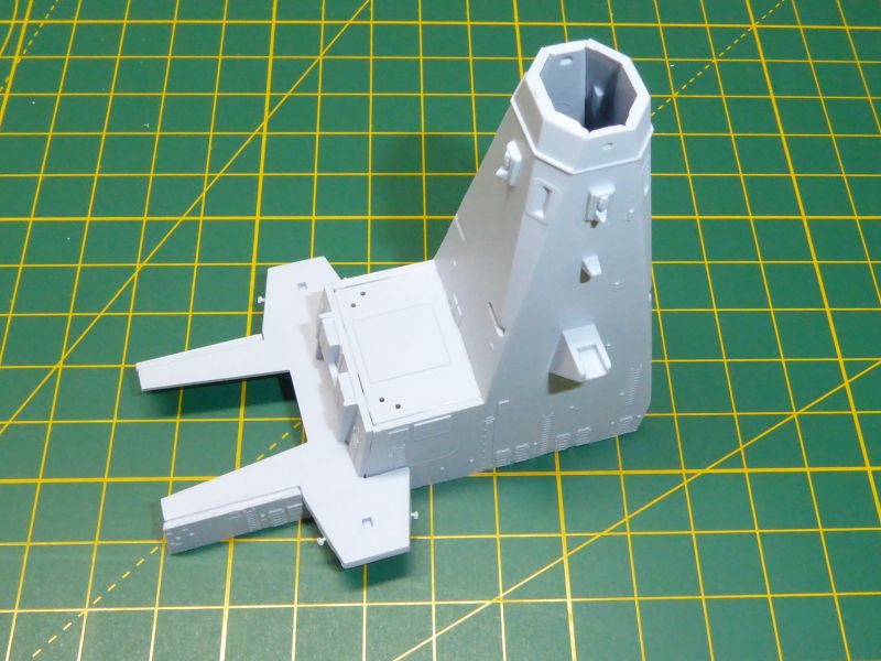

I started by deciding I was going to build the bridge assembly off of the deck, when I went to test fit this back to the deck this is where I realised that the fit problems are with the moulded on parts that you are supposed to use to help you line up the verticle sections. After cutting off these parts I found that the bridge sub assembly section fit like a dream.
I carried out in this manner by cutting the parts off of the deck that I needed to make the bridge assembly continuing with the smoke stack too. Its worked out rather nicely, just some filler needed around the edges now.
Once this has had a good time to dry I will start sanding off the details that will be replaced with PE.

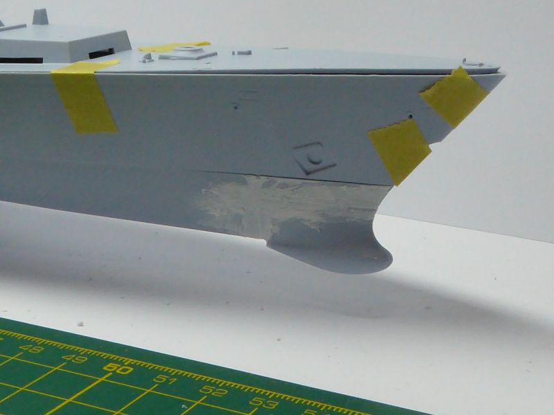

#8 Posted : 24 May 2016 17:09:31

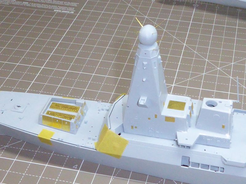

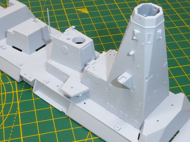

Here are some pictures to give you an idea of the filler being used

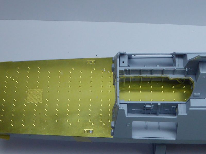

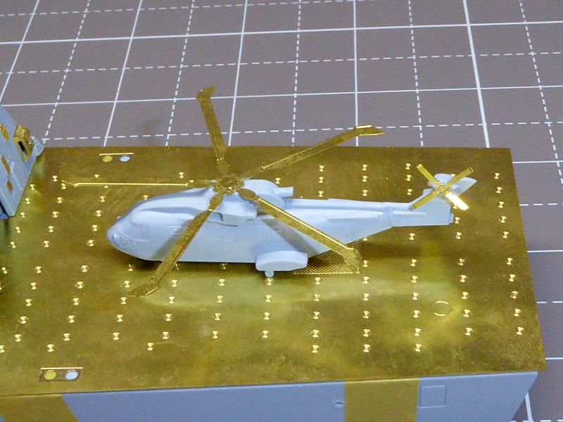

The PE rear flight deck will hide a large gap around the rear quite nicely. I'm finding you need to cut off all the locating tabs and you get a much better fit. Still along way to go

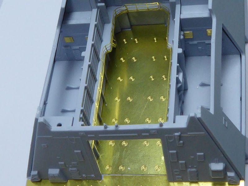

#11 Posted : 29 May 2016 15:35:48

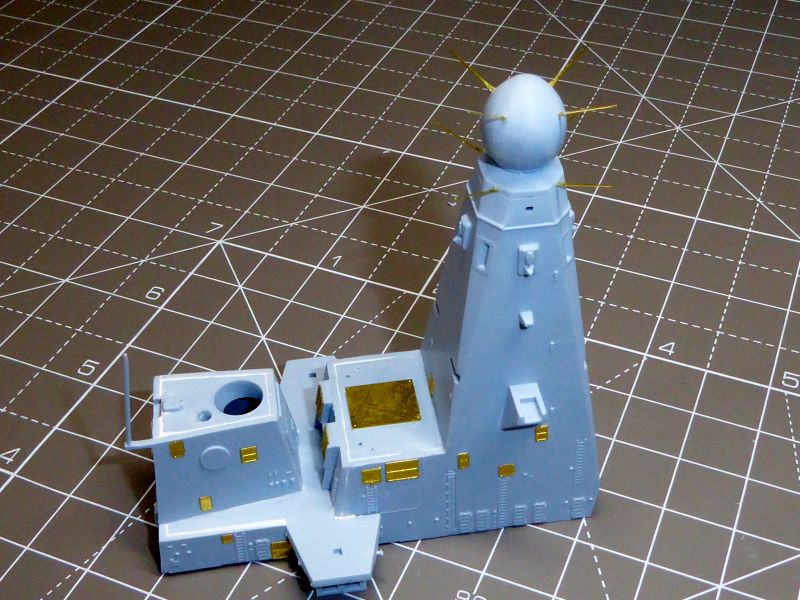

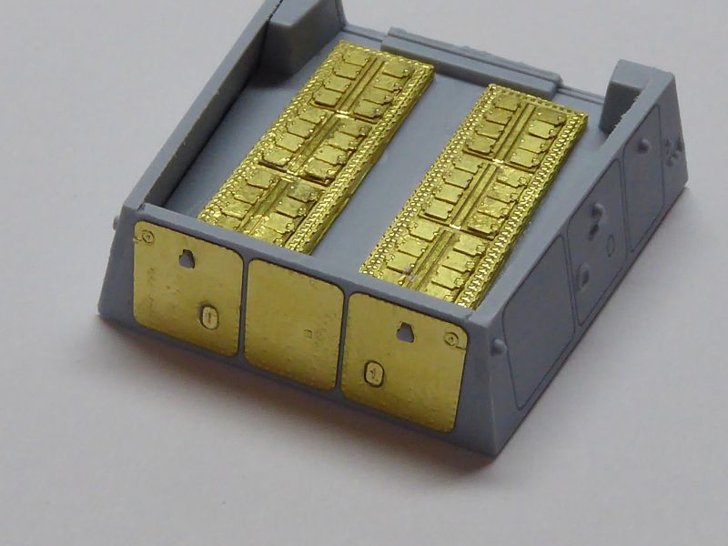

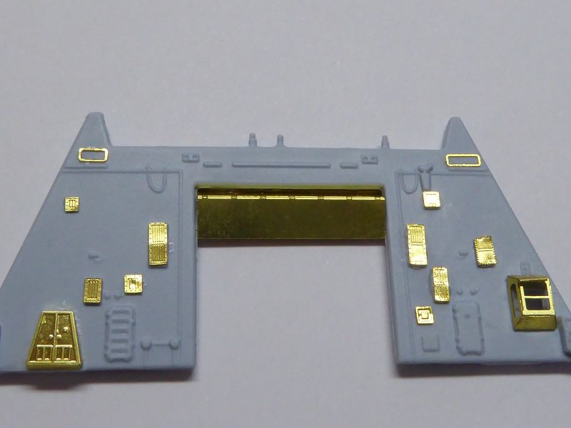

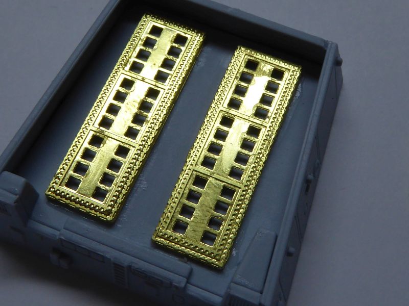

Whilst waiting for the Mr Surfacer to arrive Ive carried by starting to apply the etch to various parts. Very slow work

looking good there Dave like the etch work very fiddley regards Phil

Etch looks fab
#14 Posted : 29 May 2016 19:09:20
Looks good and the etch certainly improves the kit

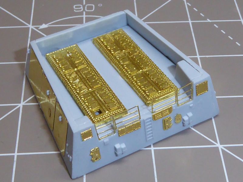

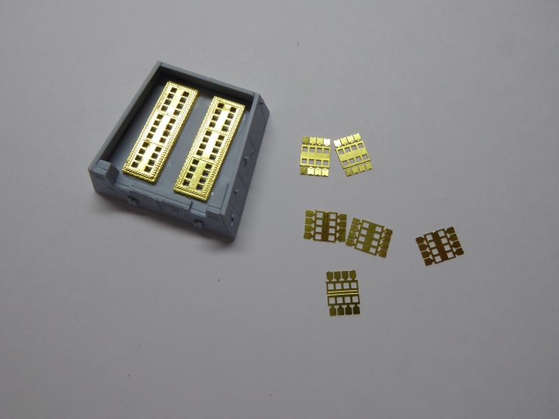

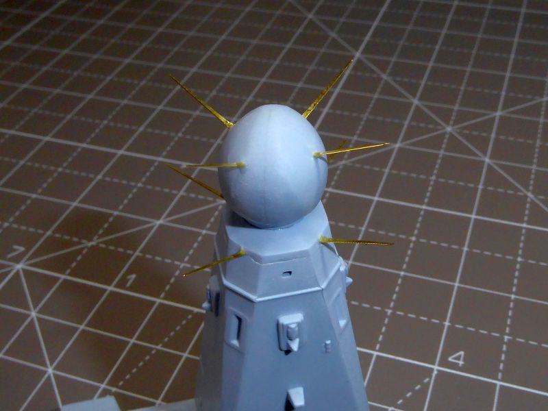

I am now carrying on with this along side my Phantom. At the moment Im still at the photo etch attaching phase but have now purchased an Optivisor which is so much help and making things easier BigGrin
One of the missle bay hatches seem to have disappeared so we will just say that that one was fired off LOL

Nice work on the etch Dave, all very neat and tidy. Shame about the lost cover for the missile launcher, but you could try just cutting a square from the discarded etch framework maybe?
An Optivisor will always be a very worthwhile purchase for any modeller and is essential if you want to preserve your eyesight? It's also a revelation as your eyes get older, as I'm sure you now realise?!
