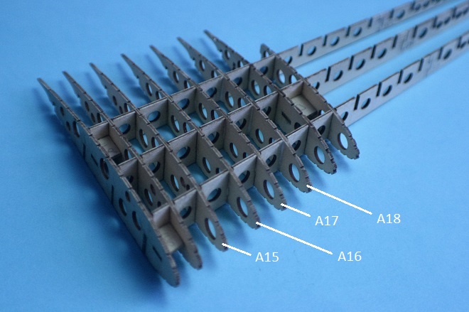

Fit and glue rib A14 into position, as shown.

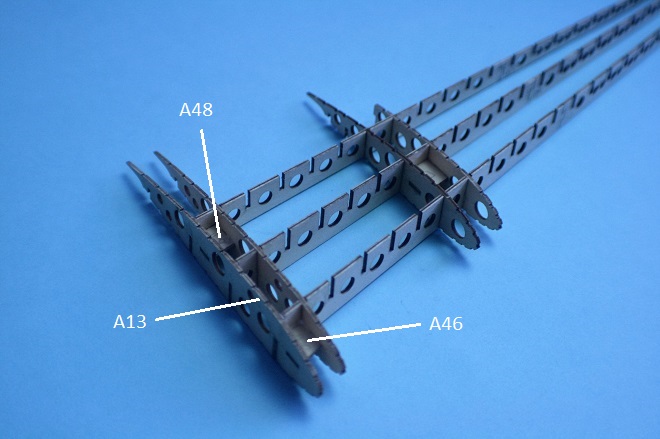

Fit and glue the support pieces A48 and A46, and then the rib A13 that was supplied in an earlier pack.
Add the ribs A15, A16, A17 and A18.

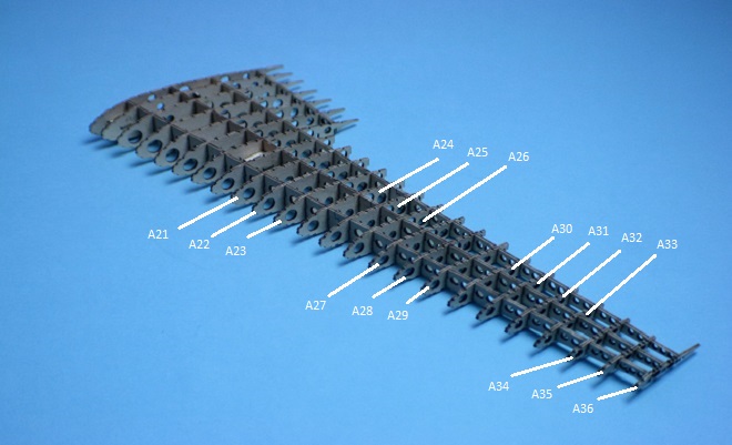

Fit and glue the remaining ribs of the left wing, from A21 to A36 inclusive, as shown in the photograph.

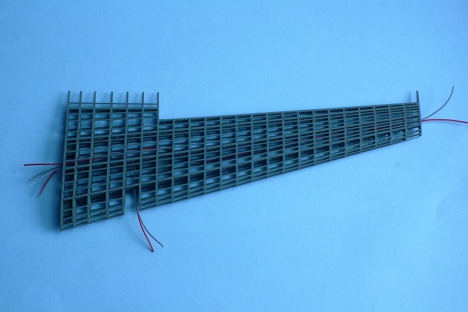

Steps 15 – 27 Installing the wires and plating the wing.

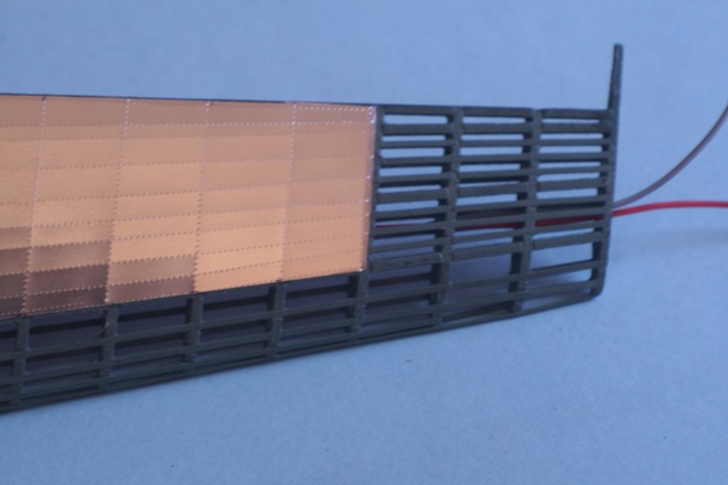

If you are adding lighting, insert two lengths of wire for the lighting in the wing structure, as shown. If you do not plan to fit the model with lighting, leave out this step and steps 28, 29, 30, 31, 32, 36, 38, 40, 43, 44 and 45.
I have included a further close up of how the wires are positioned.

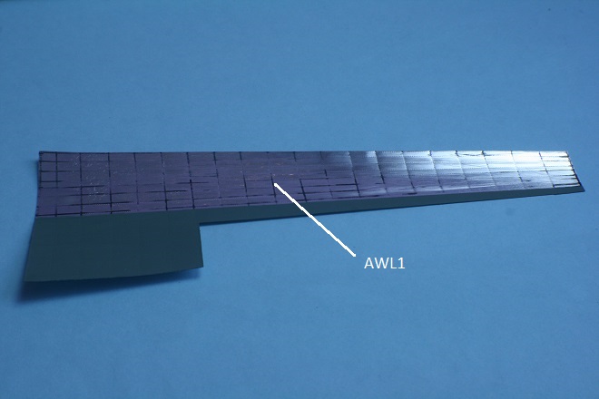

As you have done with the rest of the model, prepare the cover piece AWL1. On the back of the piece, paint the area shaded green in the photograph with green paint, masking off the remaining part to keep it unpainted.
Repeat the process for cladding piece AWL3, referring to the photograph to see which area to paint green.

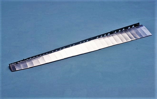

Start covering the upper side of the wing by positioning and gluing the cladding piece AWL1, as shown in this photograph. Be careful with cladding pieces AWL1 and AWL3. Note: do not remove the excess length at the rear part of the wing, shown by the dotted red line in step 19 of you instructions, which must be about 4mm.
The detail shows the correct position of cladding piece AWL1: ensure that about half the width of rib A33 and pieces A37-A38 are left uncovered, so that they can provide a good support for the rest of the cladding.
Complete the covering of the upper side of the wing by adding cladding piece AWL3.

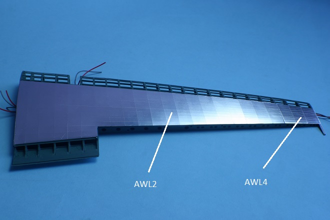

Repeat the operations on the underside of the wing, fitting cladding pieces AWL2 and AWL4.

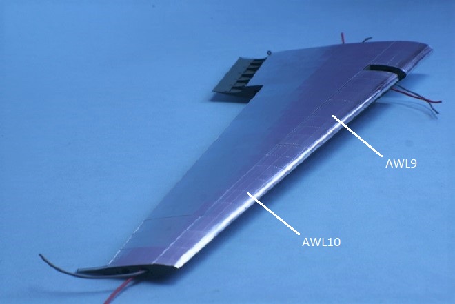

Start covering the leading edge of the wing. Prepare cladding piece AWL5. Bend and adjust it carefully before gluing it, as shown in the photograph.
On the lower side of the leading edge, fit and glue cladding piece AWL8.
Complete the cladding of the lower part of the leading edge by fitting pieces AWL9 and AWL10. At the same time, continue with the cladding of the upper part of the leading edge, using pieces AWL6 and AWL7.

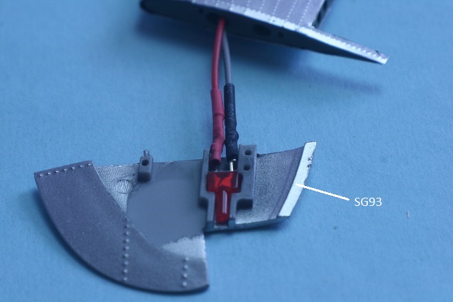

Take pieces S93G and S94G. Prime them and paint them chrome, in the same way that you have painted other parts of the fuselage.
Being very careful with the painted surfaces, fit the LED into piece S93G, as shown.

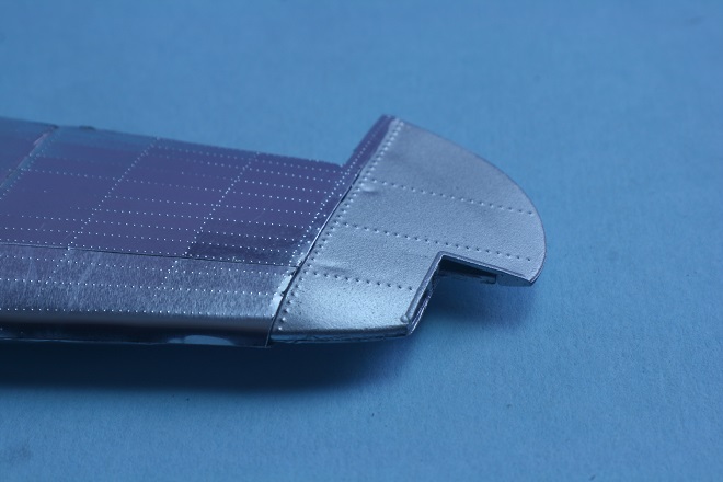

Fit and glue piece S94G to piece S93G, using as small an amount of adhesive as you can. This will make it easier for you to reach the LED for repairs, if necessary. When set, gently pull the wires connected to the LED, so that the end piece of the wing fits flush with the rest of it. Glue the end piece in place, as shown, making sure it is correctly aligned. Use as little glue as possible.

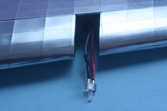

In the same way as you did with the red LED, attach a white LED to the pair of wires that emerge from the leading edge of the wing.

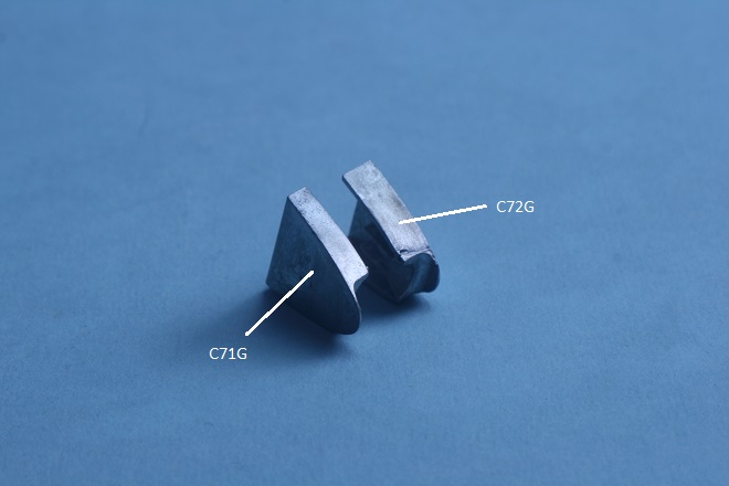

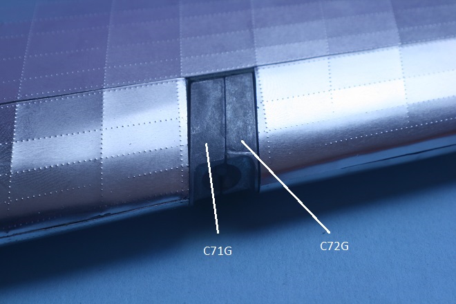

Take pieces C71G and C72G. File them lightly to remove any rough edges, and check that the two parts will fit together correctly.
Fit the LED into piece C71G, as shown in step 40 of your instructions.
Fit and glue piece C72G, as shown in step 41 of your instructions. Use as little glue as possible.
Pull the pair of wires towards the inside end of the wing, to draw the assembly into position (see photograph). Fix it with a few small spots of adhesive.

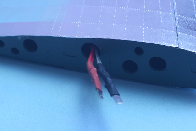

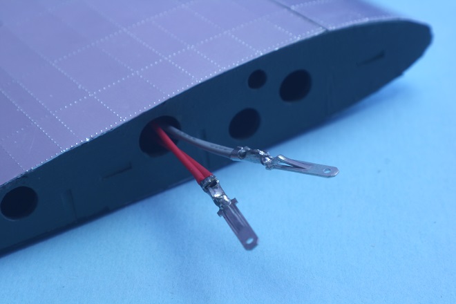

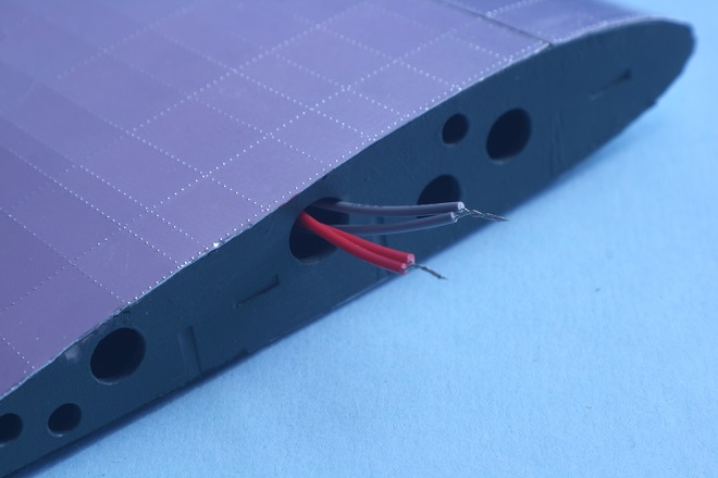

Shorten the wires to 20mm in length, as indicated in the photograph. Strip the ends of both wires and twist the two wires of each colour together.
Take the connectors shown in the photograph. Fit the ends of the wires prepared earlier into them, gently close them with pliers and then solder the joints.
Insulate the connectors with the heat-shrink sleeving as shown, to avoid short-circuits.
With a brush, paint the fronts of pieces C71G and C72G as shown in step 46 of your instructions.

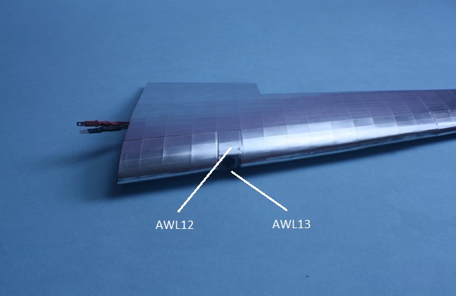

Cover pieces C71G and C72G, prepared in the previous step, with the cladding AWL11 and AWL12 on the upper and lower sides respectively. Shape the pieces to fit before gluing them, and remember to add the lines that simulate the rivets.

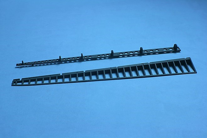

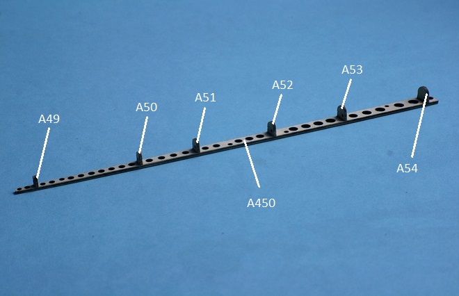

Now all that remains is to construct the wing flap. Assemble the wing flap support by fitting and gluing pieces A49, A50, A51, A52, A53 and A54 into piece A450, as shown in the photograph.
Check that the assembly put together in the previous step fits in the rear part of the wing, as illustrated in step 49 of your instructions. If necessary, carefully modify it.

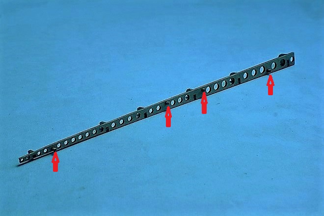

For the correct positioning of the support, you can use rods, as already suggested. From the bamboo rod supplied with the second pack, cut four pieces, each 3mm long. Fit and glue the four pieces of rod into the holes in piece A450, as shown in the photograph.

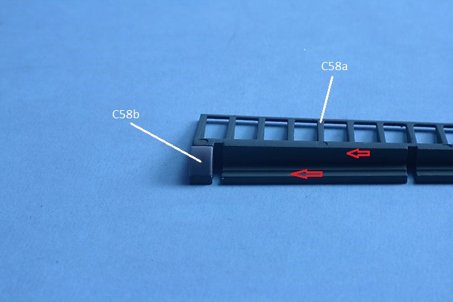

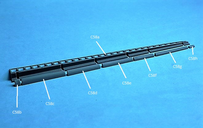

Take the pieces that form the wing flap: C58a, C58b, C58c, C58d, C58e, C58f, C58g and C58h. Smooth off any roughness and moulding marks with a file and abrasive paper.
Take the wing flap support and piece C58a. Apply primer and paint both pieces green. Leave them to dry.
Sand the flat surfaces indicated by the arrows, then fit and glue the end piece C58b as shown. Use only a small amount of glue, and make sure to keep the hole through the centre of the pieces unobstructed.
To check that the hole is completely clear, thread through the 0.8mm diameter rod supplied.

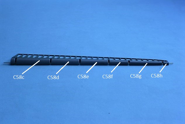

As with piece C58b, fit and glue pieces C58c, C58d, C58e, C58f, C58g and C58h in position, one after the other, starting with C58c. Test that the hole in each is clear by using the brass rod.
Prepare cladding piece AWL13 and cover the lower part of the wing flap with it.
