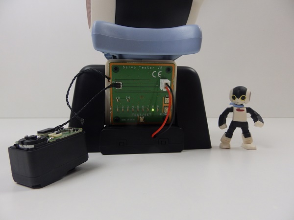

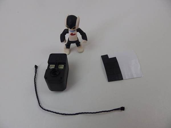

#1 Posted : 23 April 2016 16:58:38

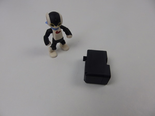

Pack 13 contains issues 47-50

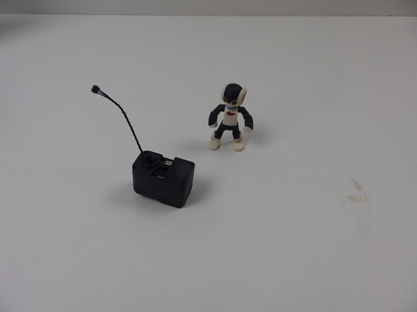

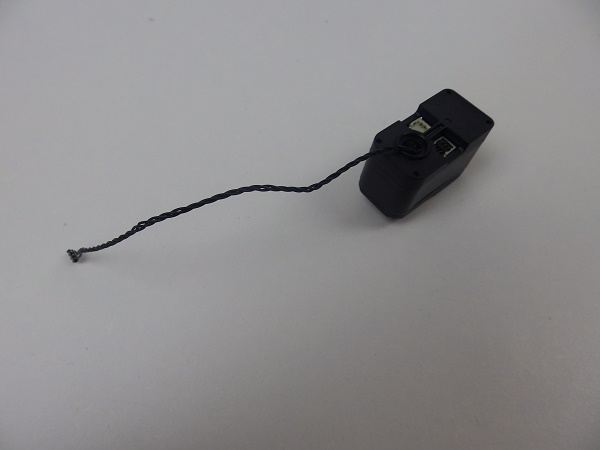

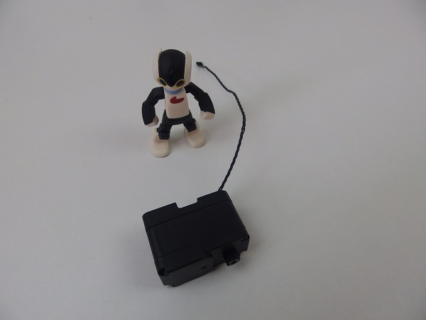

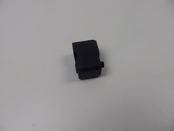

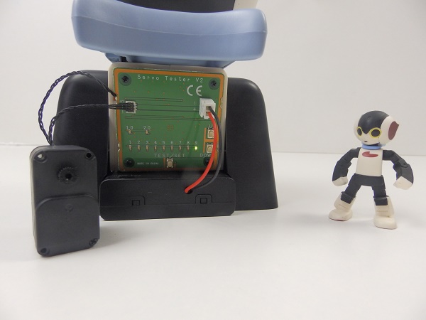

Issue 47

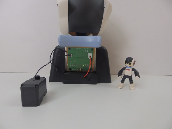

Your parts: Servo motor.
Saved parts:
You will be using parts from the previous issues, so be sure to have these to hand before beginning: Servo cable.
Preparing the servo.
Take the servo and remove the cover then attach the servo cable making sure a pad is fitted if you have not already done so and then replace the cap. Next we will set the servo's ID number which is 9 but firstly we will test the servo by attaching it to the test board and pushing the test button. The servo shaft should move left and right.
Setting the ID number.
By now the process setting the ID number should be familiar but if your still unsure then refer back to previous stages to recap this process, the Id number for this servo is 9.
Issue complete store any unused parts in a bag labeled with the stage number.

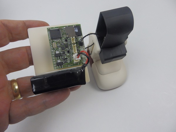

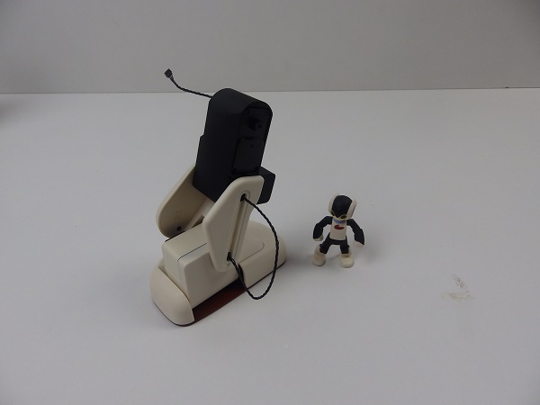

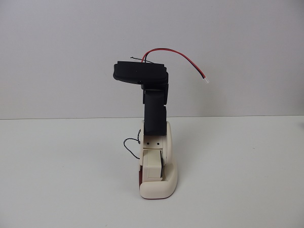

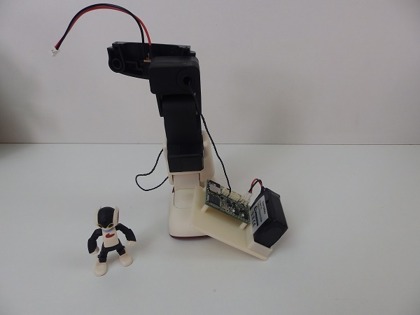

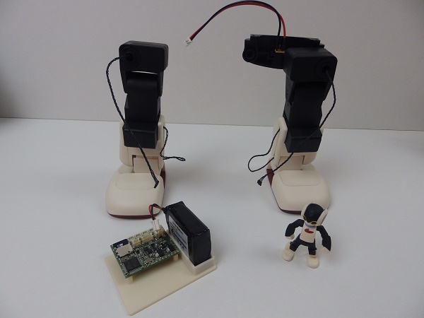

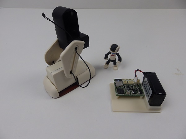

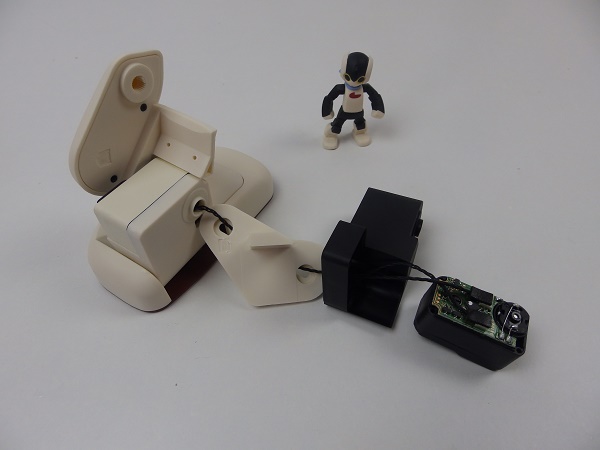

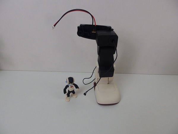

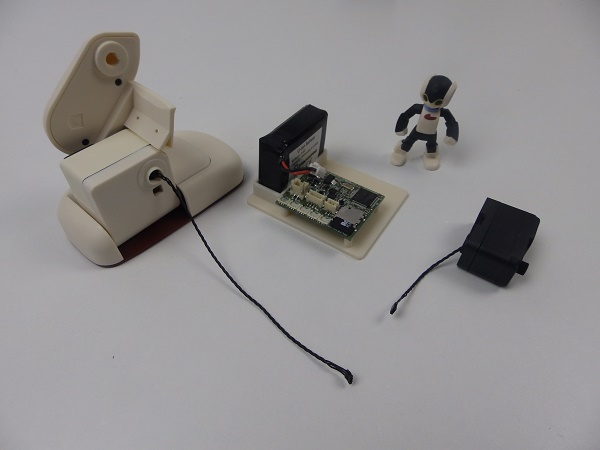

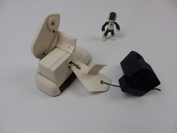

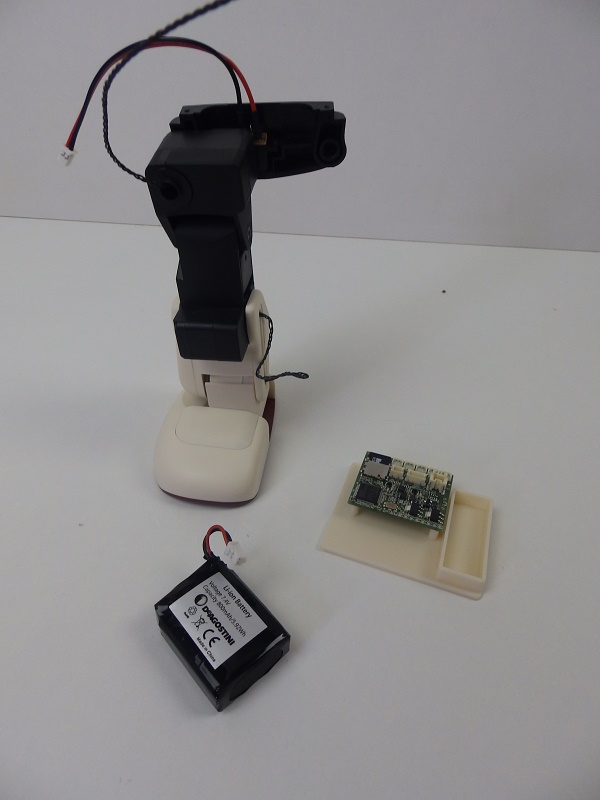

#2 Posted : 23 April 2016 17:03:54

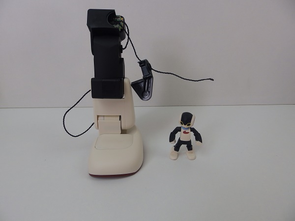

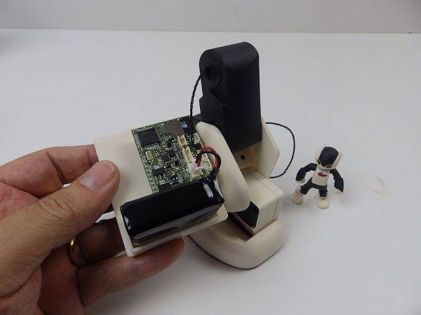

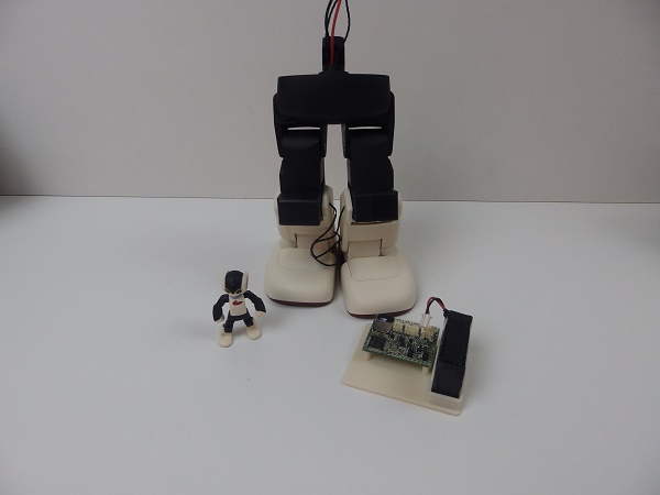

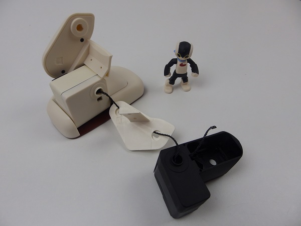

Issue 48
Your parts:left frame, lower leg, cable and screws.
Saved parts:
You will be using parts from the previous issues, so be sure to have these to hand before beginning: Left foot and ankle assembly ,battery ,servo from last issue, CPU board and pads.
Building up the lower leg.
Take the lower leg assembly and the leg panel feed the servo cable through the lower hole on the frame and out of the top hole. Next take the knee frame and again pass the cable through the hole. Remove the cover from the servo and attach the cable from the ankle assembly to the spare socket on the servo, then making sure the cable is not kinked or caught use the four screws to secure it in place.
Fitting the knee frame and lower leg panel.
Line up the shaft of the servo with the 'D' shaped hole in the ankle assembly then gently push home. Next line up the two circular holes in the leg panel and push gently together making sure the cable is not caught. When it is in its correct position fix the them together with two M2 x 7 mm screws.
Testing the left leg.
Place the servo cable from the left leg in the 2nd slot along from the SD card making sure it is seated correctly. Connect the battery and Robi's leg should start sequencing in the same way that the right leg did.
As long as there is power the sequence of movements will continue, when you are satisfied all is working correctly detach the battery.
If the leg will not work or only partially works then this may mean there is a faulty connection and may involve striping down the leg and resetting the ID numbers but before you do anything check the battery is fully charged and the connection to the CPU board is sound.
If the problem persists then follow the trouble shooting guide included in the magazine to get Robi's leg working correctly.

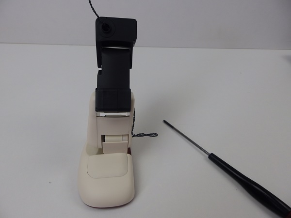

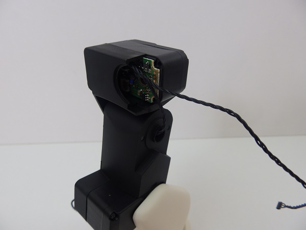

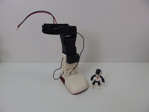

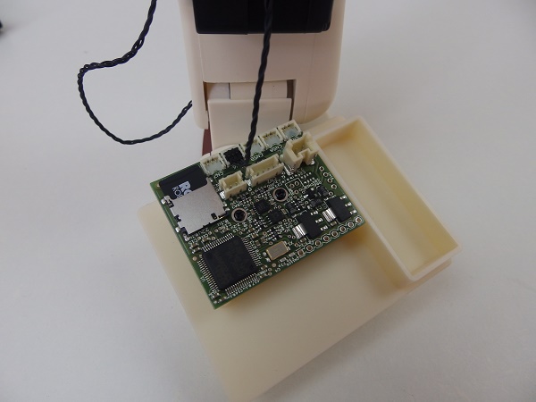

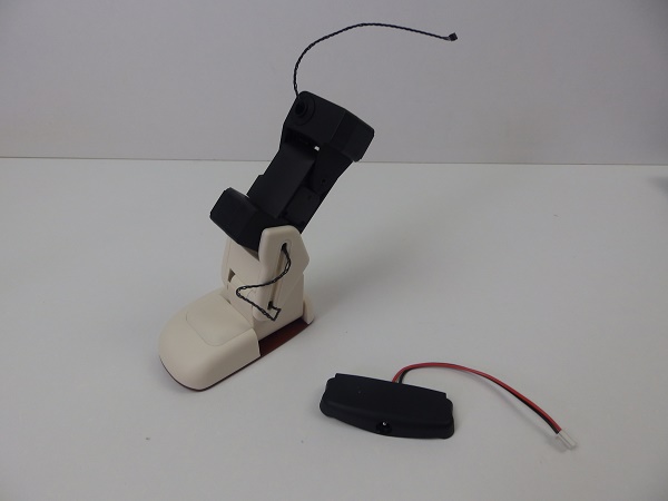

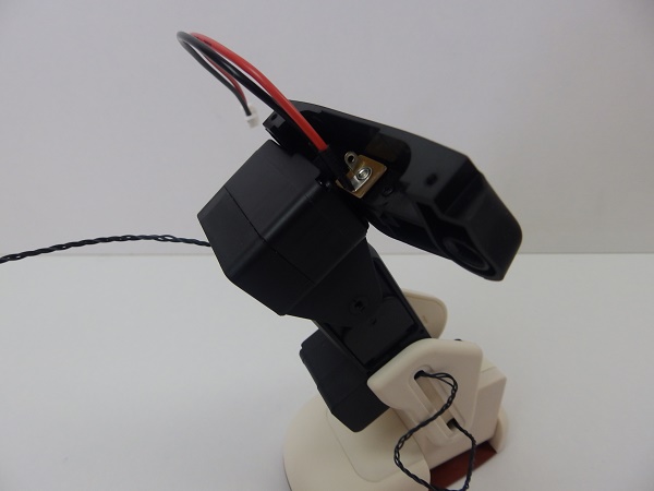

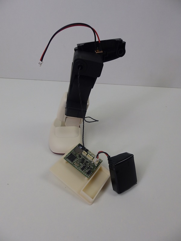

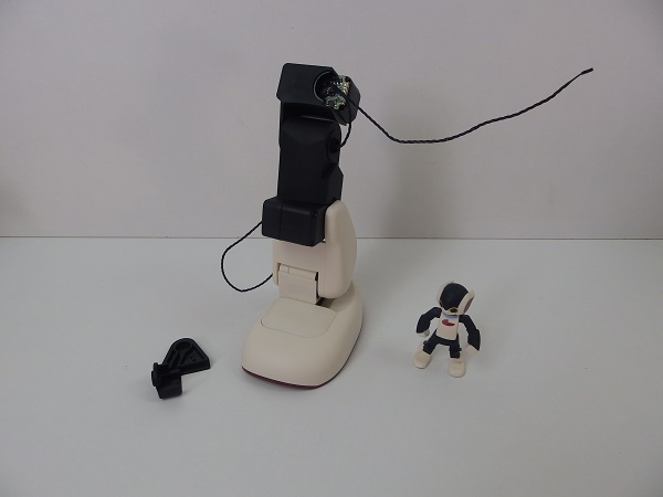

#3 Posted : 23 April 2016 17:10:40

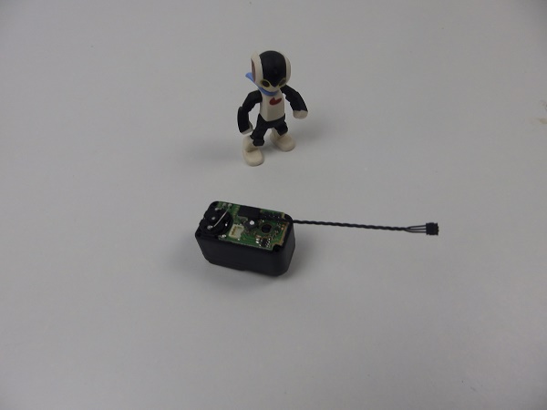

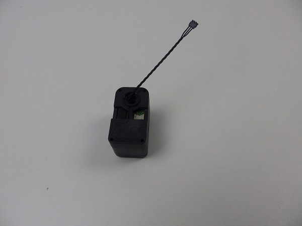

Issue 49

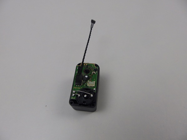

Saved parts:
You will be using parts from the previous issues, so be sure to have these to hand before beginning: Left leg assembly, servo cable, battery, CPU board and neck stand.
Take the servo and remove the cover then attach the servo cable making sure a pad is fitted if you have not already done so and then replace the cap. Next we will set the servo's ID number which is 8 but firstly we will test the servo by attaching it to the test board and pushing the test button. The servo shaft should move left and right.

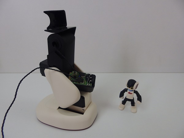

Fitting the thigh servo.
Remove the cover from the servo and attach the servo cable from the knee servo to it and then carefully push it into its housing on the frame making sure all cables are free and not caught in any way. Once it is in its correct position use the four servo screws to fix it in place.

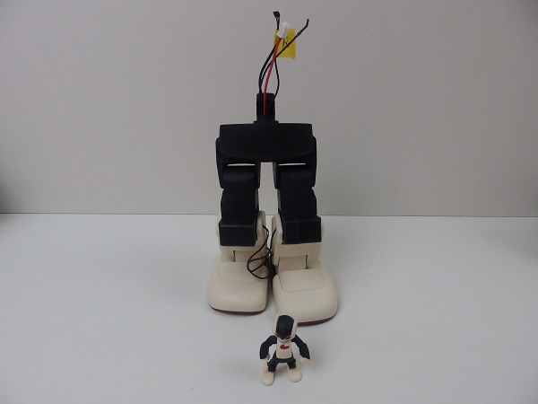

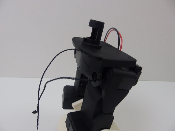

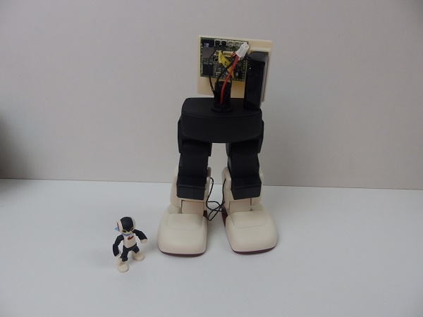

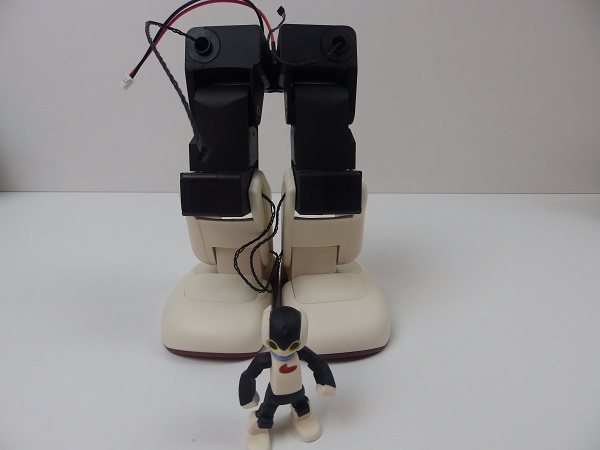

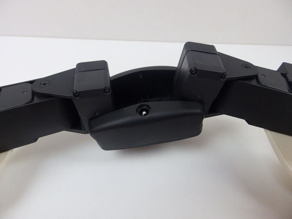

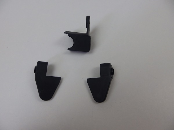

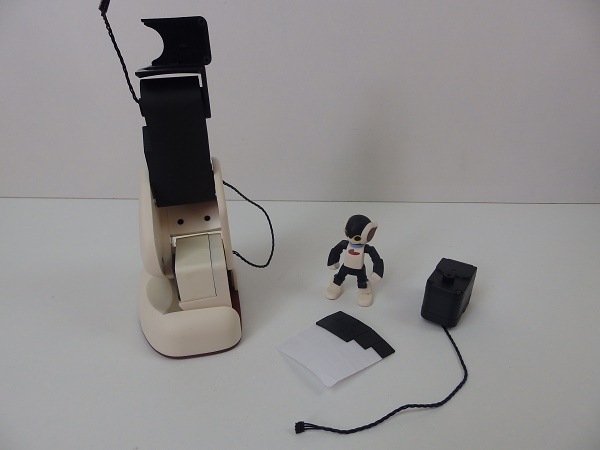

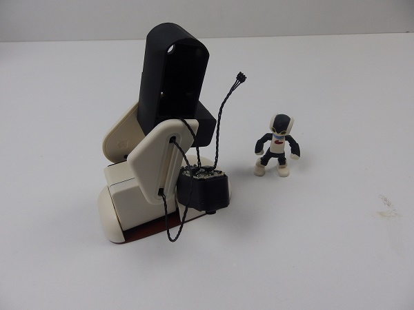

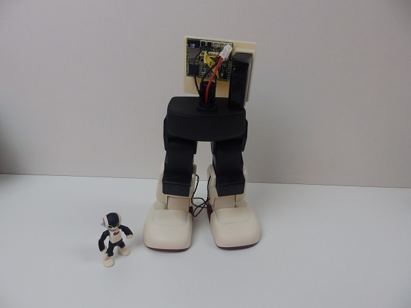

#4 Posted : 23 April 2016 17:14:44
Issue 50
Your parts: Left and right hip frames, left inner frame and servo cable.
Saved parts:
You will be using parts from the previous issues, so be sure to have these to hand before beginning: Servo [stage 33] ,battery, CPU panel, left and right leg assembly's, rear hip panel and pads.
Mounting the inner hip frame.
Take the left leg assembly and line up the hip frame with its 'D' shaped hole and push gently home.
Fitting the hip servo.
Take the servo from stage 33 and remove its cover, then line it up with the right leg assembly and attach the servo cable to the servo. Now line up the servo with the hip frame and carefully push home again try not to catch any cables as you do this and fix it in place using two servo screws.
Fitting the outer hip frame and rear hip frame.
Take the servo cable from the leg assembly and pass it through the hole in the hip frame then taking care not the catch the cable line the frame up with the leg and fix it in place using the last two servo screws. Now take the rear hip frame and line it up with the servo pushing gently home.
Place the servo cable from the right leg in the 1st slot along from the SD card making sure it is seated correctly. Connect the battery and Robi's leg should start sequencing in the same way that the left leg did.
Issue complete store any unused parts in a bag labeled with the stage number .

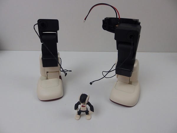

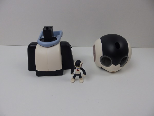

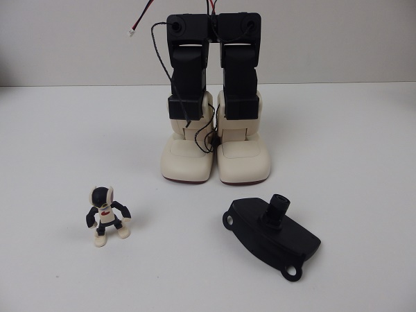

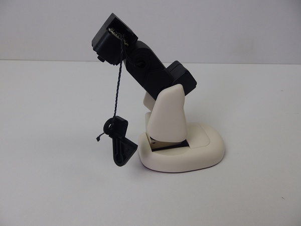

#5 Posted : 24 April 2016 11:30:32
Pack 14 contains issues 51-54

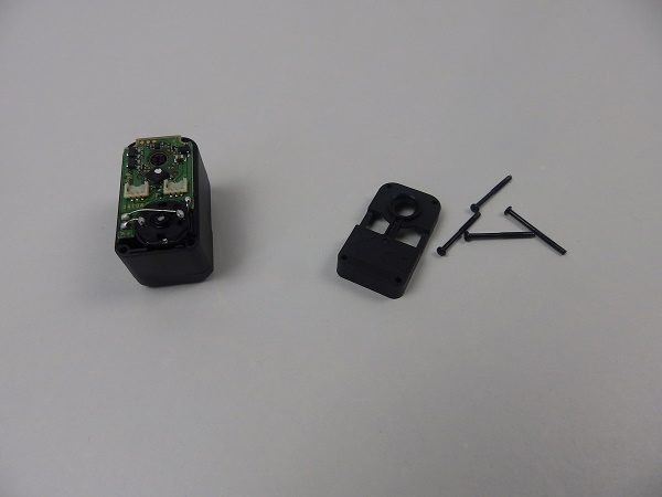

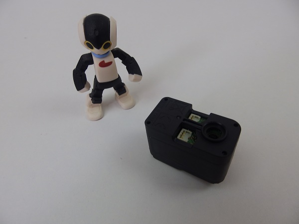

Issue 51

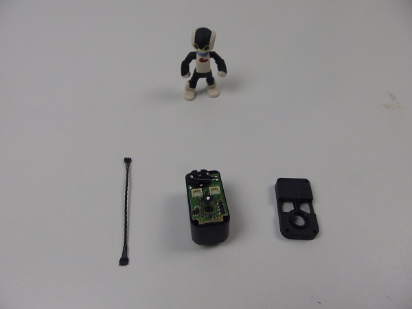

Saved parts:You will be using parts from the previous issues, so be sure to have these to hand before beginning: Servo cable,left hip frame,battery CPU board,hip panel ,left leg and neck stand.
Take the servo and remove the cover then attach the servo cable making sure a pad is fitted if you have not already done so and then replace the cap. Next we will set the servo's ID number which is 7 but firstly we will test the servo by attaching it to the test board and pushing the test button. The servo shaft should move left and right.
By now the process setting the ID number should be familiar but if your still unsure then refer back to previous stages to recap this process, the Id number for this servo is 7.
Take the servo and remove the cover then attach the servo cable from the left leg to the servo after this attach the servo to the left leg using two screws as we did with the right leg.
Adding the hip frame
Take the servo cable from the left leg and pass it through the hole in the hip frame. Line the hip frame up with the left leg and taking care not to catch any wires fit and fix in place with the last two servo screws.
Take the rear hip panel and attach it to the left leg then place the servo cable from the left leg in the 2nd slot along from the SD card making sure it is seated correctly. Connect the battery and Robi's leg should start sequencing in the same way that the right leg did.

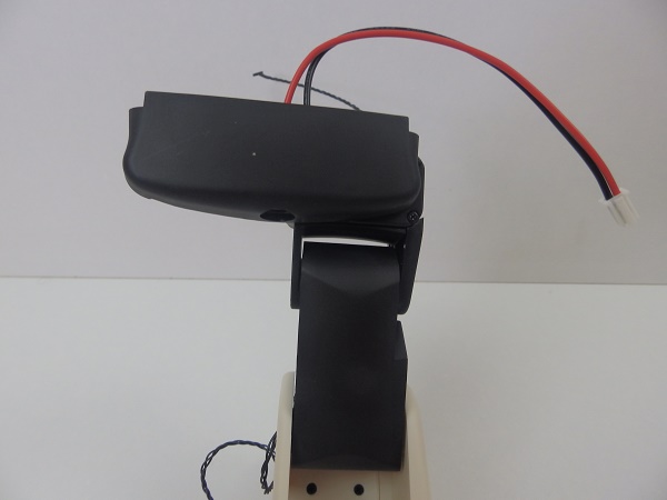

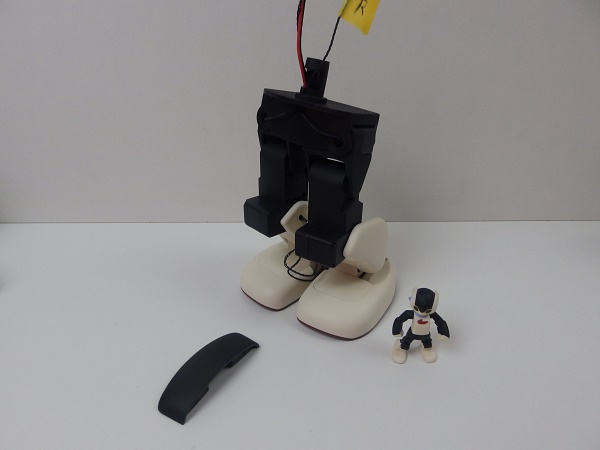

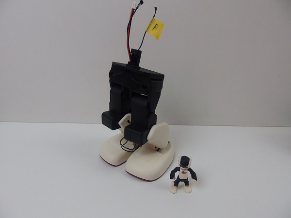

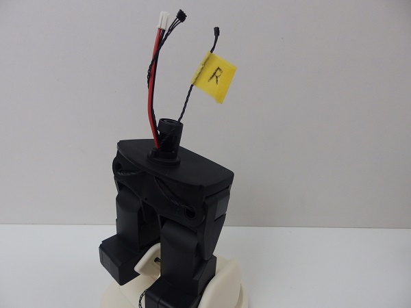

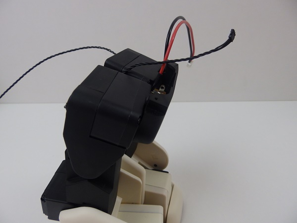

#6 Posted : 24 April 2016 11:36:55

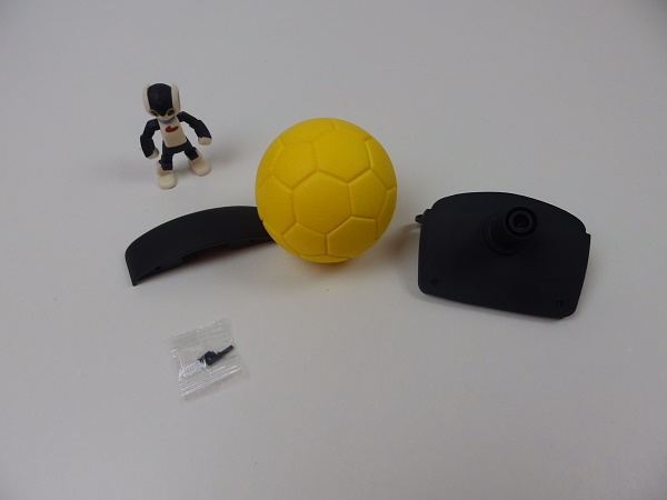

Issue 52
Your parts: Ball. Front hip panel, base and screws.
Saved parts:You will be using parts from the previous issues, so be sure to have these to hand before beginning: Battery, CPU board, left and right leg assembly's and rear hip panel.
Joining the legs and wiring the hip base.

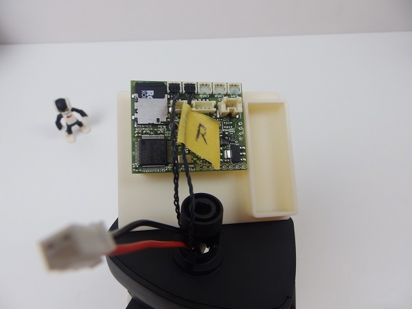

Take the hip base and put the left and right servo cables from the legs through the two round holes at the front of the hip base. The front centre of the hip base has two square holes one above and one below the waist pivot take the left and right servo cables and pass them through the lower hole and out the larger hole above it. Next swing the hip base forward but do not allow the servo cables to fall out and pass the power cord up through the waist pivot. Now fix the front of the hip base over the two round holes the servo cables were fed through and gently push it back until it lines up with the two screw holes then fix it in place using two M2 x 6 mm screws. You may need to adjust the power cable so the hip base fits correctly.
Taping the right servo and adding the front panel.
Identify the right servo cable and add a piece of tape to it . Next take the front hip panel and push it up so the two pins on the hip frame are inserted into it. Hold it in place and turn the leg assembly upside down swinging the legs open so you can use a M2 x 6 mm screw to fix it in place.
Testing the legs and hips.
Take the leg assembly and place the servo cable from the left leg in the 2nd slot along from the SD card and then the right servo cable to the 1st slot making sure both are seated correctly. Connect the battery and Robi's hips and legs should start sequencing..
If the leg assembly will not work or only partially works then this may mean there is a faulty connection and may involve striping down the leg assembly and resetting the ID numbers but before you do anything check the battery is fully charged and the connection to the CPU board is sound.

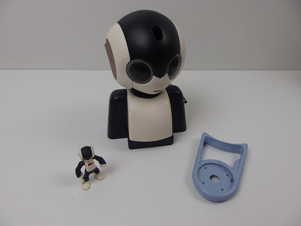

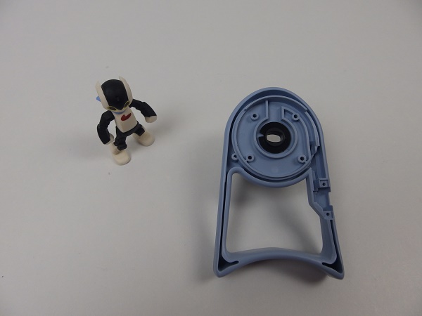

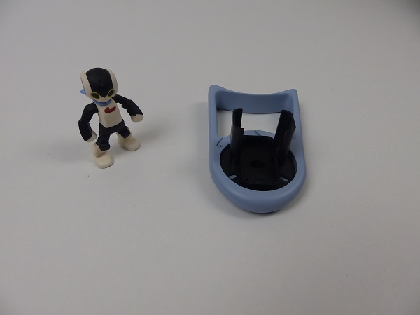

#7 Posted : 24 April 2016 11:45:16

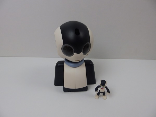

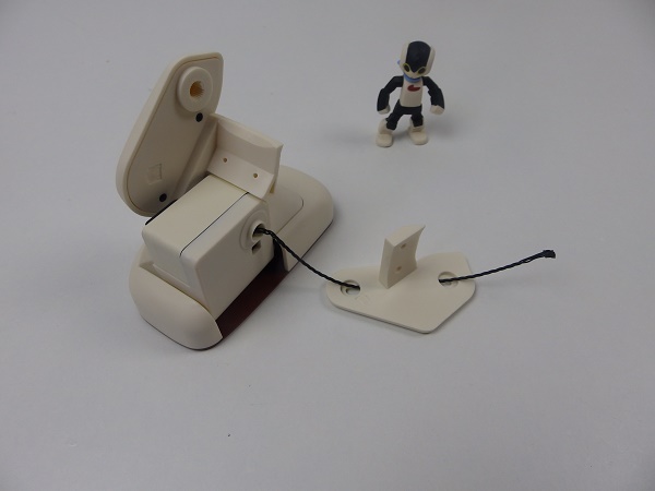

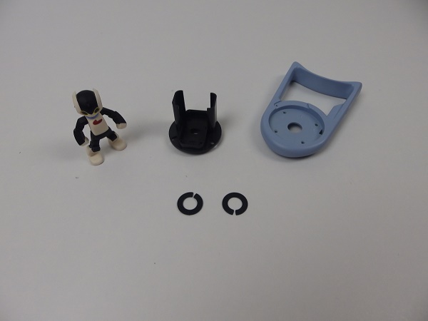

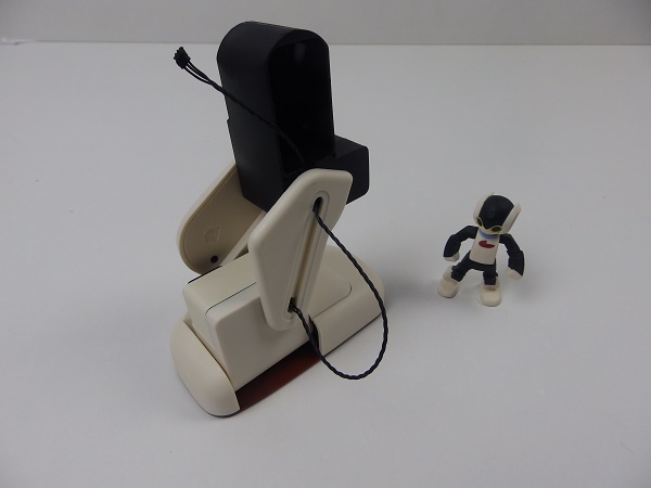

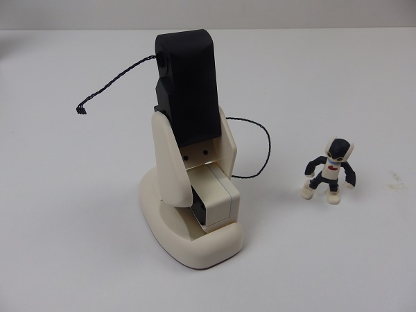

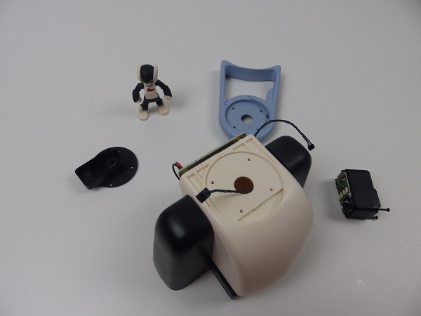

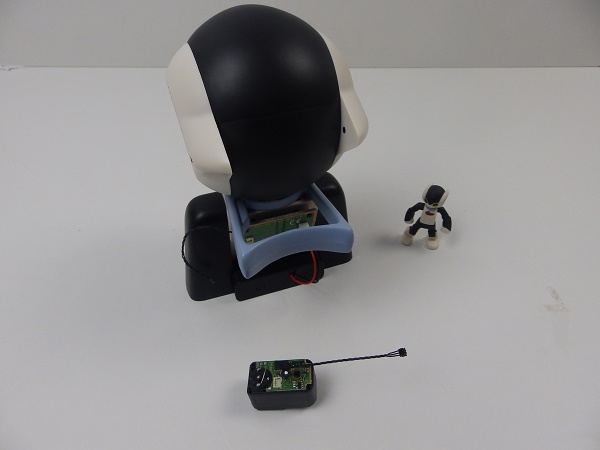

Issue 53

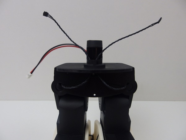

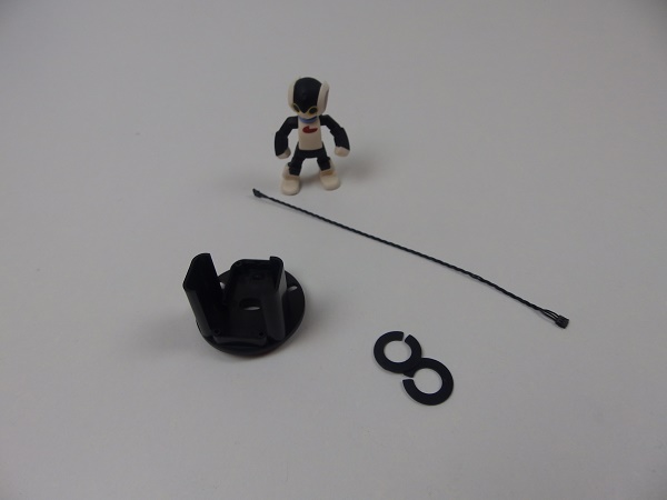

Your parts: Neck base, washers and servo cable.
Saved parts:You will be using parts from the previous issues, so be sure to have these to hand before beginning: Neck stand.
Dismantling and reassembling the neck stand.
If it is attached remove the servo cable from the circuit board and remove the head. Next remove the neck base unscrew the servo so you can detach the servo cable from the servo this will allow you to remove the scarf from the head stand. Reassemble the neck stand but without the scarf and reattach the head.
Fitting the new neck base.
Take the new neck base and fit it through the central hole in the scarf. Turn the assembly over and fix the base in place with one of the washers making sure the mould mark side is facing the scarf base.
