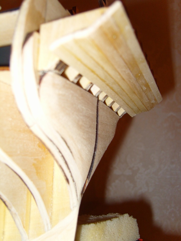

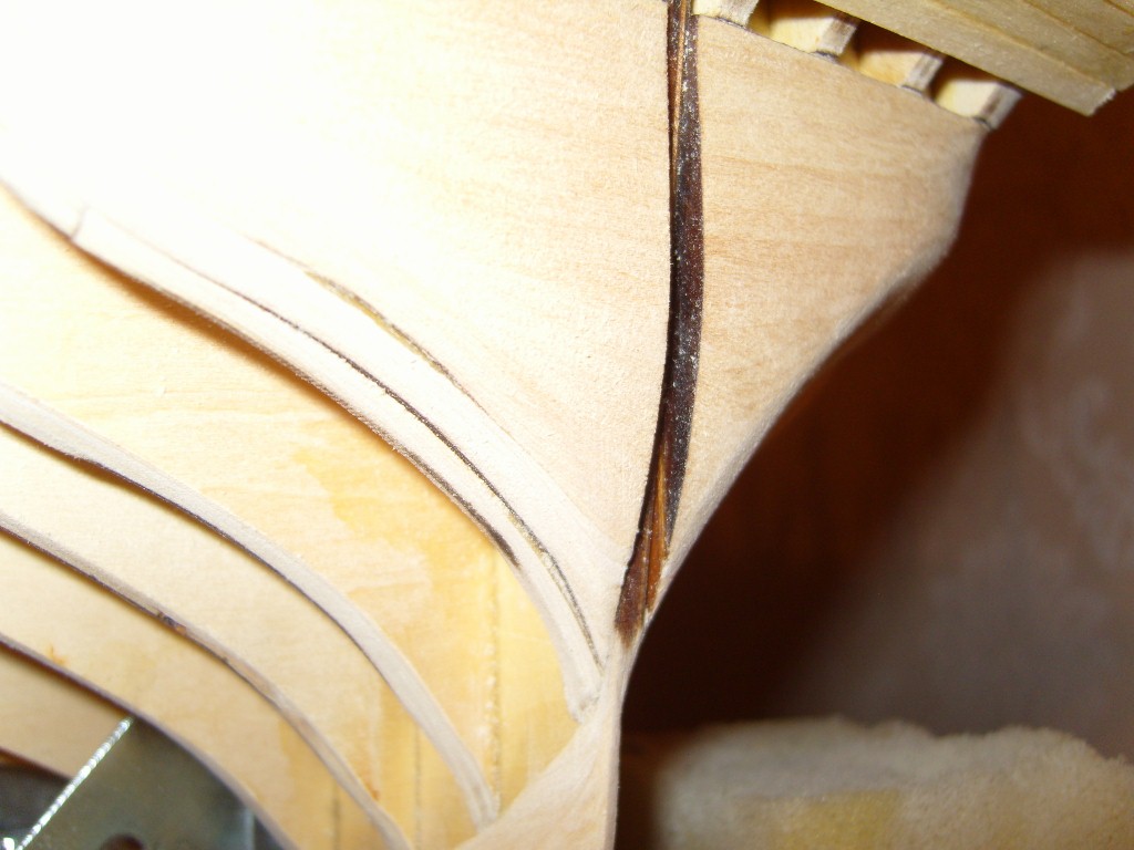

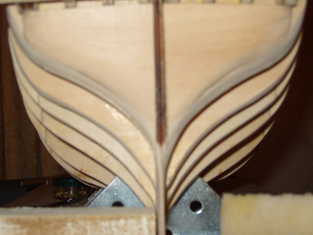

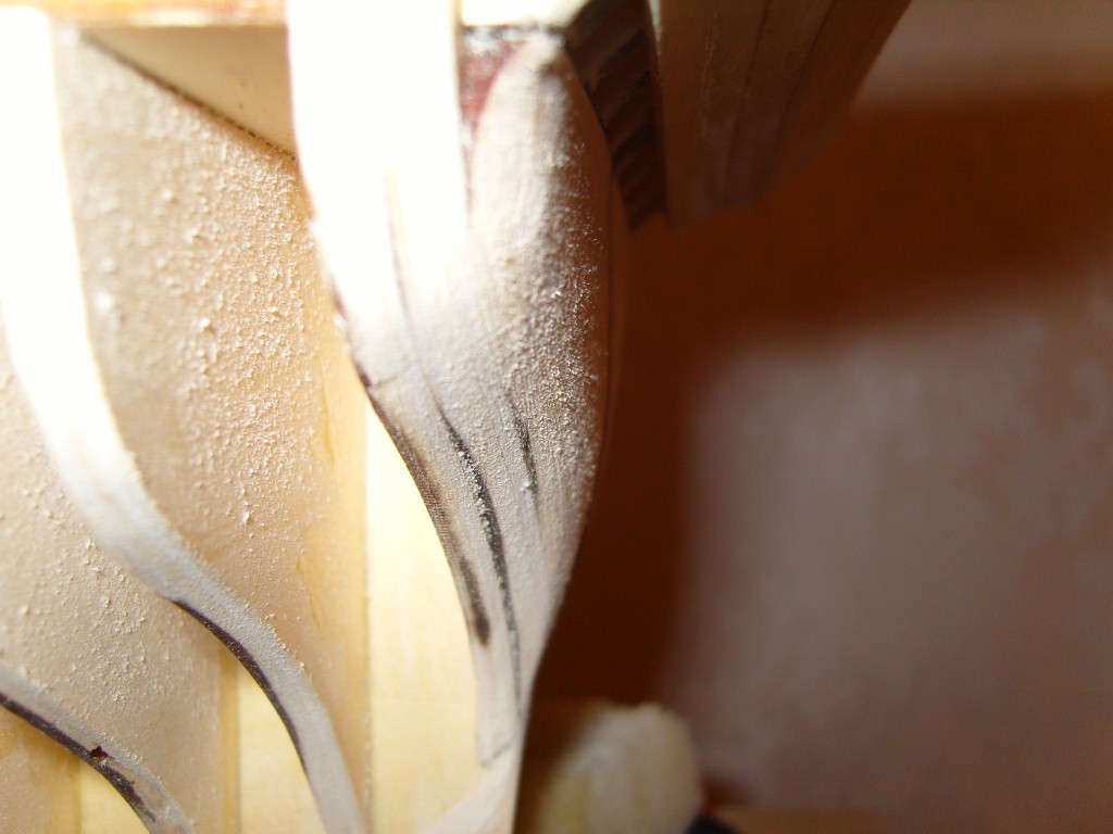

hi all i am at the stage of fairing the hull and working on the gallery support area. i have uploaded some pictures as i need some advise. do i need to fair the back more as the official build shows the lower end of the support sanded down to almost non existant. mine isnt. do i need to sand more? also the support gallery planks should they be sut square? or do they follow the line of the planking? if i bend my plank round the uprights it appears as if i will on get about 5mm when i get to the top?

smaller images attached so you can all see better

Darrend, before worrying about the gallery, you first need to sand the final couple of stern frames flush with the stern post mount which the stern post fits to later on; the side-on profile should run in an angled line top to bottom rather than the bulged out profile you have currently got because of the frames not being flush with the false keel, this area needs to be sorted out before you proceed with planking at the stern.

hi tomick thanks for the quick reply. sorry total novice here. you say to "level the final couple of stern frames flush with the stern post mounts" what and where are the stern post mounts. do they have a number i can refer back to in the mags?i think i understand that i should sand it down at an angle from top to bottom. looking at your pictures i can see what i have to do with tapering the end down sol that i can do. not sure still on the 1st part- sorry.

Darren,the stern frames need to be sanded down so that they are flush with the false keel,the rearmost frame will lose practically half its thickness at the top & disappear completely at the bottom exposing the next frame which wiil also taper somewhat at the bottom when you have finished.By the time tou have finished you should be able to fit 8 planks on the stern gallery although 8th one will need trimming a bit.

Have another look at the 'fairing the stern' photo on page 10 of issue 20 (bottom left-hand corner of page 10), it shows how the stern frames should be sanded so they are flush with the edge of false keel, not qute sure what you mean by where the false keel goes as its already in situ and is what the frames have been slotted into, the real keel is fitted to it later on.
#10 Posted : 31 January 2011 10:26:46
i will expand on what tomick has said and others.at the back end(stern)you have fitted 3 frames together,the false keel is the piece you stuck those last 3 frames onto,you sand these down so that they are flush with the false keel,the very last frame will nearly be sanded off and the next frame will have a fair chunk off as well.btw this part of the stern will now be known as the transome.
