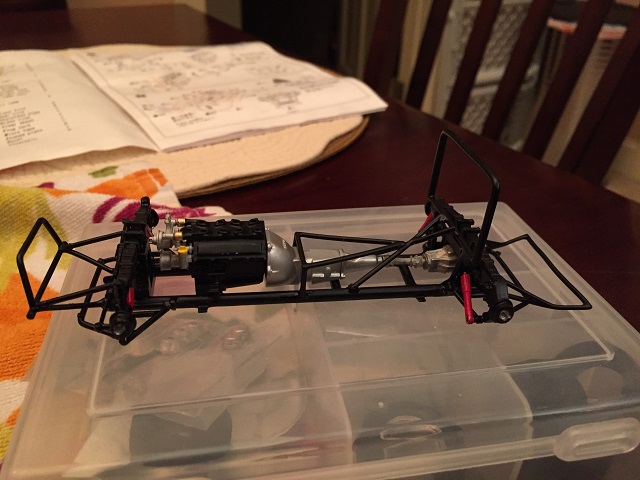

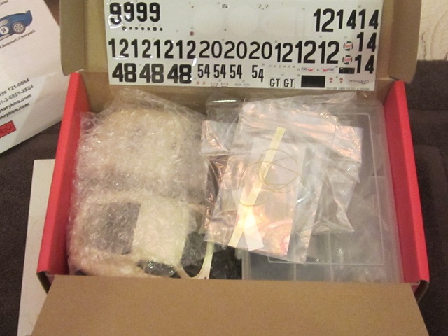

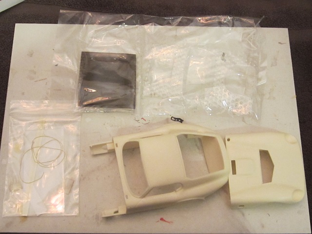

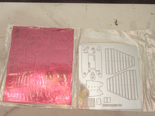

Here is my build diary for my Model Factory Hiro 1/24 Daytona Coupe racer.

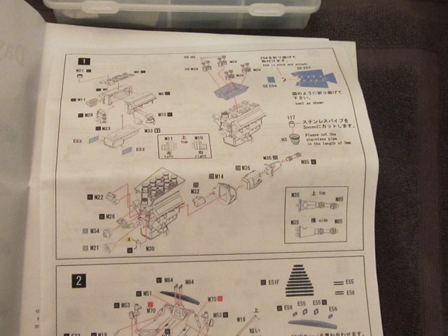

This is a Japanese made multimedia kit consisting of mainly metal parts with photoetched details and a resin body.It builds into a highly detailed kit and like a lot of multimedia kits it is a bit of a challenge to build.Here are some unboxing pictures.
I have done quite a bit of test fitting and so far this is a very well engineered kit pretty good fit.

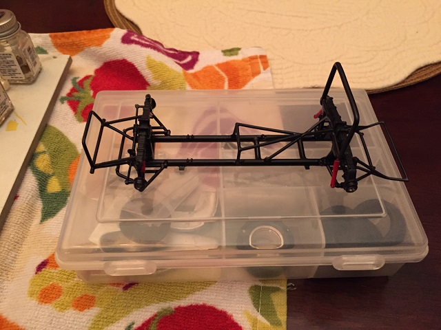

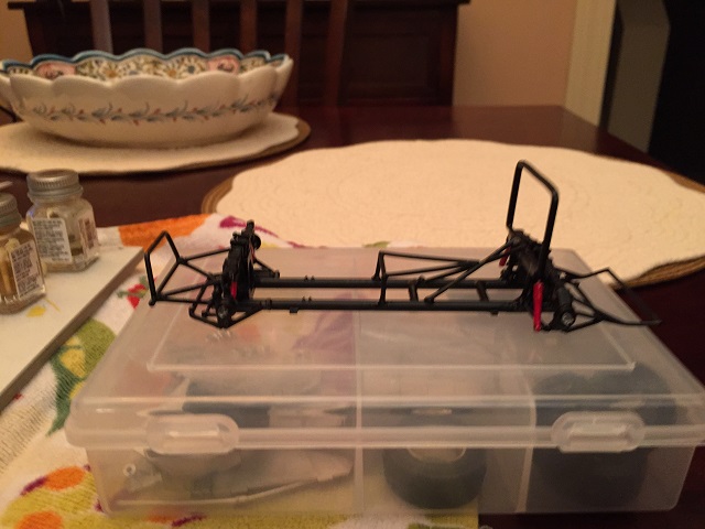

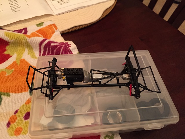

The frame is now assembled.The spring leaf suspension is made up of individual photoectched blades and then held together with photoetched ties.They assembled beautifully.Most of this wont be visible in the finished car, but it still is very detailed.Part of the engine is assembled.

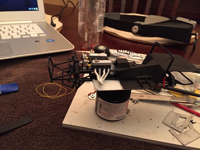

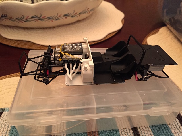

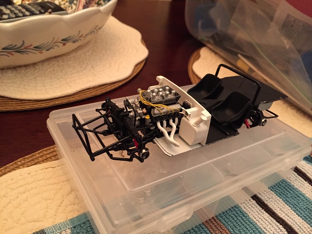

More work on the Cobra.I added the floor for the interior and added some more engine detail.The fan belt was tape and was a bear to attach.I seem to be having a paint adhesion issue and will need some touch up, but I will wait until I am done fiddling with the engine.It is quite heavy now and a bit tricky to hold without damaging.
#11 Posted : 07 April 2016 15:38:30
Disaster.The Cobra suffered a front end collision when it slipped out of myCursing hand and all of the front pieces popped off Cursing Cursing Cursing Cursing Cursing Cursing Cursing Cursing
So I have rebuilt it and now will have to repaint it.I think in the future I will try soldering the white metal parts together.Epoxy just doesnt hold the parts well and this is quite a heavy model. More pics to come once the repaint is done.

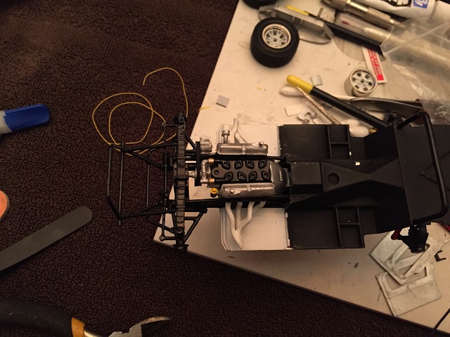

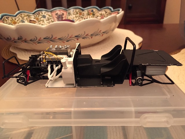

More progress on the Cobra.I rebuilt the damaged front end and added the carb and the spark plug wires, the firewall and some interior detail.The distributor cap pinged off into never never land so I used a piece of white metal to simulate it.next step is to add the rest of the interior detail and the radiator and then on to the out body shell.
