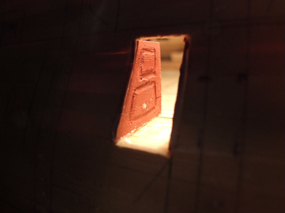

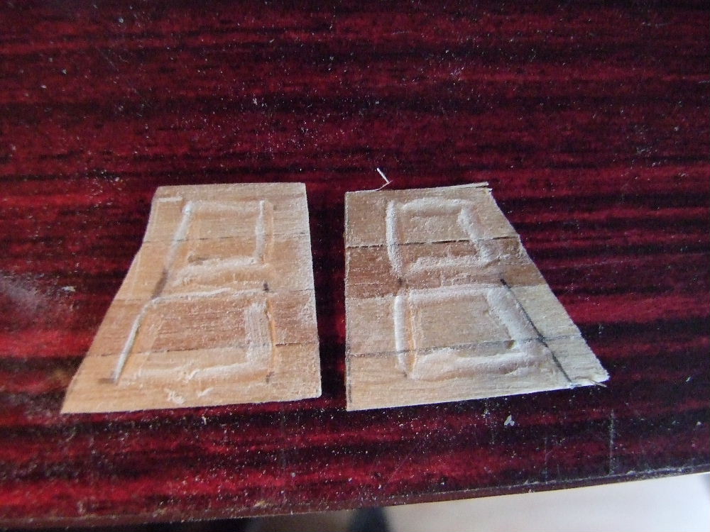

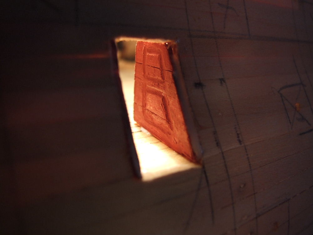

Because the entry port brakes up the run of gun ports the eye will stop at that point. So lets make it exciting and add some detail!!Cool
I have cut my new paneled side pieces from a small sheet of 2mm ply (piece of spare deck actually) you will need a 56mm x 22mm tho make the 4 panel sections. the dimensions of the panels themselves is 6mm at the top 9mm at the bottom and 22mm in length.
I marked out where i wanted the panels to be. My measurements were....
back edge of panels in 1mm in from back edge. front edge of panels in 2mm from front edge, this is to allow 1mm to be proud of entry port for sanding smooth once installed. top of upper panel 3.5mm from top edge, this is to allow a 2mm cross member later. bottom line of upper panel 9mm from top edge. top edge of lower panel 11mm from top edge and finally the bottom edge of the lower panel was 19mm from top edge
Using the point of a round needle file I scribed in the panel lines. once done I cut out the panels and then test fitted them to the entry port only trimming the bottom of the panel.
Once i was happy they fitted I widened the entry port by .5mm on each side as I was using 2mm ply. The panels were then glued into place.
The cross member should have a rounded radius. I used a piece of 2mm plank scrap cut and sanded to size. next I shaped the bottom edge with a round needle file and the cross member was glued in place
The bottom piece of liner came from the strip supplied for that purpose. once all dried i sanded down smooth with the hull. finally i carefully rounded the edges with a needle file and rubbed smooth with some scotchbright.
My last job was to give the panels a quick lick of walnut paint just to give you an impression of the end result. i will paint and varnish properly at a later date.
not difficult to do took me a couple of hours well worth the effort I reconWub
All Pictures author's collection. see my entry port detail pack for detailed plan.

I thought I would give this a try and am pleased with the results.
McDonald's wooden coffee stirrers have become an invaluable asst to me as this is what I have made them out of.

hi i used the engraving tool on the dremel,the left hand one is the one i used
cheers benny
