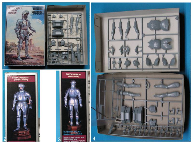

Photo 1 shows the box top and the contents in the box bottom. This kit is currently on sale for around the £20 mark, including postage from foreign climes, the cheapest I’ve seen these kits going for is about £12 (but not this particular one!)Blink If you can make out the little price tag on the box you’ll see when I bought it brand new it was £1.99!! (I think it was from Antics but might have been the Plymouth Model Shop before they became an Antics store!) Photos 2 and 3 are taken from the left hand side panel of the box top and show the finished kit from in front and behind, and finally, Photo 4 shows the full contents of the kit minus the two halves of the figure’s head. I did take a photo of the entire sprue but somehow managed to delete the ruddy file. By the time I realised that, I’d removed the head parts to begin planning the ‘alterations’. As you can see here, there are four main sprues of parts, most of the parts are on two large sprues with a couple of smaller ones, one containing the ‘hidden’ bits and pieces which join the main body parts together giving them a degree of movement (but not enough for what I want of course!)BigGrin and the last one which contains Frederick’s battle sword (fully drawn, scabbarded and an empty scabbard together with some vinyl ‘belt’ material).
So that’s the actual kit. According to the instruction sheet there should be a total of forty three parts. By the time he’s finished, there will probably be a lot more parts than that in total – especially if you include the most difficult part of the upgrade – 1/12th scale ring mail! I will be trying out quite a few new techniques with this one, with the poor old first knight I made all those years ago becoming the test bed for Frederick. Number one has already had a couple of areas re-done using a ‘metallising’ technique I thought might work, I won’t tell you what it is until it comes up in the diary but I will say that the effect has turned out even better than I’d hoped for!Cool

I looked at the pictures first before reading your article and thought to myself that it wasn't just going to be as straight forward build as it looks, then after reading your right up all became clear BigGrin

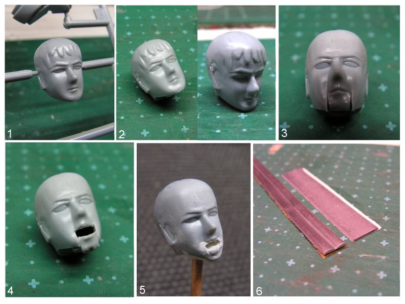

In Photo 1 we have the front half of Frederick’s head as supplied in this kit. From the available reference pictures it’s pretty obvious that he looks nothing like the Frederick of history! The face is actually a bit of an oddity – the box top art has a ‘mature’ face complete with a bushy ‘Prussian’ moustache which looks a lot like the German Kaiser, the photos of the completed model on the sides of the box show a younger looking face with what appears to be a full beard and moustache whilst the actual head is younger still, almost in his early teens. In fact, I think the face has an uncanny resemblance to that tyrannical psychopathic little monster Jofrey Baratheon, King of Westeros in Game of Thrones! (May he burn in hell forever!) So if anyone wants to scratch build figures from GOTs here’s a great starting place! With the two halves of the head removed from the sprue and glued together, we have the ‘kit part’ complete as in Photo 2. Unlike the bare headed Jofrey, Frederick will be wearing an item called an ‘Arming Cap’, this is a padded skull cap worn under the steel helmet as a shock absorbing liner. It was therefore necessary to sand off Jofrey’s hair down to a ‘bald’ appearance as shown in the rest of the pics. Now the surgery could begin. Frederick is encased in steel armour and mail in the middle of a savage battle and also in the middle of summer – he’s either going to be screaming orders (or insults) or panting his lungs out – so he’s going to need an open mouth! The first stage is illustrated in Photo 3 with two slices up from the bottom of the chin to the sides of the mouth. This was accomplished with a safety razor blade held in it’s metal ‘handle’ and rocked to and fro gradually working it’s way up through the plastic to the mouth as seen here.
With that done the next step was to use the same blade to cut down through the line of the mouth, starting at each side and cutting towards the other side until the entire mouth and chin could be removed like a ventriloquist’s dummy. The chin was then glued in position further down to produce the opened mouth as shown in Photo 4. Polystyrene glue is better for this than super glue as you can fiddle about with the positioning until it looks right and then leave it to set hard.
Once the chin has dried hard (overnight is best for this part) the next task is to sand and remodel. The obvious hard angles where the chin has dropped were sanded down with fine grade wet and dry and then a little ball of mixed Milliput was pushed up through the hollow neck and forced forwards into the mouth cavity until it began to extrude out through the mouth. With a length of model kit sprue stuck up through the neck, the Milliput in the mouth was then ‘poked’ back using an old cocktail stick (one with a ‘ball’ of dried superglue from previous use), this then formed the open part of the mouth whilst the outer edges were carefully ‘smeared’ back towards the cheeks using just a wetted fingertip. Finally, the extended chin was blended back into the face contours with a thin ‘sausage’ of Milliput again smeared into place by fingertip. The final result before allowing it to dry hard before sanding, is shown in Photo 5.
With the final fine grade sanding of the chin area completed, it was time to turn to the construction of Frederick’s protective head gear – the Arming Cap. Photo 6 illustrates two of my rolls of the excellent Decra-Led self adhesive lead strip. The one on the right is the standard flat strip which I used to form the seat harness on the Spitfires in the Scramble diorama. This will be used extensively later on to replace the moulded on straps which I will be sanding down on various parts of the armour as well as other parts such as the sword belt and shield straps etc. On the left is a thicker profiled strip composed of a pair of joined rounded strips. The ‘proper’ use for these in the construction of glass vivaria (ornamental miniature greenhouses or planters) is two fold – left joined together and bent at right angles they form the corner edging of the planter, slit down the centre and used singularly they can be curved into intricate ‘leaded window’ designs to simulate stained glass. For Frederick I’ll be slicing them down by half again to form the padded panels on his cap.

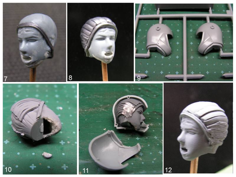

In Photo 7 I’ve positioned the first strip cut from the flat lead around his forehead to form the edge of the cap, as you’ll see later on, I decided to double this thickness with a second strip once the curved sections were going on. That lump of Milliput under his left ear shouldn’t be there! It was flicked away with the point of the knife later!Blushing
The Arming Cap is completed by Photo 8, as you can see, the individual padded sections have been formed by the thicker strips which have been sliced down their length to produce thinner sections and the initial front strip has now been doubled. The DecraLed in this shot is stuck on by it’s own self-adhesive backing, but this was then made permanent by adding thin superglue along each joint. Also, after I checked the fit of the head against the two halves of the helmet shown in Photo 9, I realised that nearly all of the cap was going to be hidden inside the helmet! There was therefore little point in modelling the rear of the cap so only the front part was constructed – which was probably quite fortunate as it turned out as there was a little problem with the fitting which I hadn’t banked on later! You can just make out in Photo 9 that the bottom of the kit helmet is actually solid with a cut out slot to take the tab moulded under Frederick’s neck. Unfortunately, with his now extended chin, Frederick wouldn’t fit in place for that slot to work and so the tab was duly sliced off as shown in Photo 10. That allowed him to ‘fit’ (or at least I thought it did) but there was still the problem of the solid front of the helmet, which would have to be cut away for authenticity (not to mention the reality of his head actually being attached to his body down below!) In Photo 11 we have the two halves of the helmet with Frederick’s head nestling in the left half. This is where the second problem arose as you can tell from the ground away shiny lead showing through the grey primer! With the internal ‘floor’ of the helmet removed, the head fitted in the left side with no problems, it also fitted in the right side the same way – it was when I tried to test fit both halves together that I realised his head was now too wide to allow the halves of the helmet to come together! If you look back at Photo 8, you can see that there is a considerable protrusion of the lead strip in the vicinity of his ears. A pity but as mentioned, it’s all hidden away inside the helmet anyway – so off it came via the rotary and a pretty coarse grade grinding cylinder – hence the nasty looking gouges! Once the head was fitting properly inside the helmet It was given a final fine sanding where required, mainly under the chin and a couple more coats of spray primer as shown in Photo 12, ready to begin the next task – painting the flesh!Crying
Incidentally, one of the main differences between Frederick’s armour and that of King Henry V at Agincourt is in the helmet. Henry did wear an actual helmet, one that sat on his head and allowed him to turn his head and neck, Frederick’s version is actually a ‘Helm’ not a helmet. In use it’s more like a deep sea diver’s head piece and is fixed in place by two leather straps to the breastplate and backplate. In essence, Frederick can move his head around inside the helm, but to look sideways he’d have to turn his entire body – not sure I’d fancy that in the middle of a hacking melee! Blink

A nice bit of plastic surgery there Robin, probably better than most of the Harley Street practitioners if one looks at some of the bloated and disfigured celebrities that have had similar done!! LOL LOL
As soon as I looked at photo #4 I thought "Gottle o' geer" and then I read your description to find that I was truly vindicated when you said he looked like a ventriloquists' dummy!! They do say that "great minds think alike" don't they .... or was it "fools seldom differ"!? Laugh Laugh
Great work on remodelling the chin and achieving a quite realistic open mouthed pose Robin and the 'arming cap' looks interesting, just a shame that most of it won't be seen, but it's your model and you'll know it's there (me too) and authentic, which is all that counts really isn't it!? I might have to track down some of that 'Decra-Led', it looks very useful stuff?!
Looking forward to your "adding some flesh" to the bones with the painting in the next instalment, so keep up the good work and well done that man - interesting stuff and a real history lesson which I am actually quite enjoying Robin, thanks!! Cool Cool ThumpUp
#12 Posted : 07 February 2016 10:42:26
Wow that is some serious and very well done modelling.
He certainly looks a lot better after his "face lift".

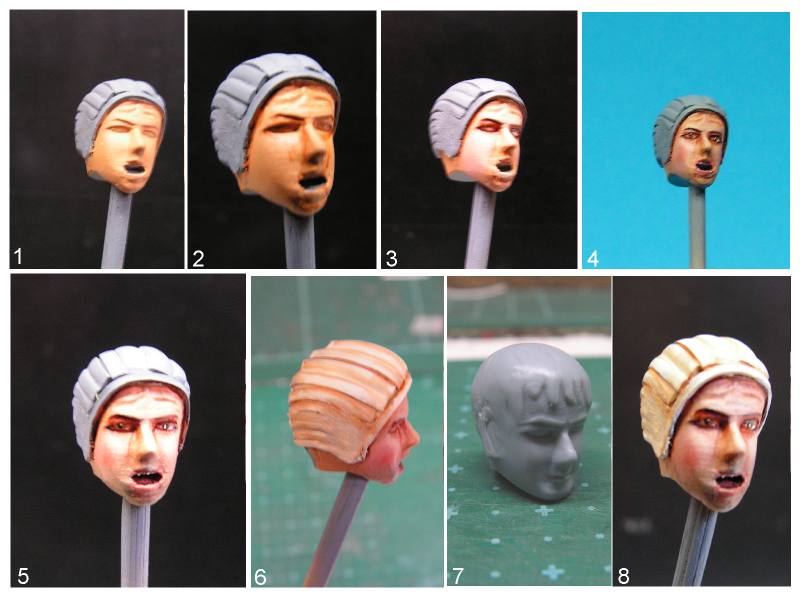

As I began the painting of Frederick’s head, the first thing I realised was just how out of practice I am in this very important modelling discipline! It’s got to be well over twenty years since I’ve painted a large(ish) scale face – I haven’t even done any 1/35 scale figures in all that time, just the 1/72 scale personel for the Messines and Scramble dioramas where painting a face is a case of undercoat/primer, flesh and a darker flesh wash to bring out any details!Flapper This one was going to require some head scratching and memory recall!Blushing
Anyway, in Photo 1 we have the very basic start to the painting process. The finished head has been given a couple of coats of Poundland Grey Primer Car Aerosol and allowed to dry completely overnight. There are many different ‘flesh’ colour paints on the market but for Frederick, who is an ‘outdoors’ type of bloke I’ve gone with the Admiralty Flesh which is a more ‘ruddy’ or suntanned type compared to the Humbrol or Revell hues. In the same photo the flesh areas have received two coats applied with a fairly small and soft haired Revell No.1 brush.
Photo 2 illustrates the first set of shadowing applied around the eyes, under the eyebrows, the sides of the nose, under the nose and under the lower lip using a thinned down wash of Citadel Flesh Wash, this is the same wash which provides all the details in the tiny 1/72 scale faces! Nearly forgot, the under edge of the arming cap is also lined with the wash as well. With Photo 3 we have the first application of highlighting using the same Admiralty Flesh lightened with Revell Matt White. This was applied using an old, once favourite natural haired brush, which has seen many years of service until it is not quite as ‘cleaned out’ as it should have been.Blushing It no longer comes to a sharp point but it’s slightly stiffer hairs now make the ideal ‘detail dry brusher’ for this kind of task. The flesh and white was mixed together on a scrap piece of shiny card and a little drop taken up on the brush and almost completely removed on a sheet of toilet paper. It was then dry brushed on the face picking out the lighter highlights across the forehead, bridge of the nose, cheek bones and chin as well as blending the previous shadow wash into the overall flesh tone. In Photo 4 and 5, things have progressed with Frederick’s brown eyes created with Admiralty Wood Brown followed later with a Black pupil and a tiny dot of White to give a touch of character. The larger brown iris was put in with a cocktail stick whilst the smaller pupil and white dot were applied with the tips of sewing needles. Looking at the photos close up, I'll need to re-apply the black to his left eye to reduce the size of the white highlight! The inside of his mouth was then painted in with a mixture of flesh, wood brown and Vallejo Carmine Red. This took a couple of goes to get the shade just right, and finally the same Carmine Red was mixed with the Flesh to create the lips and also a touch of ‘red cheek’. This is the first time I’ve ever added ‘rouge’ to any figure’s cheeks but I reckoned he’s wearing a ton of armour and padding (figuratively) and it’s the middle of a hot June in Germany – he’s going to be a little ‘flustered’ at least!Blink Finally, for the face, the final light dry-brushing of some more highlighting and blending together with a set of sewing needle applied top teeth (the photo makes him look like he’s got a set of ‘Nosferatu’ fangs in there, but when viewed from lower down they look better!) I did try a bottom set too but they didn’t look right somehow so I painted them out again!
Photo 6 illustrates the painting of the arming cap, this was really simple with a basic undercoat of the Revell Matt White as a foundation and once completely dry, this was then 'stained' to a linen colour by just giving it a wash with a very thinned down Flesh Wash - the easiest part of the lot!
Finally, in the last two Photos 7 and 8, you can see the difference between the basic kit head and the upgraded more 'Medieval' looking one.
So that’s it for the face painting, it’s a bit like riding a bike I think, once you’ve got the hang of it, the fundamentals do come flooding back again, even if you have’nt done one for ages (thankfully!). In the next instalment, Frederick gets into his helm and the next bit of up-grading and scratch building can start – with a real ‘horticultural’ feel to it!Confused

A brilliant conversion and very nicely painted. Cool
#16 Posted : 18 February 2016 17:56:56
Just caught up with your latest updates Robin and I reckon that you've made a good job of the face painting considering how little practice you've had? Cool ThumpUp
Though I do agree with you, the highlight in his left eye is a little large, which makes him look very David Bowie(ish) in appearance? Could be that actually you have it spot on as I don't think photography was around in his time so there will be no definitive reference photos to work from so who's to know EXACTLY what 'ol Fredrick looked like in reality? He could very well have been a 'wall-eye' for all we know couldn't he - it's not impossible is it?! LOL Laugh Flapper
Joking aside my friend, I think he looks great, nice job and looking forward now to seeing his helm fitted next time round. Will that be when you start the 'silver leaf' foiling method which I so correctly guessed?

Many thanks for those kind words Tony and Kev!Blushing And yes, you're right again Kev although you don't get the full effect of the total procedure so much on the next installment which only shows the metal effect on the inside of the Helm - that will come a little later when the outside gets done - which it now is, and I'm really pleased with the 'look' of it.Cool (I could have left the inside just painted really, but I used it for some more practice Blushing )

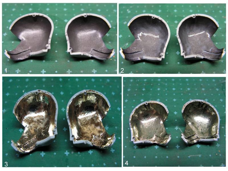

Photo 1 shows the two halves of Frederick’s helm with the inside painted with Humbrol’s Metal Cote ‘Polished Steel’. As you can see here, the polished steel is not exactly ‘Knight in Shining Armour’! I had tried a couple of experiments on the finished model knight with mixing the Polished Steel with my decades old original tin of Polished Aluminium. In actual fact that did work quite well and lightened the overall colour quite considerably. In the end though I decided to try a completely new technique spurred on by the excellent results obtained by KPNuts and his gold leafing and Kev (Modelmania) and his kitchen foiled Mustang! What I did was to send off to China via Ebay for a set of Silver Leaf sheets (get it from China and you can get it for less than half the price of UK suppliers, you just have to allow for about a month for it to arrive!) Fortunately, I’ve been planning on starting this model for a while and I sent off for the leaf just before Christmas knowing it wouldn’t arrive until after the start of 2016! This is a fantastically economic material, it comes in sheets of about (oh, hang on I’ll measure it properly) - three and a quarter inches square, and cost less than £4 for fifty sheets, less than eight pence a sheet!
The one I’ve got is called ‘Antique Silver’ and gives a slightly duller effect than plain ‘silver silver’ if you get what I mean! I did wonder if the antique effect would be enough to simulate steel without any further additions but unfortunately the answer was no – it was still too shiny for steel on its own.
Photo 2 illustrates the previously painted and polished Metal Cote after the application of the ‘Size’ the thin liquid ‘varnish’ used to glue the leaf in place. This is an acrylic size so the brushes simply wash out in water, this I did buy from a UK Ebay source – I waited for the leaf to arrive before I sent for the Size, even then, at less than a fiver for a 25ml bottle it was still far cheaper than trying the local craft suppliers down here. Larger amounts are available but this model is a trial of the whole gilding technique so I started off small!BigGrin The object is to apply a thin coat whilst avoiding any brush strokes as it dries. The silver leaf is only a few microns thick (millionths of a mm!) and it can even pick up the ripples from brush strokes if you’re not careful. The size has to be left for a minimum of fifteen minutes after which it is ready to take the leaf (becomes sticky), according to the instruction sheet the size remains useable for up to twenty four hours but I can’t swear to this as I’ve never waited that long!Blink
In Photo 3 the Antique Silver leaf has been applied to the insides of the helm. This taught me the first useful lesson – always try to cover the area in one piece – the right hand side was (virtually) a single piece of leaf whilst the left hand side was made up from the bits, which came away from the single cut down section. As I was to discover, not a good idea – which of course is why I’m experimenting on the inside of the helm first! (I had by now already tried the technique on the other knight figure with good results, but more of that at a later date.) What appears to be a hole in the back of the left hand helm is an optical illusion – it’s actually a reflection of the green cutting mat through the open front coming off the mirror surface!
In Photo 4 you may or may not see a slight difference in the ‘sheen’ of the silver leaf. This is after a single coat of the secret addition – a thinned down solution of the Humbrol spirit based Blue-Grey Enamel Wash. This is the wash I bought to do the panel lines on the undersides of the Spitfires and Hurricane in the Scramble diorama. By experimenting on the other knight figure I discovered that two to three coats of this wash applied as a varnish over the bare silver leaf tones down the overly bright silver and leaves a lovely ‘blue steel’ effect. As I mentioned, this first look at it doesn’t do the effect justice but you’ll see the full effect at a later stage I hope! This is where I learnt the disadvantage of applying the leaf in small bits, compare the left and right inner faces of the helm and you’ll notice the right hand one has lots of darker ‘squiggles’ almost like cracks in the steel. This is where the little bits of silver leaf come together – unnoticeable in the basic finish but the enamel wash follows the lines just as though it was a panel line (which is of course exactly what the wash was designed to do!)Blink This was a useful lesson though, when I get on to the full armour I’ll need to try and gild each separate piece as a single application, this is what I did on the other guinea pig knight and it worked really well.

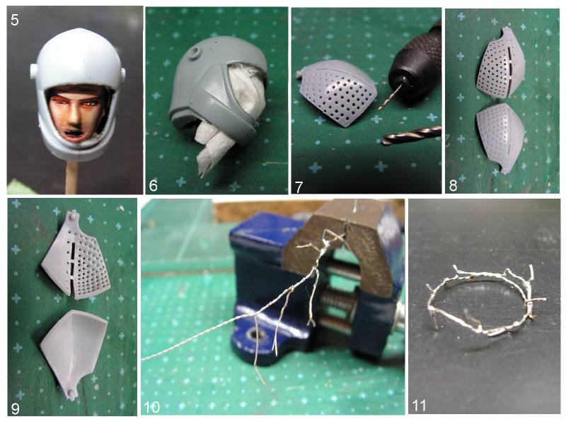

Photo 6 illustrates Frederick finally into his helm, which has been glued together, left overnight and then sanded smooth along the joints. See what I mean about all that hard work hidden away! The next task will be to give the helm a coat of spray primer (preferably without turning Frederick grey in the process!) so the next actual job was to mask his face up with a couple small pieces of folded loo paper! A small square was folded over and inserted up into the small gap under the chin. Using thin pointed tweezers, this tissue paper was then gently pulled up through the front of the helm until there was enough to carefully prod it into place around his face with the cocktail stick. Once in position a double check was made to ensure no tissue was overlying the rim of the helm which would prevent the primer coming next. The inside of the hollow head is still accessible however to allow the bamboo skewer to hold the assembly for spraying.
The next upgrade is applied to the other part of the helm – the visor as shown under way in Photo 7. This involves the drilling out of seventy three (I think) holes in each half of the visor, a hundred and forty six in all, and also sawing out the vision slit with an Exacto Razor Saw, sanding the resulting gap smooth and then replacing the dividing bars with extremely tiny slivers of styrene strip. (Those bars were probably one of the most irritatingly fiddy tasks so far!) The drilling of the holes was far easier, each one is already moulded in the plastic as a sunken dimple which made starting the pin vice drill easy enough. Once each line of holes was drilled through, the inside was countersunk with a larger drill bit to remove the rough scurf around the hole. You can see the huge difference this makes to the kit parts in Photos 8 and 9 (note the countersinks on the inside of the visor in Photo 9.)

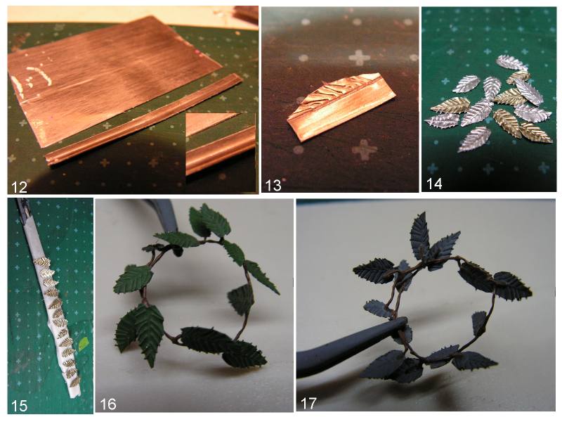

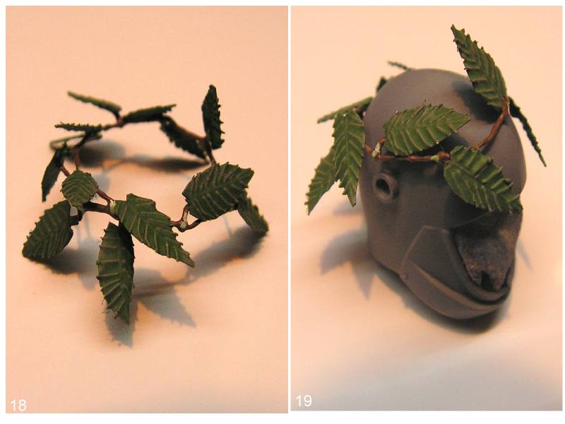

Now comes the horticultural bit – the creation of the garland of hazel leaves which Frederick and his allies used as their medieval IFF device. Photo 10 illustrates the first part of the garland underway, using the same .2mm wire that I employed to create the barbed wire on the Messines diorama. Once again, the core of the design is a double strand of wire, one end secured in the chuck of a pin vice and the other clamped in the mini vice, the pin vice is then rotated around with thumb and forefinger to create a twisted double strand. Onto this core, a series of small ‘branches’ are wound using exactly the same procedure, take a short length of wire, fold it double and clamp the loose ends in the pin vice. Thread the open loop over the core and slide it down to the rough position and then ‘twirl’ the pin vice, tightening up the short length until it is attached to the core. Finally, secure it in place by soldering, applying the solder at the joint and also running it along the core and branch. Eventually, after snipping off the excess protrusions you have a long enough length complete with ‘twigs’ to be able to form it around a circular object roughly the same diameter as Frederick’s helm as shown in Photo 11 and soldering the ends together.
The next part is something I was very pleased with – after scouring Plymouth looking for ready made ‘crafty’ type leaves and coming up empty handed, I had to think up a way to make them myself – the result was not only just what I wanted – it was completely free as well!Cool
Photo 12 shows yet another piece of my Mum’s expired eye ointment tubing, cut open, flattened out and washed off before paint-stripping the tube printing away. This is the same material as used to make the corrugated iron sheets in both Messines and Scramble. I am really getting worried about my stocks of this metal, back in August of last year there must have been a contamination outbreak in the factory which produces this ointment – all the existing stocks were re-called and the date for re-stocking the chemists has been pushed back and back, first it was December, then February and now the latest is April or even June! Poor Mum has had no eye ointment on her prescription for four months (the only alternative has also been withdrawn) and what am I supposed to do for building materials!! (Only kidding Mum!) (Since found out the entire factory had to be stripped down and examined as tiny pieces of black plastic was found around the tube nozzle due to the machine which tightens up the tip doing it too hard!)Blink
Anyhow, as you can see, I’ve cut off a thin strip of the metal the same width as the hazel leaves and this strip has been scored down the middle to form the spine of the leaf, (see close up in the corner). One half of the leaf shape is then scissor cut away and using the reverse side of a modelling knife (the aluminium handled variety), the veins have been scored into the leaf as shown in Photo 13. The hazel leaf has a sawtooth edge to it and the scoring replicates this nicely. This is then repeated on the other side, this part being the most fiddly as there is now almost nothing to hold the leaf down with to score the mirror image of the veins. The final task is to create a little concave ‘dip’ at the fat end of the leaf with a couple of knife cuts, the final appearance is shown in Photo 14, the gold ones are scored side up, the silver ones embossed side up. The finished leaves were then stuck to a piece of masking tape on a coffee spill for grey priming on both sides. I half expected the first grey side to pull away on the masking tape but it went surprisingly well and both sides were soon primed for gluing and painting.
Photo 16 shows the garland after the leaves have been fixed to the twig circle. The garland was first given a couple good coats of Admiralty Wood Brown and once dry, the leaves had a tiny strip of primer scratched off as did the wooden garland before each leaf was attached with a small drop of super glue gel. Photo 16 shows the leaves upper surface painted with Vallejo Medium Olive Green whilst Photo 17 shows the bottom surface still in grey primer after each joint was further re-enforced with a drop of liquid super glue for good measure.
The last two Photos 18 and 19, show the finished garland, in isolation and just balanced on top of the helm, (minus the visor as I was still working on the other half at this stage!) Note the little pale green splodges on the twigs, these are the tiny buds found at every leaf base on the hazel branch, ready to sprout out if the leaf is lost. Apologies for the yellow tinge on these two pics, I didn’t realise until too late I’d switched on the old workroom low wattage light by mistake – all the ‘proper’ photos are taken under a pure white light from a double strip of LEDs stuck across the ceiling!

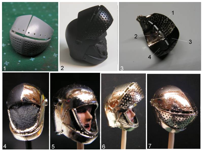

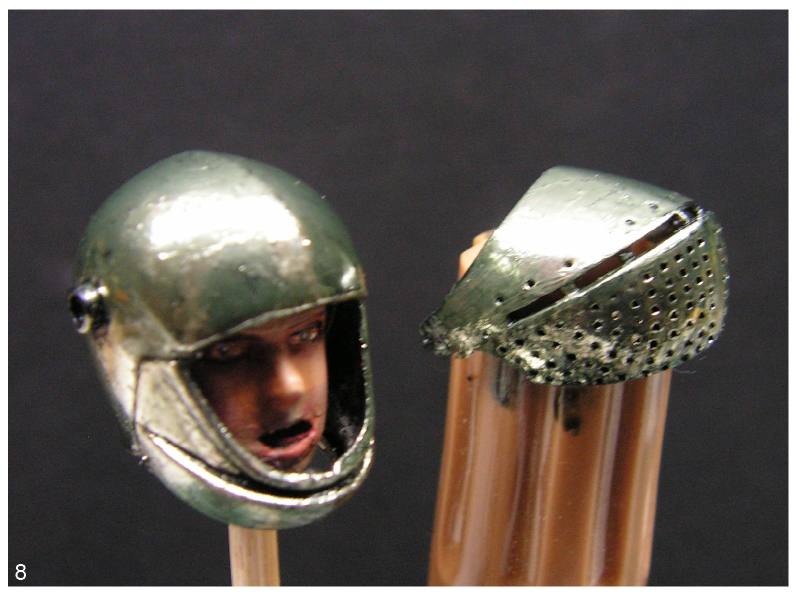

Carrying on with the visor, once all those ventilation holes had been drilled out it was time to glue the two halves of the thing together. Because a certain amount of the plastic had been removed with the opening up of the vision slit, I couldn’t be certain that the two halves would fit exactly back together. The easiest solution was to glue the bottom part together as shown in Photo 1, give it twenty four hours to dry completely and then glue the top section, keeping the top together by finger pressure until the liquid poly had set sufficiently to keep the joint in place. This worked well although as you’ll see later, I had to repeat the whole process a few days later!Crying
Once the visor was set and the joint sanded smooth, both it and the previously grey primered helm were given a second aerosol coat of matt black – again the Poundland car spray range. Although it’s called Matt Black, this one does have quite a sheen to it as you can probably see in Photo 2. Still, it does cover nicely and gives a good definition to the moulded details as you can see here.
Now came the delicate part with the covering of the Antique Silver Leaf. The inside of the visor was tackled first, being done in four sections as shown by the 1-4 in Photo 3. In this pic, sections 1 and 2 show up well against the remaining black finish with sections 3 and 4 applied straight after the photo was taken. Photo 4 illustrates the main helm’s gilding underway. This was done in three stages; the chin section came first, performed with a single piece of silver leaf followed by the left hand side of the helm shown here (the size was applied following the centre line) and when that side was on and smoothed down, the right hand side was sized and then gilded, each half being a single piece of leaf again.
Photo 5 shows the entire helm covered with the leaf and the tissue paper masking removed to reveal Frederick’s un-sullied face back again and Photos 6 and 7 show the completed helm with the finished visor clipped in place. The outer part of the visor was gilded in two parts; the lower area with the ventilation holes followed by the upper section with the vision slit, each part being a single piece of leaf again. Almost all of those tiny little holes have been duplicated perfectly in the leaf, out of almost a hundred and eighty holes, only about half a dozen needed to be re-done with a sewing needle to push through the leaf (in every case it was the liquid size which blocked the hole, not the actual silver leaf).
Now came the experimental part of the process – reducing the bright silver of the leaf to produce a more life like ‘steel’ effect. In this instance, the effect was achieved with a single application of the Humbrol Blue-Grey Enamel Wash. I applied it a little more thickly than before using my bestist softest haired brush (I must get some more of them before long!) and then almost ‘lacquered’ the wash over the leaf, allowing it to collect in the crevices to produce its own shadowing. Hopefully, if you compare the finish in Photos 6 and 7 with the washed/lacquered/varnished helm shown in Photo 8 you can see how the bright silver has taken on a more subtle ‘blue steel’ appearance. This method has one main drawback – once the enamel wash is applied over the silver leaf it takes literally weeks to dry completely (well, about ten days at least)Blink . This led to a near disaster in the case of the finished helm. To try and speed up the drying I left Frederick stuck on the end of a cocktail stick held in the helping hands gizmo over the edge of the radiator on the top landing – unfortunately not telling my Mum why it was there! I came home after it had been there for about four days to find the entire window and radiator shelf bare. After I stopped screaming I enquired as to the location of the thing I had been working on for the last three weeks to be told “Oh I’ve cleaned up the top window, everything that was there I’ve put in that box”. So there, in the bottom of the box with all the other items (some quite heavy) on top was Frederick! The varnish was almost dry so there wasn’t too much damage in that department but when I tried to get the visor off to fit the hazel garland the darned thing snapped in half down the joint! It went back together again but the top section needed to be re-sanded down which required a whole new layer of leaf and wash (and then drying time of course!)Crying The moral is obviously let your Mum know what you’re doing (and then tell her not to touch!!)BigGrin

Your foiling looks good Robin and I agree the Humbrol Blue Grey Enamel Wash does give a very convincing 'Blue Steel' look to the armour?
