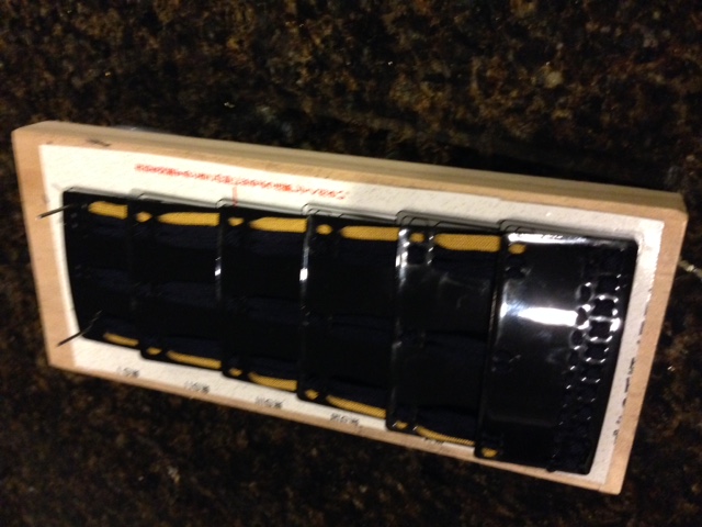

I am not sure how this works but the photos should be here. Posting commentary with photos has not worked well for me and this is my third attempt. Just did a Preview and WOWMOM they are here.
Ok, a deep breathe and we start again.
I received my kit early on Christmas Eve, just two days after ordering. Quite a surprise! Did not get into it until 12/26/15 and finished Pack 1 on the 29th. About 18 man-hours with the assets accounting for 2/3 thirds of the time. No real surprise here. I do plan to log my time on the build more exactly as this goes on and will report.
So much has been covered already of these Builds so I will comment on what happens and not rehash what has been said. My questions are planned and I hope you all help me.
Generally, the instructions are great, follow them. Relax, have good light, enjoy the journey without looking for the end. That's why we build models. Two fingers of bourbon every so often also aids the experience.
I decided to use medium viscosity CA glue with an accelerator spritz when needed. The white glue is included in the US kits but I opted to a thinner variety.
Stage 1 -
Be sure your tasset holes are aligned and save suffering down the road. Apply your glue from the inside when you can. Make sure your silk lacing is well prepared. I found the silk very difficult to cut. My wife's good fabric shears are the best. Establish your folds and keep your needle points thin.I stiffened them with a coat of CA.
Stage 2 -
I was worried about the nose piece being removable down the road so the left nose pin was not glued for now. The interference fit is good - no worries. Watch your mountains and valleys when lacing. I learned to use a toothpick right at the tasset hole in the direction of pull to adjust the fold. Be careful but it works for me.
Stage 3 -
My helmet bowl and lips did not quite mate. Suspect it is due to the paint applied to both surfaces. I filed the bowl tabs with a modeler's metal file to remove the paint and a bit of metal until the surfaces mated. Worked well. The Ball knots - they are slippery little devils. Prior to cutting off the bitter end place a small drop of CA any the cutting point before sniping off. Trust me, repairing an unraveled ball knot when no spare lengths are available is no fun. Secure your work.

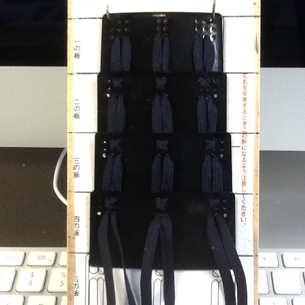

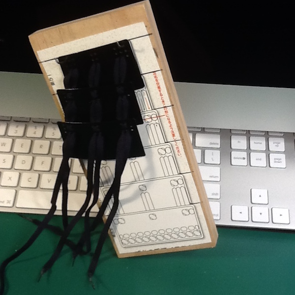

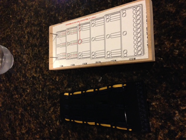

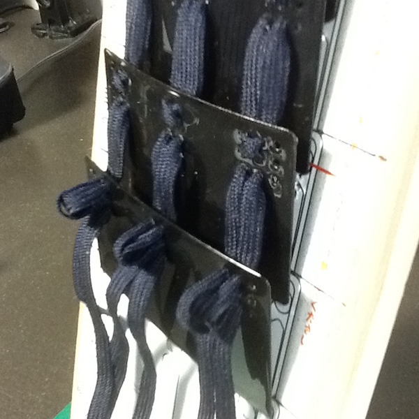

NOW, we get to my pictures. I made the jig as shown and used it to finish my first tasset assembly. It works GREAT! You can allow a bit of slack, adjust to correct, flip the plates over, apply a small drop of CA where the lace and last hole meet as you move lower and it all stays in place. I also dampened all laces and let them dry vertically. Be sure to file and round your nails - I have also curved them backwards more since the photos were shot. I will comment more on this jig to see if my first impression holds.
Stage 4 -
No comments needed.
This is my first subscription model and i like the time management provided. So I am asking if someone would sent me the dimensions of the cardboard display box included in the build. I am a good woodworker and wish to do the crate in wood. Simply Height, Width and Depth. I read Metric and English. What wood would be appropriate? Mahogany is my first pick but is that OK? Would the pieces be one piece or planks? A 3' wide single flat piece in the 15th century is hard to imagine. I think 3 piece tongue and grove planks are better as these hand shaping planes were well used then. I also ask about hands and hasps. Rope handles and toggle hasps seem appropriate. Comments please? I also plan to used blackened nailed brass edging. OK? Would the top of the crate be hinged or simply lifted off?
Questions on a backpiece flag and swords will be be later if I am still alive. BigGrin
Done.
tnequette attached the following image(s):
#2 Posted : 30 December 2015 22:29:09
Hi Tom, photo's are fine as is the text. Nice looking work there and great job with the jig....Cool Cool

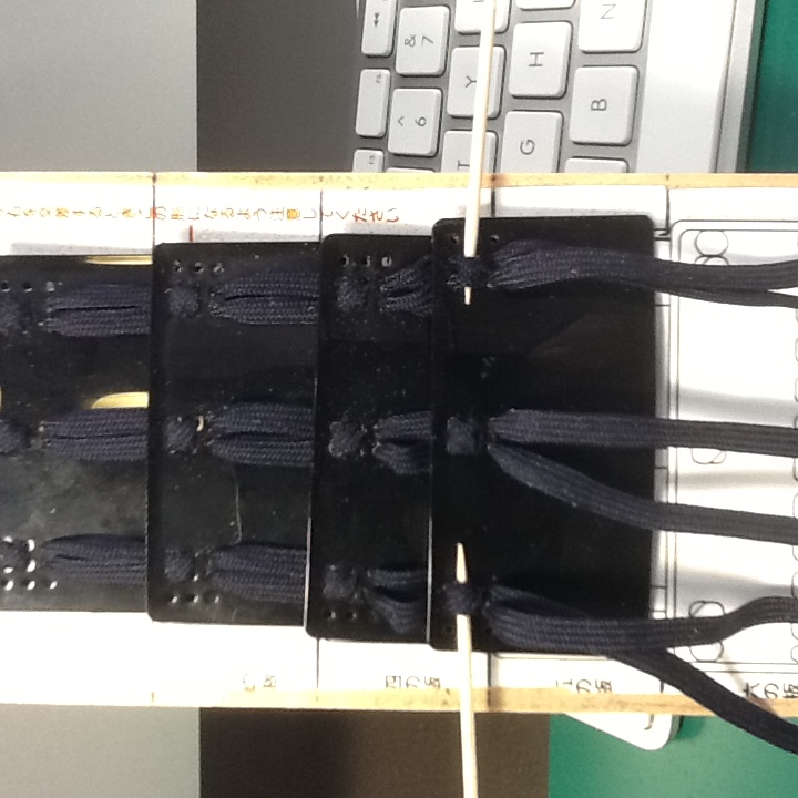

#14 Posted : 05 February 2016 00:08:35
Joined: 22/12/2015
Posts: 246
Points: 776
Location: Birmingham, AL, USA
I think I have this figured out, again. Thanks Martyn and Alan, again, for help.

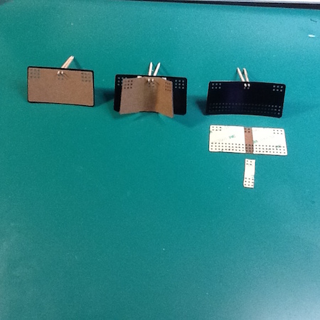

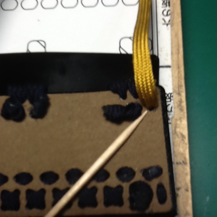

We are half way through Pack 2 and it is a good time to report. I have spent 20 man hours so far. Assembly of the helmet visor and wing is straightforward. Just follow the instructions.
The tassets and jigs took 85% of my time.
I wanted a better way to attach and align the backings to the assets to ensure all holes were aligned. Working from the middle outwards, using two toothpicks in the top center two holes in the taste to guide me looked good. I made a dry run and then used an exact knife and cut out a small strip from the backing adhesive paper, taking in the two holes. It was easy to align the side holes with the center holes filled with toothpicks. Smooth down the center section and then pull back one side paper and gently lay it over the side holes. Repeat for the opposite side. The picture tells the story better.
tnequette

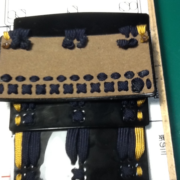

Now, if Gord reads this maybe he could tell me how he was able to combine text and photos in sequence in his build diary.

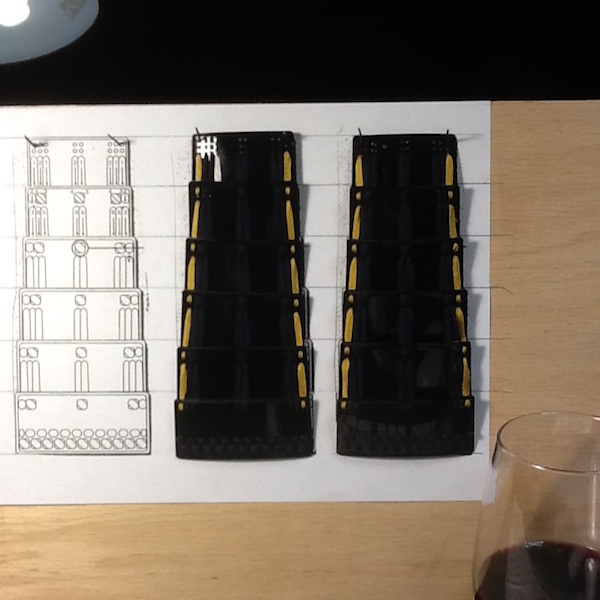

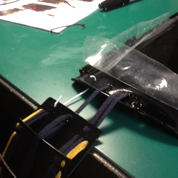

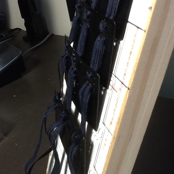

After completing my first set of tassets on my jig, I extended to lines for the top of each plate so it would be easier to work and adjust them as assembled (Photo below). I found it easier to handhold the first three as I laced them a bit loose and then putting them on the jig. Use the lines and pull the laces to be sure they match the pattern. Attach the next three plates on the jig. They will flop over easily for lacing. keep them a bit loose and then adjust. See the photos. You can see how loose I kept the laces as the plates were built up. Use your fingers and toothpicks to take up slack from both the front and back of the plates.
All laces were secured with a dab of medium CA prior to knowing them. You can hide the glue where it won't be sen if someone dares to flip up your tasset! Knots were also secured with a drop of CA.
Finally, I made up a hanging rack by scanning my jig's check sheet three times and cut and pasted them on a sheet of paper, extended lines between the plates and then scanned all onto one page of paper which got glued with adhesive spray to scrap wood ply sheet. You can see the final results in the photo.
On to the cuirass side and MORE TASSETS!
Tom

#18 Posted : 05 February 2016 02:03:21
Hi Tom,BigGrin
Looks good and the jig seems to be working well.Cool
To get text between your pictures you need to use a third party Web site like "Photobucket", it cannot be done using the Model space system.

After a bit of thought I feel it may be useful to say that my little tasset jig is proving out very well. It makes handling the assembly very easy as well as allowing me to align the plates and take up slack in the lacing without plates falling all around my hands. The caveats sent to me on being careful about overall lengths well well taken and the jig as well as the hanging rack help.
Most modelers hate repetitive work. We like to build the original but constant reproduction of the same part is just BORING. Examples are 106 cannons for your Victory as well as backstays, clews, ratlines, halyards, copper plating etc. Or a thousand rivets on a tank.The problem here is that this is were we tend to make our biggest mistakes which causes rework or worse.
So, I tend to jig where ever I can if multiples have to be produced.
Sorry about my photo posting problems and I do not like the shots not being separated but I am learning. This forum program was written for folks who drive on the wrong side of the road. BigGrin
Tom

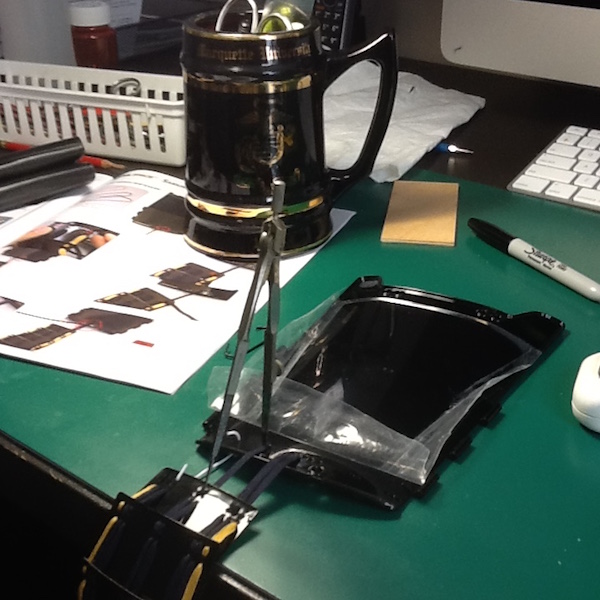

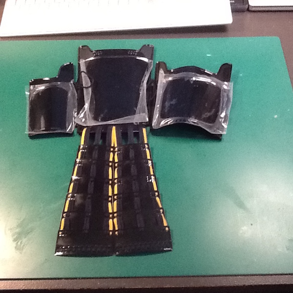

Pack Two is now finished. I started it on 1/27/16 and finished 2/7/16 and put in about 34 man-hours.
The second half of the build was dominated by finishing and attaching the tasset plates to the cuirass. Assembling
the curios sides is easy, follow the instructions and refer to the precious diary builds. After building the two full tasset assemblies the actual reeving the laces between them and the front curios is not difficult. Cool
But was difficult for me was the actually handling of the parts involved to insure the 4cm spacing between them. Sort of like playing with noodles, they are all over the place. The the curiass plate is not small and and I had to lift it off the table constantly. Another point which you must take into account is that bottom of the front plate in not straight but curved therefore the 4cm spacing varies a little from side to side. Finally I had to wrap my head around the fact that the tasset placement is offset. There are more holes to the left than to the right. The instructions here are correct, follow them. Huh
I laced the first holes as shown and then took a bent paper clip, spaced to a 4cm spread, and put it into the outboard holes ( yellow lacing holes) of the tasset and the correct curiass hole. Then I could pick up the assembly and continue loosely lacing. Then lay it down, snug up the laces, section by section using dividers to ensure spacing. Carefully turn it over and use some CA on the rear of the plates where you bridge the section holes to secure it. The paper clip helps holding up the far end of the plate. Easy. LOL
Now what do I do with all of this? Well, I just map tacked it to the wall, looks great! BigGrin
