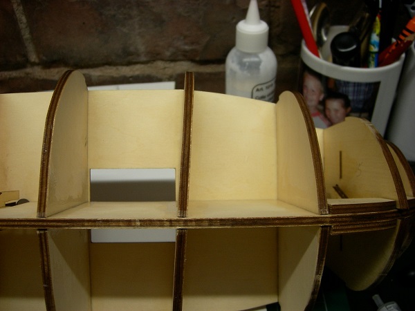

Hi Folks,
My first build, and also a Blog virgin, will post photos at each progression, and gladly receive all and any advice from anyone!
I am having issues posting pic's. Often there is a tag which when right clicked on the image will appear, will try to resolve over weekend.

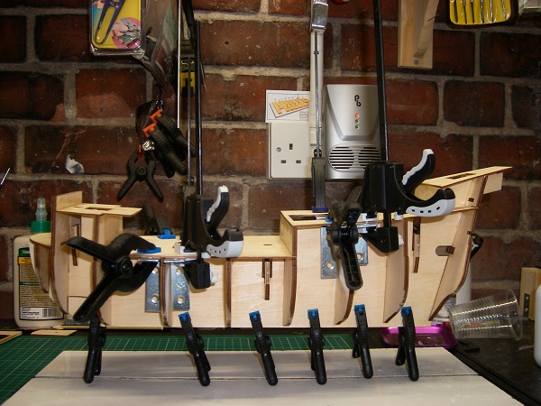

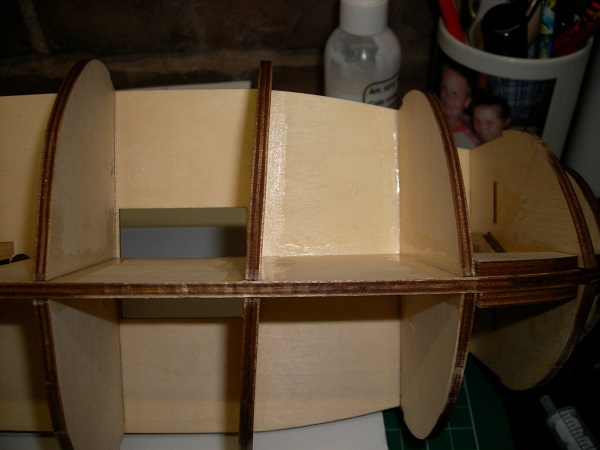

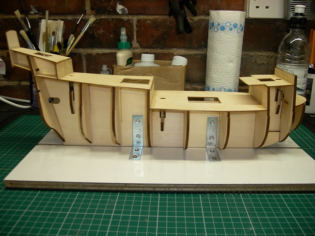

Couple of slip ups, major being "READ THE FORUM BEFORE EVEN BUYING"! Which I failed to do, And clamping your ship whilst glue is curing is an absolute necessity. How to remove glue. because a part of the keel laterals was warped after gluing over night, so use them clamps at every stage
ModelSpace » Ship Modeller » San Francisco II » San Francisco II - General discussion
Brushing warm water to the joints, then steam the joints and will eventually enable you to separate the components Pic's showing how far out the lateral framework had twisted on mine. In the region of 18-20 degrees.
On removal & and replacement all is well in the last shipbuilding yard left on the Tyne aka my workshop. Although nothing compares to the quality of the warships built on the Tyne,
My ship (HMS Northumberland F238) was the last but one to leave Swans yards, I worked on her in build, as a Weapons Officer signing off & accepting completed works on behalf of the MOD, the shipyard workers were fantastic, even knowing that once we sailed approx. 60% of the men who sailed her down to Devonport, to hand her over to the RN officially, knew that over half of them would be getting the "brown envelope", as they were driven back to Newcastle a bloody disgrace by the government of the time
Even 20 years down the line I still feel anger & resentment at the way Swans workers were treated.
That's my rant for the weekend!!! Below are pics various will take more as I go, and I won't be ranting every postCursing

Lazy Saturday evening & Sunday.... with grandkids age 13,8 years old... a possibility... but the third one is 2 years 5 months... I had lazier and less stressful days during the Falklands conflict

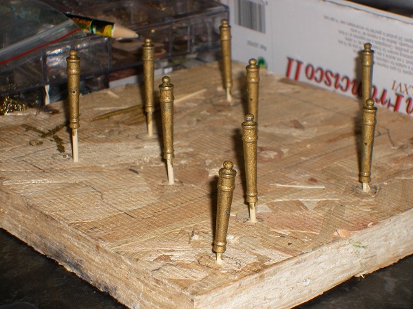

In between hide and seek and peek-a-boo I managed to get a coat of brass on my cannons, mounted on improvised rig for a very thin coat second and final coat to follow
Partial completion on Jig, next job on main body is bringing the bow down top size & appropriately curved, you can all have a good laugh when I post the "Wood butchery" which may well occur tomorrowCrying

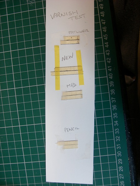

Tried out a couple of caulking lines ideas using pencil/ different sizes felt markers/ HB pencil then coated them in matt varnish any opinions on those which look most realistic?

Keep the pics coming, very nice progress...Cool Cool .. I tend to lightly sand the edges of the planks to ensure a smooth edge then use permanent black marker. By lightly sanding the edges I find the chances of black ink bleeding into the plank is greatly reduced....Cool Cool .. Hope this helps..

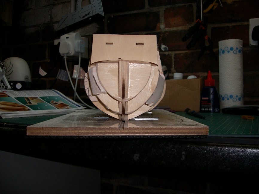

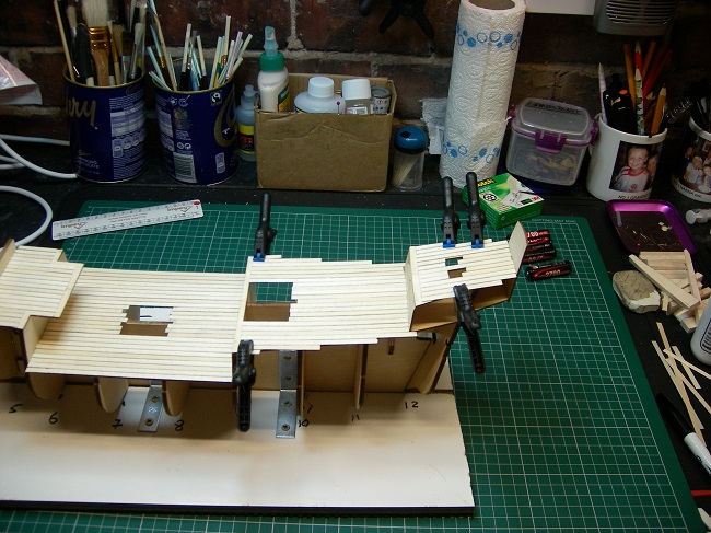

Now taking wood butchery to a new level as I attempt the required curves to the bow and leading laterals. Very nervous about this, slow and steady is order of the day... stage one:
After 1/2 hour sanding started getting a little slapdash, so decided to have a break and cut a few planks to size & ended up placing a few in:
Now concerned that the "Caulking" may be a little on the heavy side, but welcome any & all comments. Much like other blogs I read I found the cutting and subsequent gluing of the planking quite relaxing,
Finally thanks to all for kind words & suggestions to date

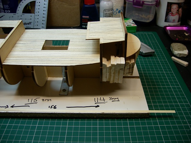

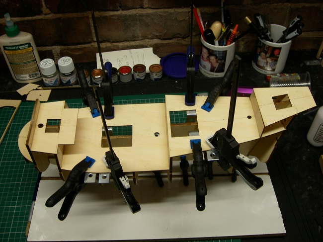

#14 Posted : 12 December 2015 15:49:03
Rank: Beginner Level 3
Joined: 16/11/2015
Posts: 23
Points: 72
Location: At the edge of reality
Hi Folks,

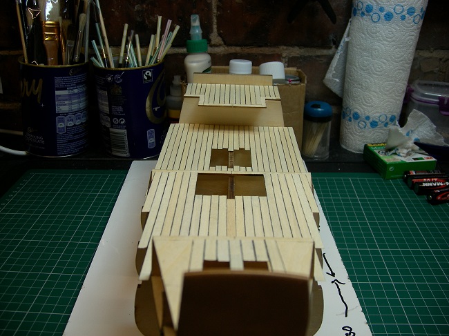

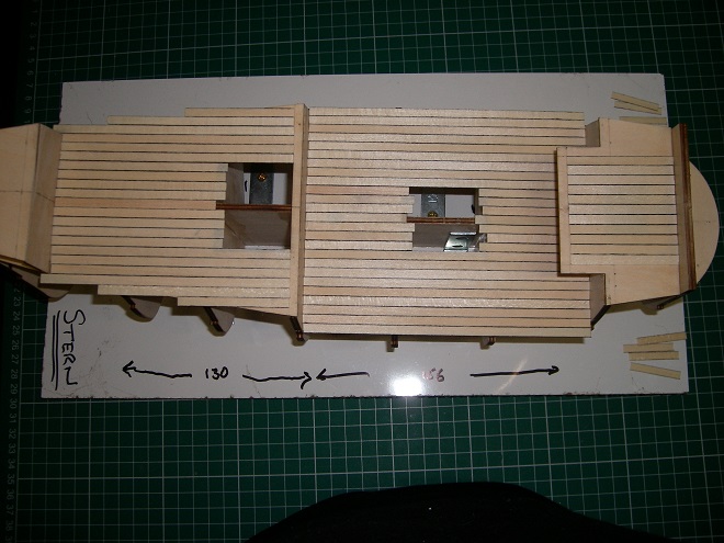

Steady progress, as stated before I find the decking process surprisingly therapeutic! Couple of photos, the "caulking" looks overdone in pictures, but nowhere as near as dark in natural light.
spineman attached the following image(s):

Looking good, very neat and clean work..Cool Cool .. The caulking doesn't look overdone to me, looks just fine... Very well done....Cool Cool

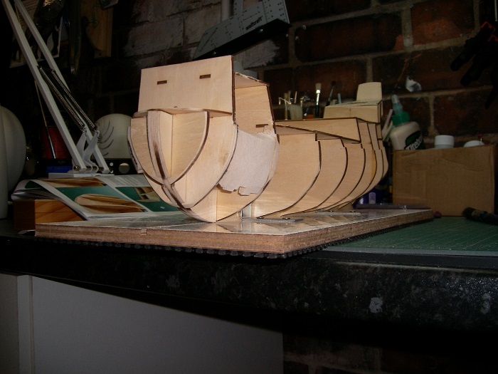

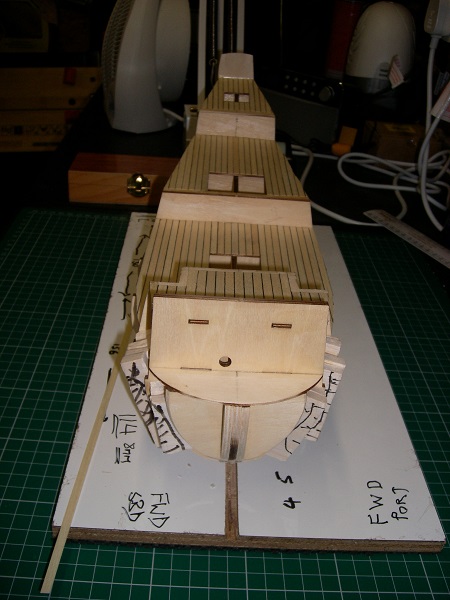

Hey guys,
Not a lot done again, Man FLU you know... women make such a song and dance about having babies. Shelling peas compared to Man Flu, maybe they will realise in time!Angry
Packed in some of Port & Starboard packing between bow lateral to smooth out the hull for blanking. I am going to post photo's as an atachments, as I am having issues which of the links to use from Photobox, any tips appreciated
