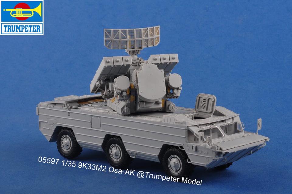

Hi guys (this WILL work sometime)
This will be my first attempt at creating a diary of one of my builds. I am not an expert modeller or painter but I enjoy what I do and am happy with my end results.
I use some PE when it's available and try to add very minor scratchbuilds if it will enhance the model.
On this occasion I will be building Trumpeters SA-8 'Gecko' almost straight OoB. There is one piece which I will try to replicate inside the hull but since it can't be seen once the hull top is on I won't worry if it turns out wrong.

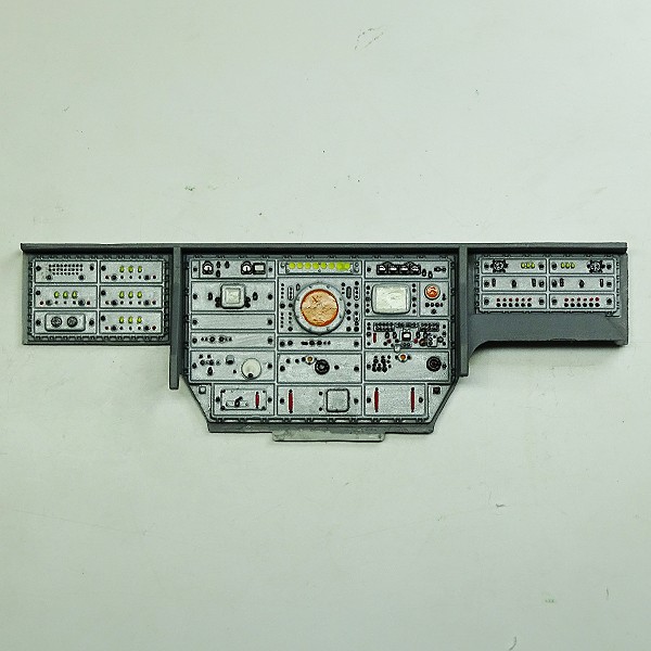

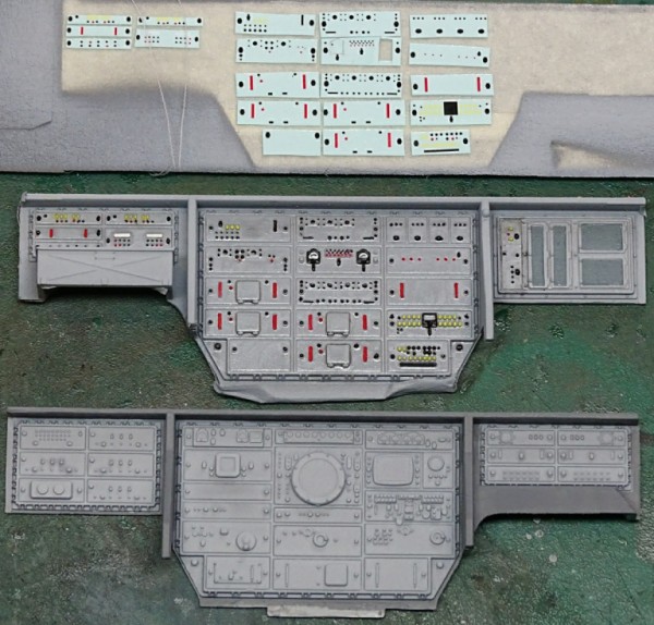

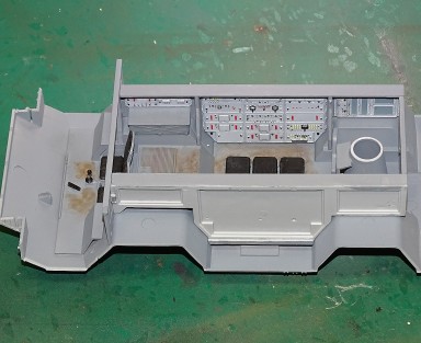

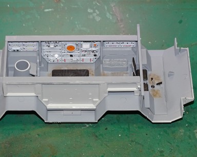

The initial part of the build is preparing the internal hull cabin. Both sides of the missile controllers positions are extensively moulded and from photos appear to be fairly accurate in their representation. Trumpeter supply individual decals for each panel which you could either attempt to lay over the raised detail (very hit & miss) or remove the raised detail and apply the decals to a flat surface. I decided to hand paint the raised detail for, hopefully a better end result.

#4 Posted : 15 November 2015 18:50:20
Hello Richard, nice to see a new military build on the forum.
This looks like a very interesting subject and I shall be watching your build with great interest. Looks like you've made a very nice start, I think you went the right way with the control panels by not removing the moulded detail and using the decals? That moulded detail looks very good and I think you've made a superb job of painting it, definitely an improvement on the look of those decals?
Very well done Richard, looking forward to seeing more of this build. Cool ThumpUp
#5 Posted : 15 November 2015 21:24:18
Hi Richard, BigGrin
Good choice of kit and painting the detail was the best decision.
Great result. Cool

Thanks for the comments guys.
Completed the second of the main cabin panels using a few decals that have dial representations too small for me to paint.

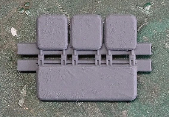

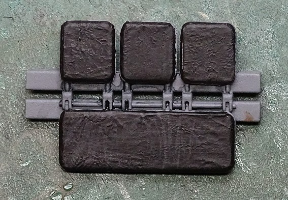

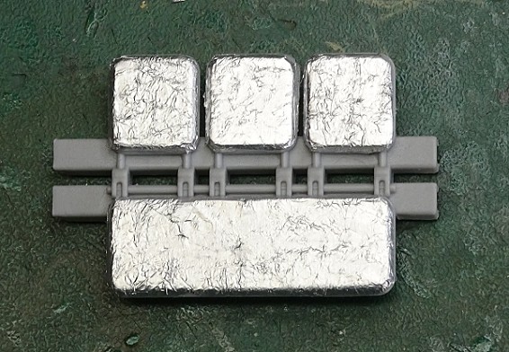

Continuing with the interior cabin detailing i now move on to the crew seats. As in most cases in standard plastic models the crew seats are re fairly basic with little or no showing of wear or use. To overcome this I tend to cover the padded part of the seats with kitchen foil. Initially screwing it up and then gently teasing it out to get a sort of texture. This is then superglued over the kit part and folded down the sides of the seat. Any overlap is removed with a sharp craft knife. The result is then undercoated and then given a coat of the required seat colour. This now gives you a rougher surface which can be drybrushed to bring out the detail.

#10 Posted : 21 November 2015 20:38:07
Now that is a very good idea.
Looks like you have a good base coat on that foil as its a difficult thing to try and get paint to stick onto.
Very inspiring build - many thanks for keeping the updates coming.

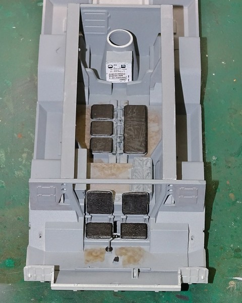

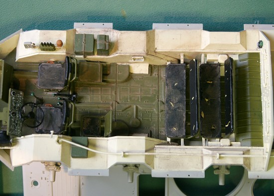

It has a basecoat of car primer followed by the general interior colour coat before the black went on. A light drybrush of Rubber/tyre black brought out the subtle shading.
Results of the interior. The panel at the rear was taken from the only reference photo I could find of the rear interior of the cabin. Cropped the image to the required size, printed and glued in place using No More Nails glue.

#13 Posted : 21 November 2015 22:33:59
Thats a fantastic idea and looks really effective!
I will remember this method as I have a few builds in my stash that will have seats that need doing Cool

I picked up the tip from a build on a BTR60PB, and tried it for the first time on my own kit. The foil can be cut and folded to show rips on the seating.

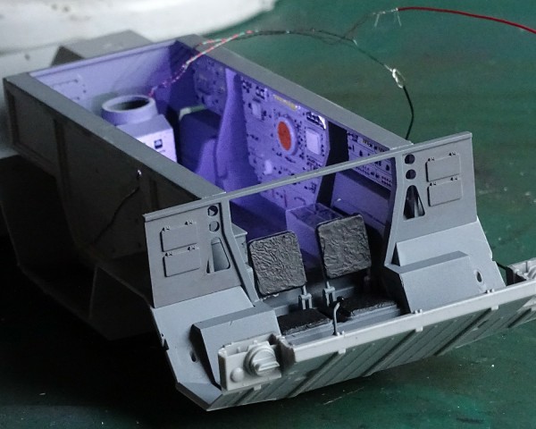

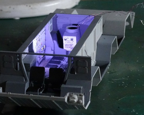

Time to see if my idea of lighting is going to work. LEDs of 'pico' size with a switch and coin battery are supplied by a US Model Train shop. The battery and switch will be housed in the base of the radar/missile array unit.
With house lights turned off in a fairly dark room this is the result.

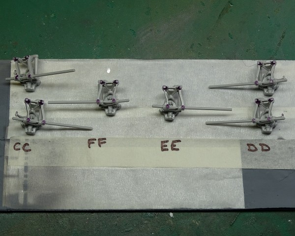

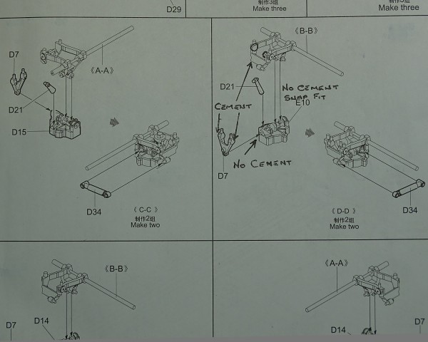

Moving on to the suspension. The instructions do not tell you that the front and rear wheels are steerable, albeit individually. I discovered this after cementing part D7 to parts D15 on my first sub assembly. Sub assemblies (A-A) & (B-B) snap fit onto D15 and E10 respectively. The centre wheels are fixed so sub assemblies (E-E) and (F-F) can be cemented throughout but you need to ensure that the wheel hub is at right angles (90 degrees) to the suspension. The first photo shows where not to cement, the second is the suspension units ready to be undercoated. I plan to spray the wheel arches and suspension units with Base Russian Green before moving on. In that way I'm not going to have to fiddle around big wheels to get it all coated with paint..

Great work with the lighting, it looks really cool Cool
