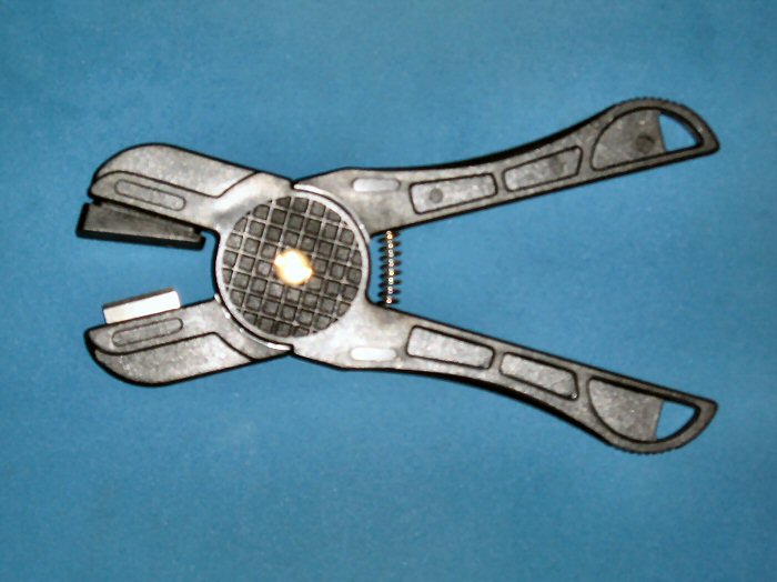

What does "plank bender supplied with the kit" mean? I haven't received one, I don't think.

jeff averre ,hi,did you reverse the blade in the bender?using the blunt end?I used the sharp end and I kept snipping the plank into pieces,when I used the blunt side all was ok.
#7 Posted : 20 November 2010 11:43:00
Correct its the blunt edge for bending.
z8000783 - Those who subsrcibed to the series received a free tool kit which includes a nip plank bender.
Oh you mean that thing that looks like a pair of secateurs?
Is that going to be necessary rather than using steam? I didn't want to use pins let along that.
John
This John!

The sharp or blade side is designed to cut planks, the blunt side of the blade designed to nip planks for bending.

Thats it then! I was using the sharp side of the blade (the way it came), I never picked up on it being turned round, I've never used one of these plank benders before and as far as this kit is concerned I probably won't need it again as the remaining bends are not too tight.
I don't know why there is a sharp side, I would'nt dream of cutting a plank with it!
