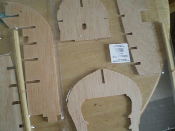

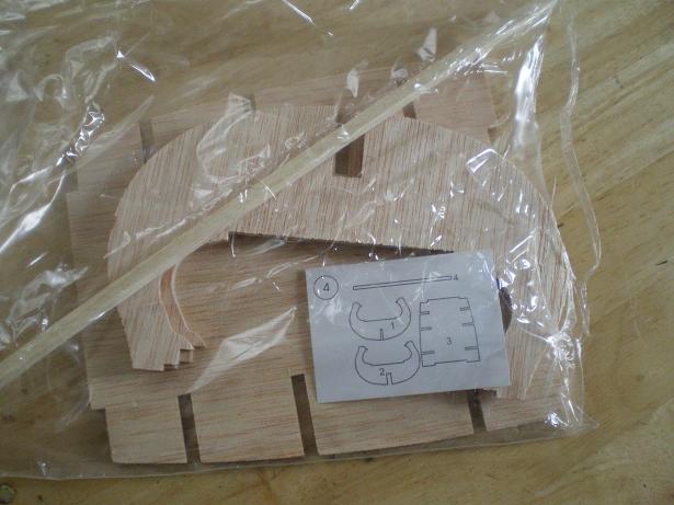

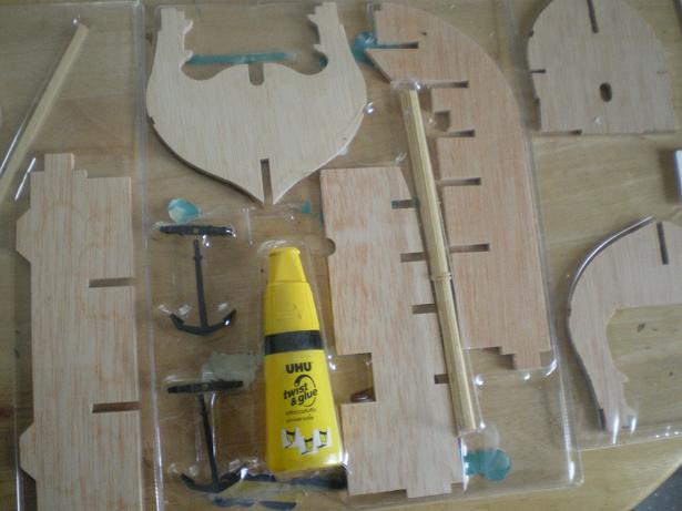

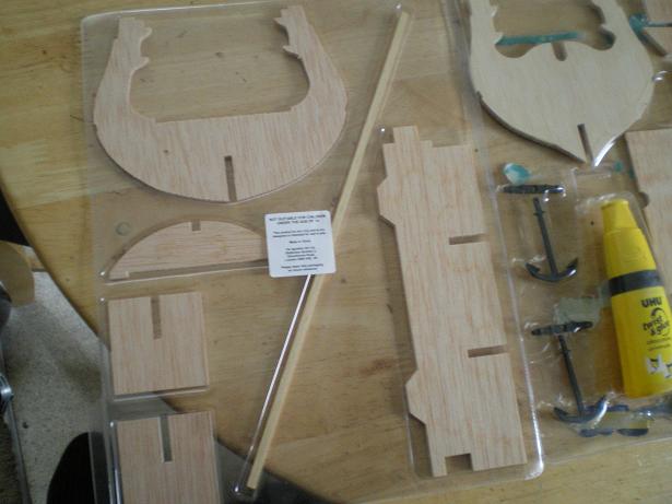

BigGrin Got some parts today in the post so had a look. Very nice packing and the parts are clean with no warping . also in the pack is some glue and sandpaper Cool

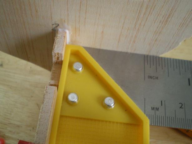

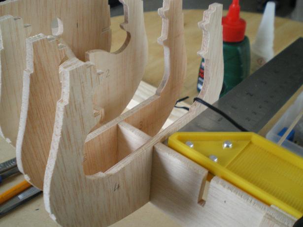

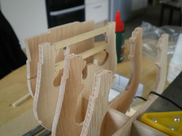

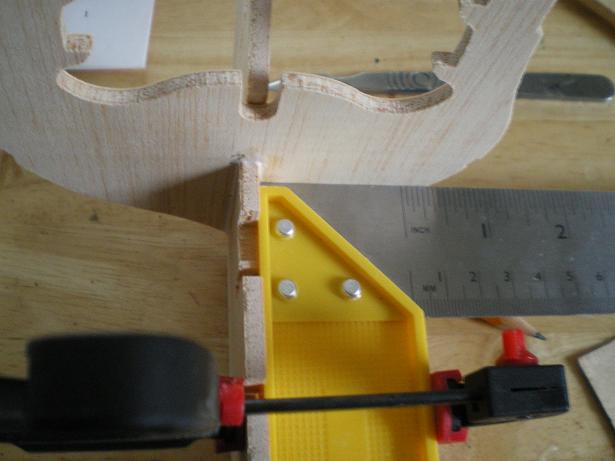

First job sanding and dry fitting the first rib to the keel . I found it to be a nice sliding fit into the slots BigGrin Next up glueing the rib to the keel . A small drop of PVA was appled to the slots and slid into place then with a setsquare to set the rib 90deg to the keel and set aside to dry BigGrin
Thanks for looking next update soon rgd Martyn

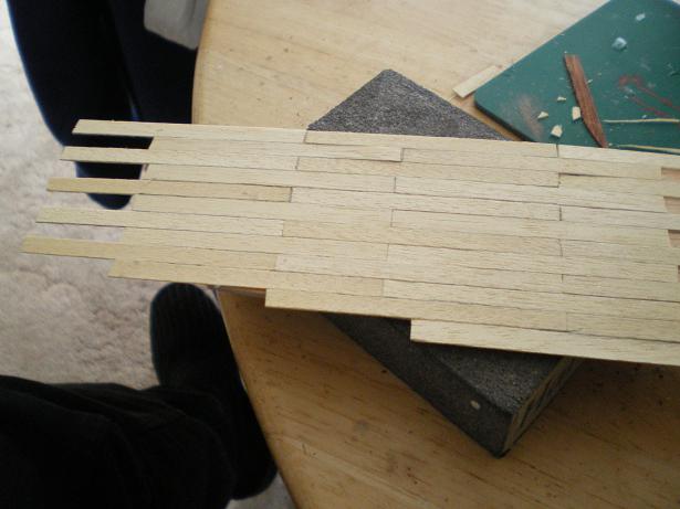

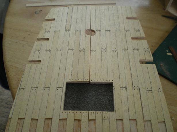

I have started planking the deck and will post some pics later Cool
Thanks for looking in rgd Martyn

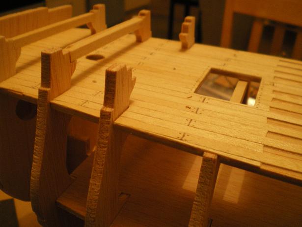

#14 Posted : 23 October 2015 15:22:47
BigGrin Hi all Cool
I have finished planking the deck and have moved on to the anchors Cool

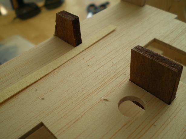

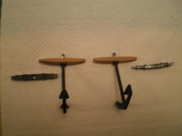

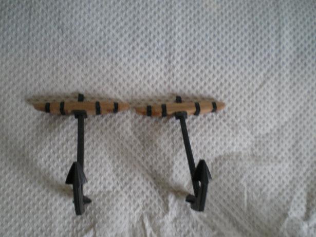

The anchors are cast and with very little mold lines . The stock is also cast as I want a all wood finish I have made some out of walnut with tin foil bands to look like iron Cool

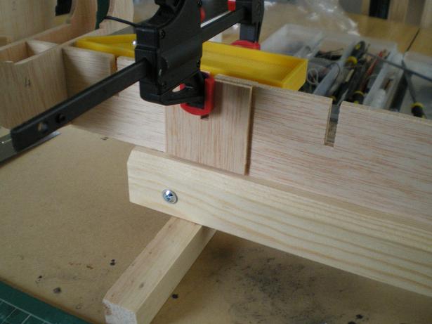

Next step is putting more frames onto the keel . As before thay have been set to right angles to the keel Cool As you can see I am useing a build jig to hold the keel in place BigGrin
More to follow see you soon rgd Martyn

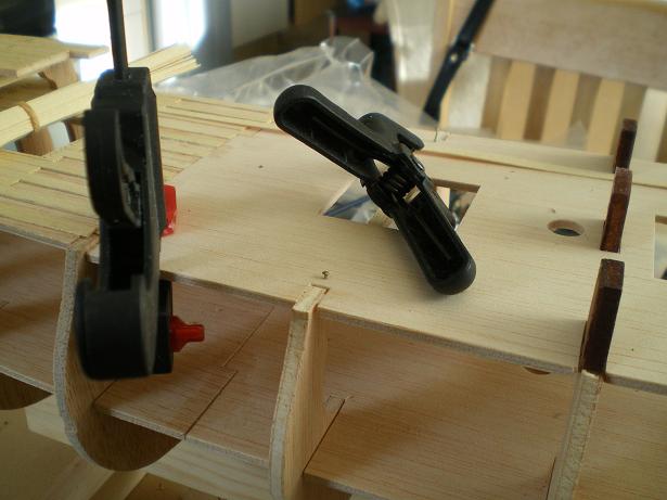

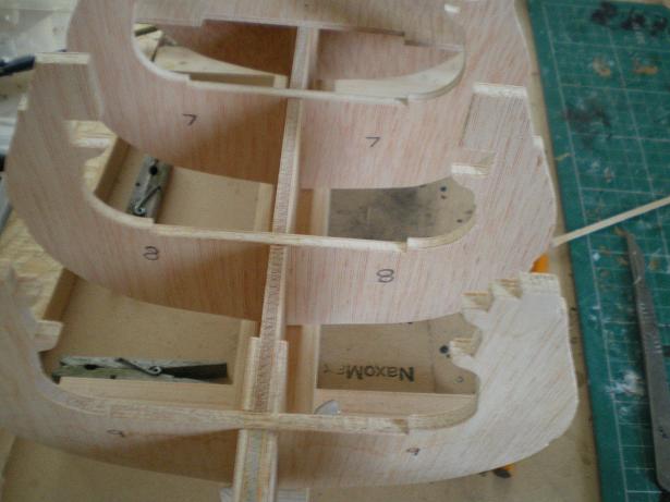

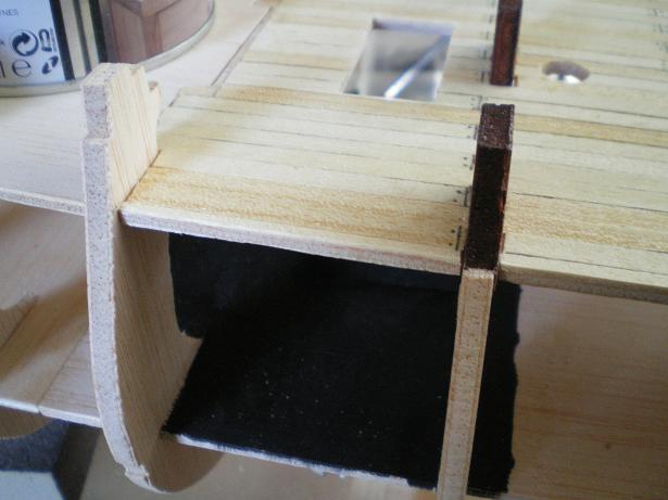

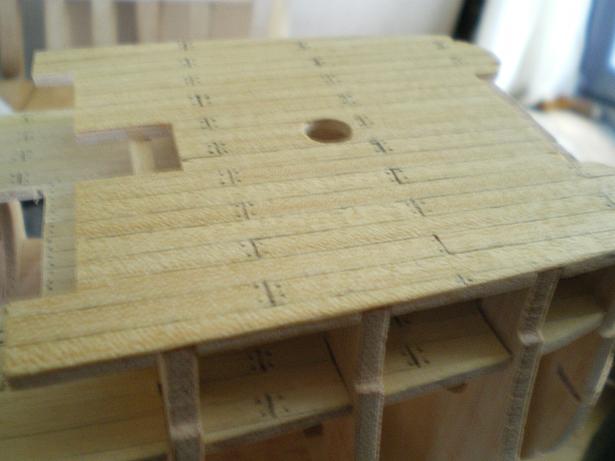

Onwards with the build . I have fitted some more ribs to the keel and after they had dryed started fitting the lower decks Cool . I like the decks going in as it stiffens up the ship no end ThumpUp

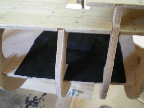

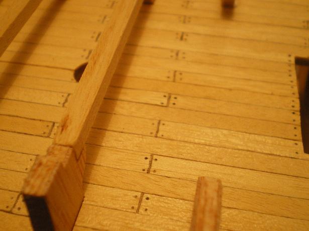

Next job planking the top decks . The planks have been corked by useing a pencil along the edge Cool . After the openings have been cut out I could see the deck underneath so painted it black Cool
The bulkhead that comes through the deck I have planked with some leftover planks from the SoTs BigGrin
Thanks for looking rgd Martyn
