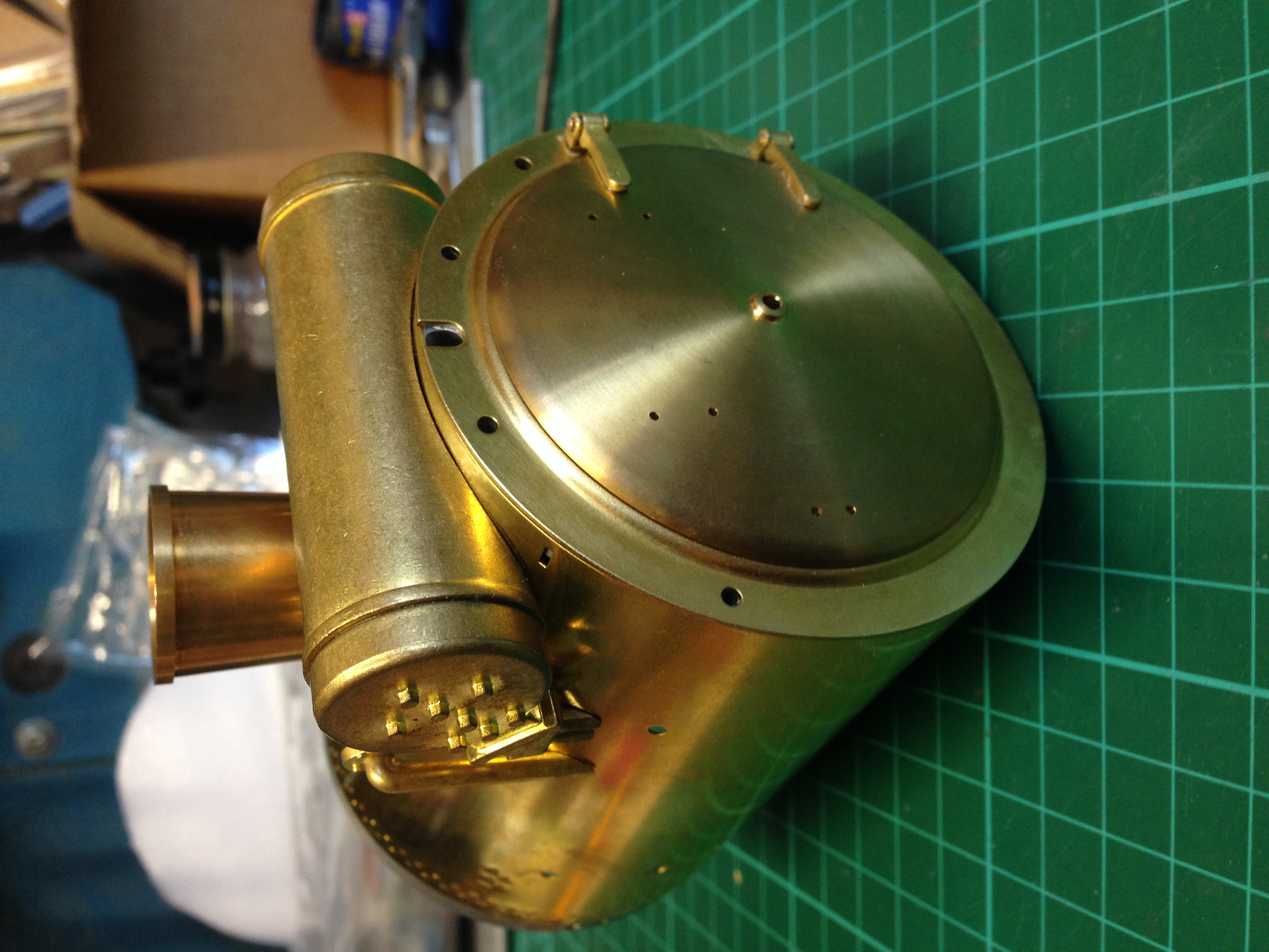

Here are my efforts in building the first few stages, once again would like to thank you guys for all those little tips that make building the model a lot easier than it otherwise would be for me.

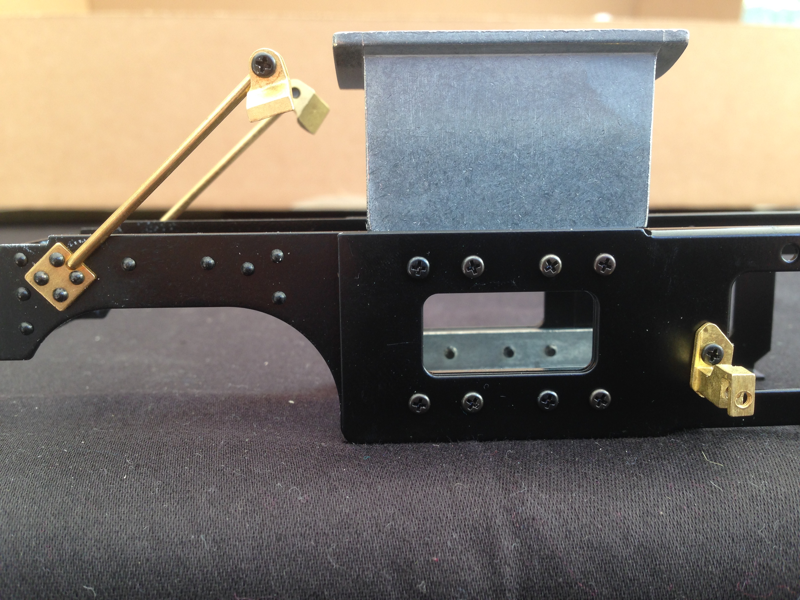

#9 Posted : 14 November 2015 22:02:48
Joined: 23/09/2015
Posts: 16
Points: 48
Location: London

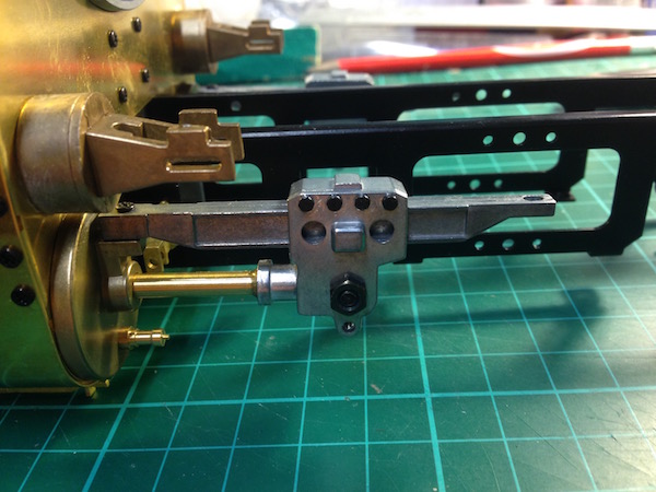

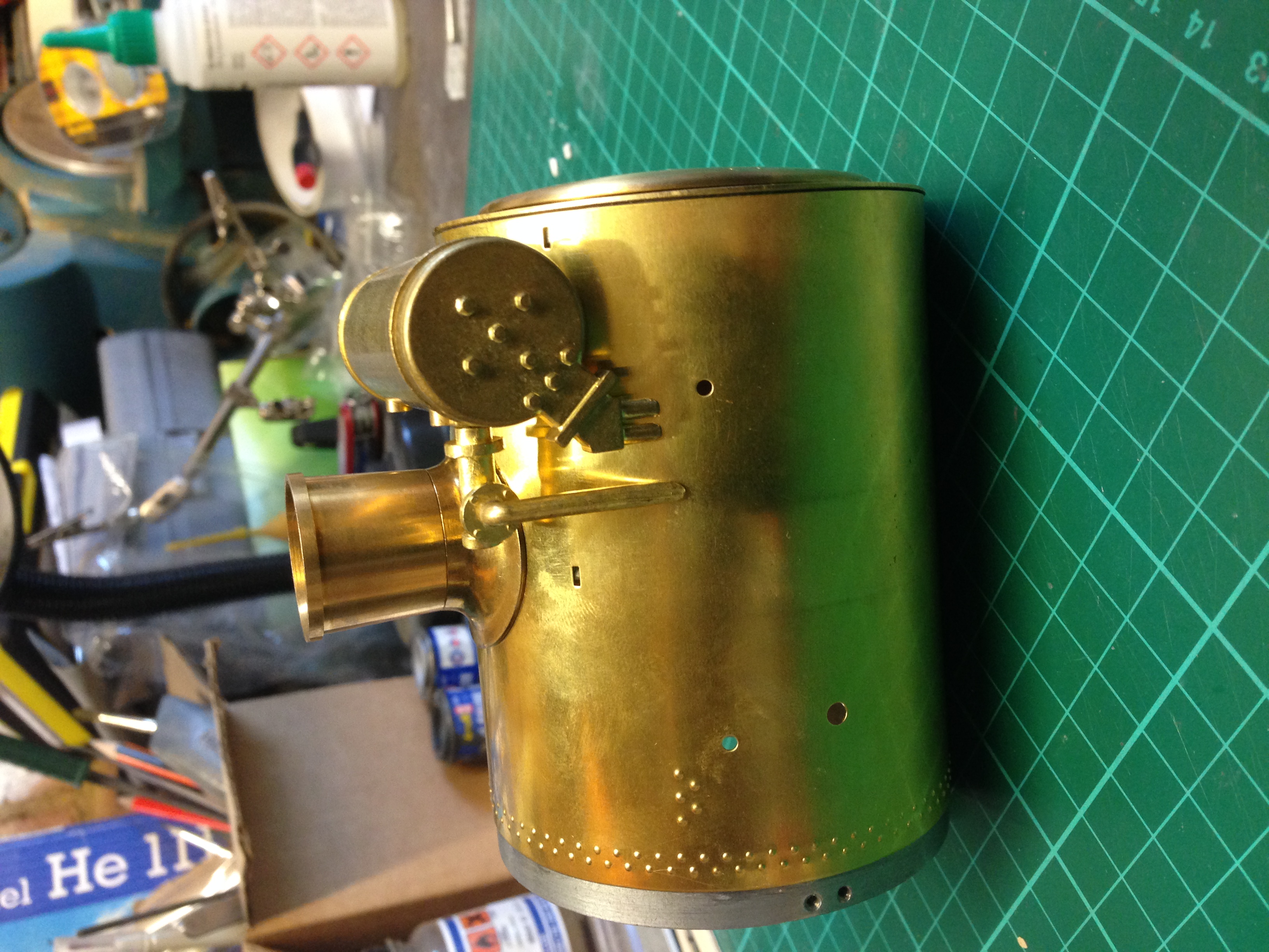

Update on how the build is going, don't have the small socket tool so improvised with a pair of long nosed pliers and span the piece, tightened with the small spanner provided. Epoxy on the shaft and fitted onto the frame.

So glad I purchased a pick up tool ! I managed to seat all the rivets in the holes without the usual drop on the floor and search routine, a record for me, feel so proud of that little achievementLaugh

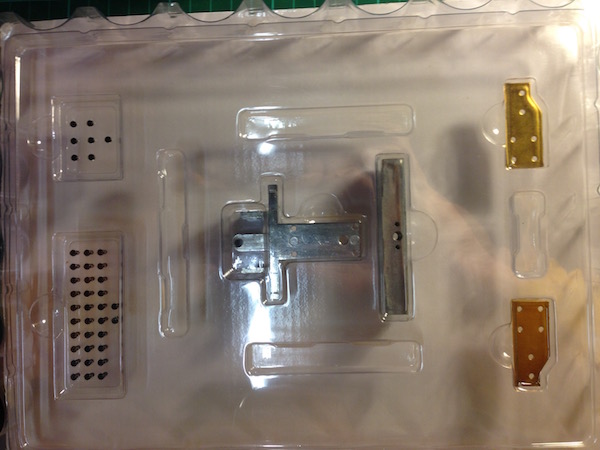

Gr33n1e
#11 Posted : 14 November 2015 22:15:34
Joined: 23/09/2015
Posts: 16
Points: 48
Location: London

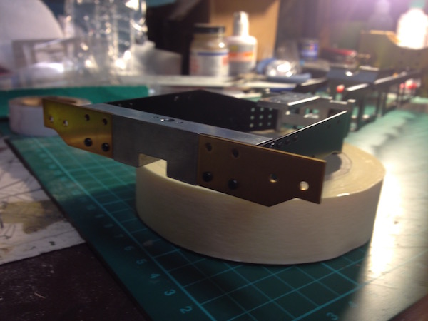

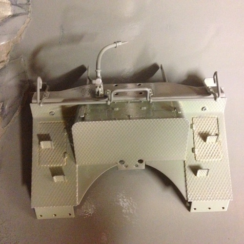

More screws on the next stage, nothing difficult here just a matter of lining up the holes and having a magnetised screwdriver

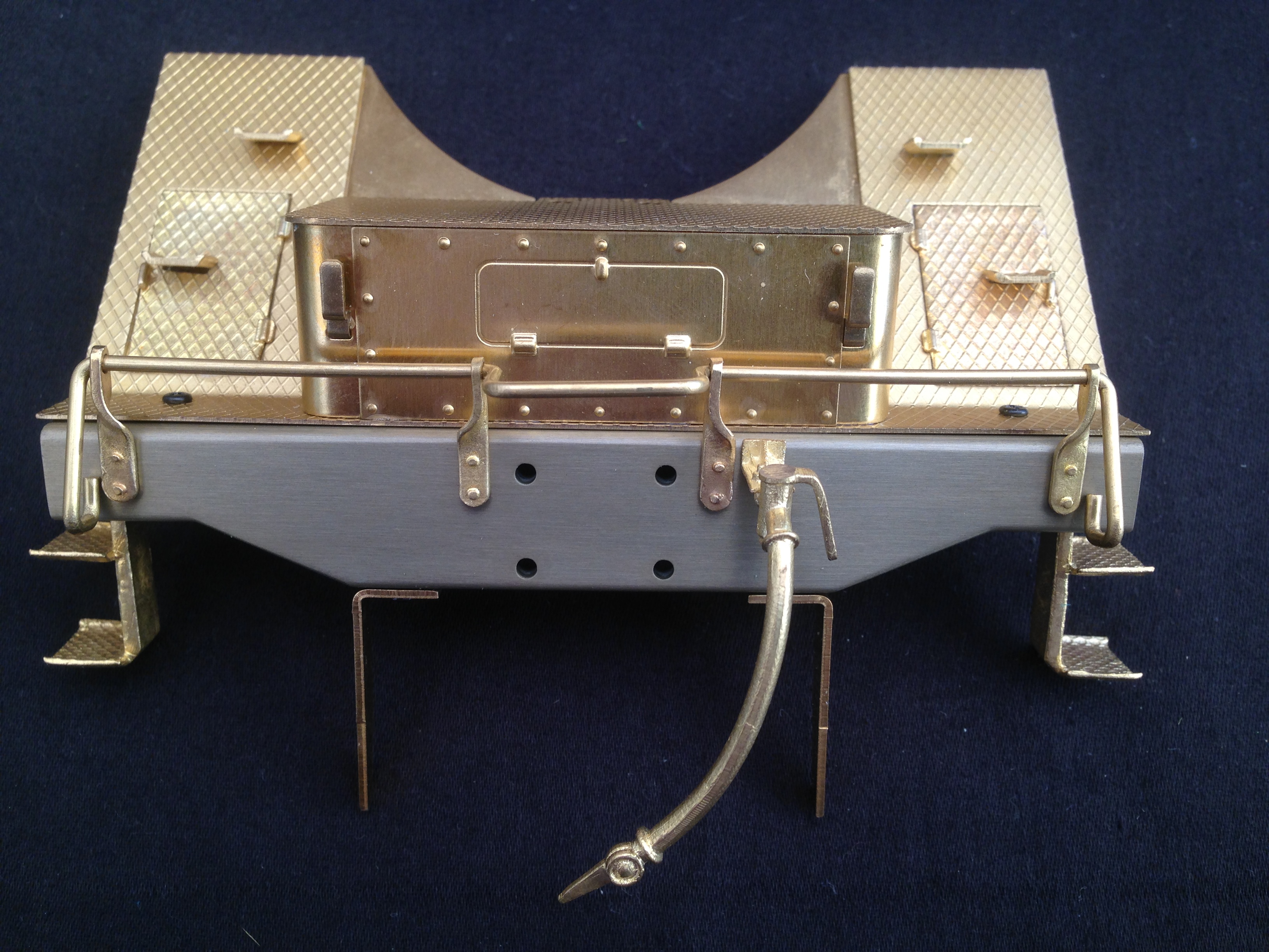

And the final section for this months delivery, no dramas very straightforward, just need a screwdriver

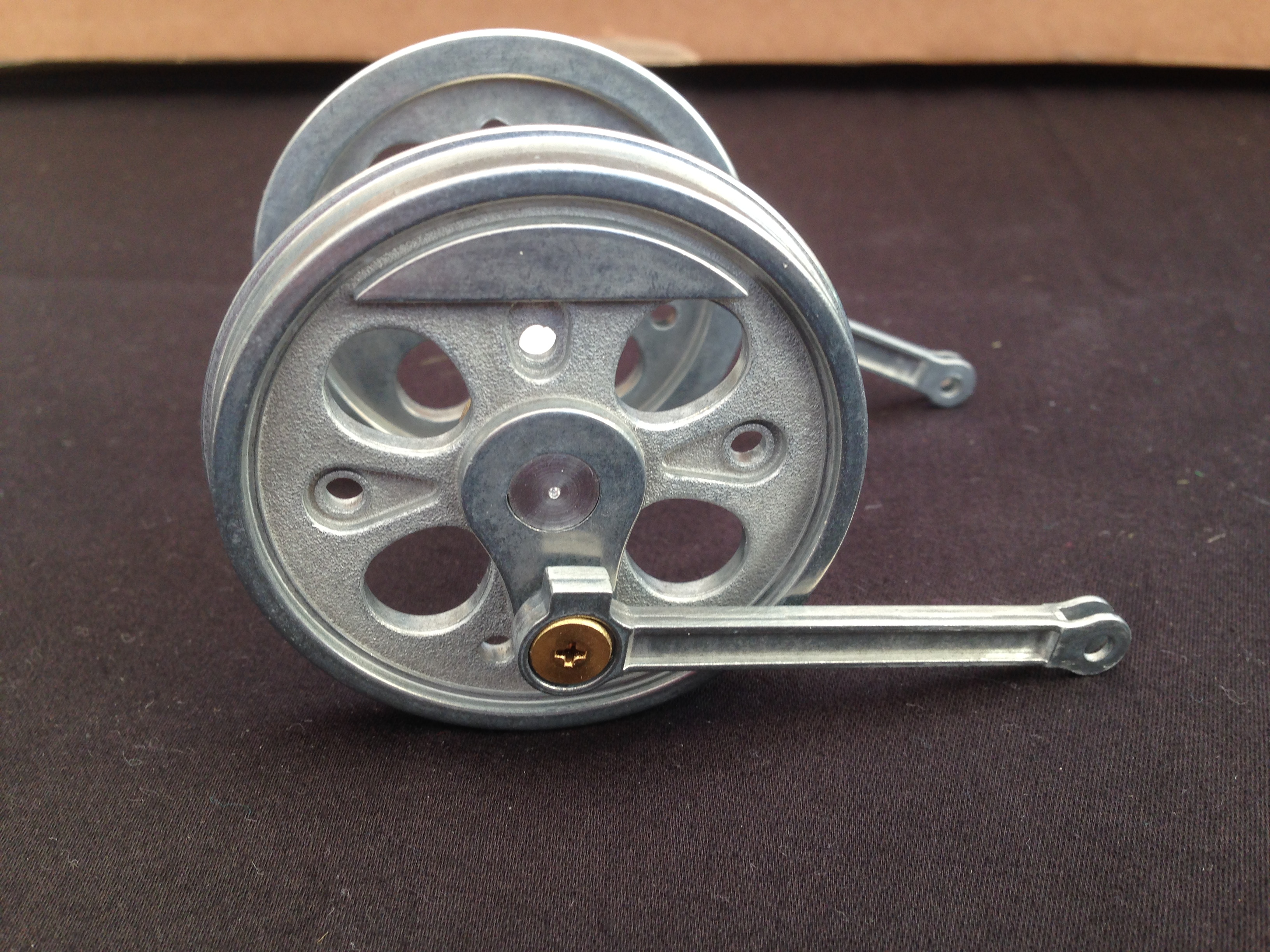

Gr33n1e
#17 Posted : 28 December 2015 22:02:20
Joined: 23/09/2015
Posts: 16
Points: 48
Location: London

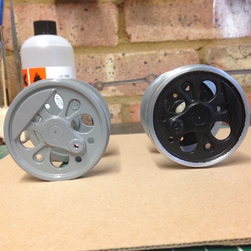

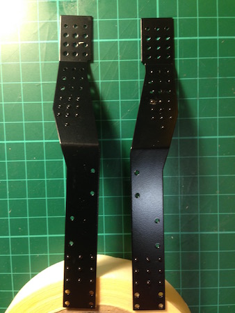

Looking at other builds, early on I have decided to paint, whilst the brass versions look great I think paint really makes this stand out... One problem - my painting skills!
Anyway here goes, always glad of advice and thanks to those who have gone before for the ideas on paints to use it has been really helpful.
I started with the wheels, I'm using white vinegar to degrease, everything gets a thorough clean. Then onto prime, here I have used cambrush primer, finished it gives a shiny plastic look but a great surface to paint on.
I found myself over applying in a couple of areas and got a couple of runs, put this right with a bit of sanding back and reapplication.
Pictures show one set primed and the other set finished using Railmatch weathered black acrylic. Need to clean up a couple of areas around the edge but I'm still wrestling with the dilemma of painting the tyre in. Think I will on one set and see how it looks on the frame with the other bits in Situ.

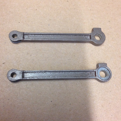

#18 Posted : 28 December 2015 22:05:29
Joined: 23/09/2015
Posts: 16
Points: 48
Location: London
The coupling rods I have used Railmatch oily steel, didn't thin it down, applied straight from the bottle brushed on

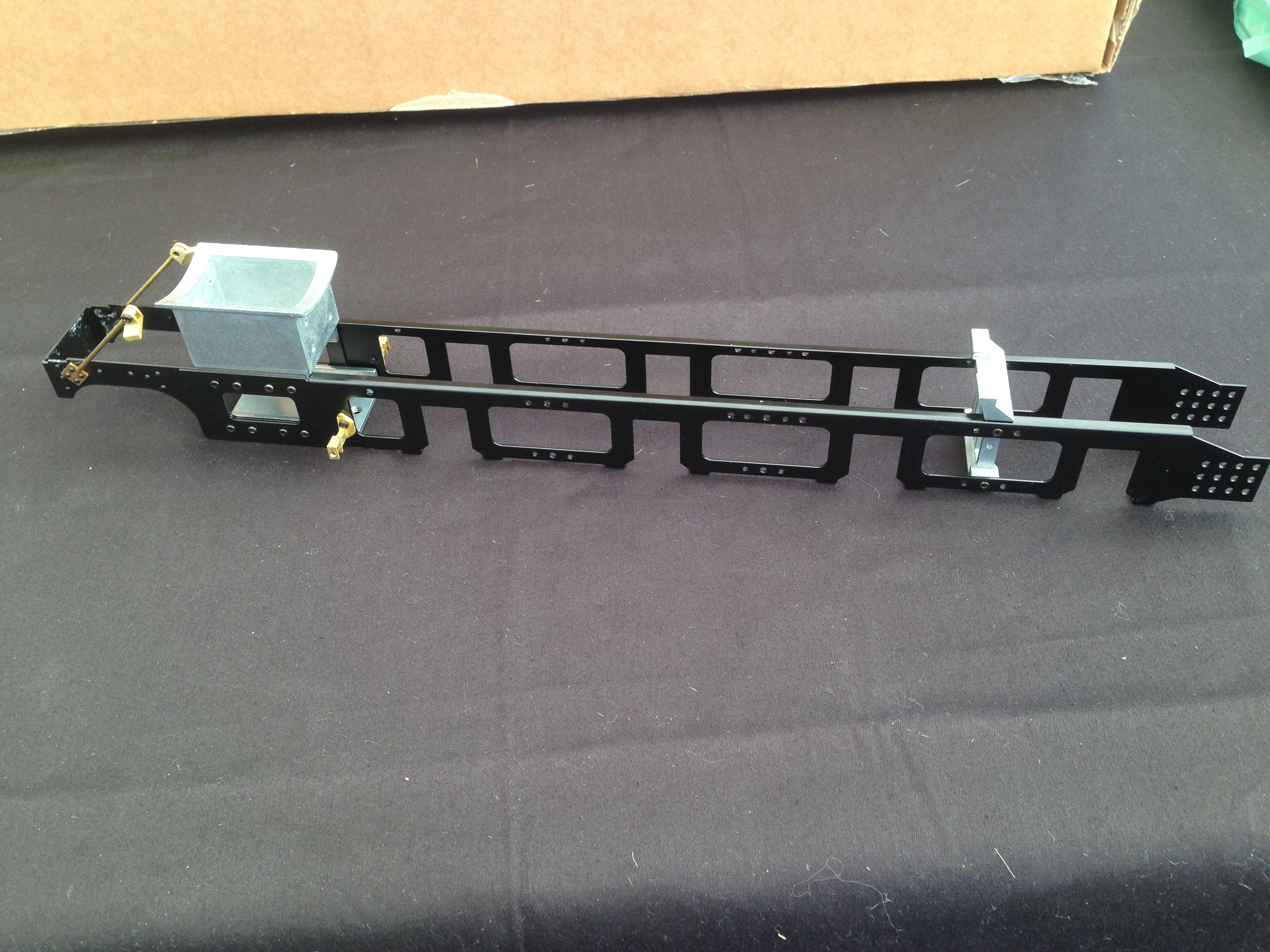

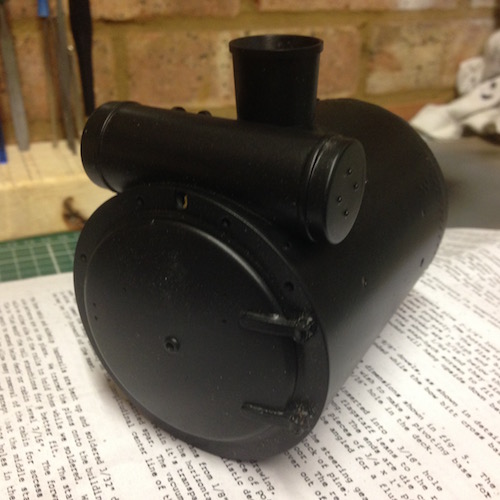

Front section and steam box primed for paint.

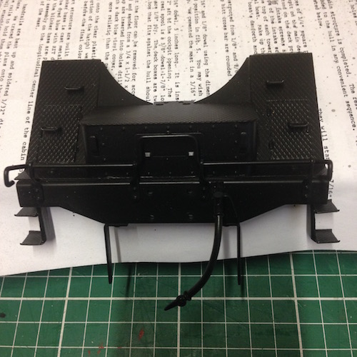

Gr33n1e
#20 Posted : 28 December 2015 22:21:22
Joined: 23/09/2015
Posts: 16
Points: 48
Location: London
Here are the results of my first ever experience of using an airbrush.
Read up lots on this and looked at various tutorials on the old interweb.
What psi should I use, how thin should the paint be etc... lots of trial an error. My first effort resulted in the paint being too thin, although I was correct distance away it looked like the paint was splattering and running. Mixed in a bit more paint and hey presto, with the paint now good I decided to spray on a PSI setting of around 20, the spray brush I use has a stop on the lever which I set to halfway as a safety net of not applying to much paint in one go. A real nervous moment to start with but gradually the confidence began to flow and as a first shot at doing this I'm really please with the outcome.
