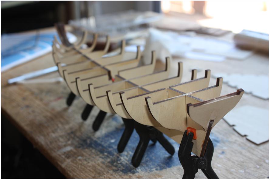

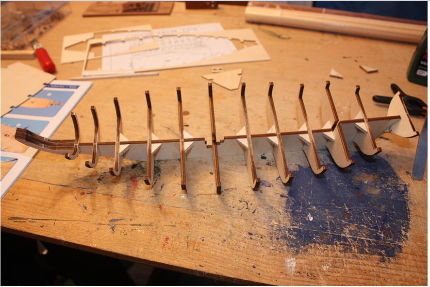

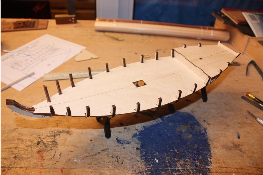

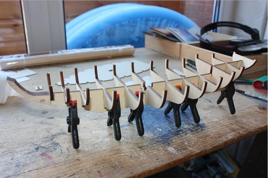

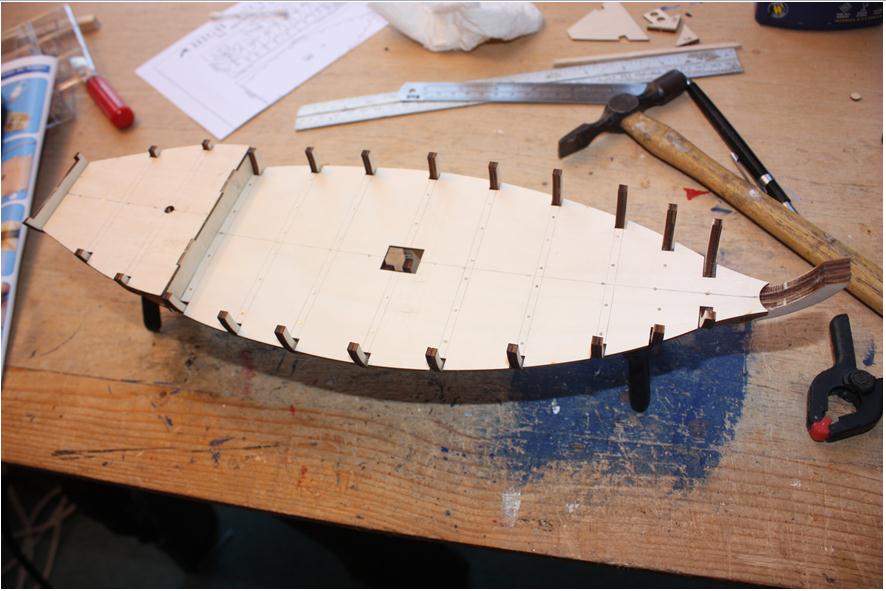

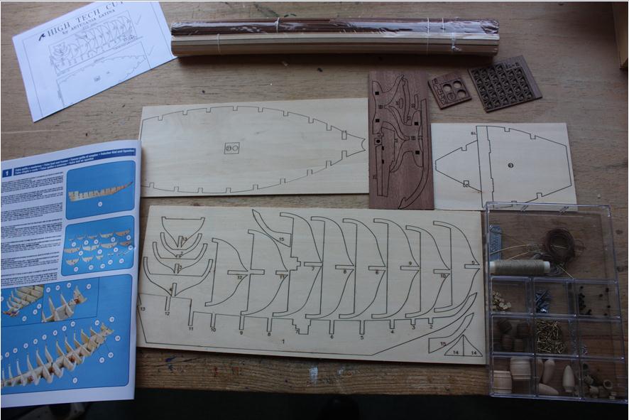

After the Jupiter Build decided to go back to a small ship build. This is also to fill in time whilst waiting for the next issue of my Orrery build
The build so far as indicated by the attached pictures
1) The Box arrives

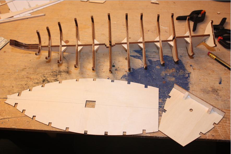

2) The contents of the Box

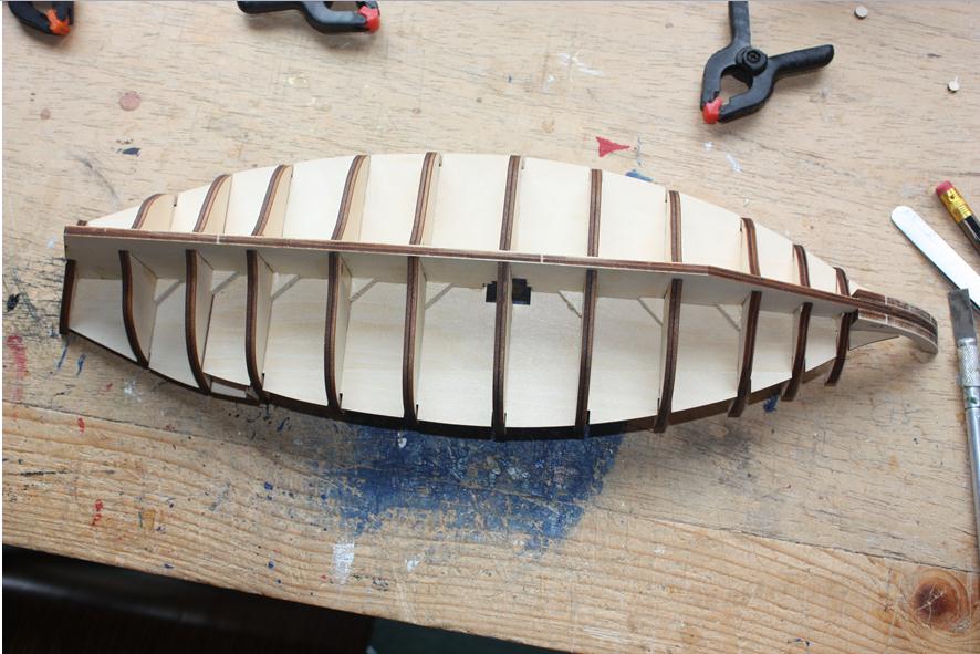

3) Attaching the frames to the false keel
4) another picture of the frames on the Keel
5) I have reinforced the frames by adding additional blocks to support the frames on the keel. Also to ensure the required 90 degree angle is achieved
6), 7) and 8) attaching the decks to the frame
9) Nailing the deck to the frames. I pre drilled the ply decks as I find this avoids the to potential for the deck to split
The next step is to shape the frames prior to planking
So far so good
More to follow

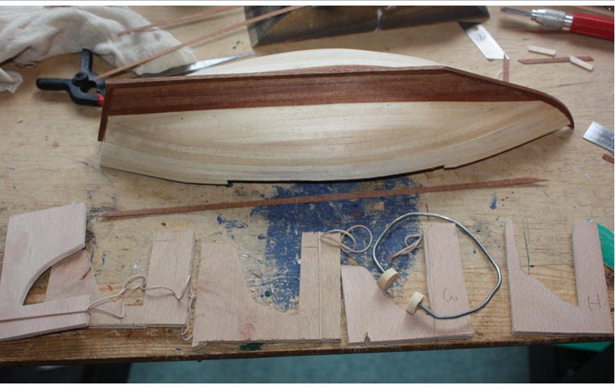

This build has been on the back burner whilst I considered my first attempt at second planking. I decided in the end not to use an impact glue (Lack of confidence) but continue with the evostick wood adhesive I have used for the rest of the build.
The hull has various curved surfaces so I have made up some formers which follow the curve of the hull at strategic places and use these to hold the planks whilst the glue dries . This glue goes off reasonably quickly but gives me time to position the plank.
Still some way to go but happy so far
BigGrin BigGrin BigGrin BigGrin BigGrin BigGrin BigGrin BigGrin
Pictures attached
