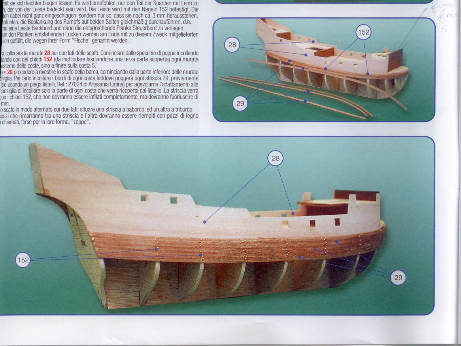

Here is the section of the plans:
BrettK attached the following image(s):

Firstly welcome to the forum and if your stuck just ask were here to help. As for your planking question its down to artistic licence by the kits designer in that single rows of planks will look nicer than cut part lengths as would have been on the full size ship which you correctly point out. So its up to yourself really but laying the planks as instructed will make the planking easyer to do.
The stern will not be much of a problem curvature wise but the bow will need the planks to be soaked in warm water for at least half an hour then either steamed to shape or use a plank bending tool to get the curve. There are several good diary's on the build of this ship and refering to them will help you too.

BigGrin Totally agree with Andy on the planking as it is best to stick with the instructions Cool
After it is fully planked you can mark the planks to look like they are made off shorter ones Cool

If you decide to cut the planks to a length you present yourself with som potential problems firstly you will have to stager the joints like brick laying so yo may find you are having to put a bend in the full length of a cut to lenght plank, not easy in 2mm hard wood. Also you may end up with more wast and potentialy run short of strip wood. Also you are prabably trebeling the time required to plank the hull as well as creating mor oppertunity for gaps. And thats before we consider having enough nails to do the job.
It would look nice with more joints but it presents a lot of issues to resolve.
This wood is very hard and needs a good 30 mins to an hour of soaking plus bending time it would toake you months as there is a lot of wood on that hull

With the planks on the San Francisco they are very Brittle. Mahogany doesn't like to bend so to get round it I soaked a couple at a time in boiling water until the bubbles stopped. Then used an iron to shape them. If you do it slowly you can get a good round on it. Once shaped then you can go about tapering them.
I did the planks full length and it does look good that way. If you have a nose at my build you should see how I went around it.

I did a little test run of full vs sectional. It reminded me how hard it is to get good straight or curved lines with shorter lengths, and how impossible that might be with 2mm thick planks.
