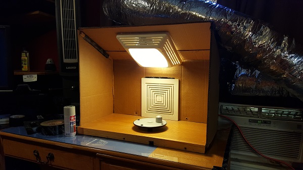

Have been spending more time watching youtube think i have seen most of them and wow there is some really great stuff going on. I got my first 4 issues but still waiting on paint supplies, got some of it but not some of the primary ones i need first, have been "prepping" what i can, made a diy paint booth with some cardboard and some spare parts form my work. Also picked up a 1/48 scale colonial viper from the classic Battlestar galactica to use as a practice piece before i i try on the falcon. I did give it a try on the quad guns and carved out the tips. Will try to up load some pics

I like your spray booth. I am wanting to learn air brush techniques, so like you, I have watched a lot of YouTube.

I would have never thought to build a paint booth like that. It is awesome. BigGrin

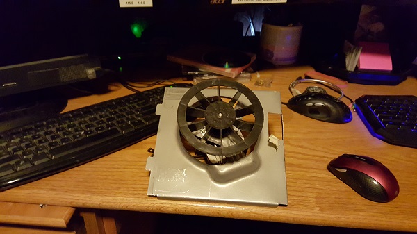

I need to upgrade it the ideal was sound but after priming a couple parts "primer is the real reason for booth" I need it to move more air, at the moment its a 50 cfm bath fan that I had laying around, that's not enough it can barely hold filter in place and I found myself a little light headed after priming parts, no were near as bad as without it, I run an AC and Heating Co, and had a couple used blower assemblies from a small gas furnace its 110volts so with a little modification will be able to incorporate that and get the airflow in to the 200 to 300 cfm range that should not only get all the fumes but any stray dog hairs in the area, will update once I get it done.

My spraybooth is in the basement so it does get dust and cobwebs.I turn the fan on and let it run for a few minutes before I start painting and that helps to avoid the big floaters settling onto my paint job and gets the air cleaner.You do need quite a large airflow to capture the fumes adequately.
if you are using rattle cans even a decent spraybooth wont get all the overspray.You are better off spraying that outside.I have quite a large spraybooth and it struggles with the volume of spray from cans.My airbrushes work fine because the paint volume is much lower.If I do my rattle can spraying indoors I wear a respirator

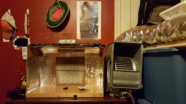

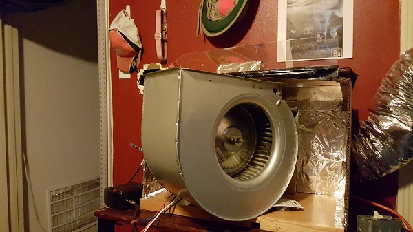

Here are examples of the fan that is and the fan that will be.

Still waiting on the replacement parts but in the meantime have finished my latest paint booth the last one with the blower from a furnace was to much and the dam thing burned out in a few minutes after hooking up, but then I was looking though all my spare parts at work and found this great inline booster for a duct line, its pushes or in my case pulls 200 cfm and is strong enough to pull the filter in tight when 6" away from hole.
It had a cracked housing so we cant wsell it but a little tape and it was sealed, and had a great mounting
A plastic container made a nice transition for it
I dont have the final picture but will add later the 7" duct I ran from it to the windo that I wanted it to go out gives my work area a real Falcon feel. I also updated my desktop image to give inspiration
